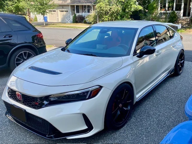

I am running H&R hub-centric 20mm in the front 25mm in the rear. Car looks worlds better (no more tuck). That being said I don't track my car only dd and spirited driving when in the right area for it. Car drives great. I am also lowered on H&R springs and have a taller sidewall (35). Like many have said running spacers is just like running a more aggressive offset with new wheels.
