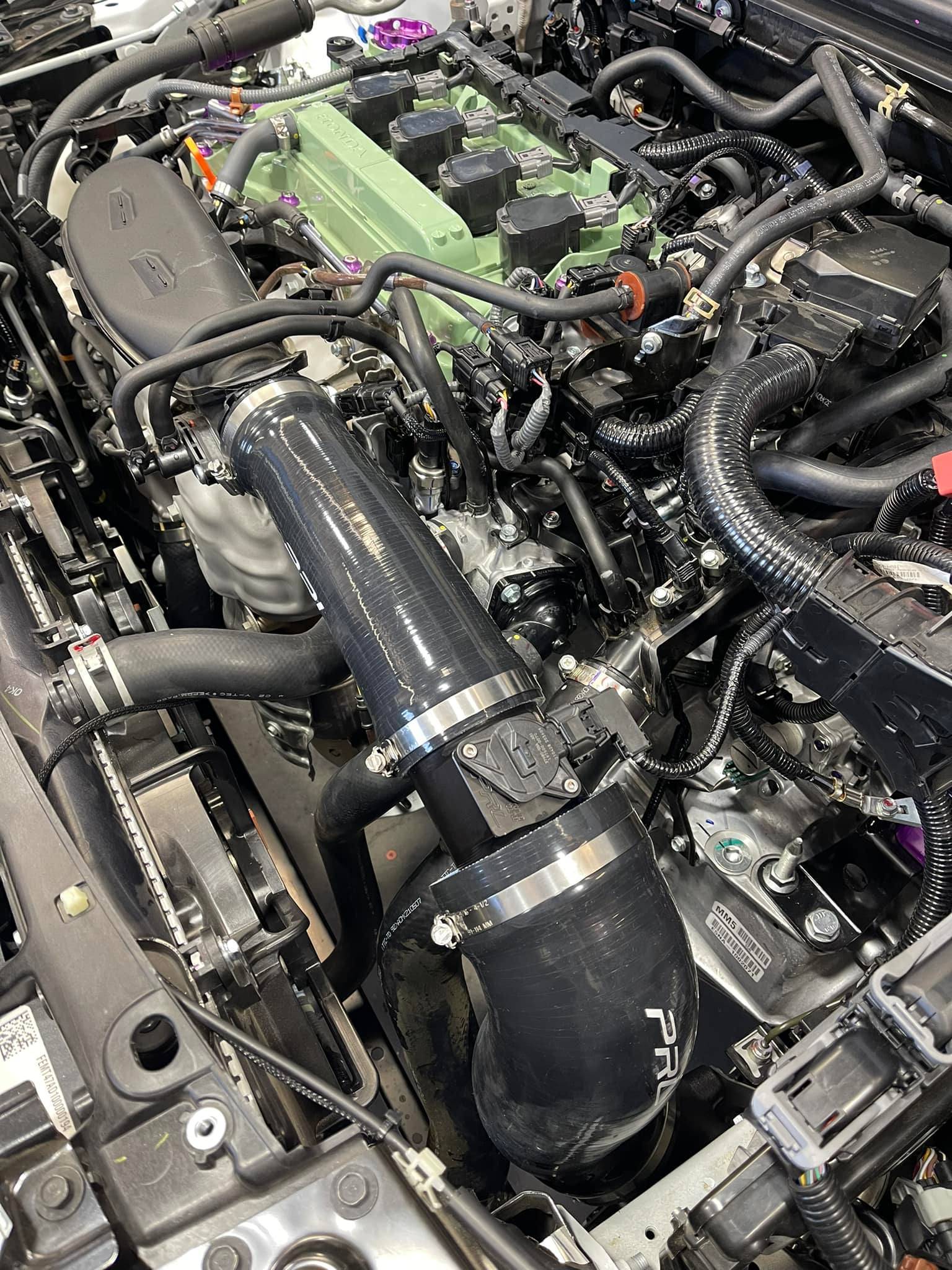

So we ended up stay with the stock turbo for now and will wait for the built engine for the big turbo
We did the Si cam and DI pump along with 10th gen Cobra intake which needed modified to work and tuned. We also installed the PRL flex fuel kit. Now to tune the car and get it to the track to try and run 11's

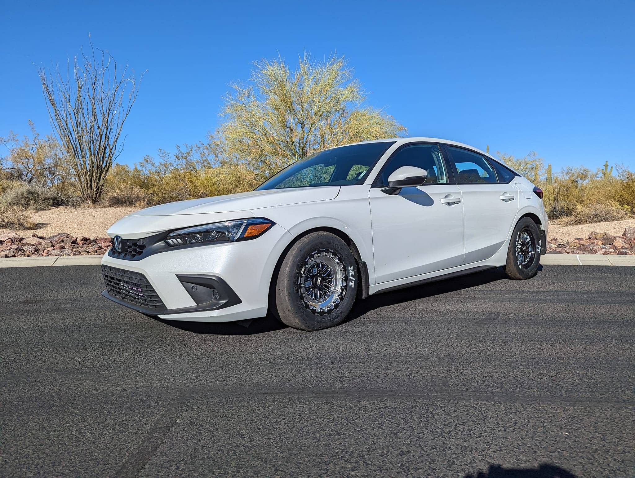

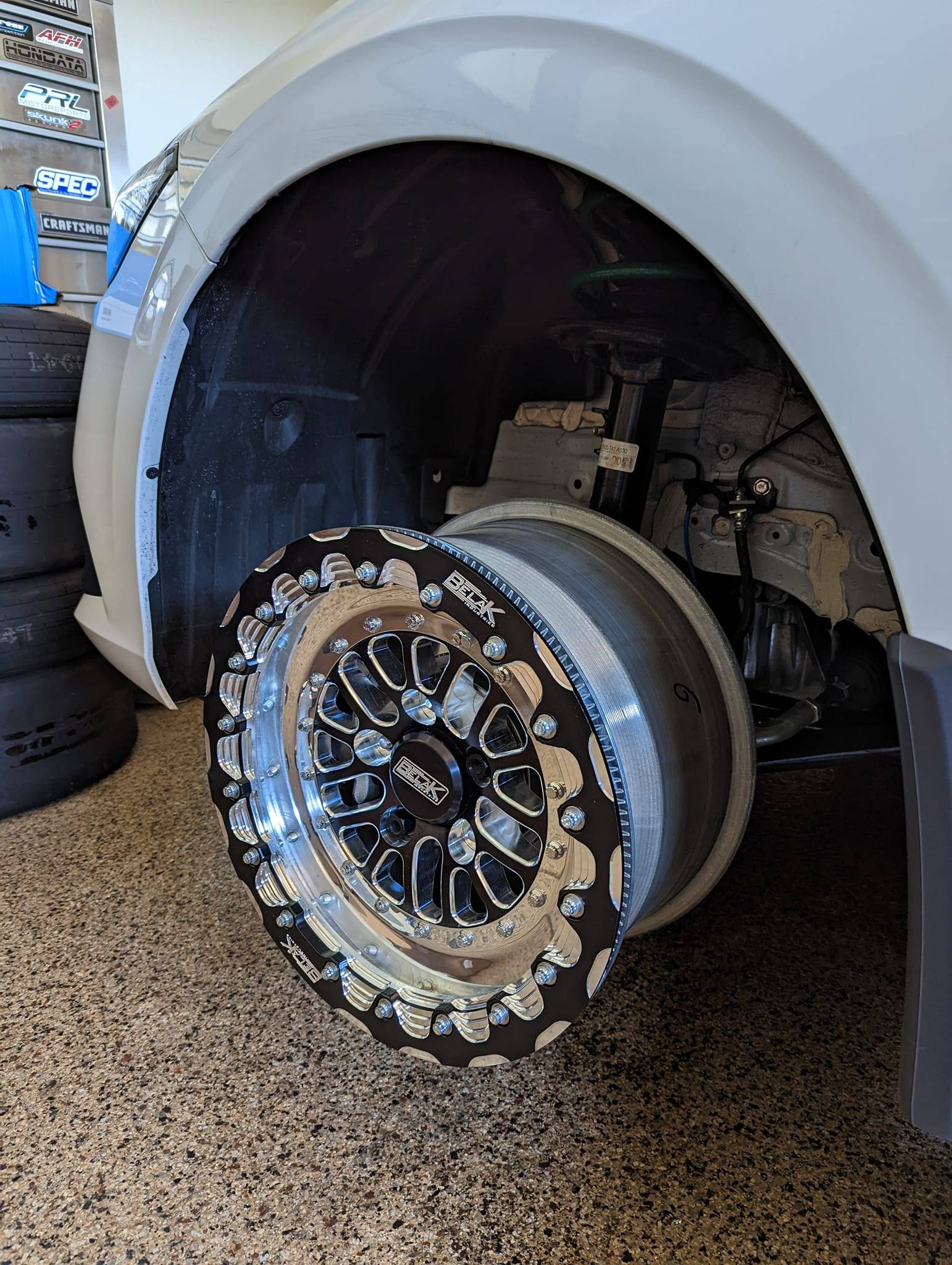

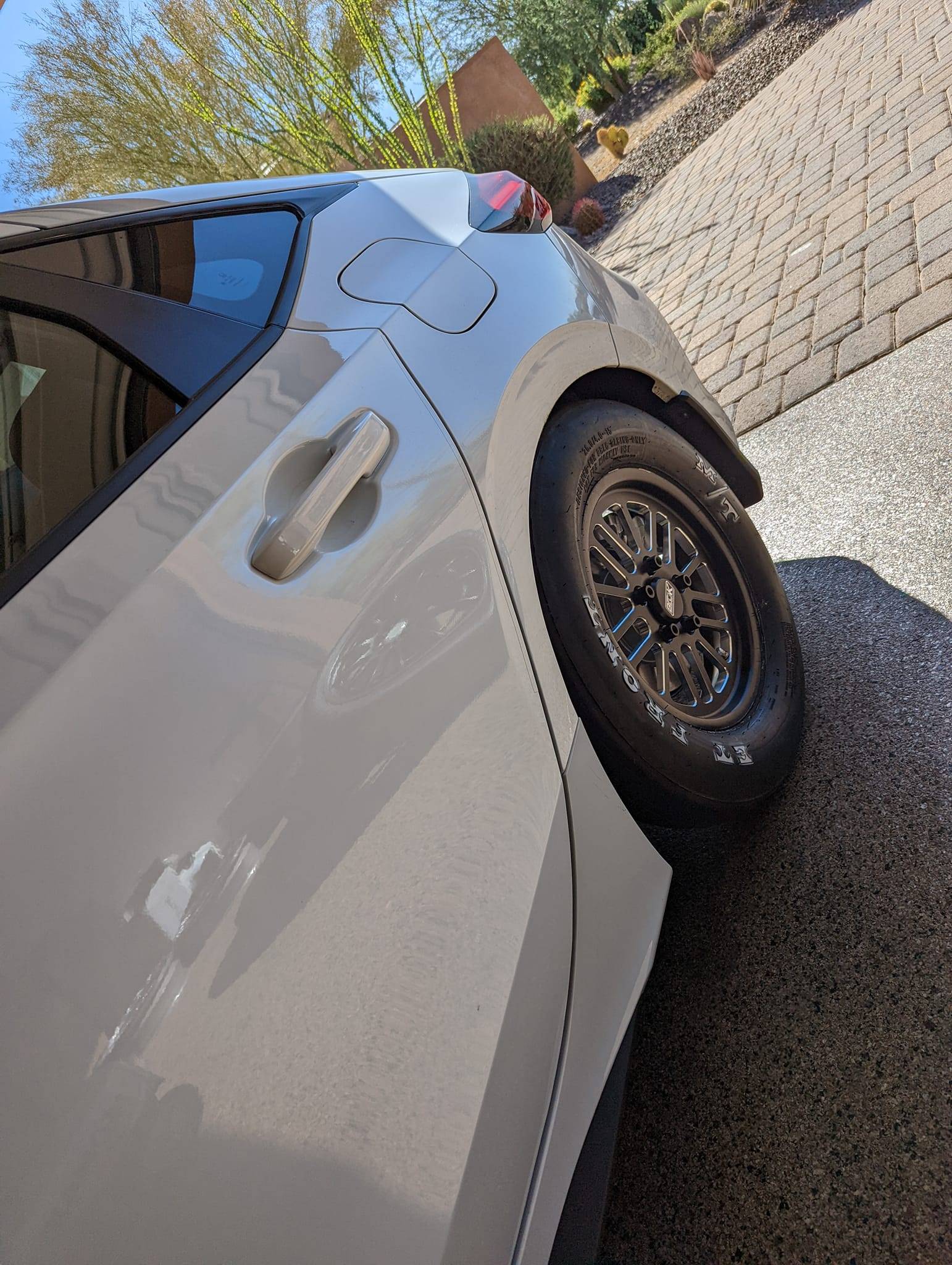

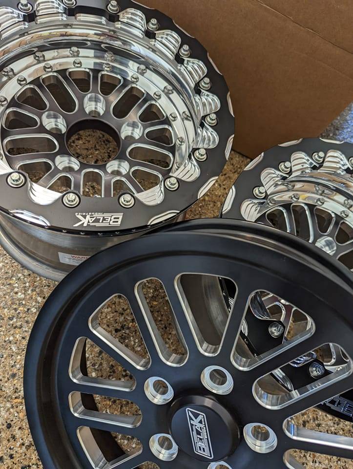

Our Belak wheels are here, just need to mount up tires and install
15x8.5 front and 15x4 rears
