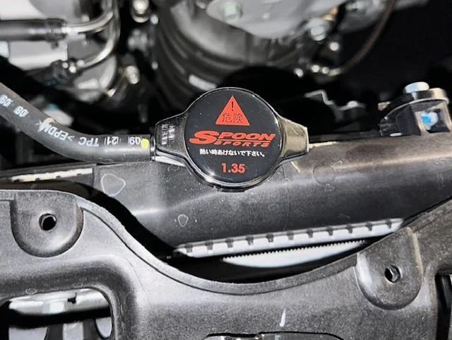

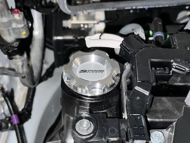

More Spoon goodies to go with the Rigid Collars. I have the air cleaner too, but never took a picture of that. Will probably get the Spoon Progressive Springs soon. Trying to decide what else I want to get that they have available and won't break the bank.
What are your opinions on the Spoon air cleaner? I was thinking the same instead of going with a full intake system to save some money, but I looked into the micron sizing and don't know if its worth risking getting extra crud in my engine.
Does it produce extra sound & power?
TBH, for the cost of the Spoon air cleaner I should've gone with with PRL HVI. It is less restrictive than the OEM air filter and because it is less restrictive it does give off a little bit of intake sounds just not as noticeable as with a full intake. I don't live in a super dusty area so the micron sizing to me isn't as crucial. You can go with a Sprint Air Filter, I found out after its what Spoon uses just rebranded with the Spoon name just half the price.

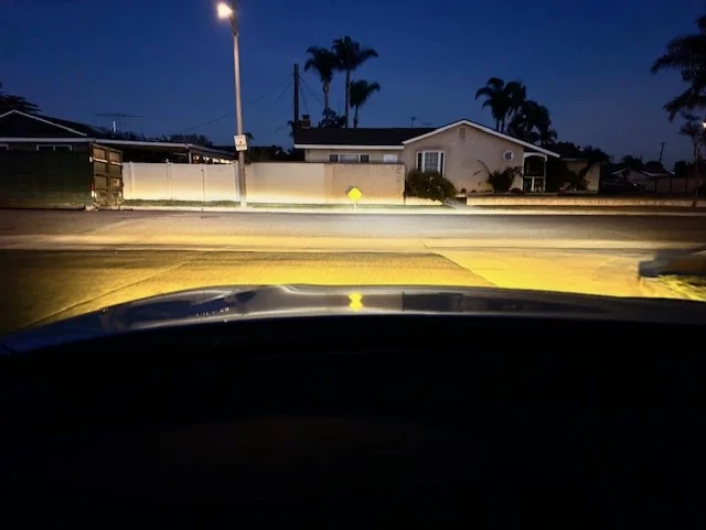

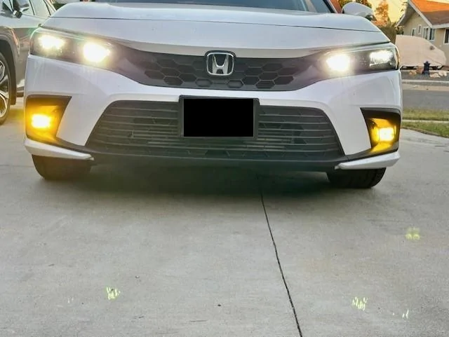

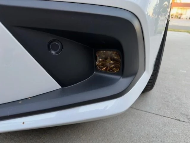

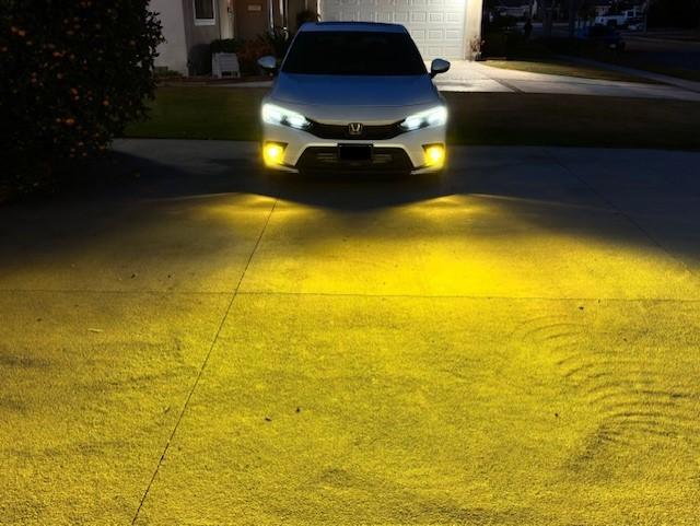

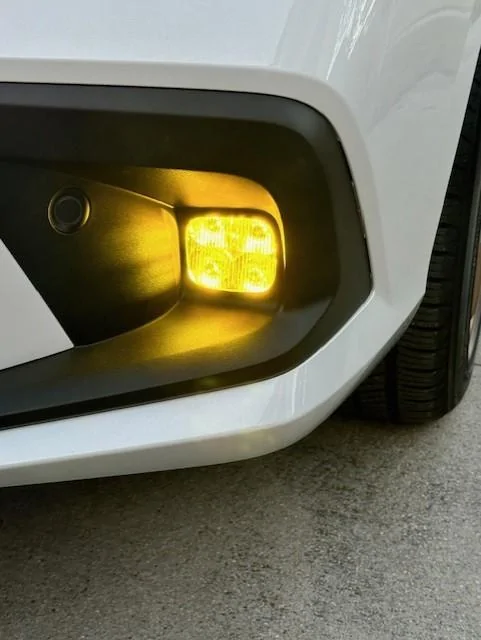

Installed the Diode Dynamics SS3 PRO LED Fog Light Kit for the 2016-2012 Honda Civic.
This was not a simple plug and play, but it was a sort of easy install and I didn't even need to take the bumper off, just jacked up the car and peeled back the fender liner.
I did have to modify the mounting brackets that came with the fog lights to fit the little post with a cross on the bumper for the factory fog lights by cutting the tab off of the SS3 brackets. I also used the harness adapters that came with the Mikstore Laser Projector Lamps. Just an FYI, the Mikstore Laser Projectors do not fit. The bolts on the sides of the lights will not fit without cutting your bumper. I didn't feel like messing with the bolts that are holding the light together and I didn't want to cut into my bumper.
Overall I think it was a worth while upgrade. Looks good, definitely better output than the OEM LED fog lights that left a lot to be desired.

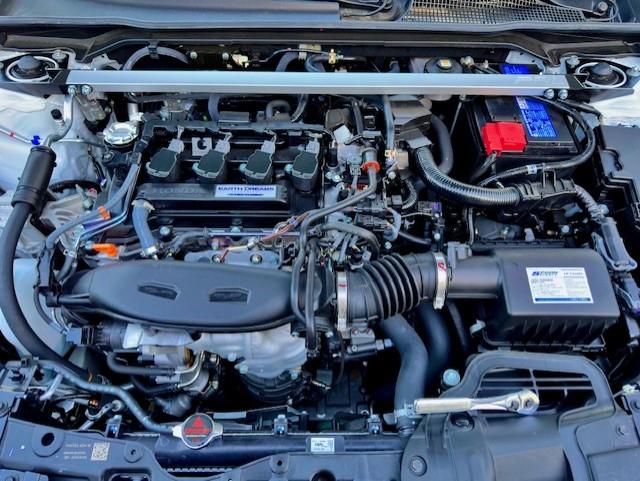

Just installed the PRL "Throwback" Front Strut Bar, I think it was the only thing I bought from any Black Friday sales.
What's your opinion on the strut bar? Have you felt any performance benefits in daily driving / spirited driving? I can't decide if I want to invest the money into a strut bar or not.
I also saw your other post where you're selling your KTuner, but if you wanted to tune your car, you mentioned getting an intercooler and charge pipes earlier in this thread. I'm planning on mildly tuning my car (no serious power gains), and intercooler is #1 mod on the list because this car gets so hot. I've read around the net that intercoolers don't really cause any turbo lag, but that charge pipes do so I wasn't planning on buying them. Just wondering what your opinion on charge pipes was and why you were considering them. Maybe your input can help sway me to buying them.
With the strut tower bar, I do feel that the front is slightly stiffer and a little more responsive and planted when taking turns. Was it a huge difference, no, but there is a difference. I do feel like my Spoon Rigid Collars had a bigger change to my suspension than the strut bar did, but it looks good under the hood so there's that lol.
I'm just not using the KTuner right now and feel like its better off in the hands of someone that's gonna put it to use with their modifications. I'm enjoying the car as is power wise, I'm mostly concentrating on handling and suspension at the moment.
I may tune later, I may not. If I do I may go the Hondata CARB route or wait for COBB as they just released their Accesport for the FK8 and said they will be releasing one for the 1.5 in the future as well as the 11th Gen. Also being in California I really prefer to have that CARB EO# to not have any issues if they were to arise.
I had an upgraded intercooler on my 10th Gen with the stock pipes. Personally I think its fine with the intercooler alone. Would it help to have the charge pipes, sure, but I had the stock turbo and didnt find it necessary and just the intercooler alone I saw anywhere from a 10 - 20 degree drop depending on the day compared to the stock cooler. If you're going to tune as well, I'm sure the turbo lag won't be an issue. Plus, you can always buy the PRL intercooler, and decide to upgrade and get the piping later on.
These look great! Can you share any info on how and where you wired them, as well as what other items needed to be purchased (wire taps, etc)?
Thanks!
The wiring part was kind of easy. I did not have to tap or splice anything. I had originally bought the Mikstore Laser Projectors fog lights, fortunately/unfortunately those fog lights did not fit. The Mikstore fogs did come with adapters to plug their fog lights into the OEM fog light harness. I was able to use those adapters to plug into the Deustsch adapters on the Diode Dynamic fogs. I'm not sure if Mikstore sells the adapters separate, you can probably contact them and ask.
If they don't sell them separate you probably need some H11/H8 2 pin adapter to whatever the plug is for the OEM fog light's harness.
ok that makes sense. I have an Si so I wont have the existing fog light harness. thanks !
Mikstore does sell fog light kits for 11th Gen Civics that do not come standard with them that people have successfully installed. Might be something to checkout for yourself.
