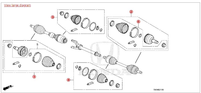

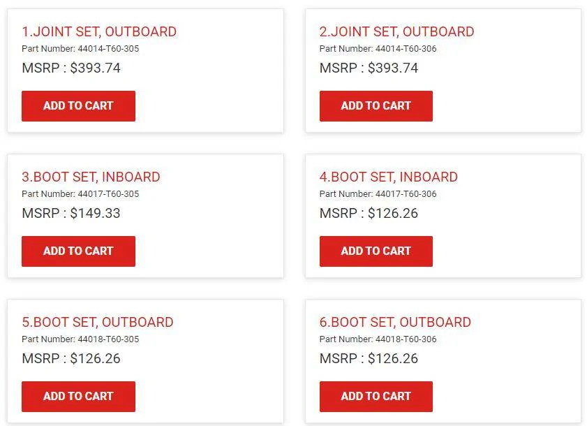

Had the same thing happen on my Si when I tried to do a spring swap. Boots can be had separately but they might be on indefinite backorder. I was told they had been backordered for 2 years with no idea when they would be available as a piece so I had to buy an entire axle.
11th Gen Honda Civic Axle or axle boots ? 1727120363519-om
11th Gen Honda Civic Axle or axle boots ? 1727120380347-dk
