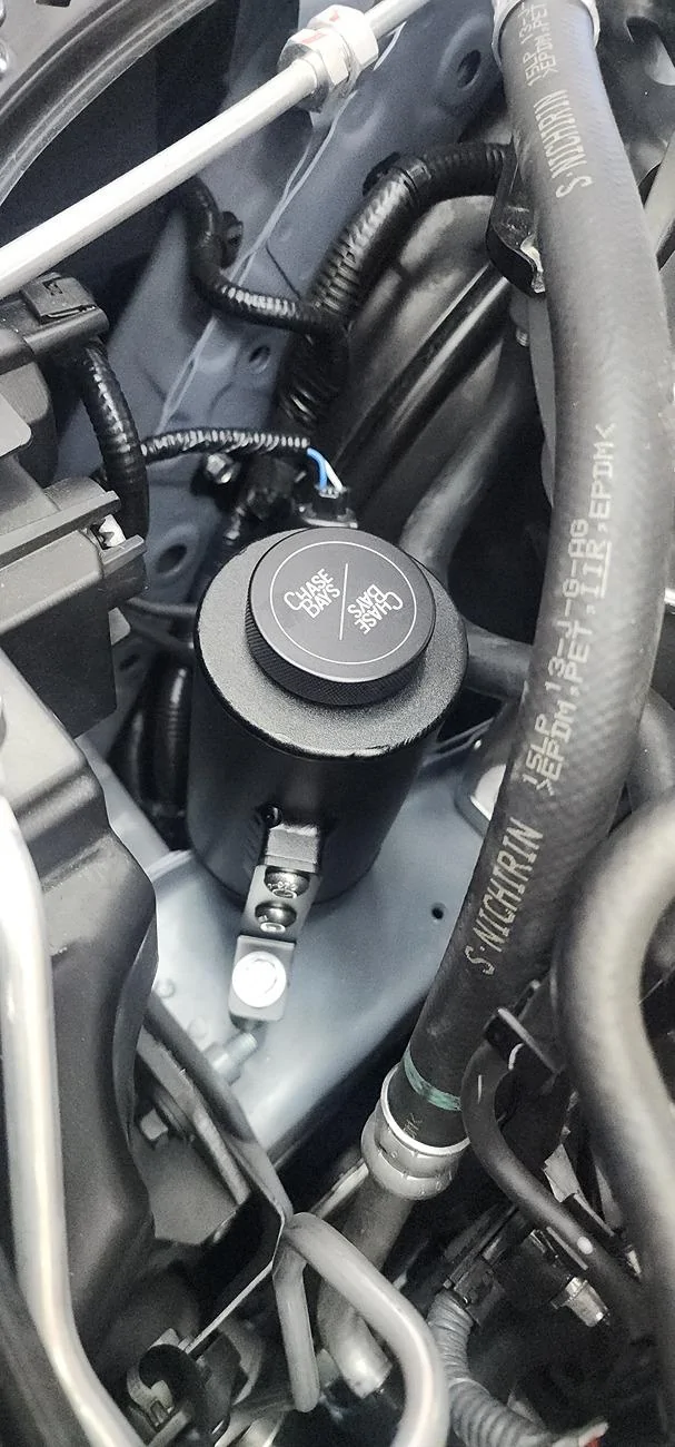

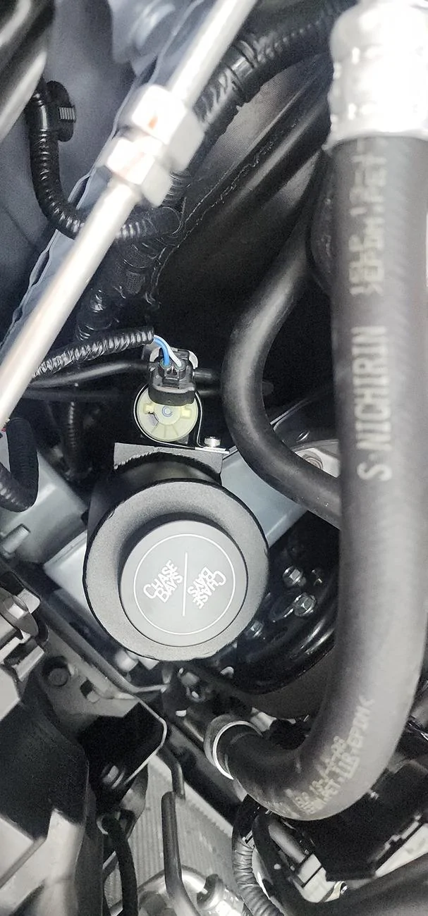

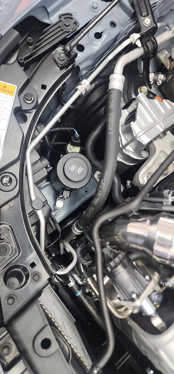

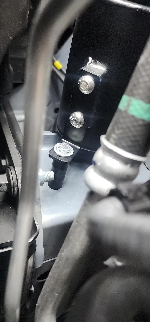

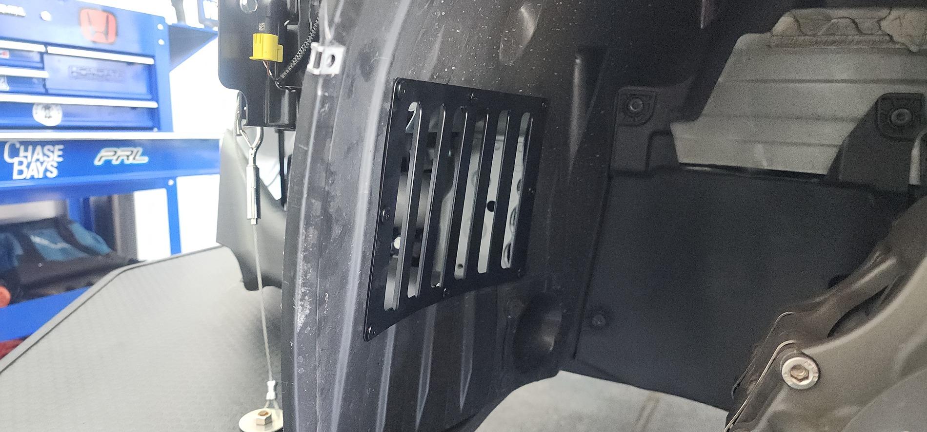

Follow up on the dual oil cooler set up.
This chase bays washer fluid reservoir replaces the OEM washer fluid reservoir since it has to be removed to create space for the passenger side oil cooler.
It works well with the OEM pump and retains full functionality. Had to wrap the intake nozzle on the pump with 1 wrap of silicone tape so there was no gap between it and the grommet, but seems perfectly sealed with no leaking to this point.
Also the bracket (#4 of the options they have available) required some spacers under it to work in this location, but yeah, it's rock solid, looks great, and works like OEM.
Should have the last few remaining pieces by the end of next week and the dual oil coolers will be in and ready to test on the street in the 104° weather we're supposed to have.
