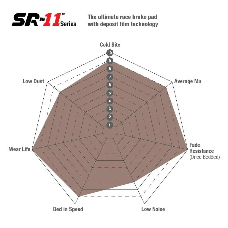

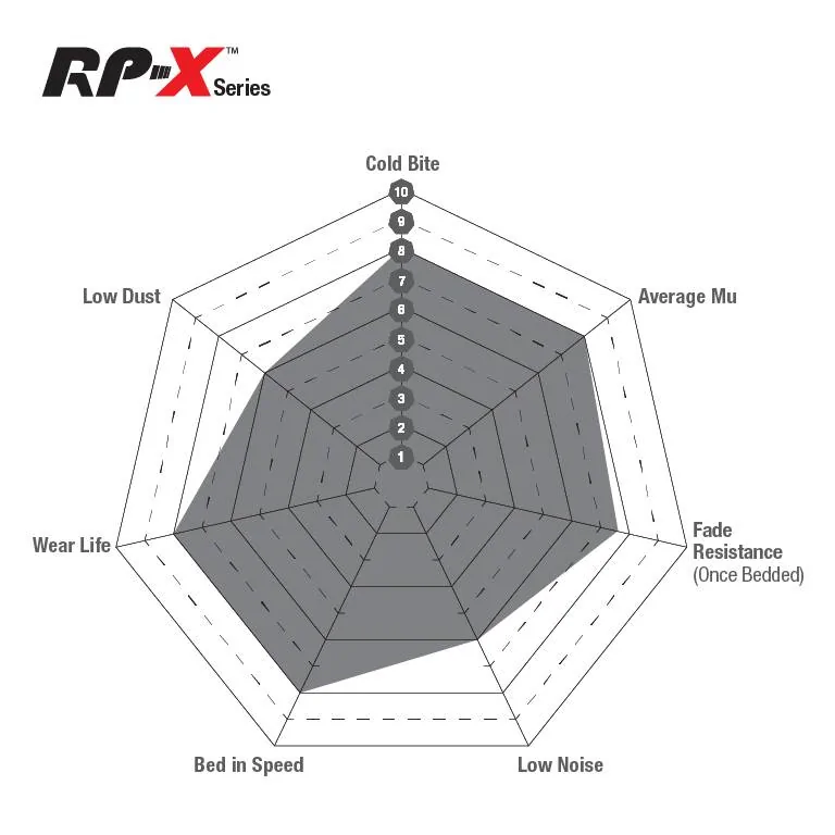

Are these any good on the road or do they need to be warmed up to get some bite? EBC is a UK brand (where I’m based) but the SR range are made in the USA. Did you consider the RP-X range at all?

Mine have been great on the street even in winter months. No heat needed. I liked the lower dust and longer life of the sintered pad. Plus no crazy bedding process for them to mate with rotors. Cost was a little more for the sr11.

I use my SR11 daily but I don't drive that much. That said, the dust is not bad at all, they are quieter by a long margin than the paragons I had, the bite is immediate even when cold so for me they are a all year pad. Also from what I read from the EBC literature (take it with a grain of salt cuz they want to sell the thing) it is easy on the rotors, it adds a layer to the rotor and in some cases your rotor actually measures out thicker.
I need more time with them, only have had 1 track day and a few hundred miles but so far so good. And yeah we are in the US, you can run paper mache as brake pads and no one cares, I know in some places in Europe certain compounds are not legal to run and I this is one of them because track use only but pretty sure neither is the RPX

I have only used them with 200tw tires so can't comment on using them with ps4s. They do have a big initial bite, they are not for everyone, some people prefer a more progressive pad. They do modulate better once they are hot but when cold they are a bit more on/off. I was looking for a pad like a ferodo 1.11 without paying $650 and these do the trick but if you like tons of modulation then maybe these are not it.
I bought mine from CSP racing
