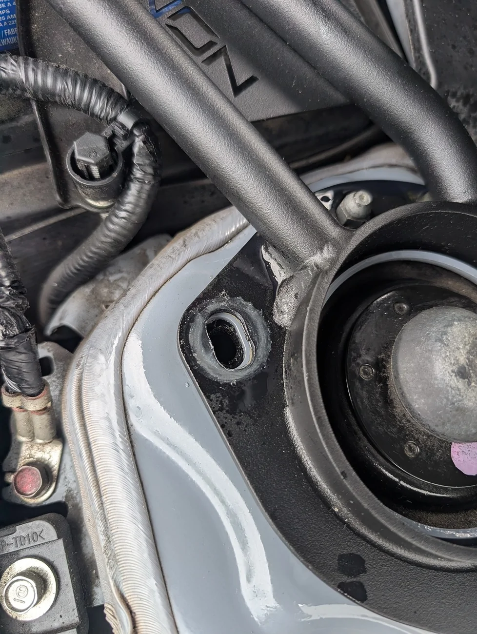

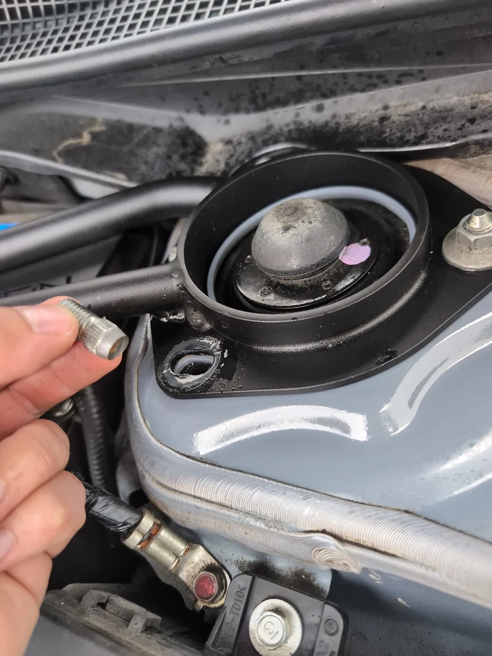

Hi everyone,
I bought a strut bar from 27won and unfortunately during the install, I snapped a strut tower bolt. I was wondering what do you guys think would be the best way to proceed with the repair? I have not taken anything apart yet.
Fun story: A month ago I snapped two studs on the turbo / downpipe connection I'm sick of snapping stuff 😭
Edit: I followed the manual for the install, it said to torque these to 53-55 lb-ft. The bolt snapped way below that torque, I think it would've broken on its own.

If that happened to me, I would replace the strut mount assembly. I never seen that stud sold separately.
How the stud looks from underneath

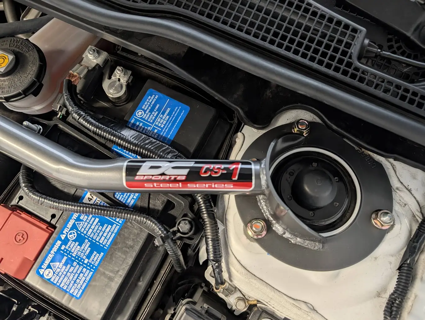

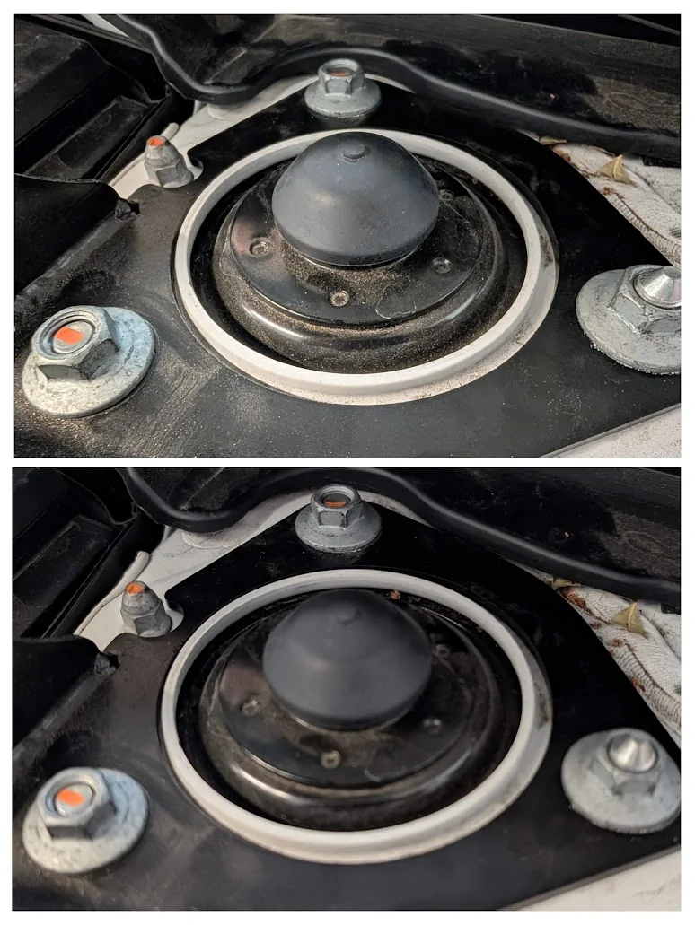

I had a PRL and DC Sports bars. I didn't like how the nuts didn't thread all the way. Below is a photo of the PRL bar on my car. Now I don't have any front strut bar. FL5s have longer studs, so this not an issue.
11th Gen Honda Civic Broken strut tower bolt, best way to repair? 1786911697677-t5
The DC Sports bar came with new nuts and sat flush. Interestingly, the DC Sports strut bar instructions states 32 lb ft.
