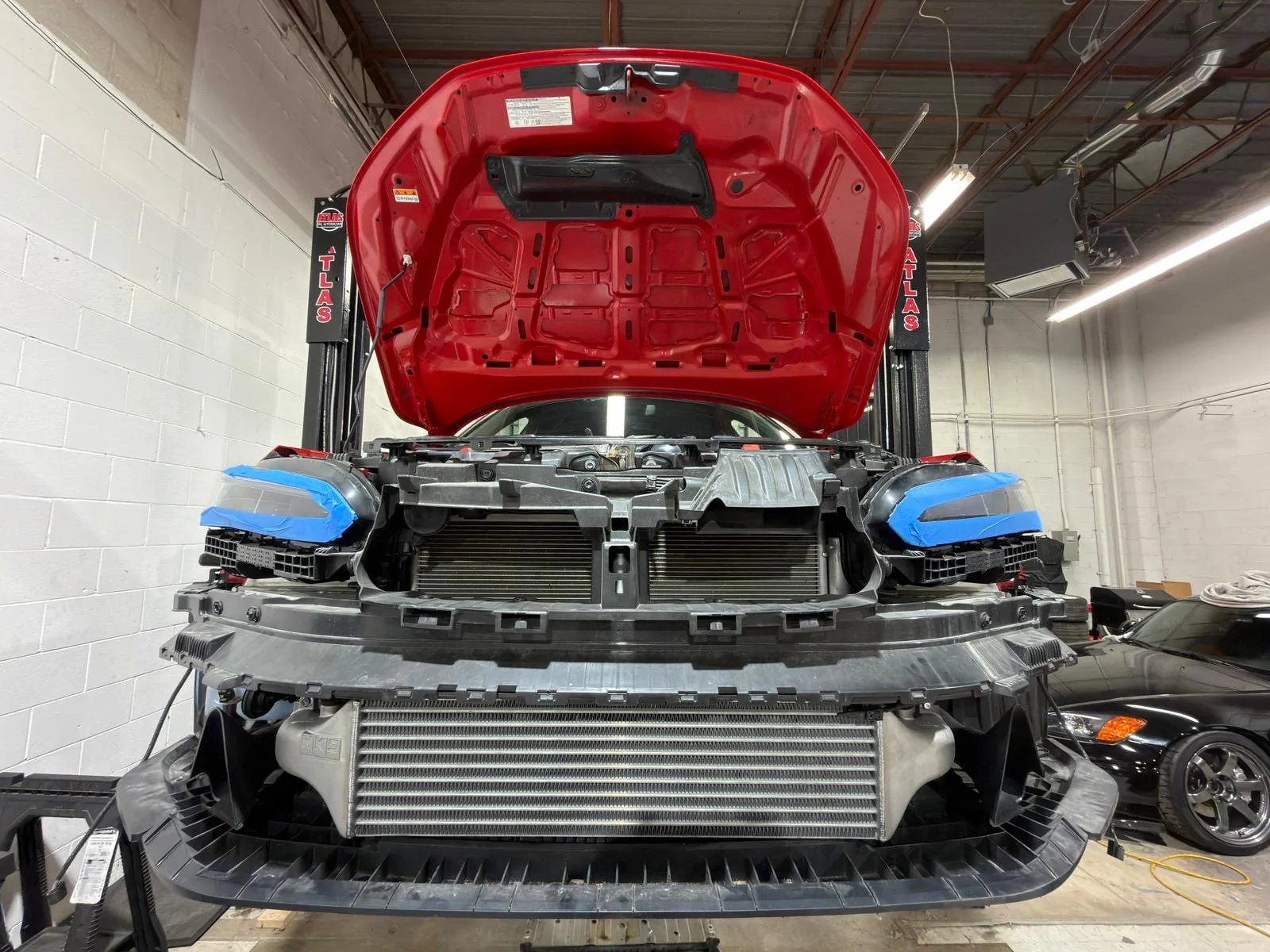

I don’t have pictures of the charge pipes on my phone at the moment, but we did install the HKS Charge Pipes along with the HKS Intercooler on our Red tester car.
HKS Charge Pipes are easier to install on the FL5 than they are on the FK8 since there’s more room in the engine bay, especially at the front. So far there’s 9 customers of ours with full kits over the last year, and I haven’t had any emails come my way saying they’re experiencing any fitment issues or boost leaks.
