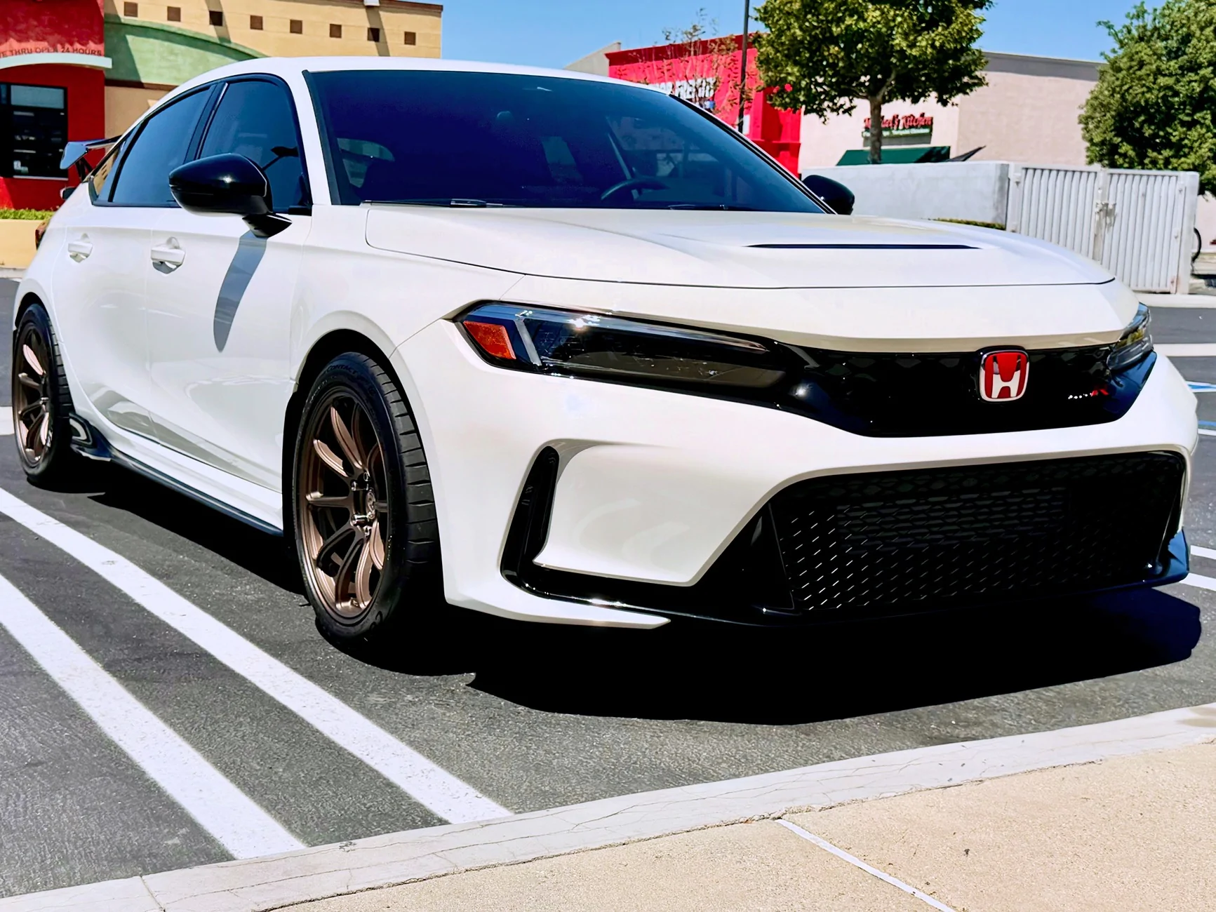

Those rims are super nice, curious why you switched to Akebono pads from the Dixcel's?

I switched to the Akebono because I was getting a little bit of brake squeal in the rear brakes, saw that the shims on the Dixcel pads were all chewed up and decided to switch them all out. The shims on the Akebono pads are metal.

Thank you, that's good to know as I was considering the Dixcel but I'll probably just go Akebono.
