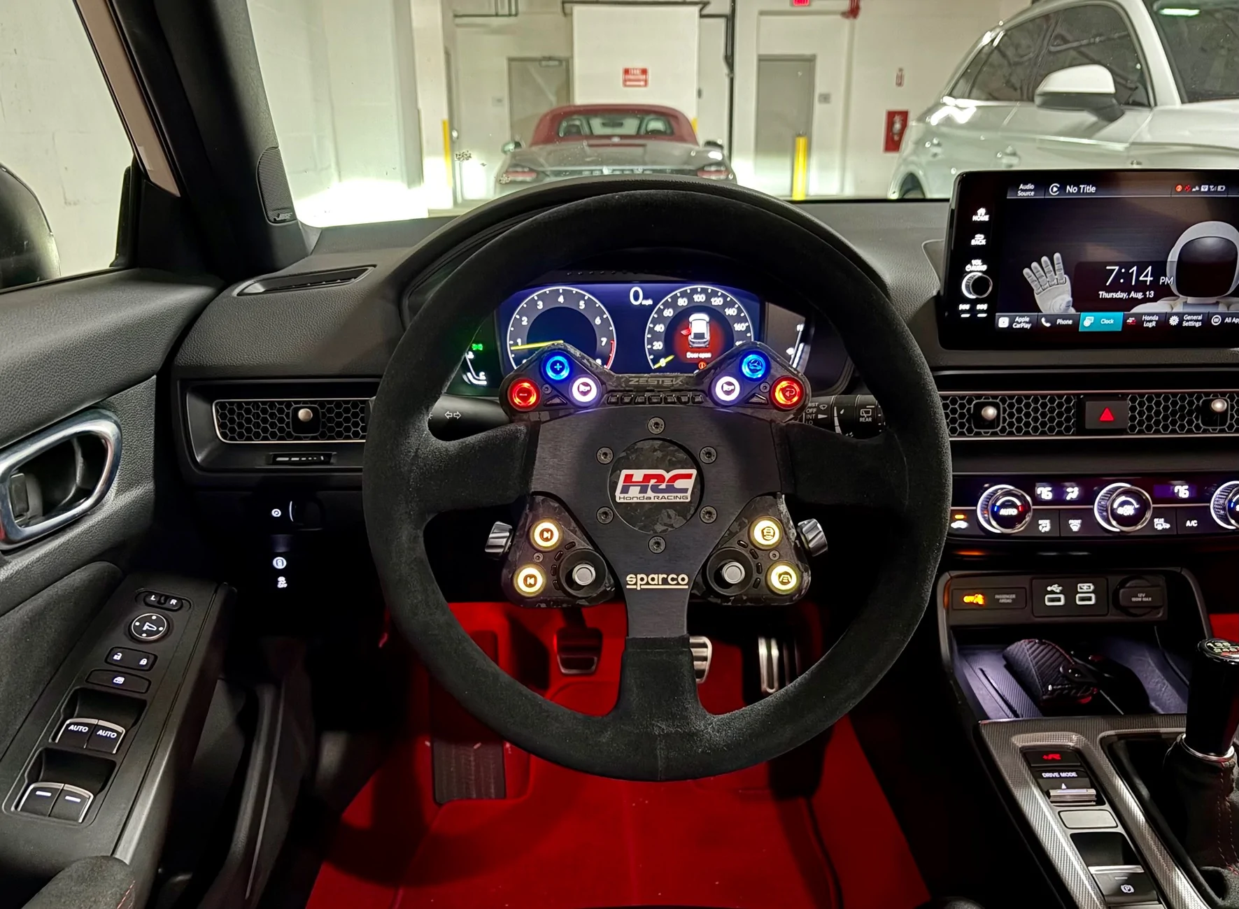

Zestek
With a generous discount from Zestek, I’m happy to finally have a proper racing wheel and quick release hub in my FL5! The install was pretty easy, just had some trouble removing the factory airbag. So far I’ve had the hub system installed for about two weeks and everything works as expected. However I do have to mention, if you live in a hot environment with high humidity the quick release mechanism does tend to get stuck. I have spoken to others who have the same mechanism and they have reported the same issue. Other than that I’m extremely happy with the system.
I had setup the RPM indicator which is helpful as sometimes the steering blocks the factory light indicator given I sit significantly lower then stock and I have the steering stalk as low as it can go. Another point I would like to add is that I had initially installed the hub system with a Sparco wheel that was 330MM however I did not like how it felt driving around town. It felt a bit too small given how big the car is inside. So I went and ordered a Momo Corse 2.0 in suede which is 350mm and feels better in my opinion.
Finally just this past weekend I completed a full track day with the wheel and I can say it does provide you with more feed back and more information to your hands which I really appreciate.
Enjoy the following pic and install video!

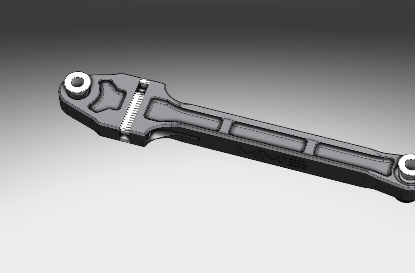

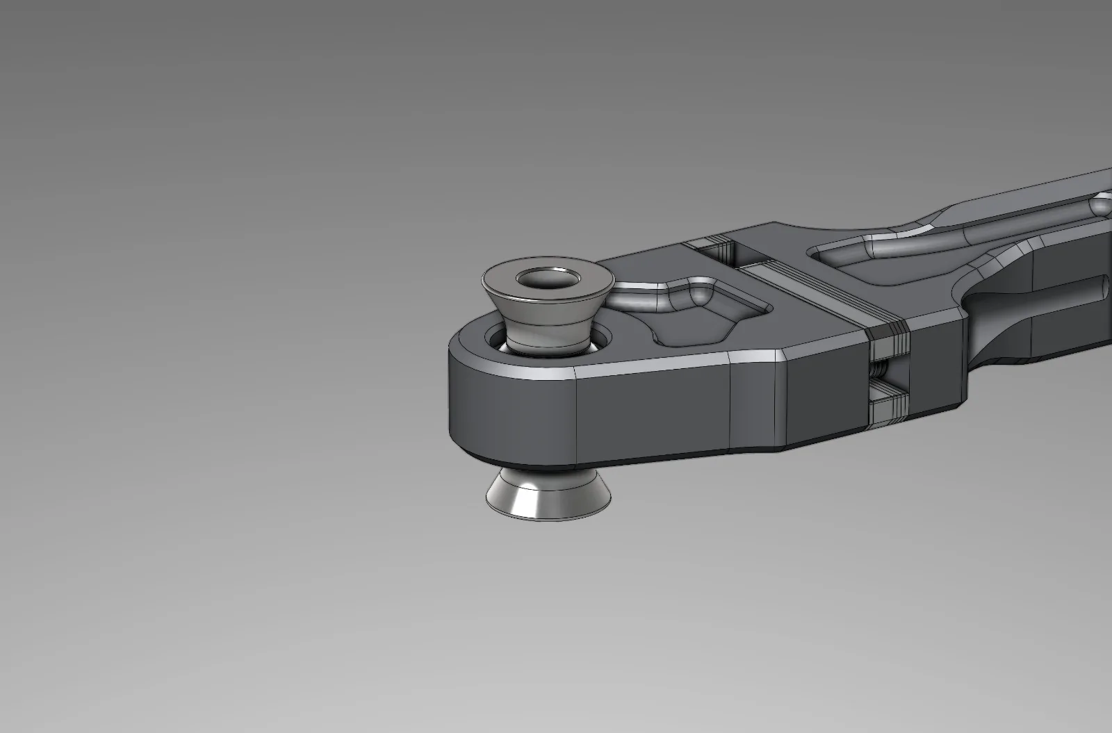

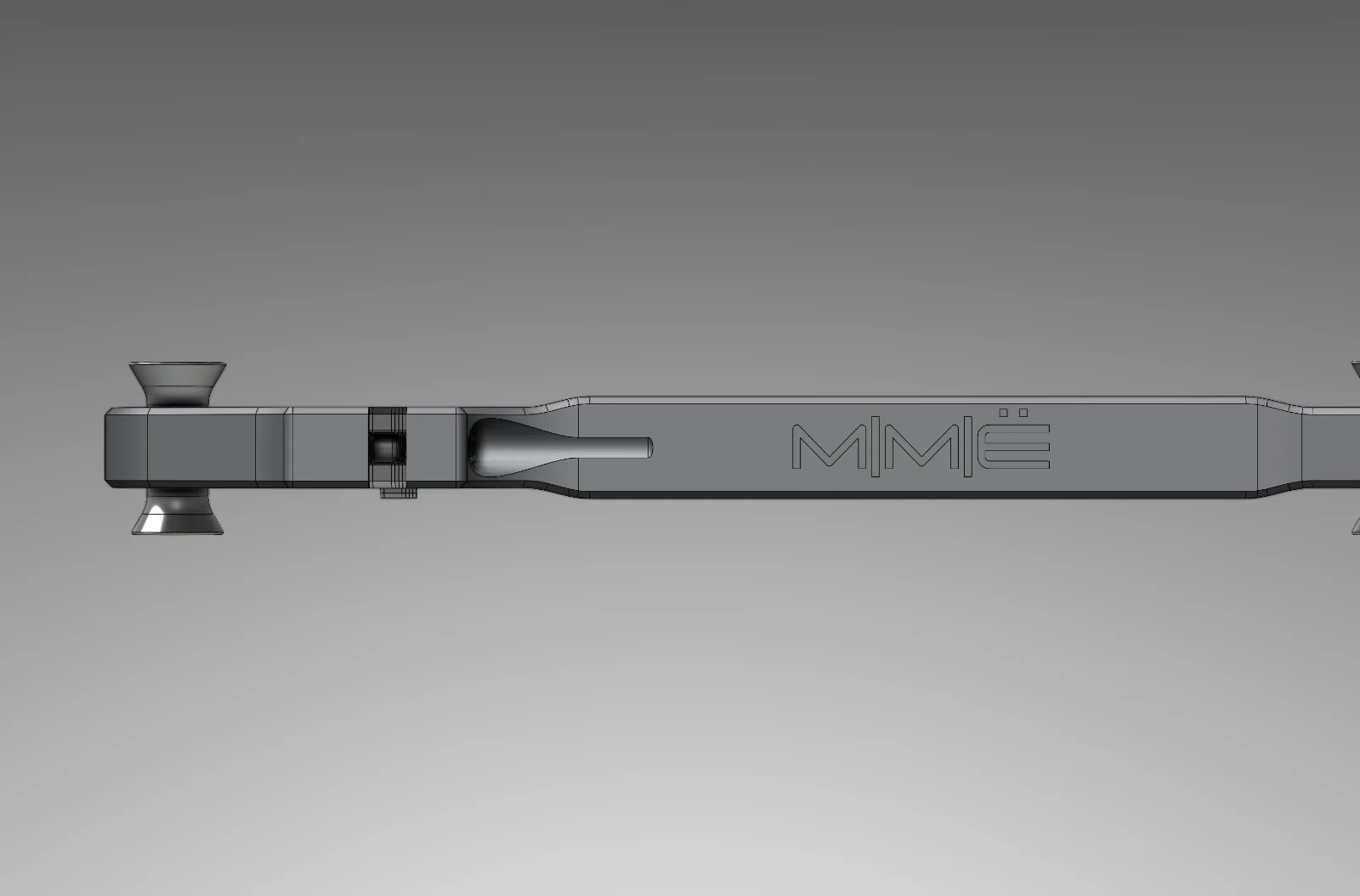

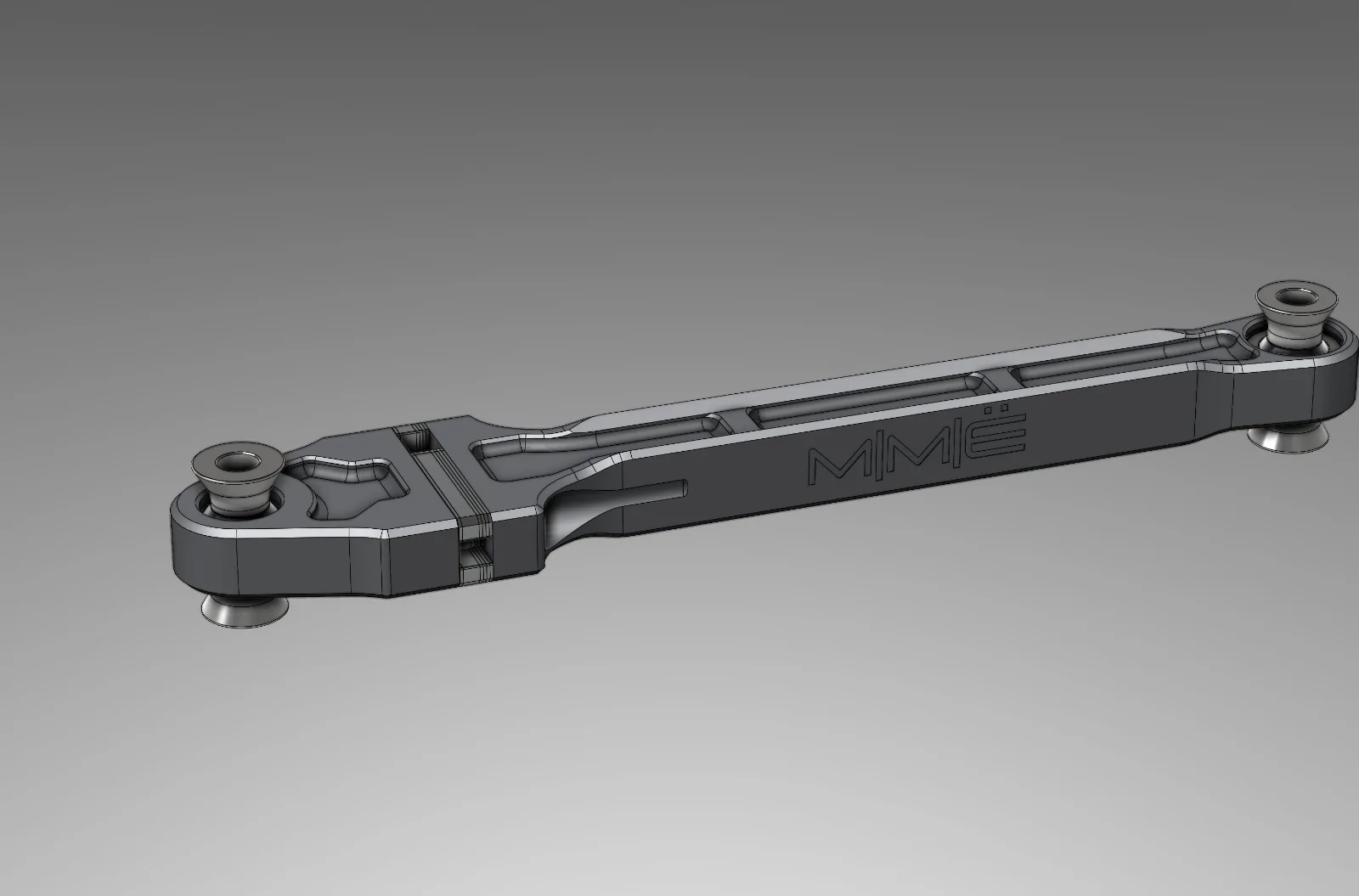

Just in case any of you have missed my post in the "Suspension | Chassis" sub thread Club-Version x M|M|E Shim-Adjusted Rear Toe Arms, I have partnered with M|M|E to help develop true motorsport suspension arms for the FL5/FK8/DE5 chassis. The arms are aimed at true motorsport track and autocross enthusiasts and are inspired by the FL5/FK8 TCR race cars which use shim-adjusted arms. We are starting off with development and testing of the rear toe-arms followed by the rear camber arms which will also be shim-adjusted.
To begin production and continue testing, we need at least 10 reservation orders. We will make the final production decision on Friday, October 16, 2026. If at least 10 reservations remain active on that date, we will move forward. Reservations withdrawn before the deadline will not count toward the minimum. If fewer than 10 reservations remain, we will either proceed with production or automatically refund every deposit, and we will notify all participants of the decision.
Please find the reservation link below with more detail information regarding material choices:
MEISTERSCHAFT MOTORSPORT ENGINEERING / RESERVATION
Most adjustable toe arms are threaded: turn the rod end, lock it with a jam nut. The setting is held by thread friction and the clamp of that nut, so it depends on correct torque and on counting turns to keep both sides equal. The rod ends also have to be clocked so each ball sits in the middle of its travel before the nuts go tight. Lock one at an angle and the bearing runs against its limit, binds, and wears out early.
This arm sets its length with a stack of shims clamped between the arm body and the bearing end. The length lives in solid metal and the bearings are pressed in at a fixed angle, so there is nothing to clock. Each shim is a fixed step, the same stack gives the same length on both sides, and a setting can be changed and put back exactly without an alignment rack.
Enjoy the following renders of the Toe Arms and please reach out if you have any questions!!
