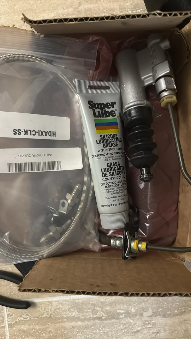

i strongly suggest making sure you are using the right lube... this stuff is great for this. feel free to look it up - this one is 92003
11th Gen Honda Civic Clutch Squeak/Creak from Engine Bay 1778356500286-z
I’ve got plenty of super lube (great stuff) but gonna use Honda high temp urea grease
