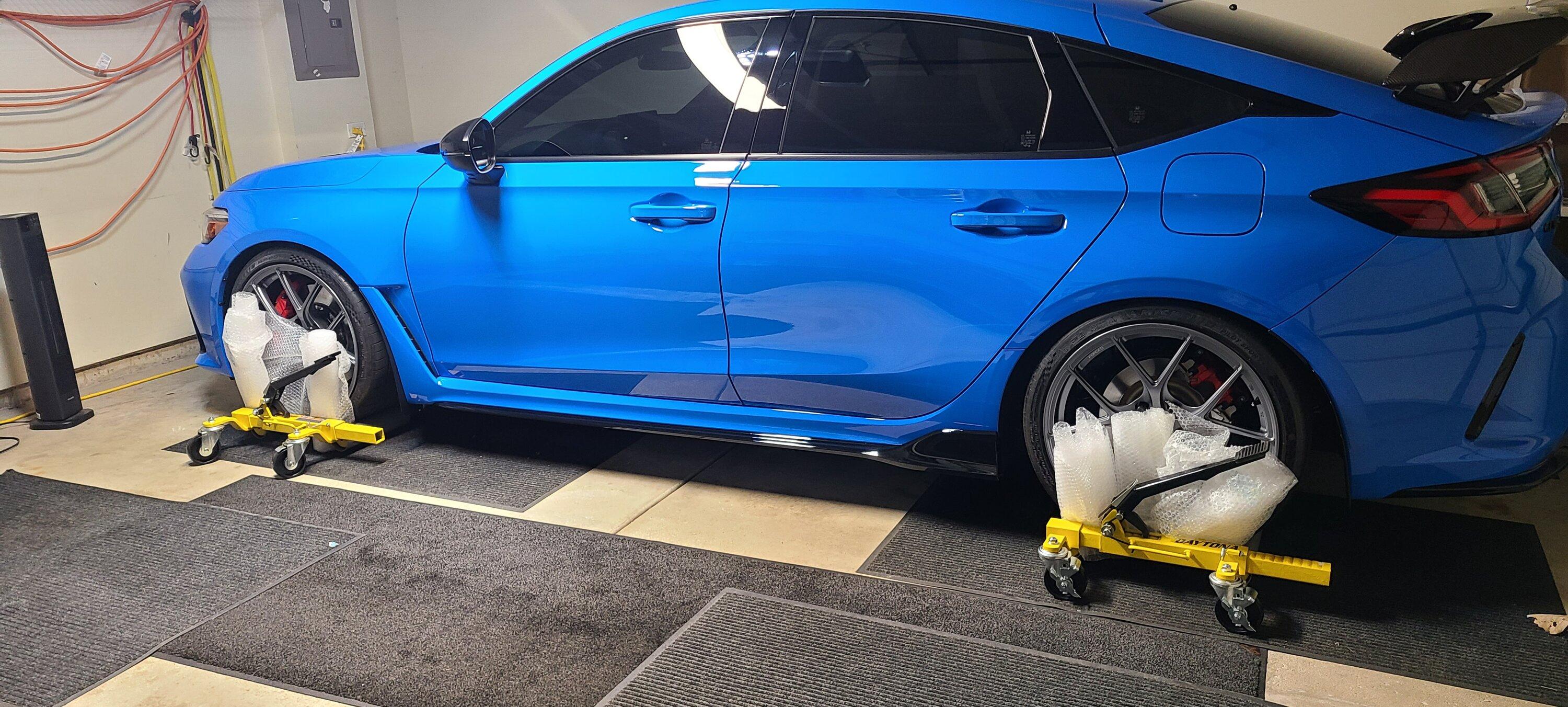

Winter hibernation minus the bubble wrap that's my OCD shining through..lol and the cover, and its been a week and I want to say fuck it...and drive...
11th Gen Honda Civic Cold winter storage of Type R and PS4 tires? 20231120_152750
