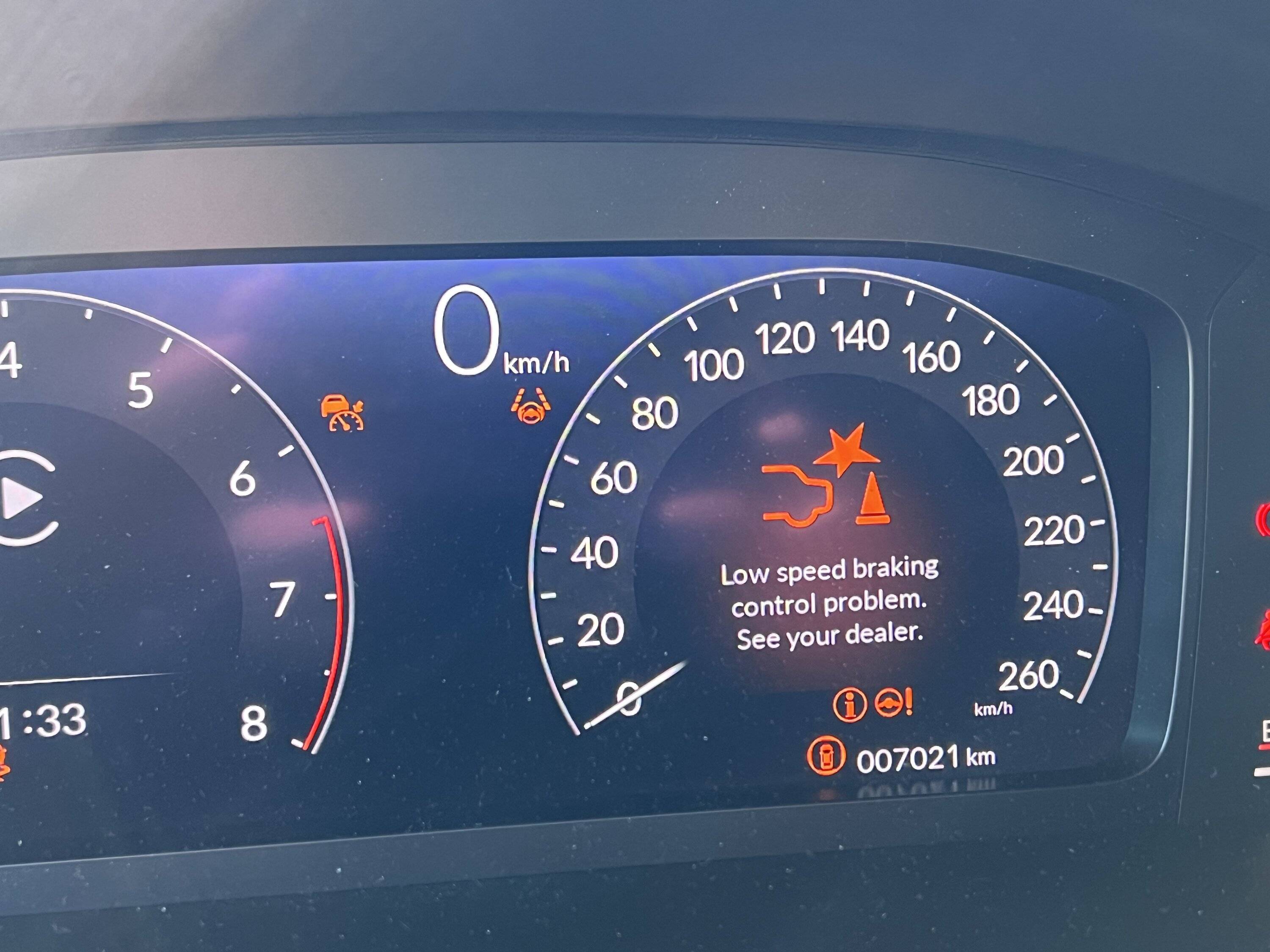

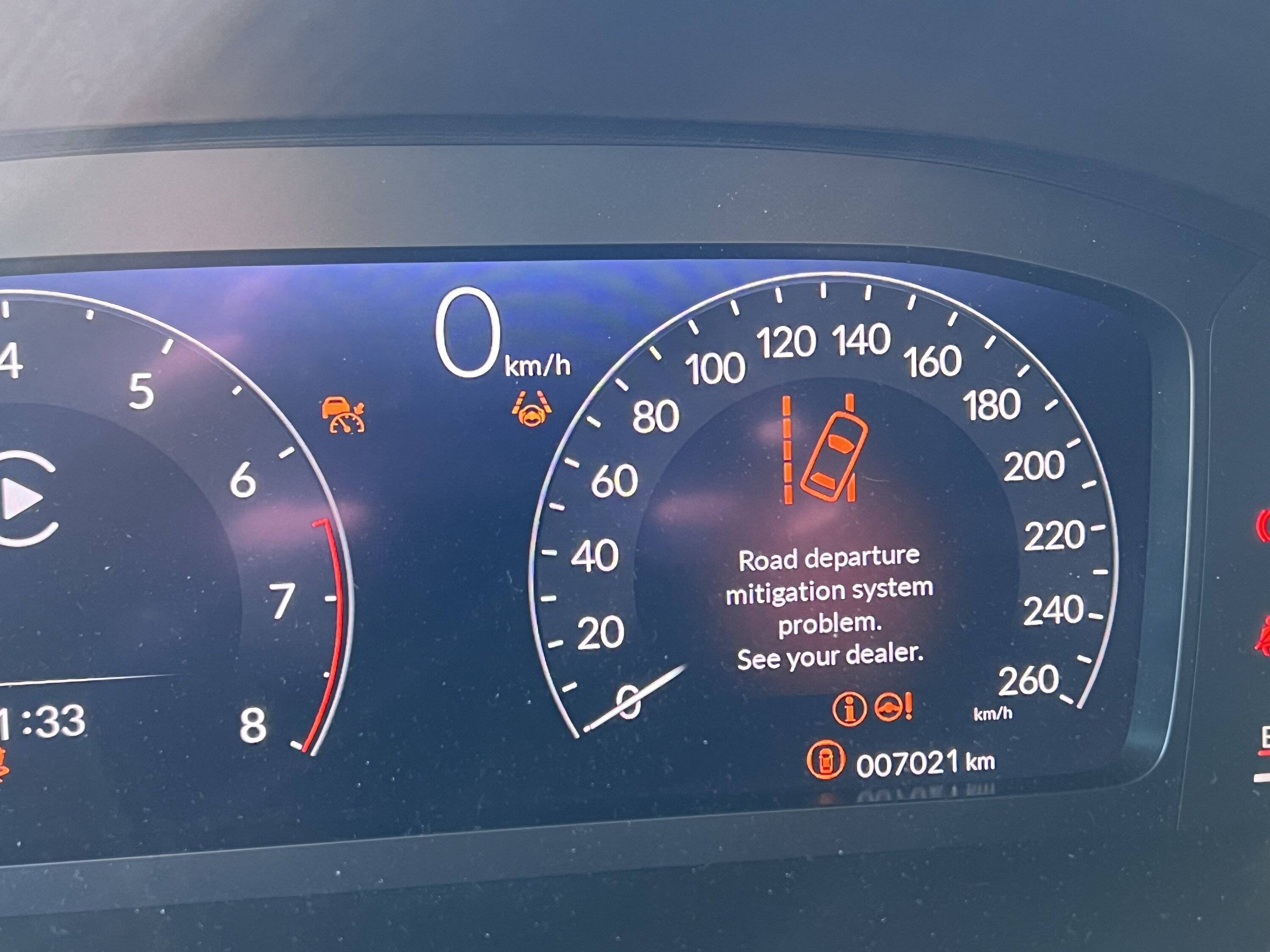

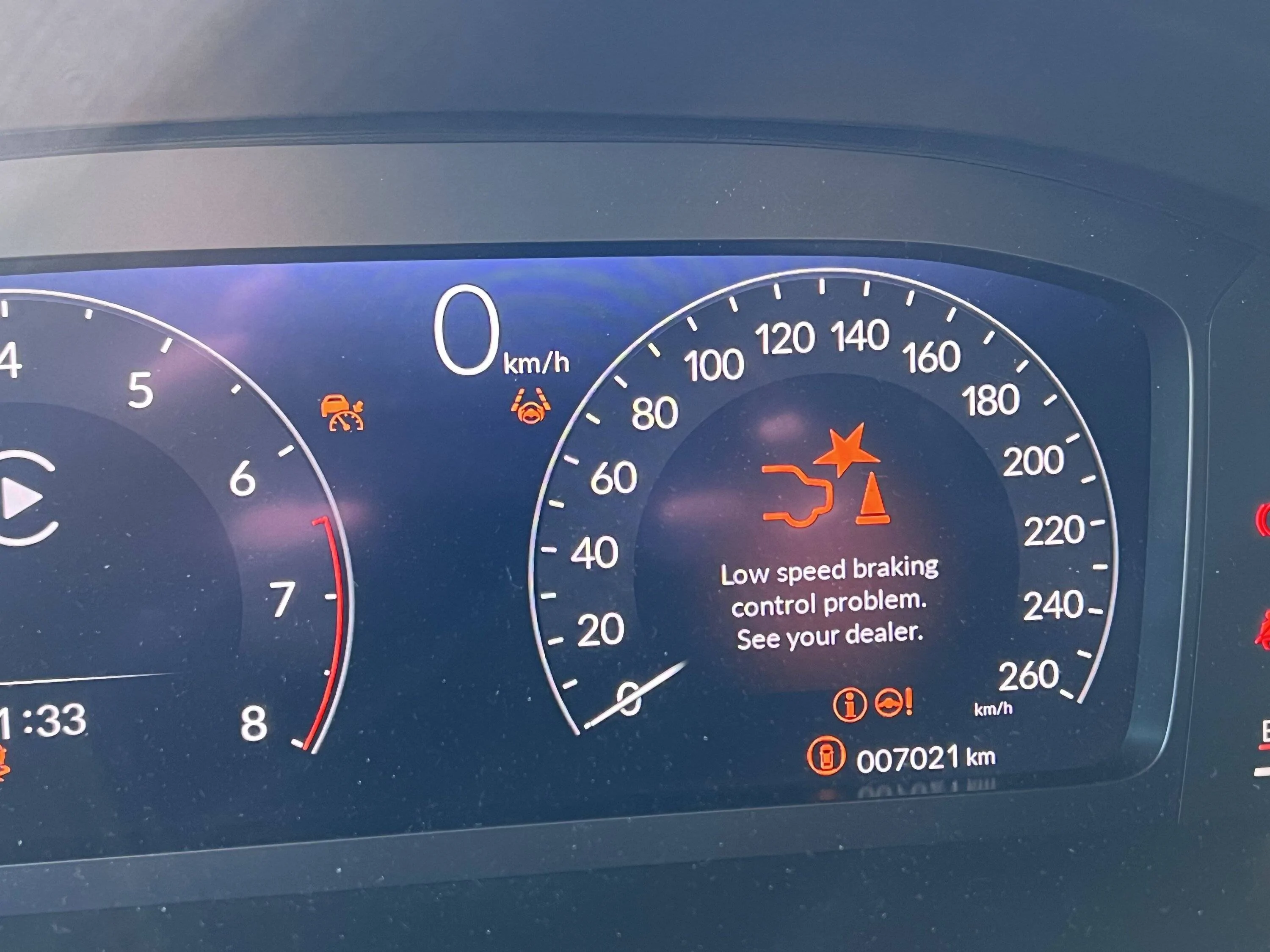

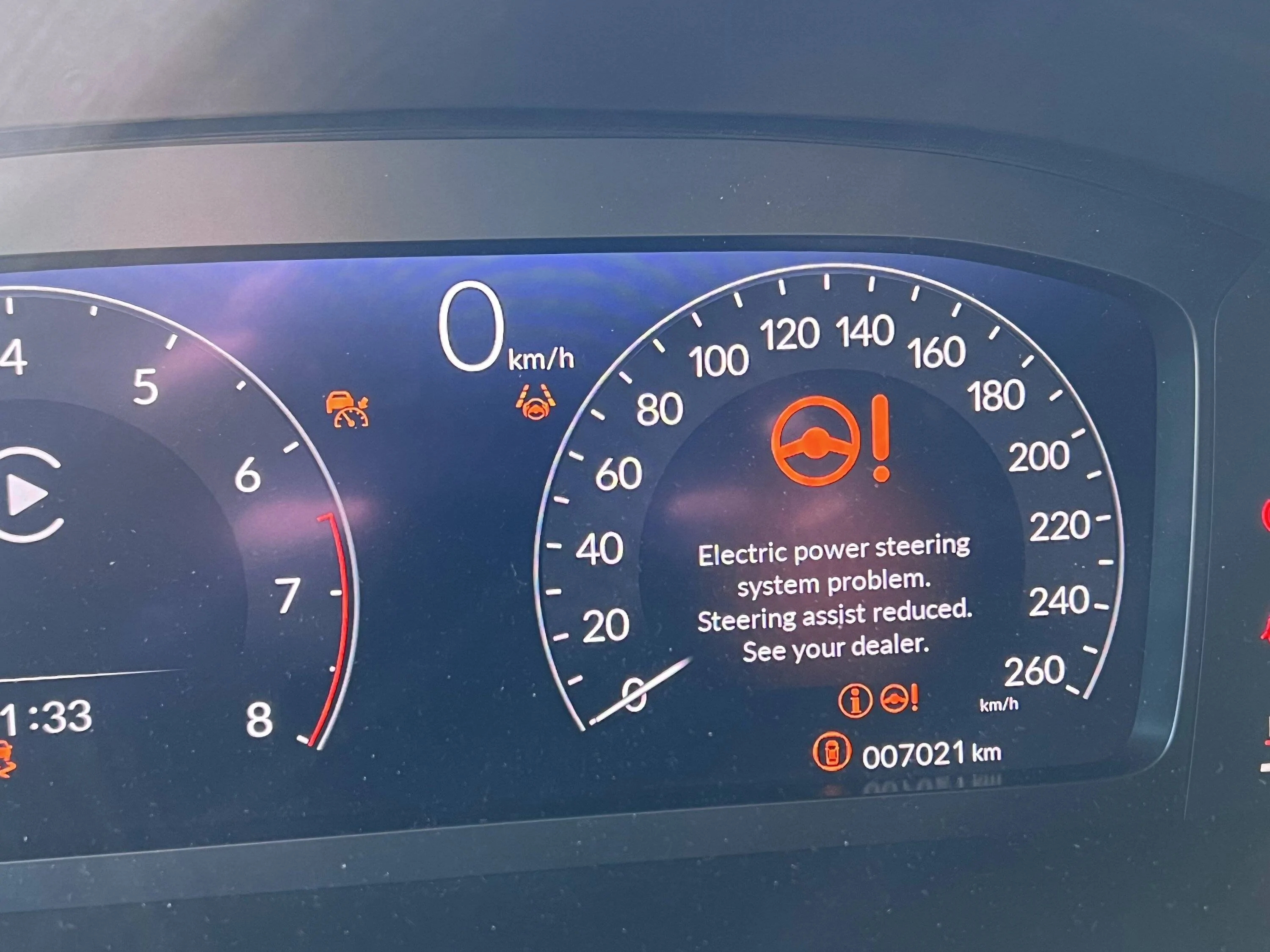

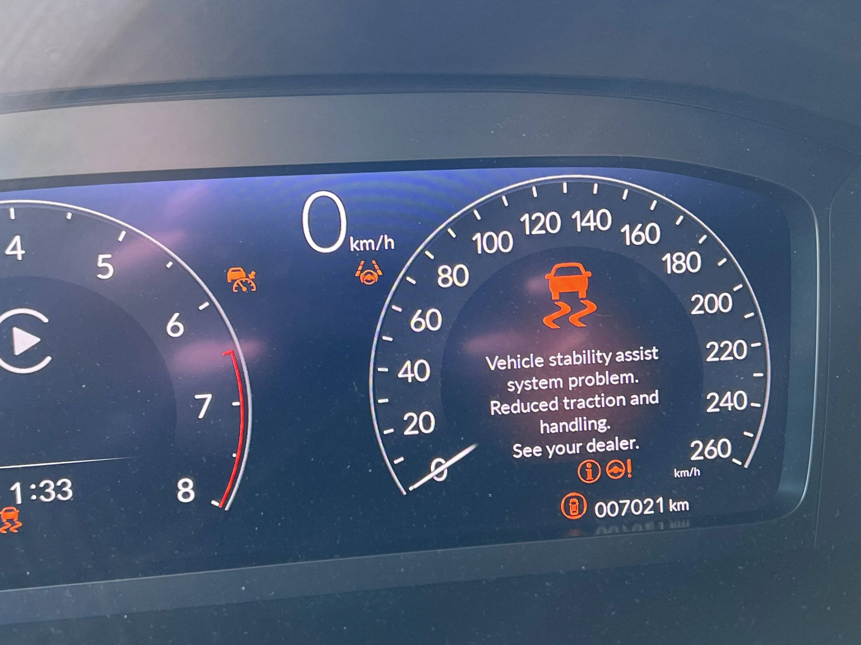

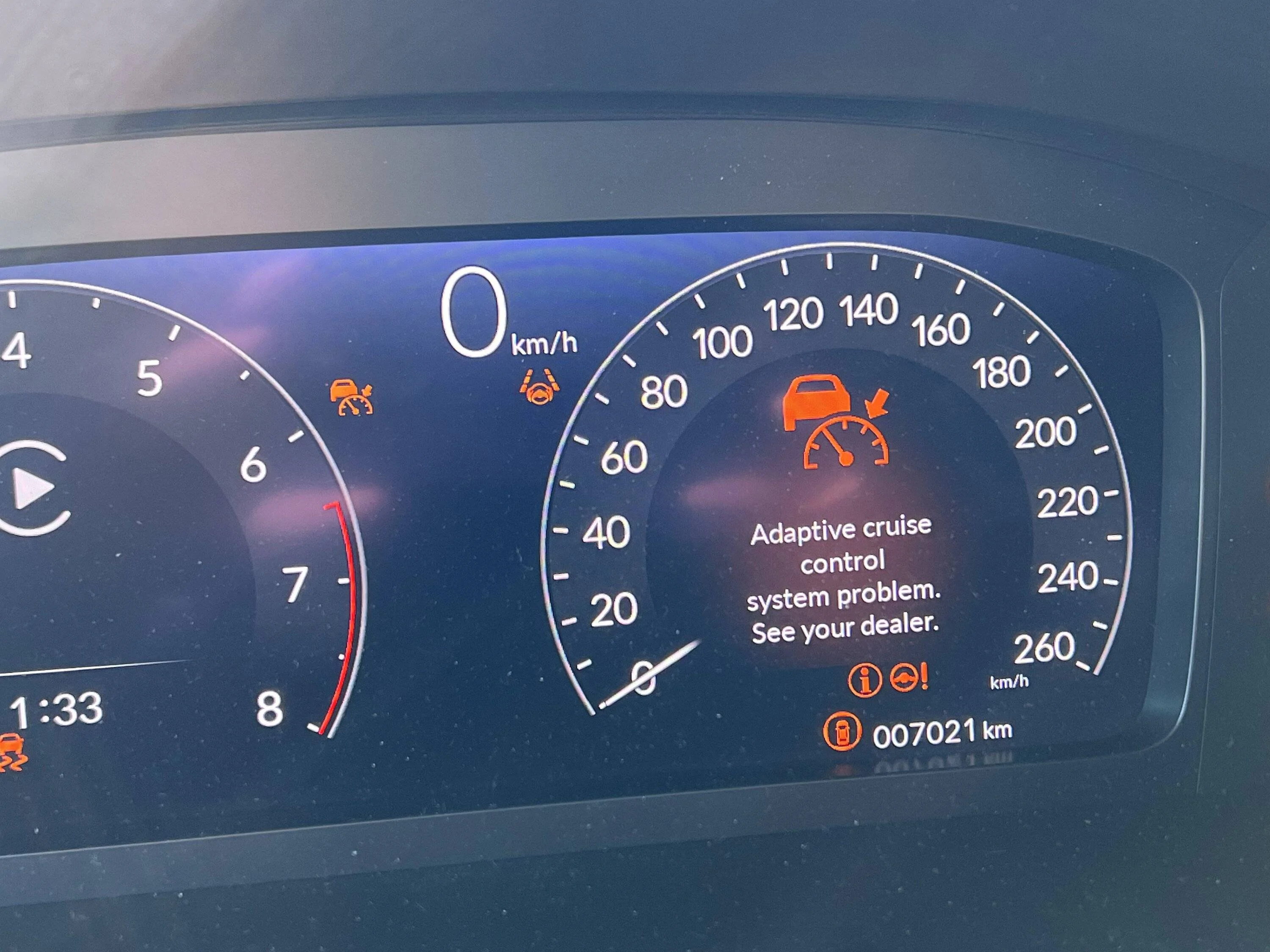

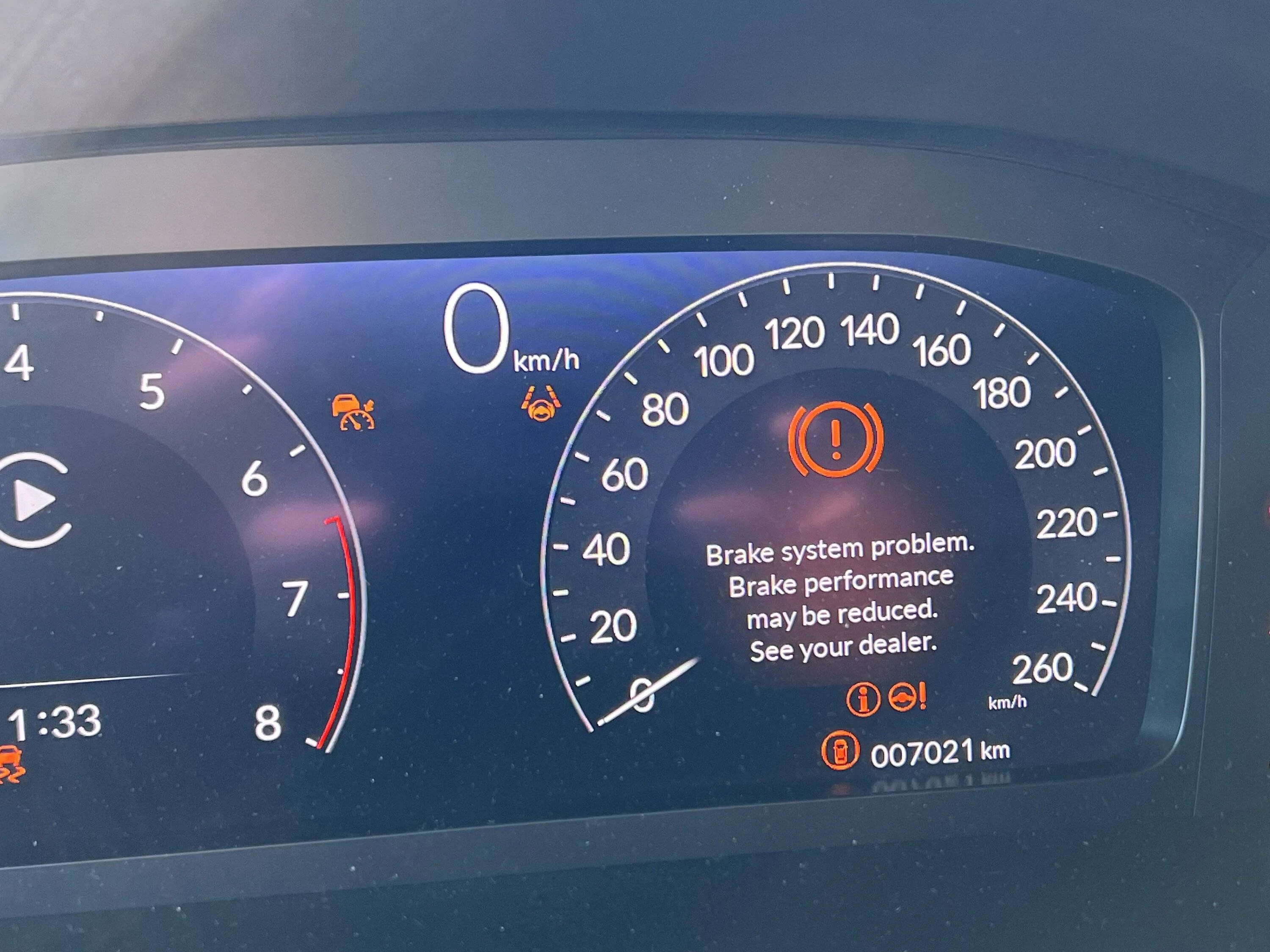

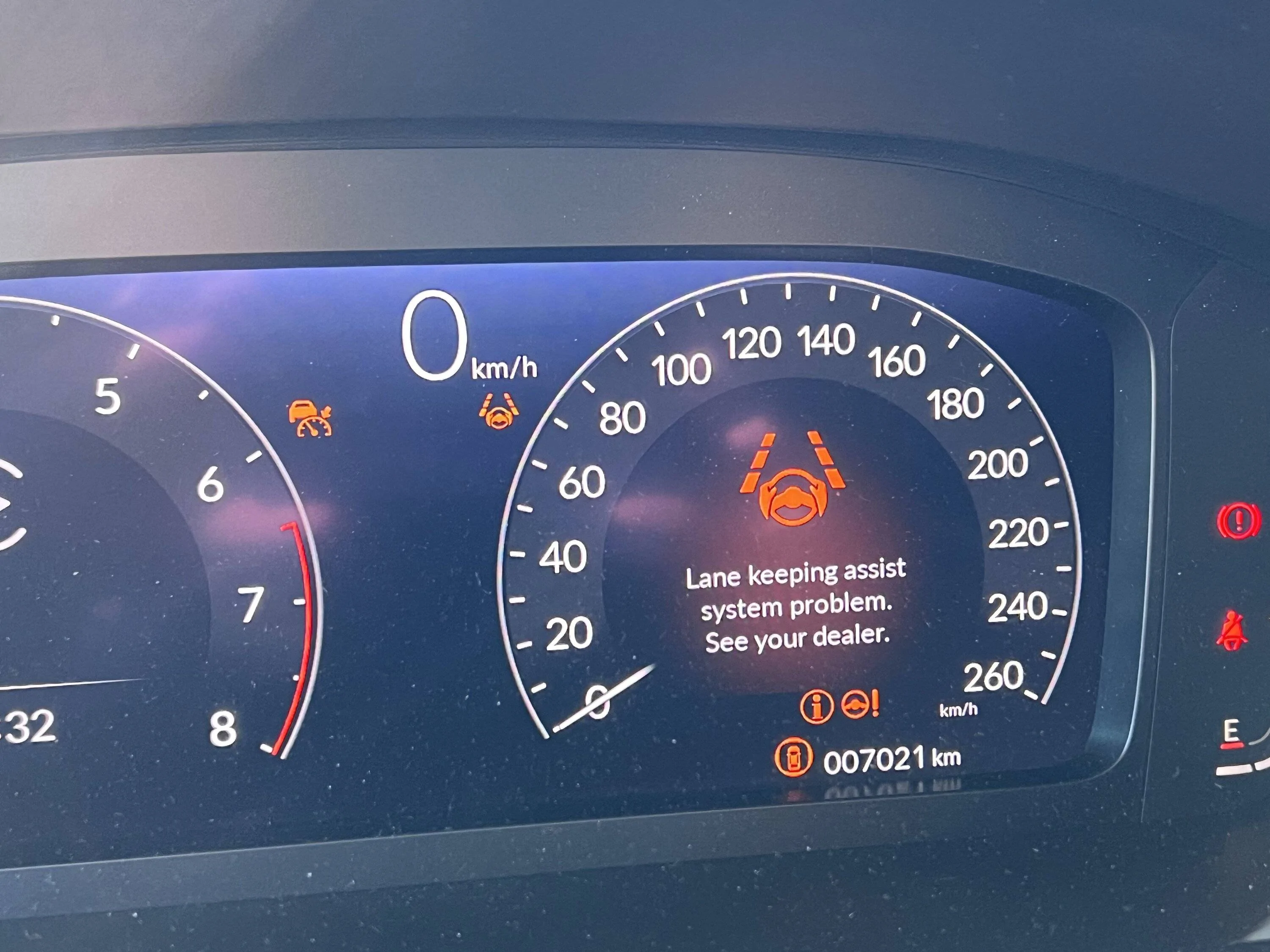

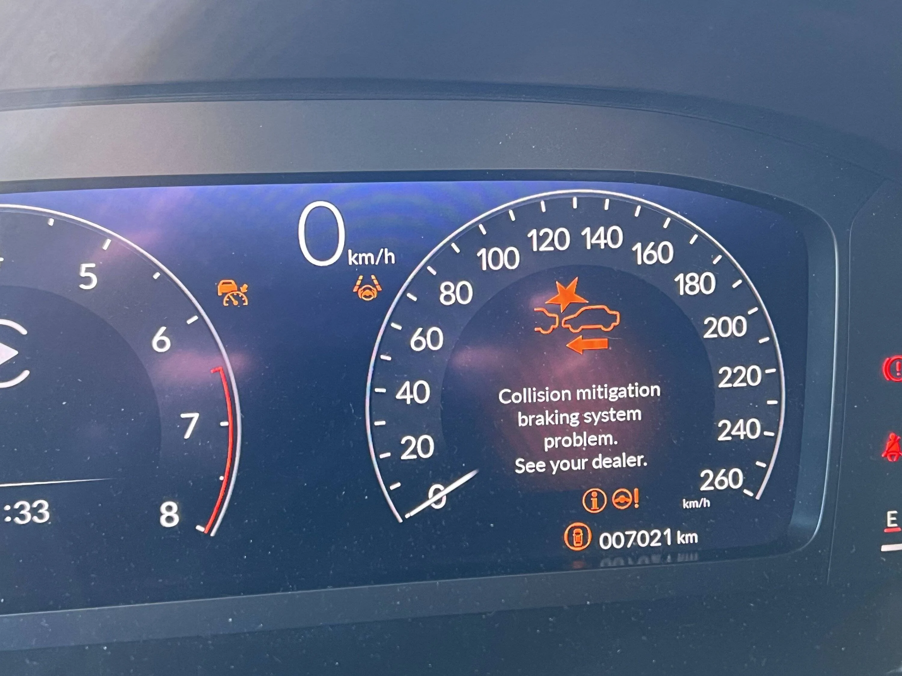

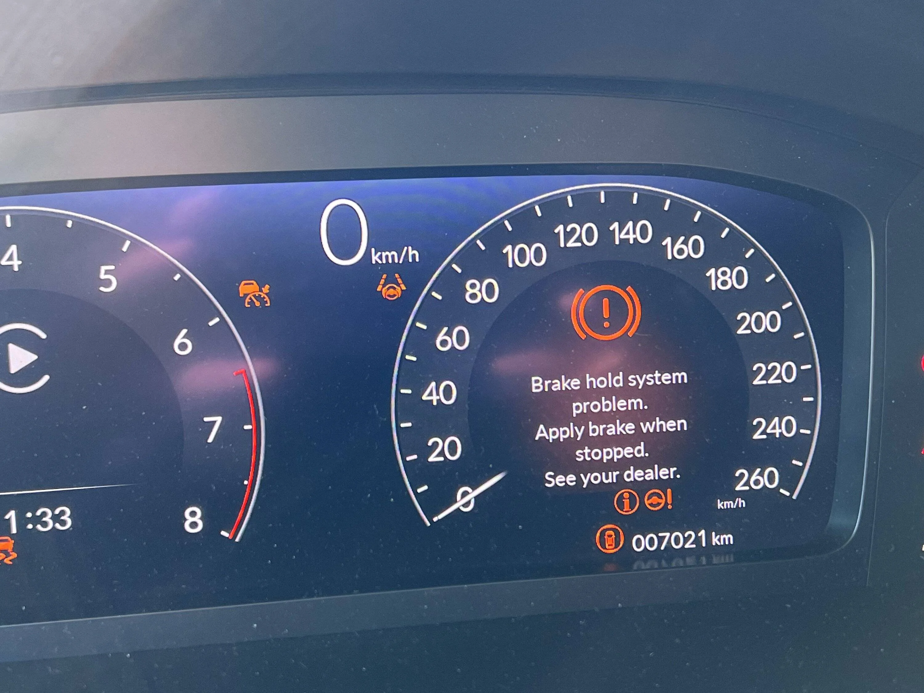

So, here in Atlantic Canada we had a couple of days of extreme cold weather which included warnings. The temperatures hit -47C with windchill with an air temp of -35C.
I started my car to make sure it would start yesterday and after a few minutes it started throwing errors and failure messages like no tomorrow.
Fast forward to today, where its a balmy -2C feeling like -5C and its the same thing.
Needless to say, I'll be paying a visit to the dealer on this one as I wouldn't have expected this to happen at all. 22 CR-V no lights period.
Anyone else experience this?

Update on this issue:
Issue is cleared. Hopefully to never come back.
Here is the description:
Checked for DTC's. Found Code U3000-49 EPS CONTROL UNIT - INTERNAL CIRCUIT MALFUNCTION
Tried to clear code, code would not clear. Performed hard battery reset. Code Cleared. Test drove vehicle. Lights/Code did not come back.
Thankfully, no charge as they wanted $125.99 CDN for diagnosis :oops:
So, it looks like Electronic Power Steering flaked out the rest of the safety feature in the car. Gotta love technology :D
I'll chalk this one up to the cold weather and hope we don't see this one again.
