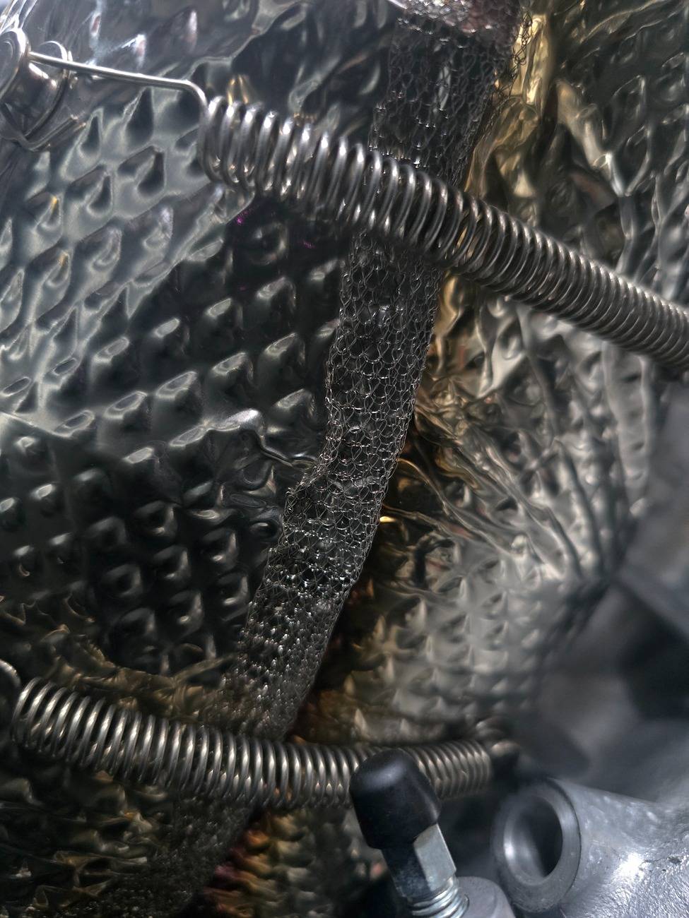

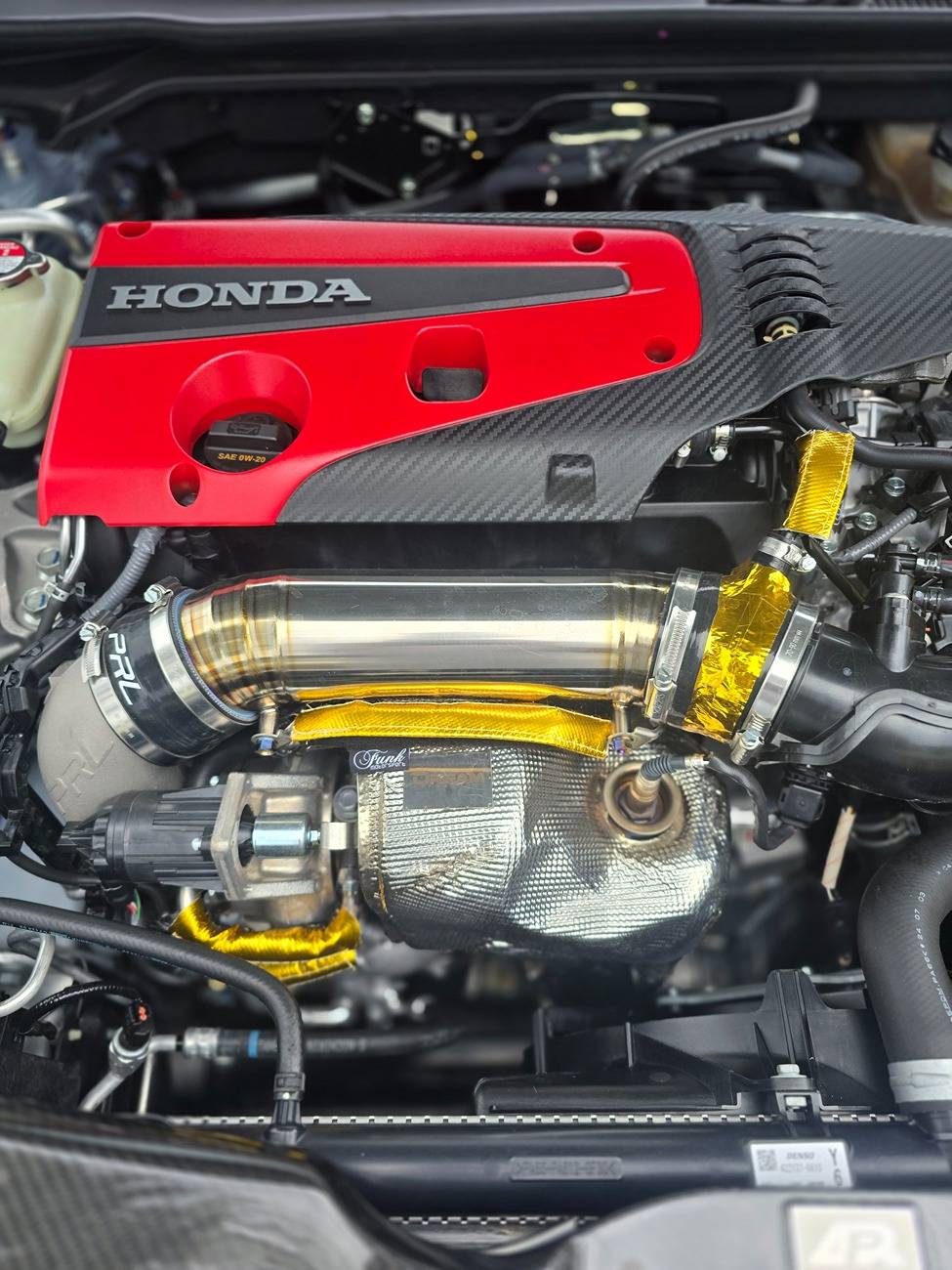

Some eye candy! ;)
11th Gen Honda Civic Cooling mods for the average Joe 20250505_183422
11th Gen Honda Civic Cooling mods for the average Joe 20250505_183222
