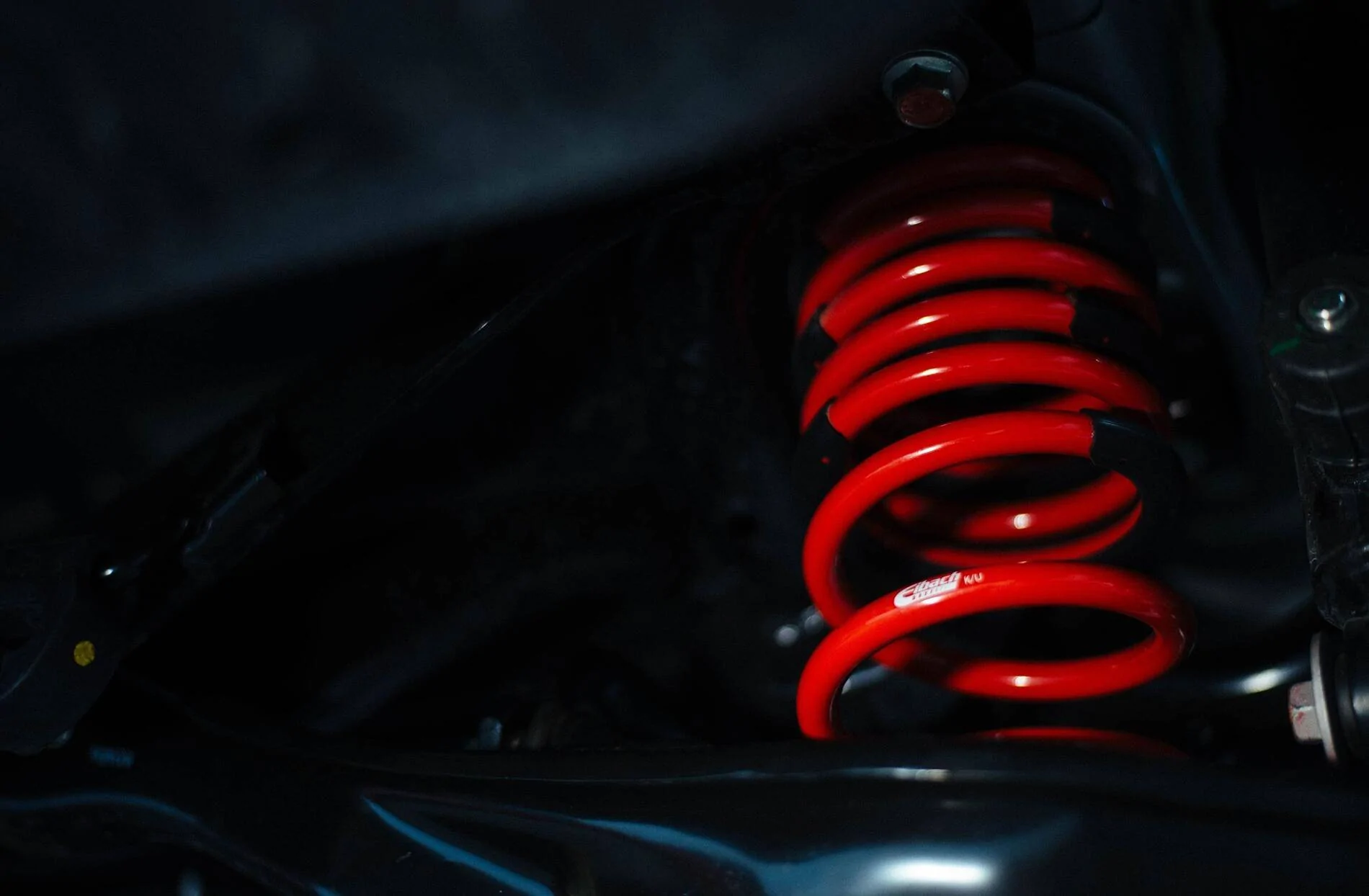

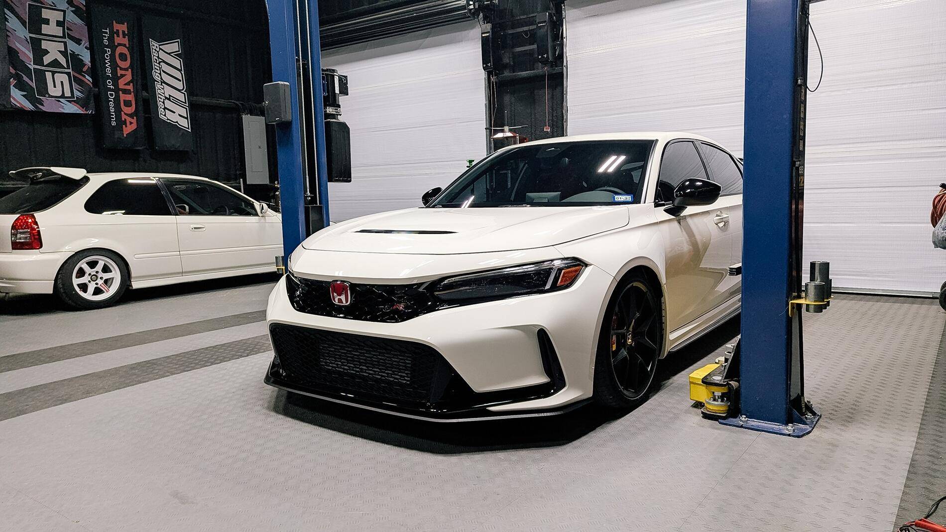

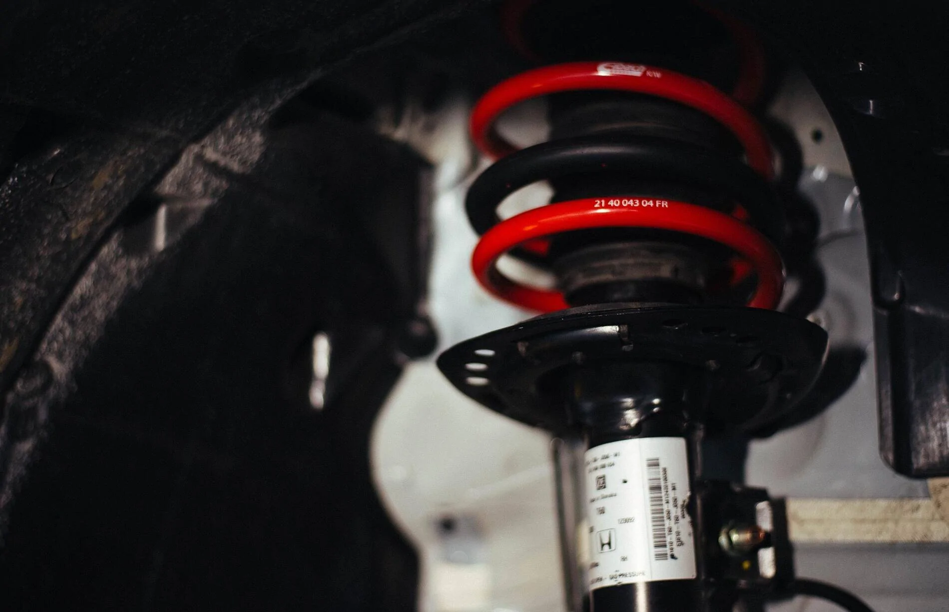

Anyways, we threw on some Eibach Sportline springs as stock heigh is quite 4x4 mode, Project Aero front lip, PLM wing risers, and along with hardwire radar detector, OEM Accord Homelink mirror, and a FitCamX dash cam.

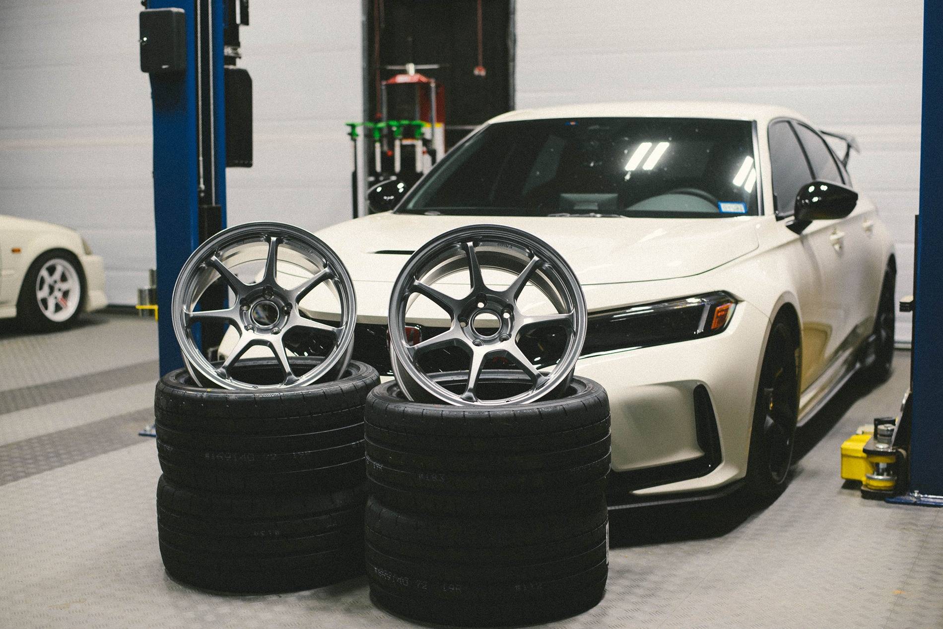

Next up is awaiting our wheels. As a dealer for Volk Racing, we have (2) sets of CE28s coming in our next shipment in late summer/early fall. One set will be for sale: Volk Racing CE28SL 18x9.5 +35 in Pressed Graphite. Let us know if you're interested in this set!
We're going to keep the other set, which is normally referred to as "god spec": Volk Racing CE28N+ M-Spec 18x10 +40 in Dark Diamond Gunmetal. Going to go with 285/30/18 Yoko AD09s (we're super happy with A052s on our track Cayman, so we're sticking with the Yokos).

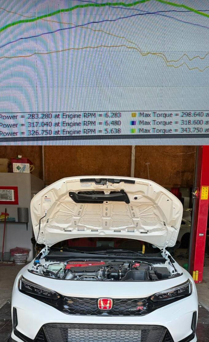

We got some dyno time a couple days ago with our buddy Alan Jackson over at Edge Autosport to see how the street e-tune he did performed in a controlled environment. As mentioned earlier, our shop FL5 was the used for Cobb Tuning's beta R&D for the MY25. Previously, on Cobb's dyno it baselined stock at right around 300whp/300wtq and with the Cobb Stage 1 OTS 93 octane map, it gained +20whp and +20wtq (maybe +30wtq). The dyno we used with Alan was a Dynojet, and oddly enough, it read low, at least compared to Cobb's dyno. Maybe it was also because it was kind of warm, with virtually no airflow to the IC (the dinky fan did basically nothing) as IATs were climbing to close to 120F just sitting there or there was some sort of correction factor going on.
Either way, it doesn't really matter at that point as we were going to baseline everything on this dyno and with the baseline on the same dyno, the deltas would be accurate. We baselined it at 283whp/298wtq on Cobb Stage 0 93 octane (aka: Stock map).
Run 2 would be the street e-tune Alan had tuned for us. While the street e-tune performed pretty well, driveability was great, and validated the logs we captured, Alan wanted to try out a little bit of a different strategy using torque modeling compared to what he did previously on the e-tune.
As you see, the final results in Run 3 are quite a drastic difference. 326whp/343wtq
The final tune gained peak +43whp and +45wtq from baseline!
We're very happy with the tune, and you can definitely feel the additional torque up top, and the powerband is much improved.

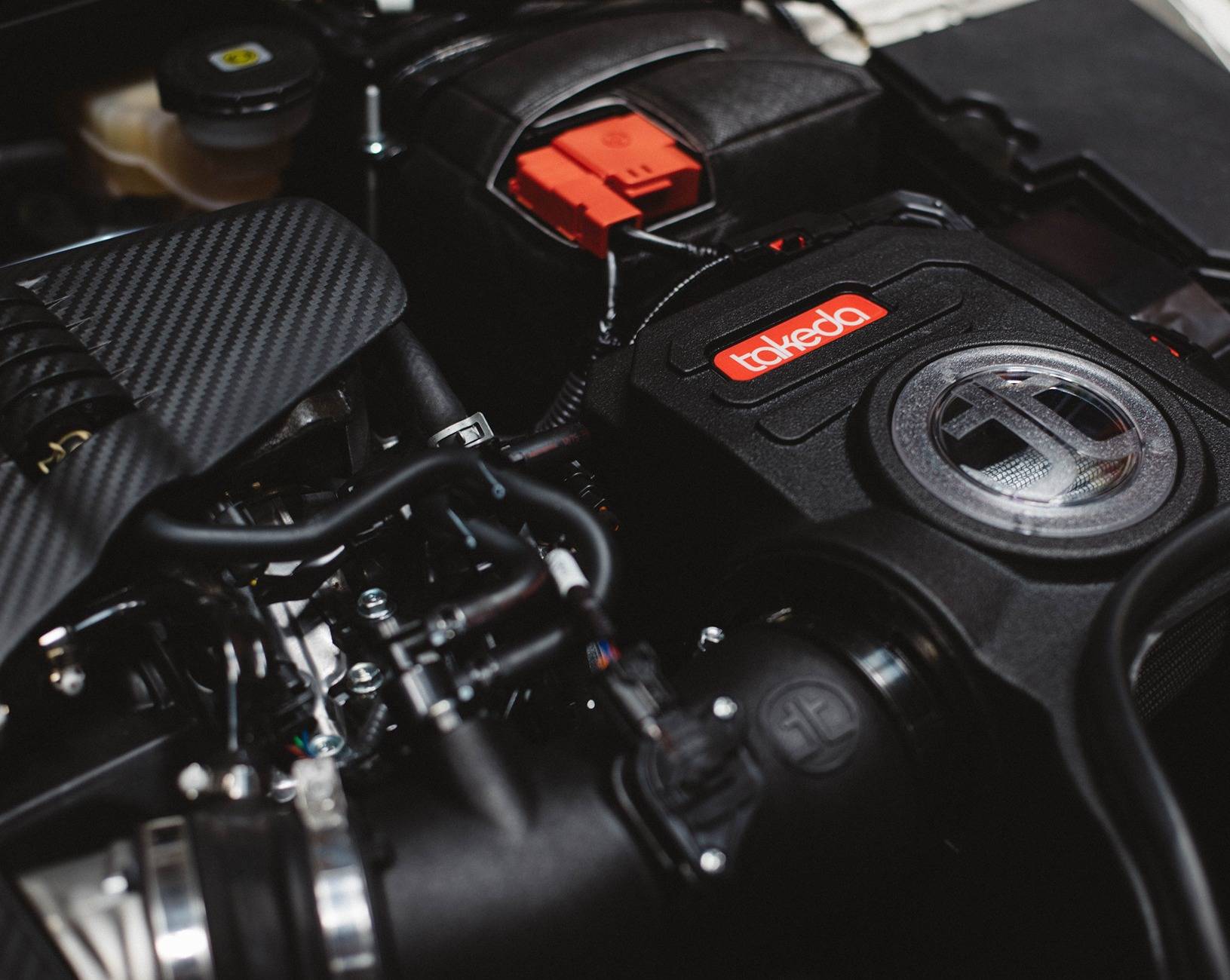

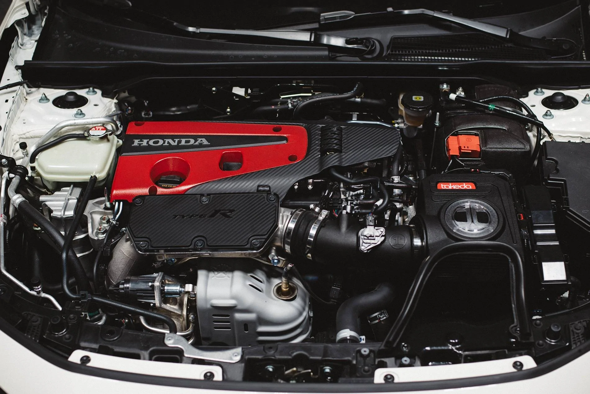

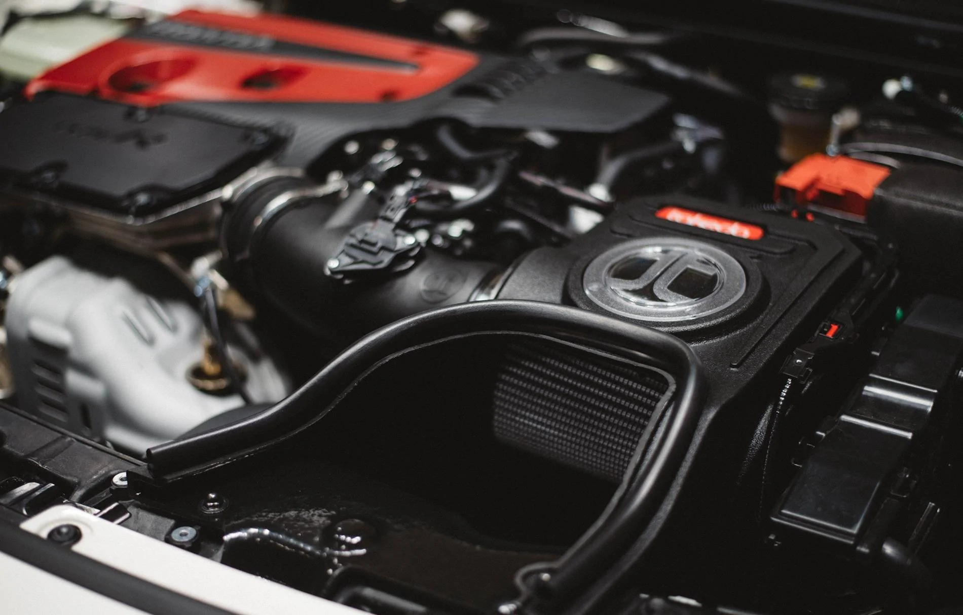

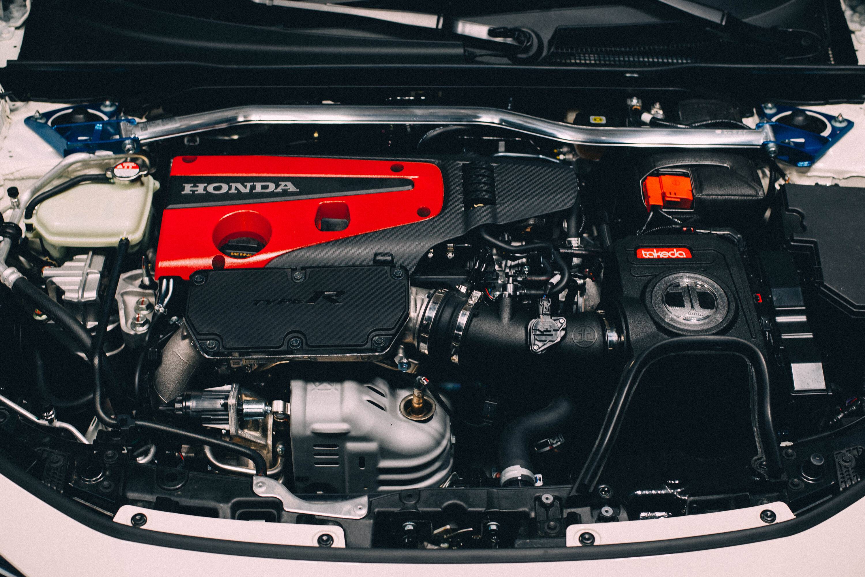

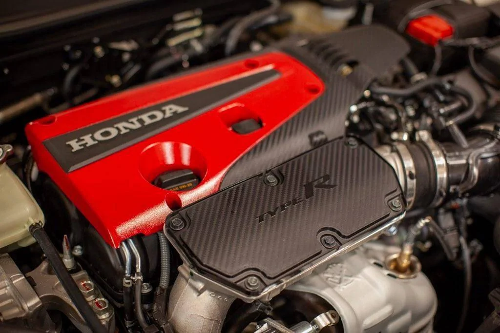

Fast forward to tonight - we installed the aFe Takeda Intake, did more logging and testing (75-ish miles driven tonight while logging). Logs to me look good from AFR to LTFT, but of course sent it off to Alan to verify as he's the expert tuner here.
Looks cool, spruces up the engine bay a bit, and makes a little more noise. We have this intake on our FK8 as well, so we've had good experience with it thus far.

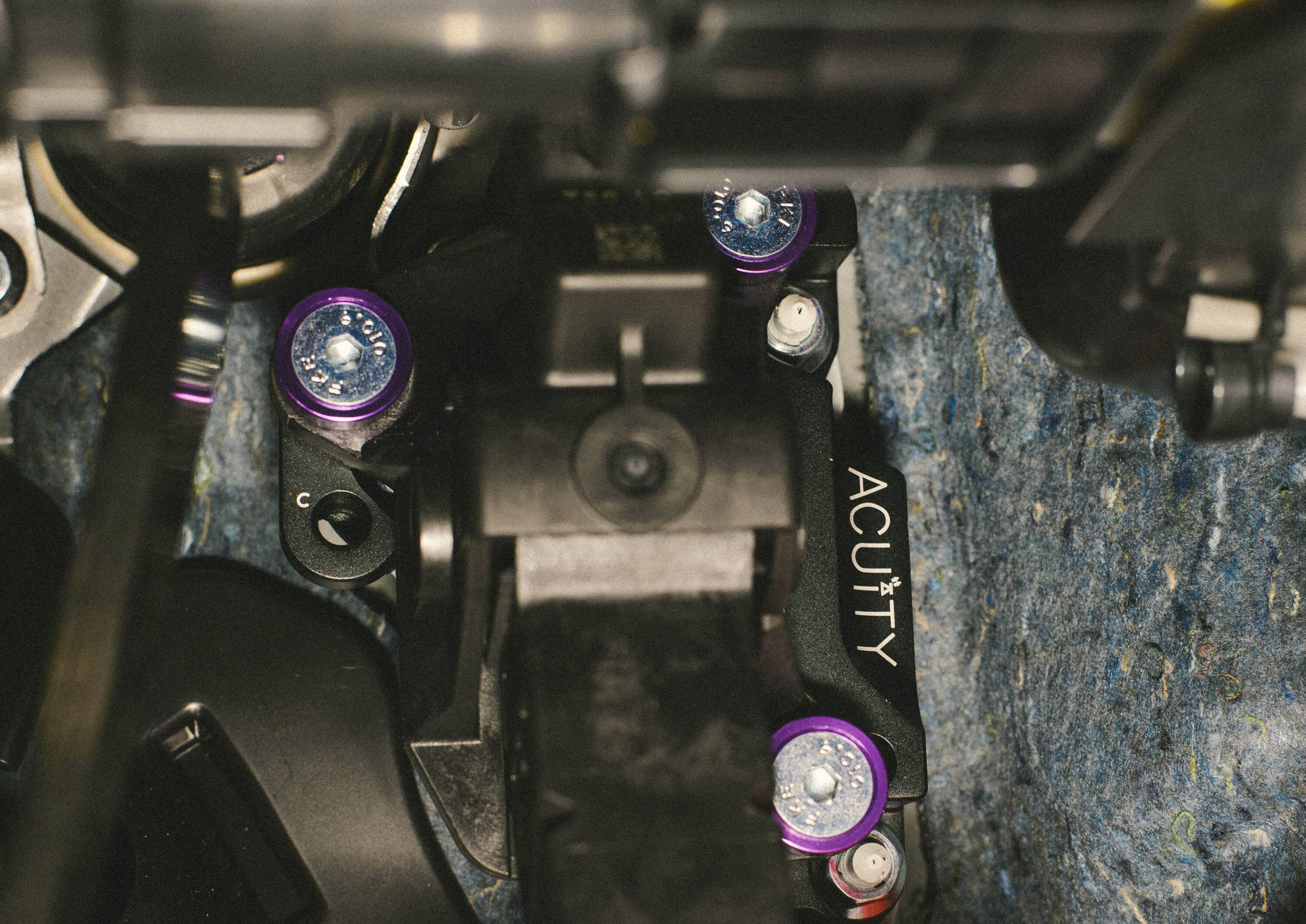

The first quick mod is a drivability mod. The FL5's throttle positioning is quite far away from the brake pedal and it makes heel-toe rev matching a bit more cumbersome and challenging, especially coming from our floor-mounted OE throttle on our track Cayman. We don't have big feet here, either, so when most people use the "side-foot-side-foot" of heel-toe rev matching, we actually have to be very literal and use "heel-twist-ankle-toe" method of downshift rev matching. If you've ever seen the Initial-D anime, this is what it looks like in reality for us:
11th Gen Honda Civic CTECH Automotive Street/Track FL5 Build Thread sddefault
We went with the ACUITY Instruments Throttle Pedal Spacer. It's an incredibly well designed and machined part that is so simple (relatively) and solves a common issue on this platform. The ACUITY Throttle Pedal Spacer (or more technically, Accelerator Pedal Relocation Bracket), helps resolve this problem by providing three unique new positions for your accelerator pedal. In addition to moving the pedal toward the driver, the ACUITY Throttle Pedal Spacer allows you to move the pedals closer together, laterally, to aid drivers with narrow feet.
It took about 5 minutes to install and we were off on a test drive. We chose Position B out of the three total positions to choose from, and it moved the throttle pedal 11mm up and 11mm to the left. This definitely felt more fluid when we were test driving and immediately felt the much needed throttle pedal position change when downshift rev matching and heel-toeing (we keep the auto rev-match system disabled though, out of preference). We highly recommend this throttle spacer to improve driving dynamics.

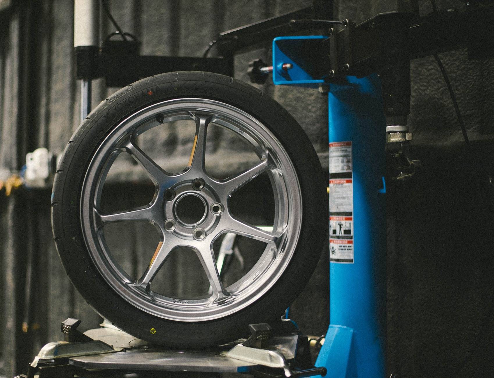

Threw on some "temporary" (in-betweener) wheels on our shop FL5 while we wait for our container to arrive end of summer/early fall. I actually like them a lot more than I thought I would as they kind of remind me of AVS Model 7s a bit.
Enkei TS7 18x9.5 +45
Yokohama Advan Apex V601 265/35/18
You can find these wheels in stock and ready to ship on our site HERE . We also have black and bronze colors available!

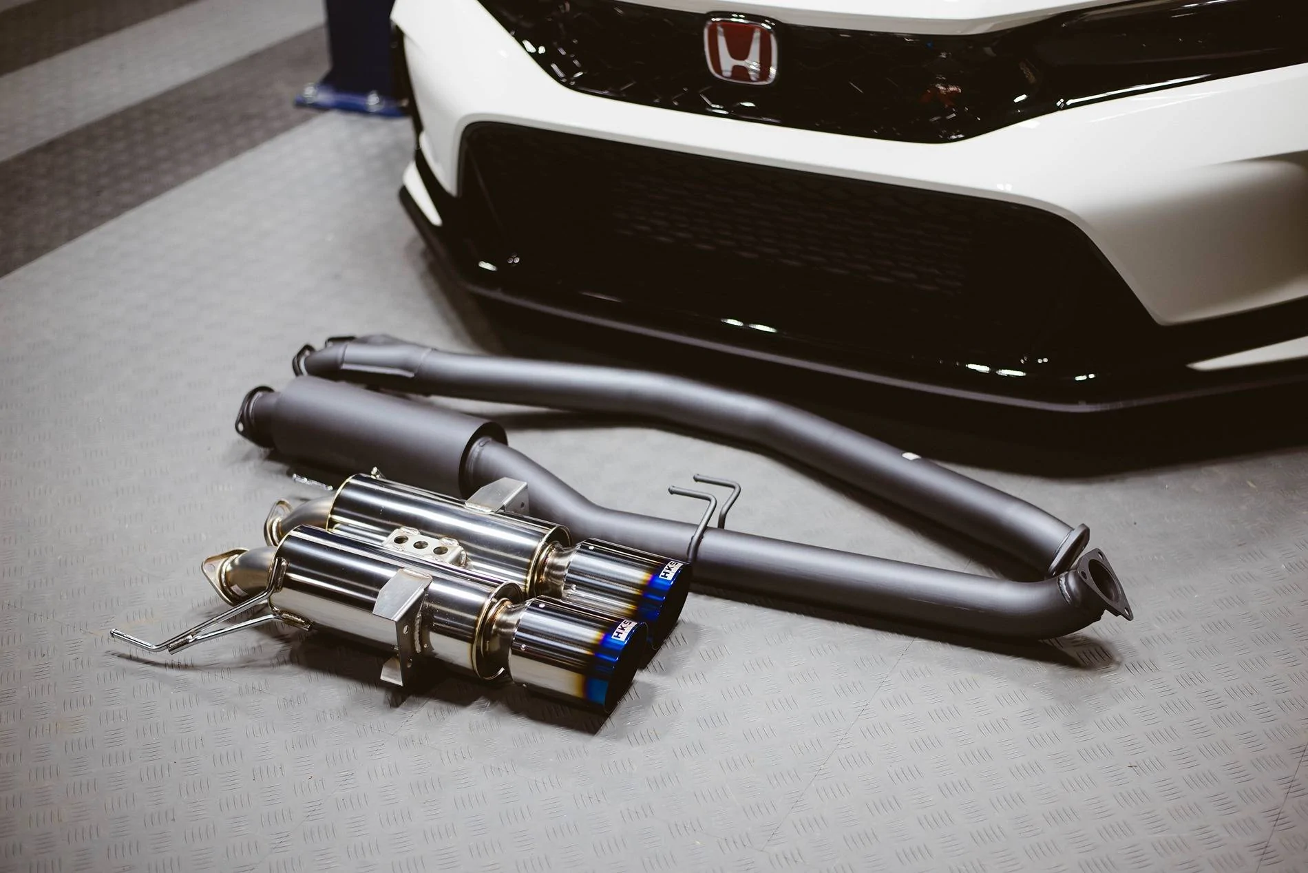

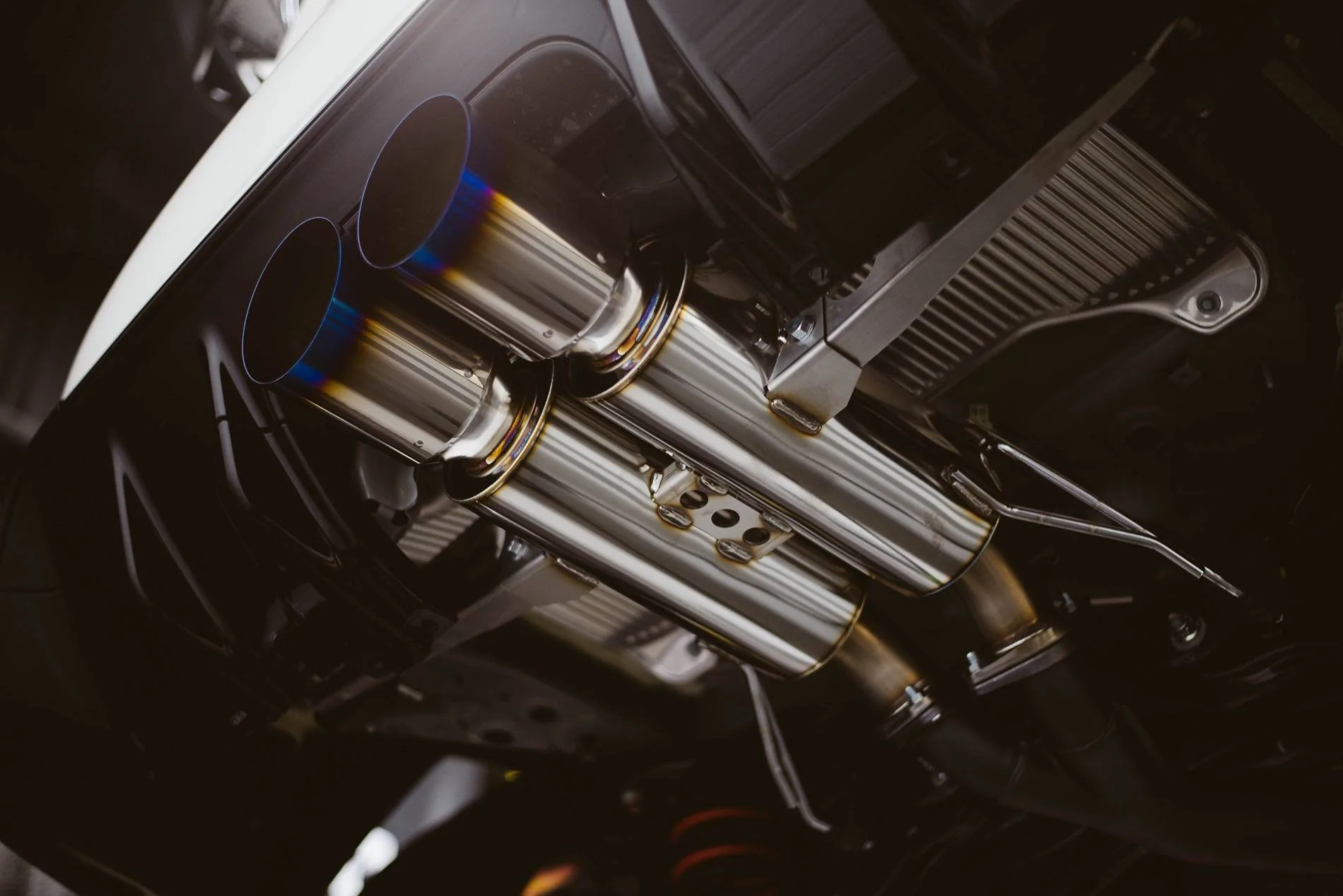

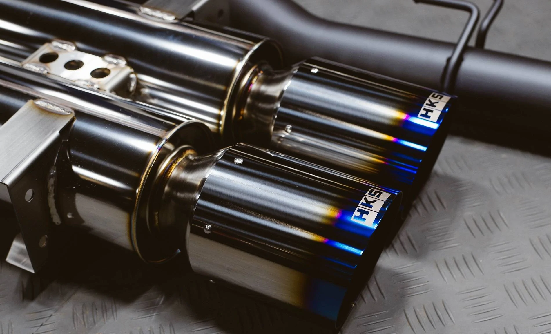

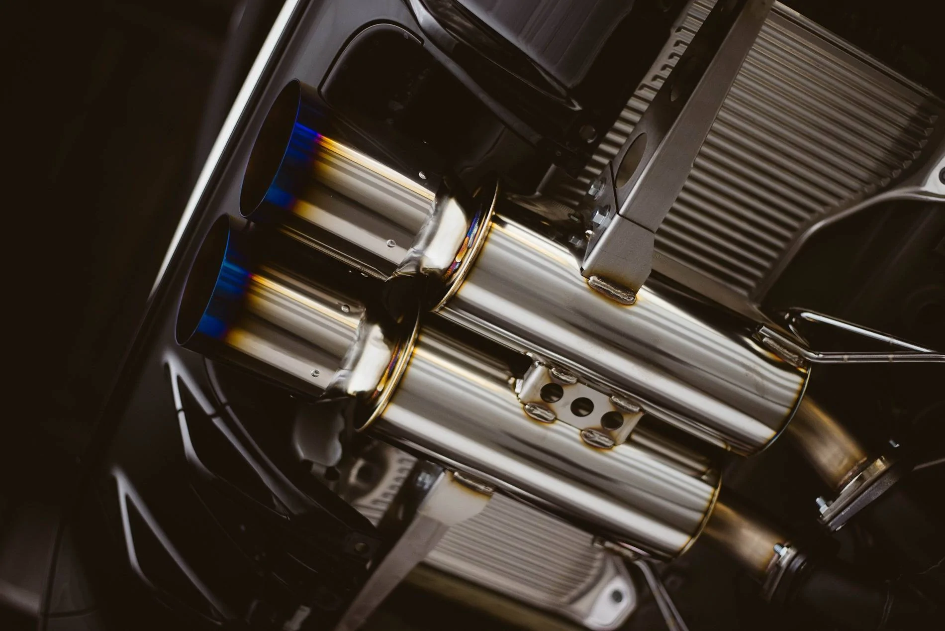

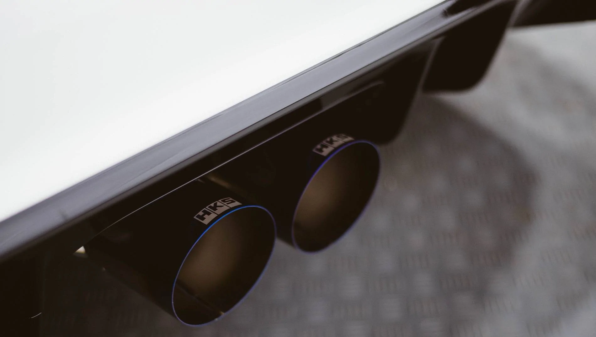

We installed a HKS Hi-Power exhaust on our shop FL5. It is a little more aggressive in tone as well as looks with its dual 5" burnt tips compared to the also popular HKS Legamax exhaust.
These have been on backorder for a few months now, and we had two orders in this shipment, one for a customer and one for our own shop FL5. Taking orders now for the next shipment with an ETA about 30-45 days out.
Please feel free to PM us, or email us at [email protected] to reserve a spot in the pre-order.
Here is the exhaust on our website: https://ctechautomotive.com/product...-civic-type-r-fl5-k20c?variant=51152471097658

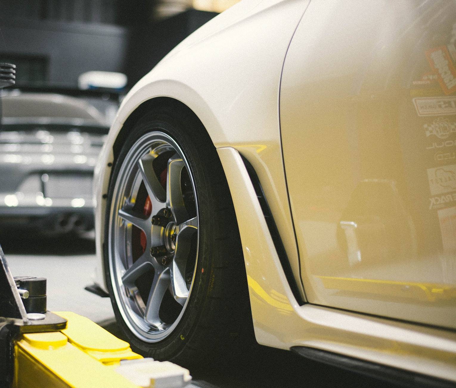

We installed a whole bunch of suspension on our shop FL5. We were running on Eibach Sportline Springs for a bit while we got our suspension package in place.
You can find all the parts on our site which will be link embedded!
We can also have a custom packaged deal with a discount depending on options like the Sakebomb camber plates (we are official dealers for Sakebomb Garage/FPSpec), EDC canceller, helper spring upgrade, custom spring rates etc. PM for more information!
- Ohlins R&T (stock 6k/10k springs) and Ohlins helper springs upgrade
- Sakebomb Camber Plates/Top Hat
- Awaiting our Swift Springs 6" 6k springs to come in then we'll swap out the front springs (fine balance between aesthetics and track functionality; we're good with losing a little bit of compression travel for more lows and we can always raise it up for track days if needed)
- Ohlins EDC Cancellation Kit
- Whiteline Front Lower Camber Ball Joints
- Whiteline Front Sway Bar Endlinks
- Whiteline Rear Lower Toe Arms
- Eibach Rear Upper Control (Camber) Arms
We set the front LBJ to max camber pin setting (-3*), upper strut guide pins were already removed previously on the old set up, and adjusted the upper camber plate to farthest out (no additional camber).
Eyeballed everything with regards to camber/toe/caster and went to our friends shop for the alignment rack. For being eyeballed, I think we did pretty good all things considered :)
Wanted at least -3.5* front and -2.5* rear camber, and this was initial reading.
Final reading:
Overall very happy with how it turned out! Once our Swift Springs come in, we may move the LBJ camber pin to the middle setting (-2*), then adjust from the top camber plate in order to reduce a little bit of the gained track width from camber adjustment from the LBJ as we're planning to run aggressive wheel specs and tire size once our shipment arrives! Also if you're in the North Texas DFW area, we can get all this installed and knocked out for you.
