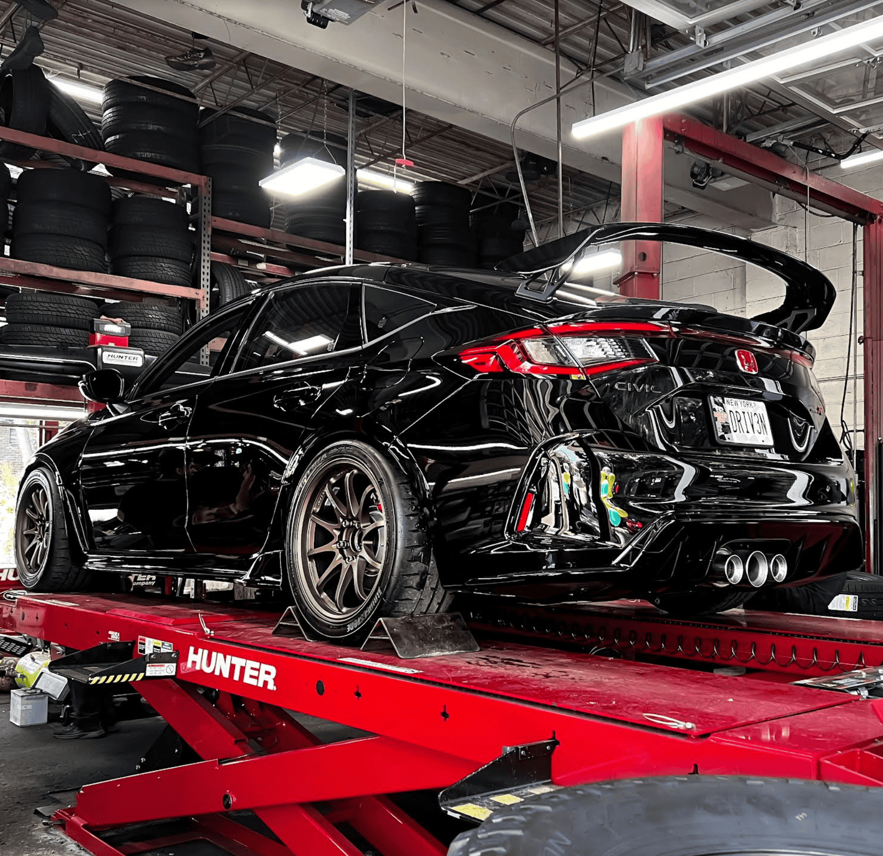

The Spoon FL5 Spec springs have settled a bit after day 2 and 100 miles of driving.
The rear fender gap is less than the front as others have already mentioned, however, the side skirt remains level with the pavement.
It looks like Spoon had a decision to make: lower the car so that it the body is level to the ground OR, create an equal fender gap front and rear which will in hand make the car raked with a lower front end.
Alignment to come by this weekend per your camber recommendations @tezzasaurusrex , I'll probably go -0.5 toe in the front, 0.0 rear.
11th Gen Honda Civic Jonnys_honda FL5 Build Thread IMG_7353
tezzasaurusrex
Terence
Aug 16, 2022
384
980
Australia
I think you're right, they chose to get the side sill level with the ground. The FL5 from factory has a small amount of reverse rake when the fuel tank is full.
In terms of the alignment settings, I recommend 0 front toe, and +1 to +2mm rear toe (combined). You'll find you'll get quite a lot of inside tyre wear running toe out with anything more than -2.5° camber especially on the front axle of a fwd car. And a small amount of toe in at the rear axle helps bring the tyre temps up, and helps with stability preventing over-rotation under heavy trail braking.

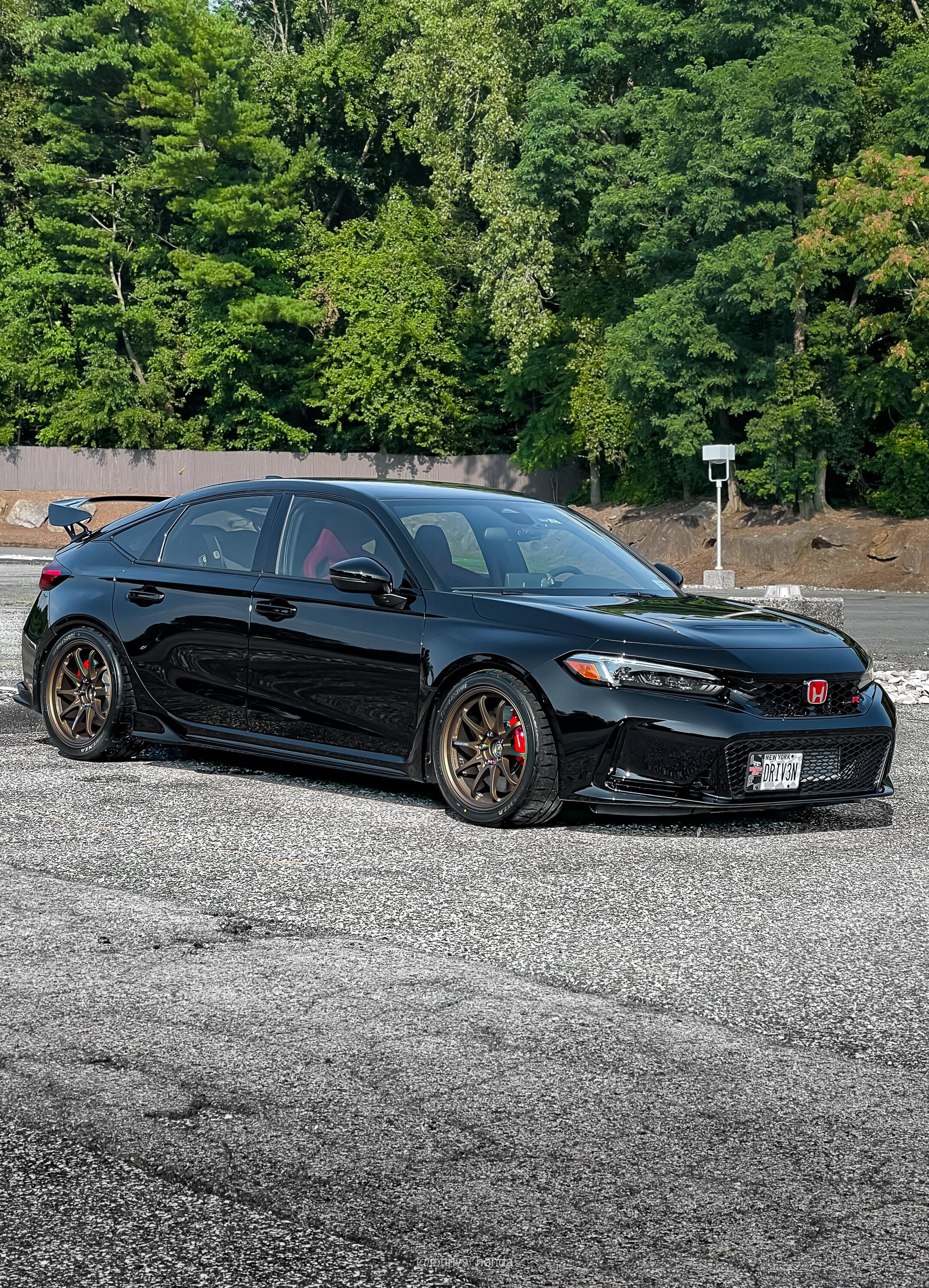

jonnys_honda
jonnys_honda
Jonny
Mar 1, 2017
1,620
155
Irvine, CA
2017 Civic Type R #1288
I took your advice and went ahead with those recommended toe settings. I did not have the same luck matching your front camber, could only get 2.1 up front and so matched that in the rear.
Car is sitting nicely currently and rides great now that the toe was corrected after the suspension work it went under with springs, ball joints and camber arm installation.
11th Gen Honda Civic Jonnys_honda FL5 Build Thread 1689992733946

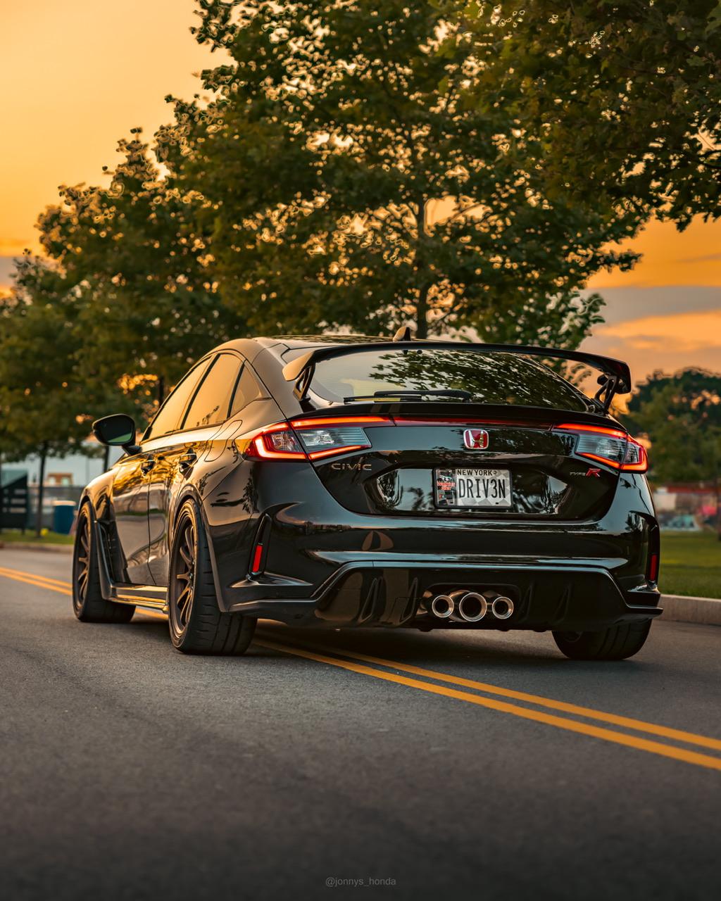

Snapped a few photos at golden hour. The Spoon springs are settling a little more as the mileage creeps up. About 300 miles added so far.
11th Gen Honda Civic Jonnys_honda FL5 Build Thread IMG_7526
