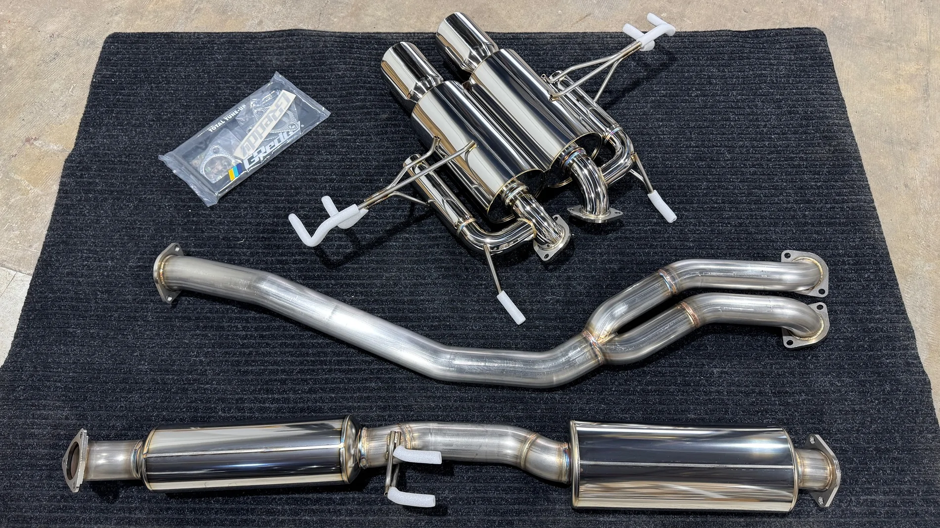

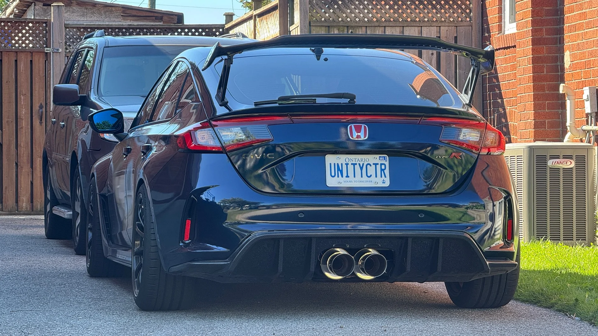

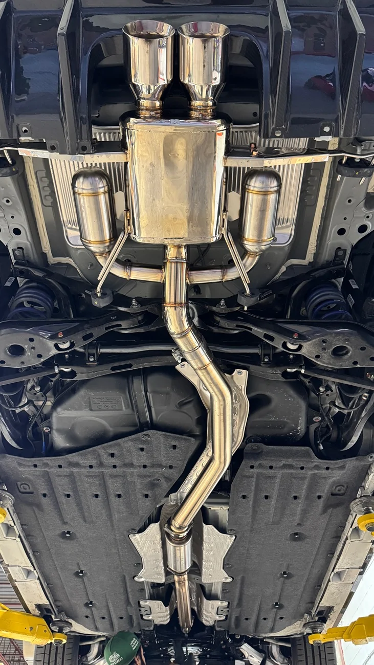

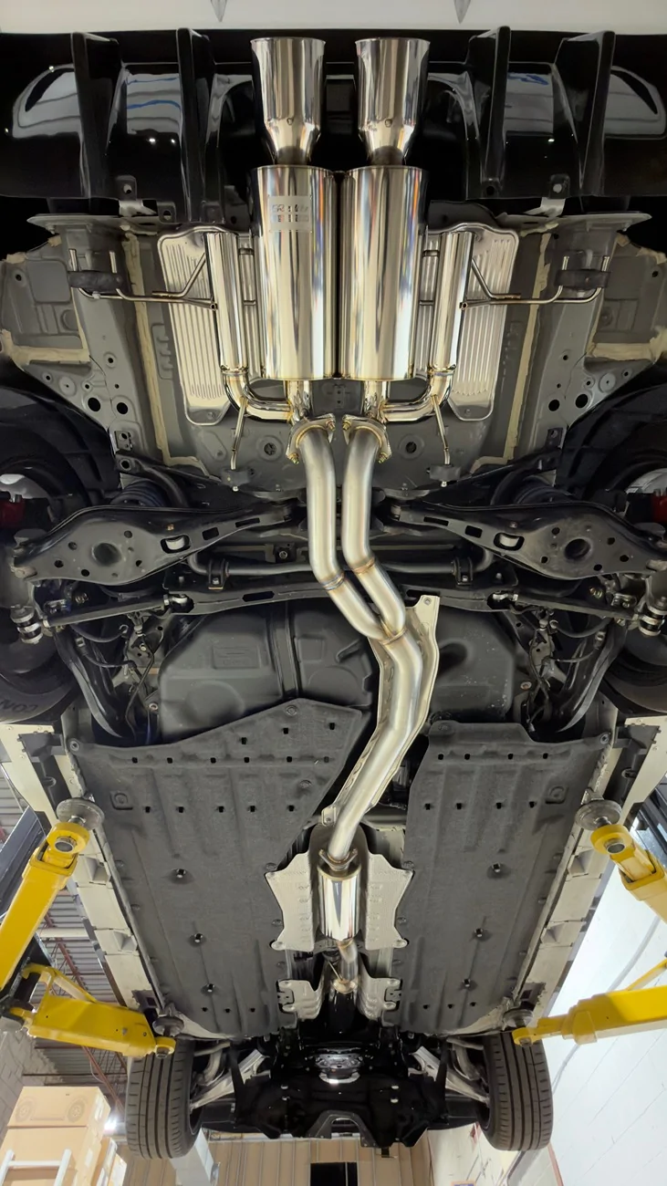

End of July I got word that our GReddy SP stock was ready, earlier than expected, I was thinking closer to mid-September.
Beyond wanting to get early content out on it, I was genuinely interested in this exhaust since it's similar to the ARK, just with an extra resonator in the middle. So we brought one in, installed it, and around the same time sold my HKS Legamax to a friend who desperately needed a quieter exhaust to go with his new TSP DP and RV6 FP, which he'd picked up from us a week prior. I'll grab another Legamax for myself later once GReddy testing wraps up, OR offer the same friend a straight trade if he’s interested in testing out both as well.
Anyways, I've been living with the GReddy SP for about 2 weeks now, following my ARK testing.
I rank exhausts as mild, medium, or loud. ARK Resonated falls into medium, GReddy SP is solidly mild. Up to 70mph, the ARK was daily driver friendly on the highway, and I can push the GReddy to 75mph before getting any real cabin intrusion. GReddy does give up some of the theatre you sometimes want in exchange for that. I could do a road trip with either, just a bit more comfortably with the GReddy. I'd be slightly wary adding a DP + FP with the ARK (that's just the old man in me), whereas I'm actually looking forward to testing the GReddy with a catted DP + FP soon.
Overall, both exhausts are great. If you don't mind something louder, go ARK. If you want something more understated, go GReddy. With this being exhaust #4 on the car, here’s my rankings from quietest to loudest so far:
Hybrid - closed valve
GReddy - Resonated (double)
MXP - closed valve
Hybrid - opened valve
ARK - Resonated (single)
MXP - opened valve
ARK - non-Resonated
11th Gen Honda Civic Unity Performance Humza's FL5 Build Thread IMG_7537
11th Gen Honda Civic Unity Performance Humza's FL5 Build Thread IMG_7554
Top: ARK. Bottom: GReddy SP
11th Gen Honda Civic Unity Performance Humza's FL5 Build Thread IMG_7539
11th Gen Honda Civic Unity Performance Humza's FL5 Build Thread IMG_6293

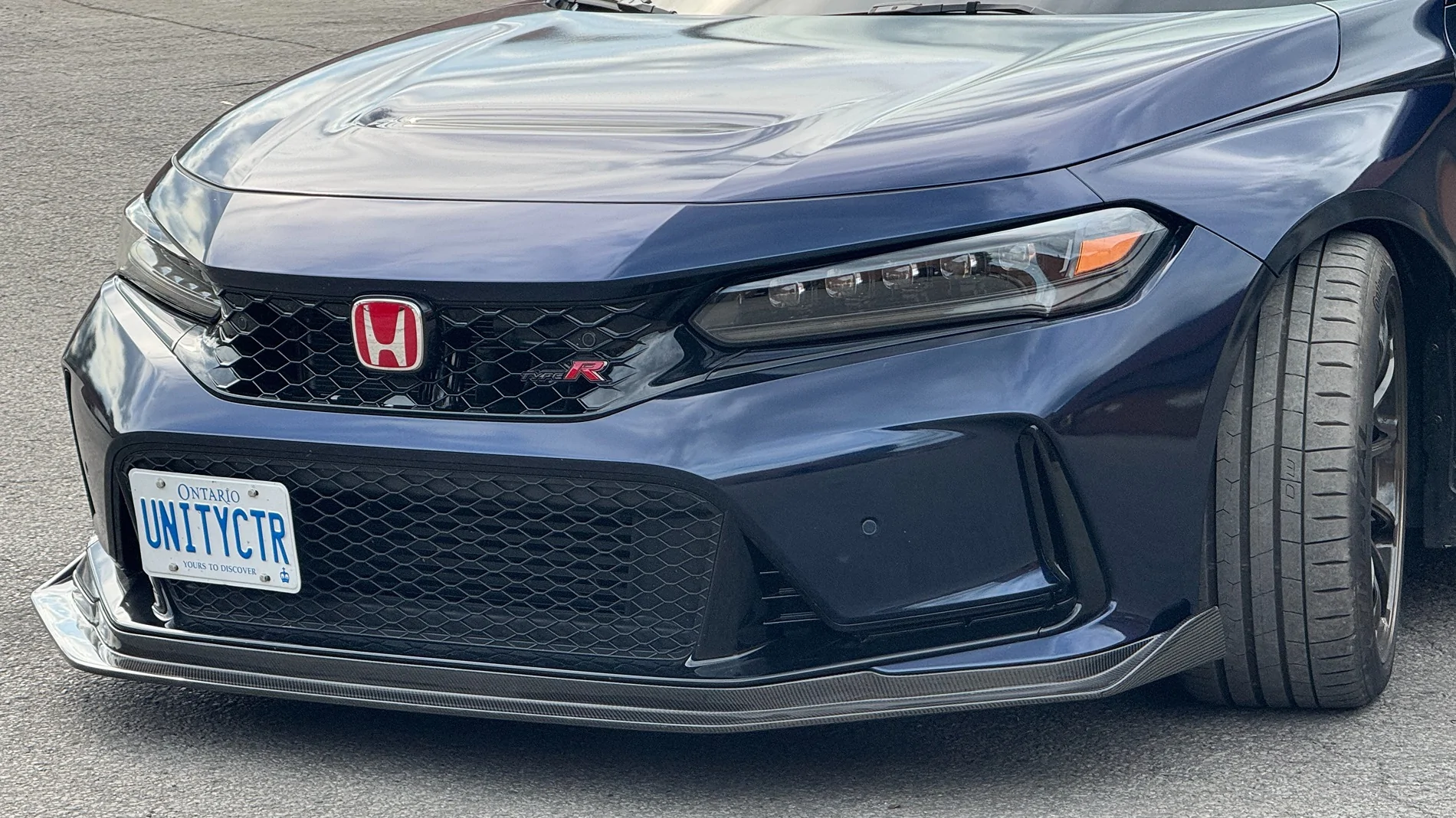

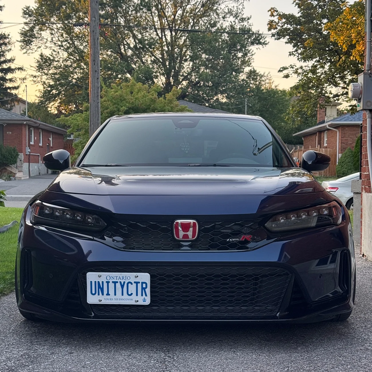

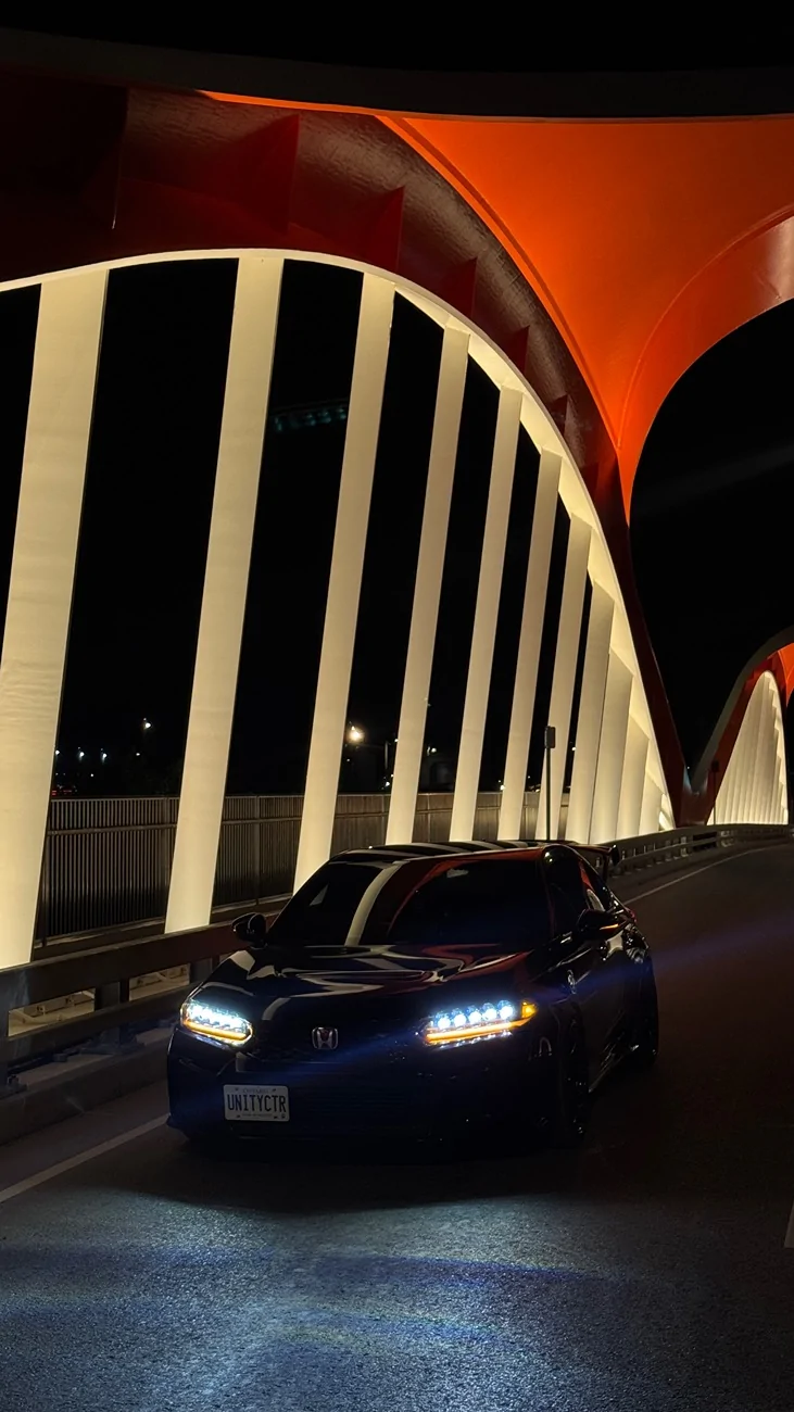

I've been humming and hawing over installing the AlphaRex headlights for some time now. Got this particular set last year, PPF'd the lenses, but just never got around to it.
Finally couldn't take it anymore and told myself the bland front end had to go. The visual imbalance between a stock front and a modified rear (diffuser, risers, wing, exhaust) was throwing off the whole car for me. Sorry I didn't grab any install photos, but it's exactly as AlphaRex's instructions lay out. This particular version is "AlphaBlack," which comes with the smoked DRLs.
The height adjustment knob was easy to rotate with a bit on a 1/4" ratchet. Cutoff is much more distinctive than OEM, and the beam projects further out too. With the engine off, the cutoff point is rock solid. I do notice a slight jitter with the engine running, and my guess is vibration from the two engine mounts at idle is enough to cause it, since the cutoff line is that fine. No hyper flash or any issues to report thus far, I’ve had these for about a week now.
Overall, once you've got these on your own car, you start looking at everyone else's stock headlights and calling them basic 😅
You can find them on our website here: https://unity-performance.com/products/alpharex-led-headlights-11th-gen-civic

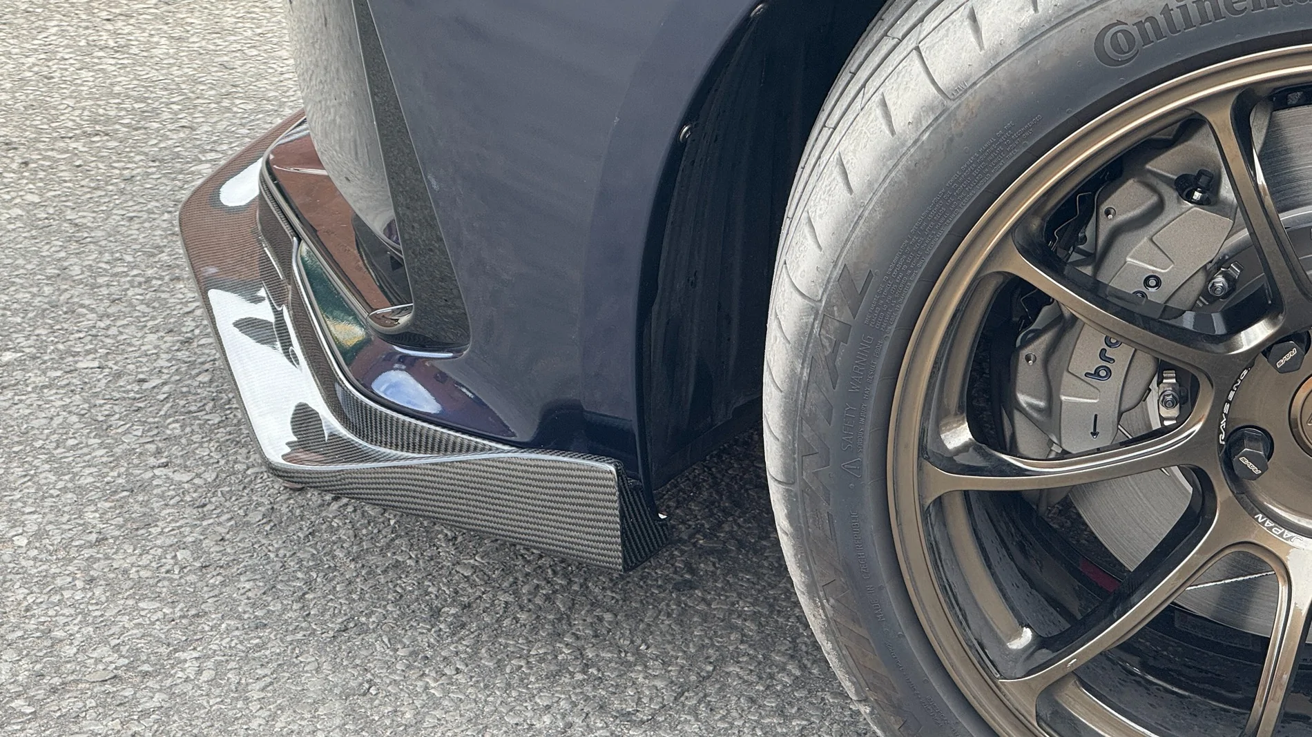

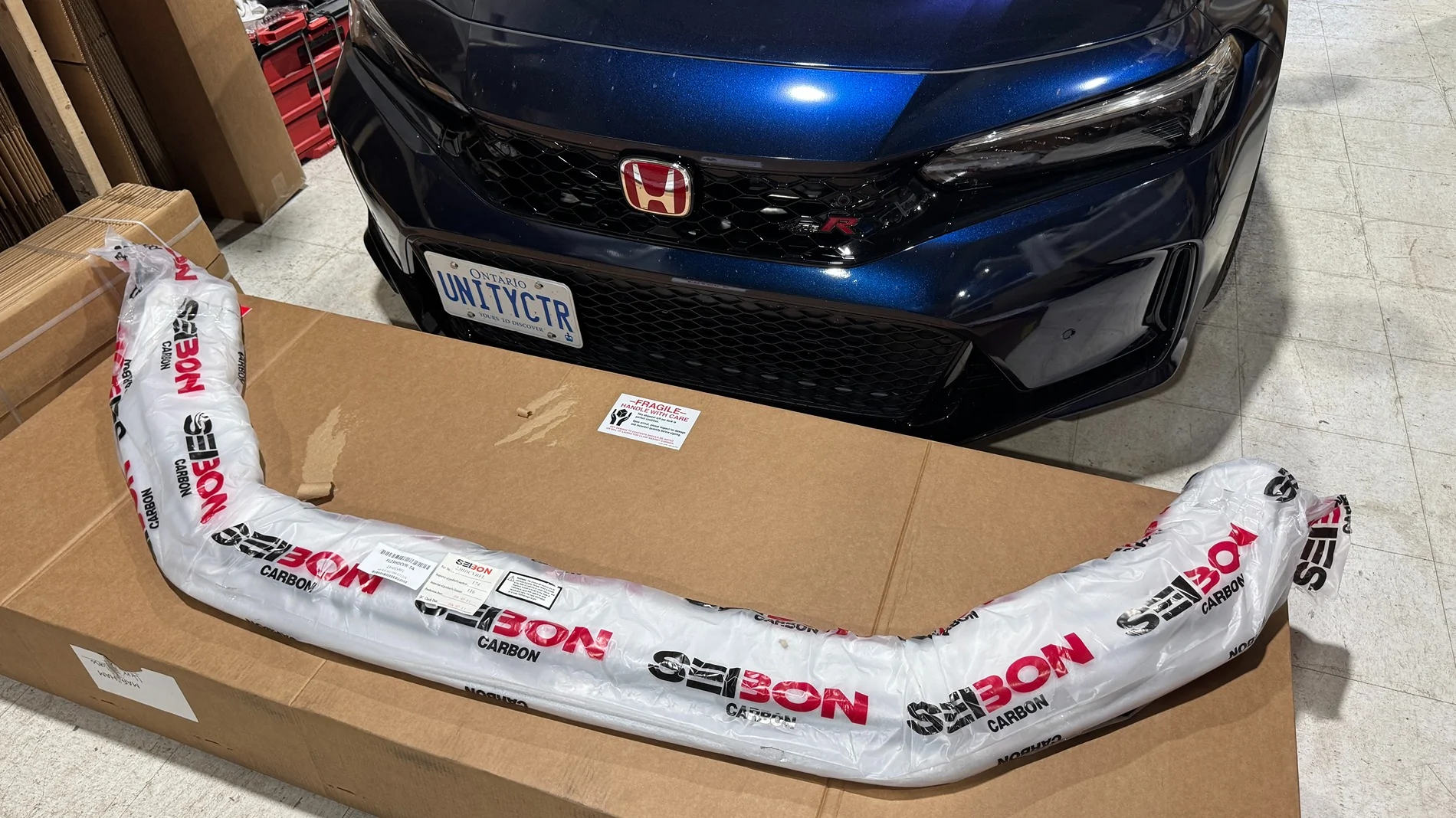

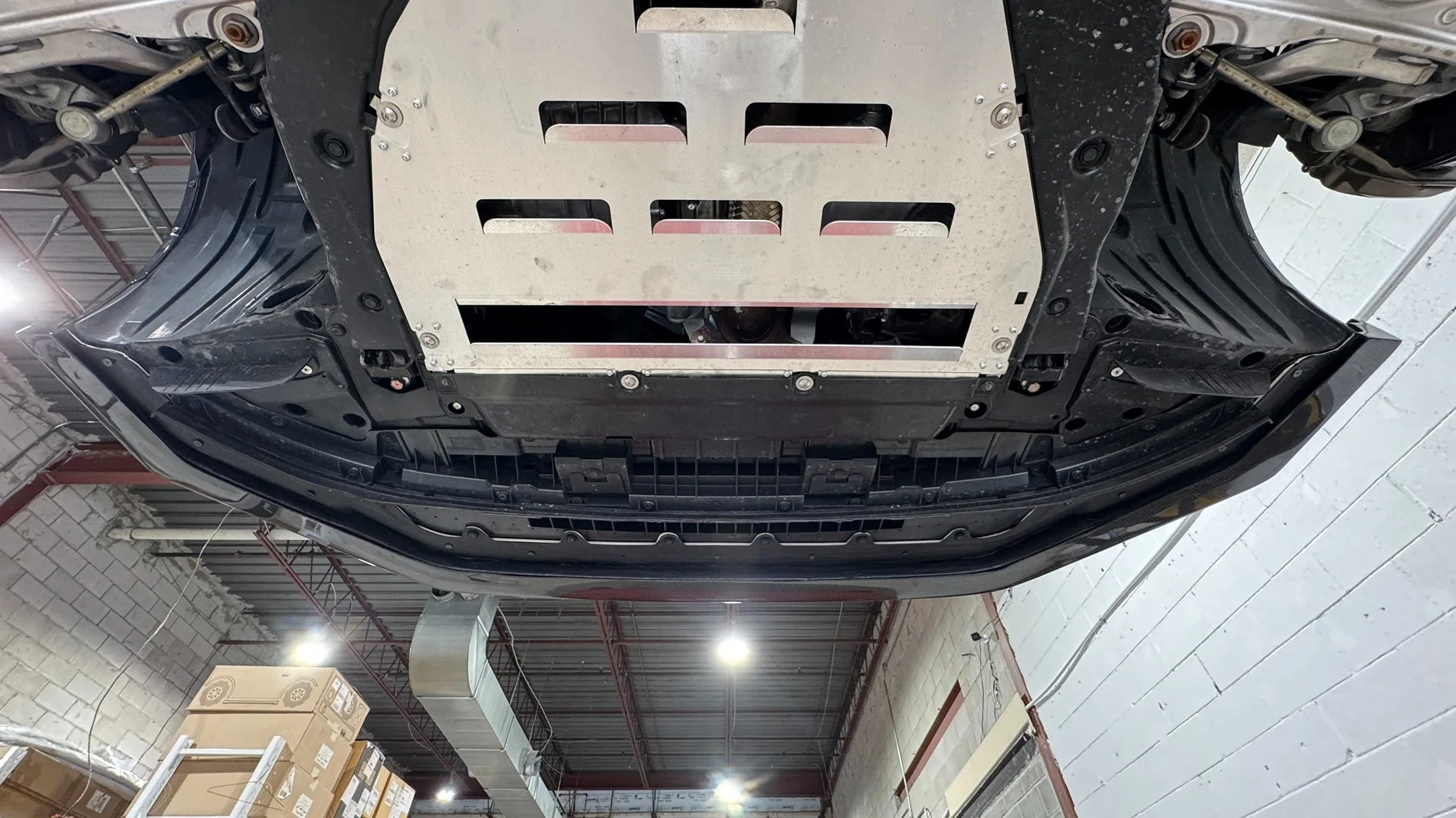

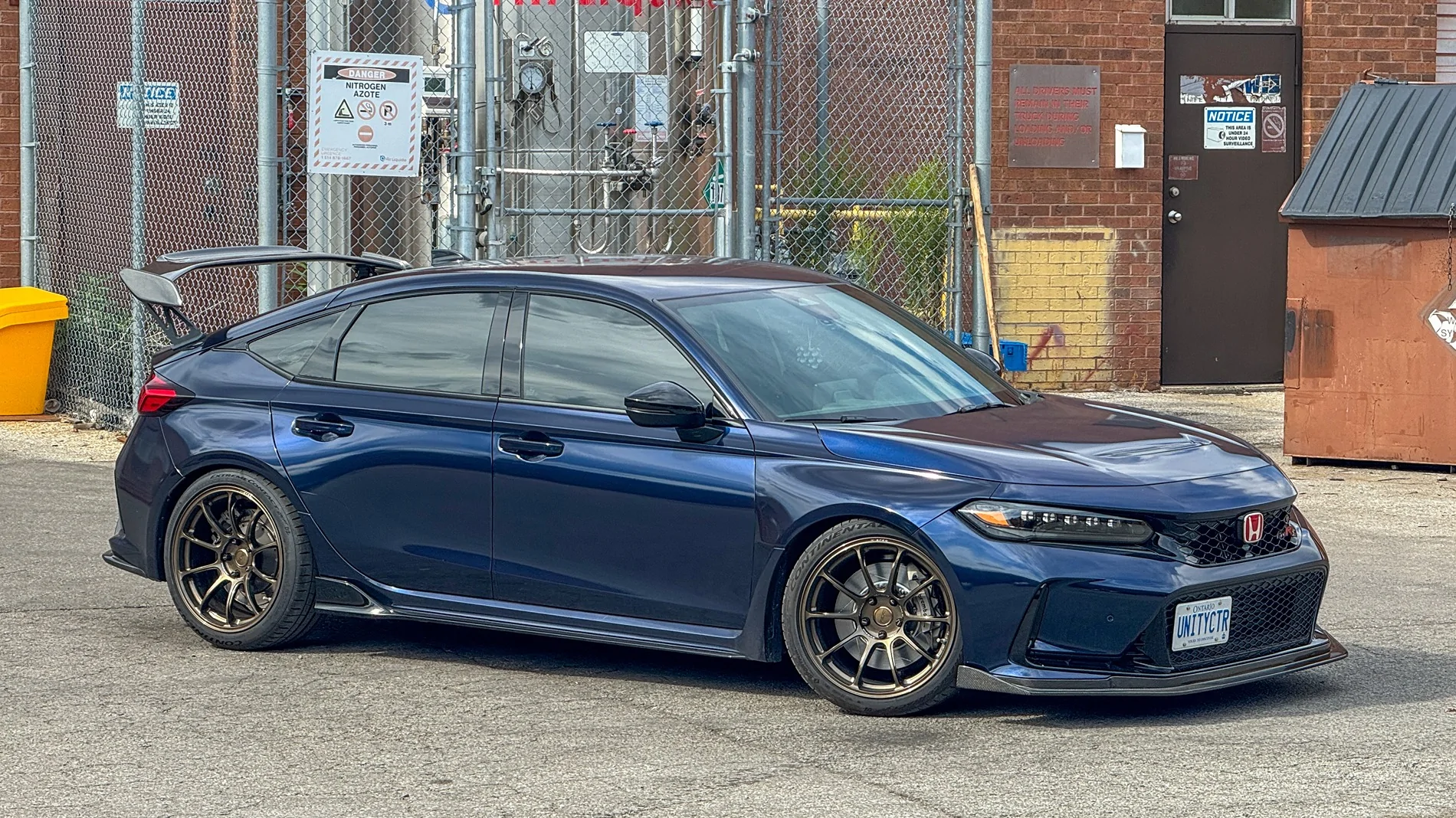

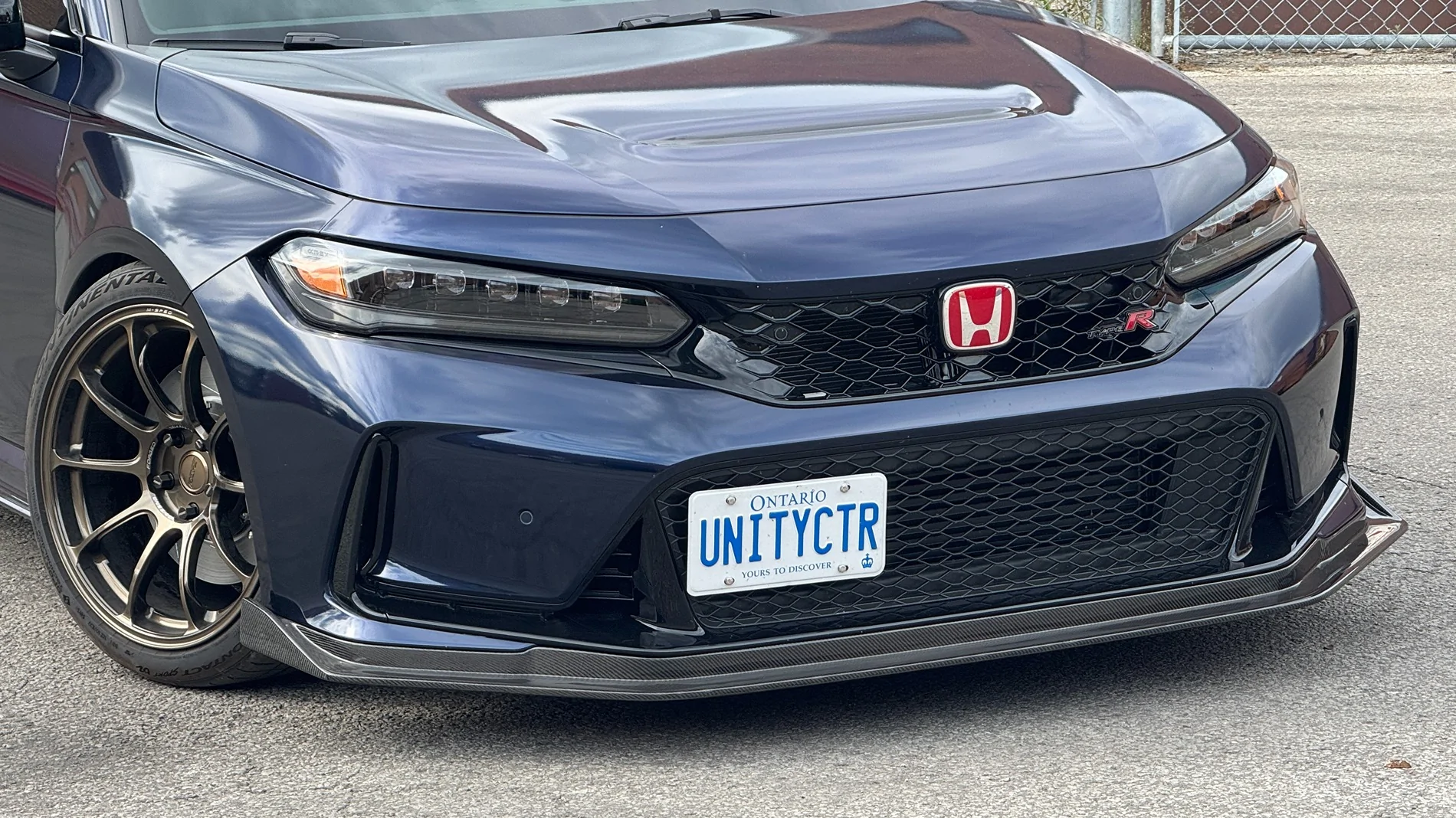

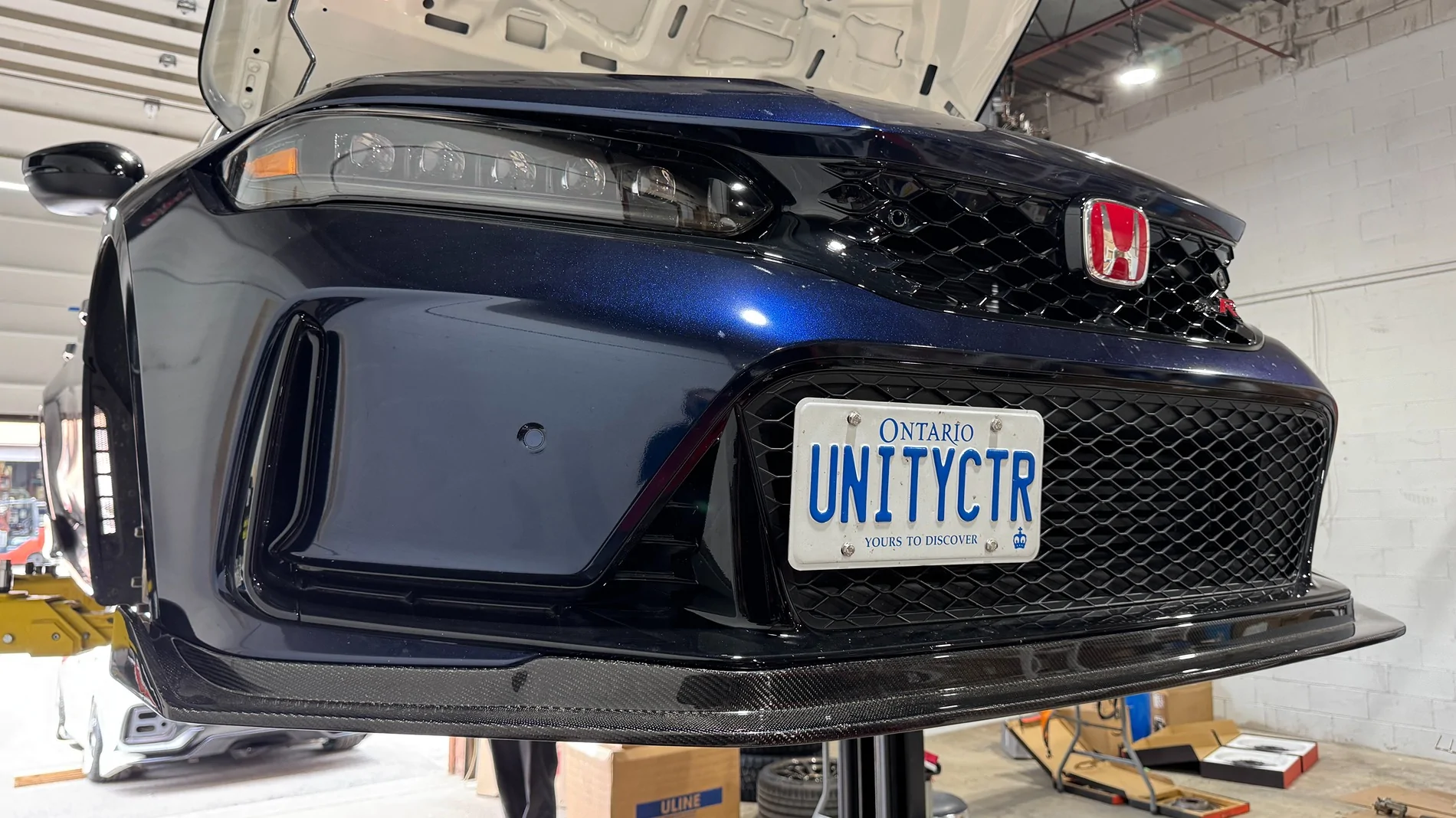

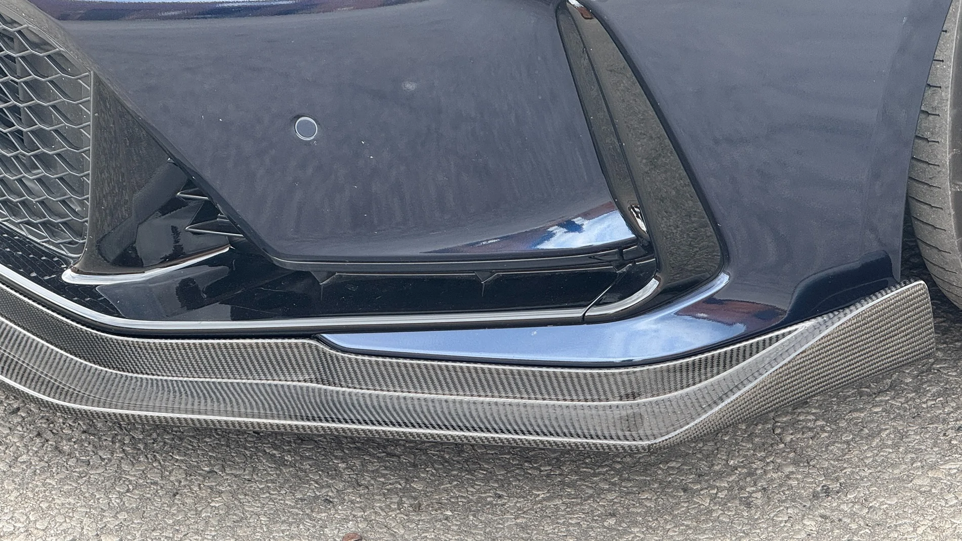

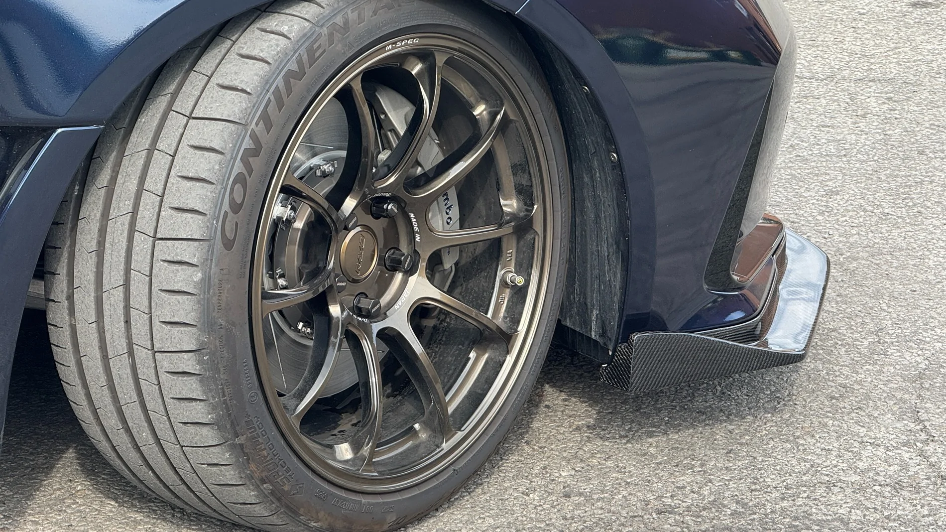

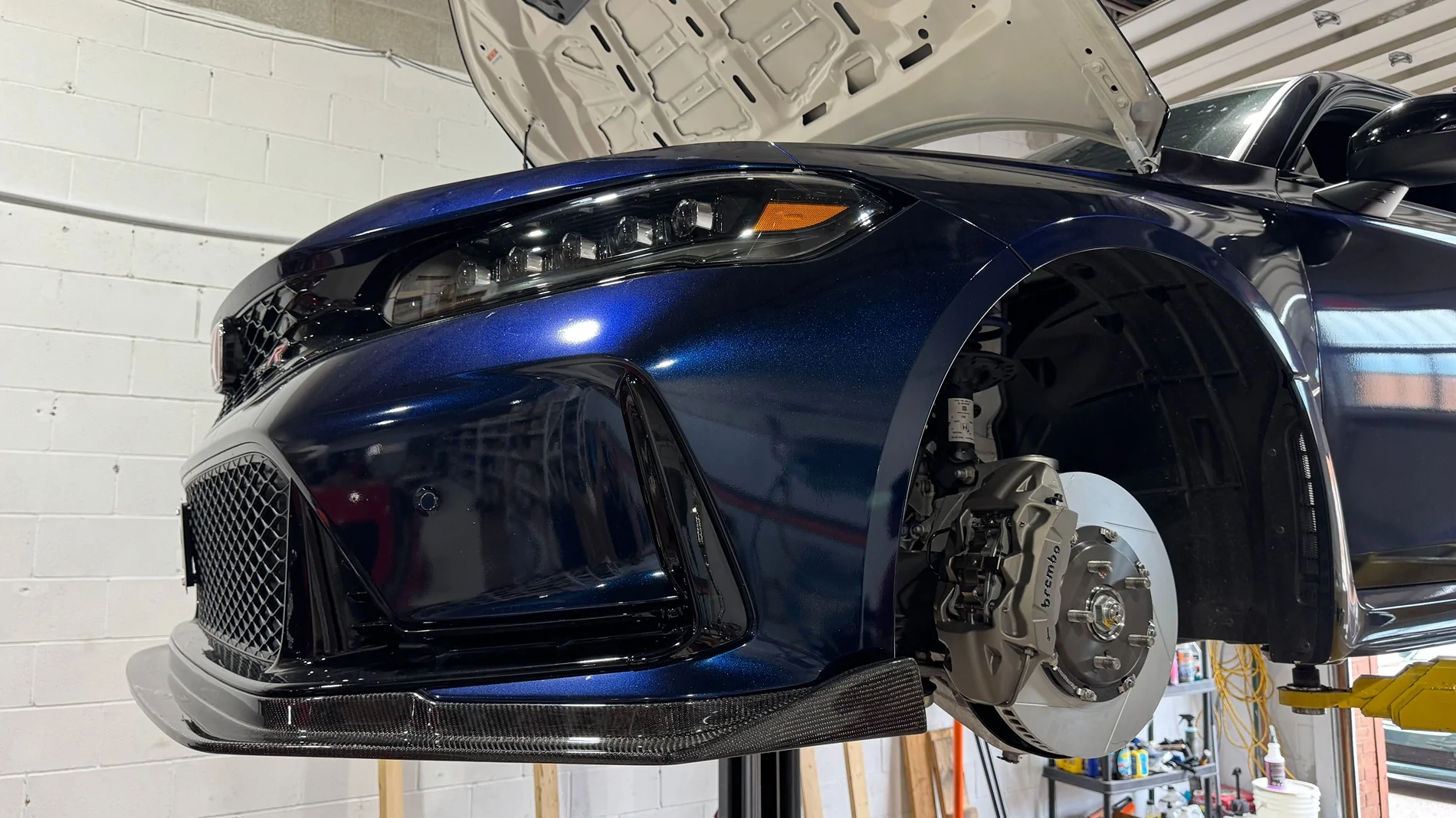

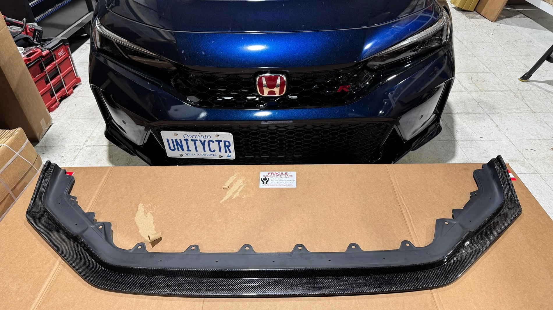

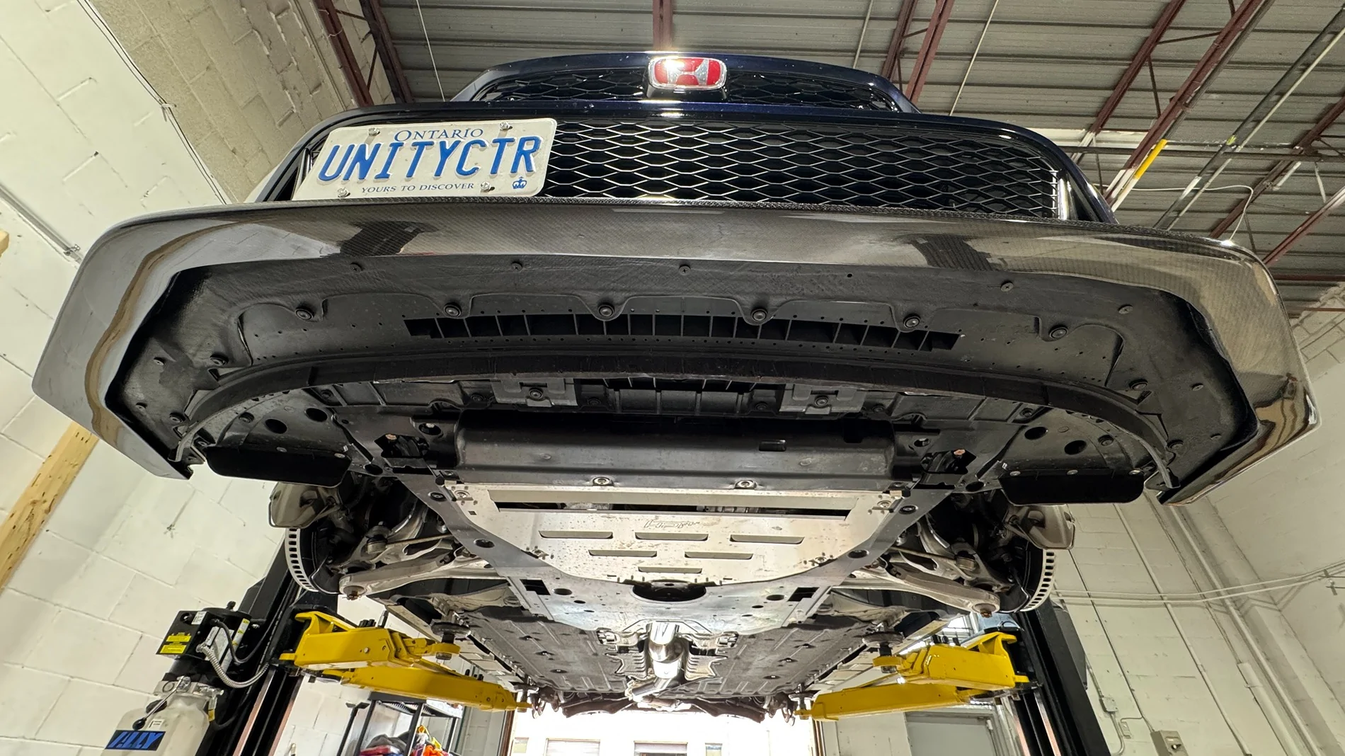

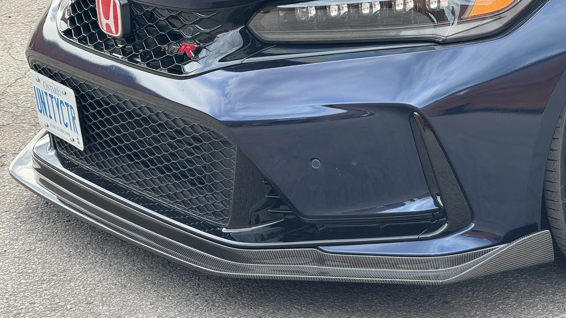

The Seibon TA-style lip barely has any mentions online, so figured it deserved some coverage. Wanted something sleek without sacrificing ground clearance, and this barely takes anything away. It extends about 2" from where it starts, a bit more than the 1-1.5" I'd have leaned toward, but seeing it on the car sold me, especially with the rest of the aero, the drop, and wider wheels/tires.
Biggest selling point: reuses all OE clip locations, pre-drilled for self-tapping screws. Also ran 3M double-sided tape as backup for future 60-130 testing, learned that lesson after losing a lip at 130mph on my FK8.
My buddy who installed it has done Mugen, Spoon, M&M, Aimgain, AFD and more, called this one of the easiest lips he's fitted, zero adjustments needed.
We carry it on the site, check it out here. Runs a bit higher than Seibon's own listing to cover $315 in freight, most Seibon products will end up priced this way as we add them.
11th Gen Honda Civic Unity Performance Humza's FL5 Build Thread IMG_7829
11th Gen Honda Civic Unity Performance Humza's FL5 Build Thread IMG_7838
11th Gen Honda Civic Unity Performance Humza's FL5 Build Thread IMG_7931
11th Gen Honda Civic Unity Performance Humza's FL5 Build Thread IMG_7932
11th Gen Honda Civic Unity Performance Humza's FL5 Build Thread IMG_7939
11th Gen Honda Civic Unity Performance Humza's FL5 Build Thread IMG_7936
11th Gen Honda Civic Unity Performance Humza's FL5 Build Thread IMG_7934
11th Gen Honda Civic Unity Performance Humza's FL5 Build Thread IMG_7967

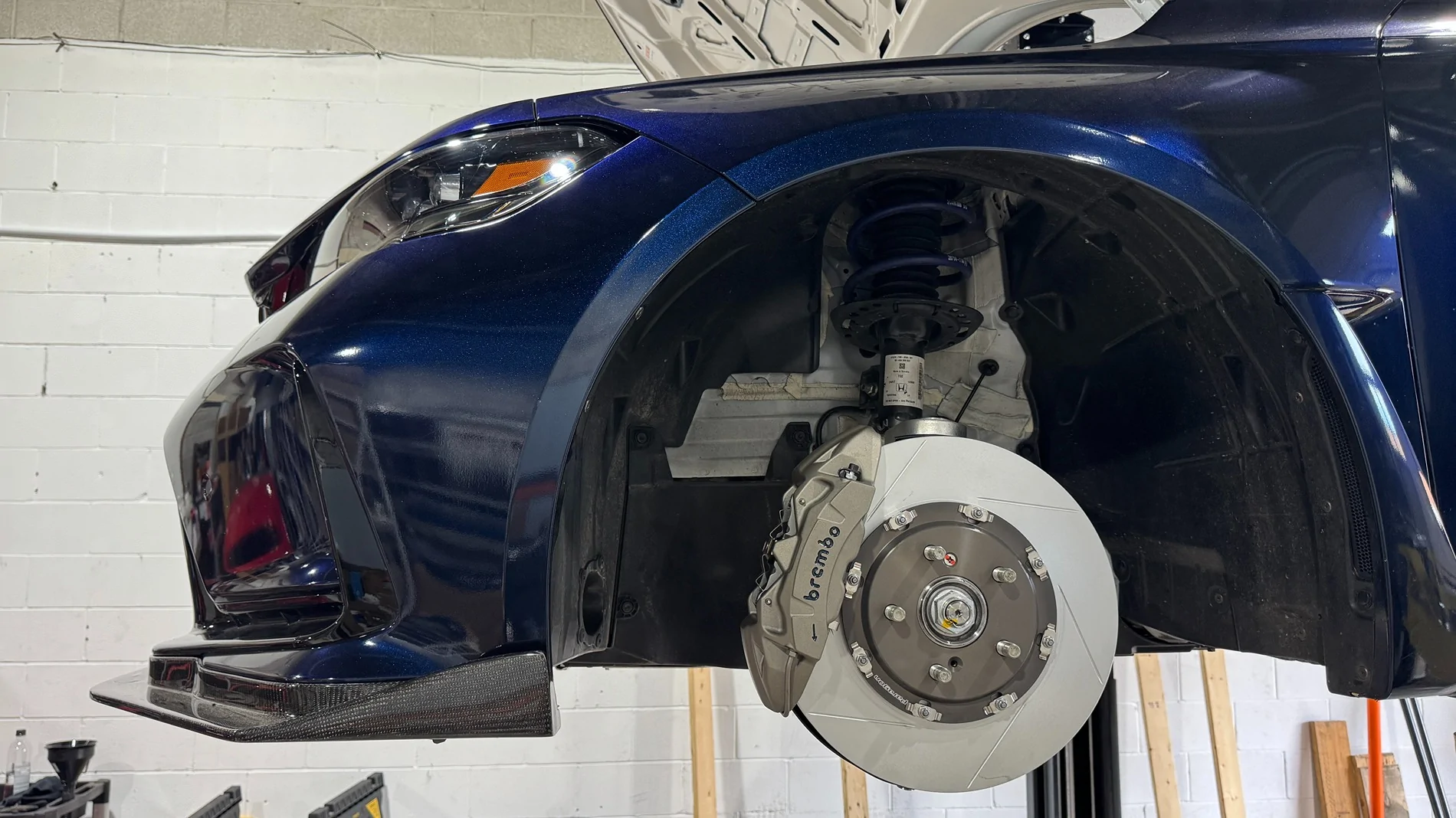

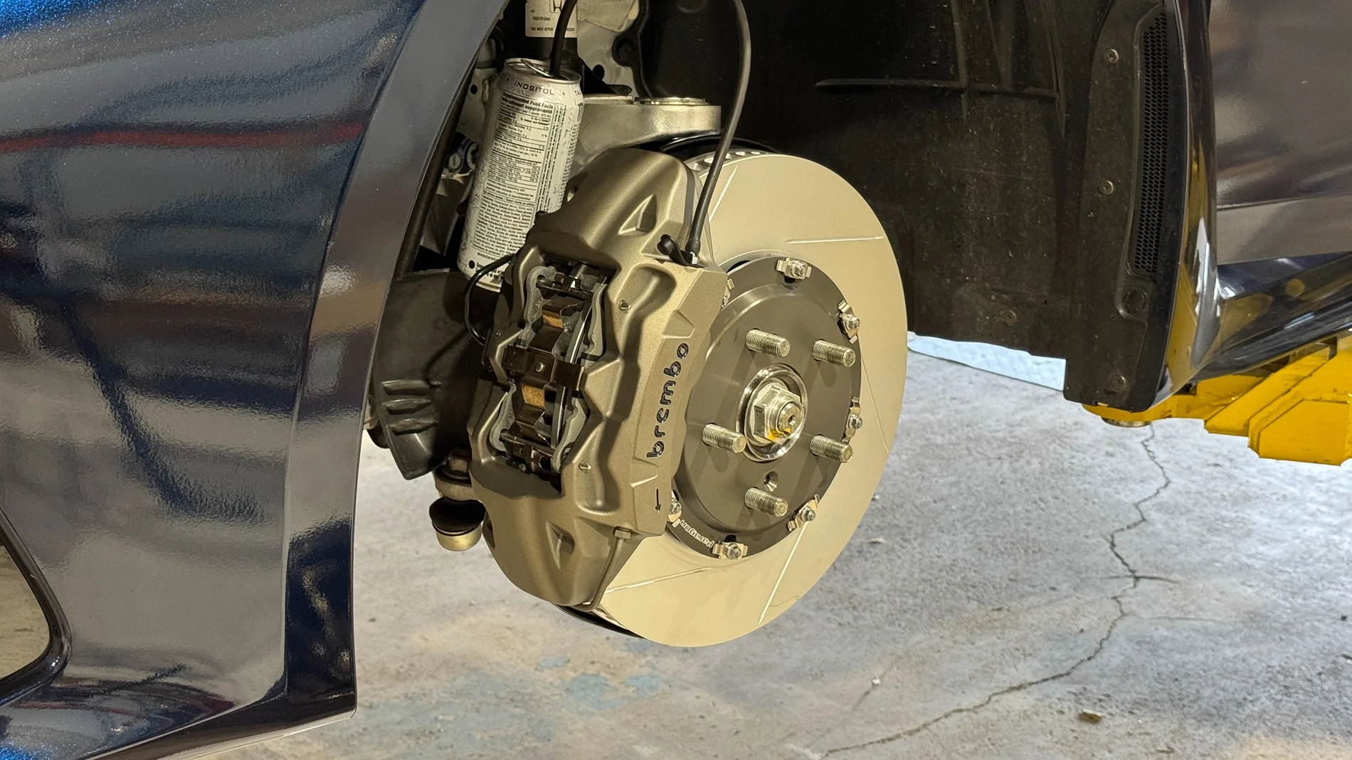

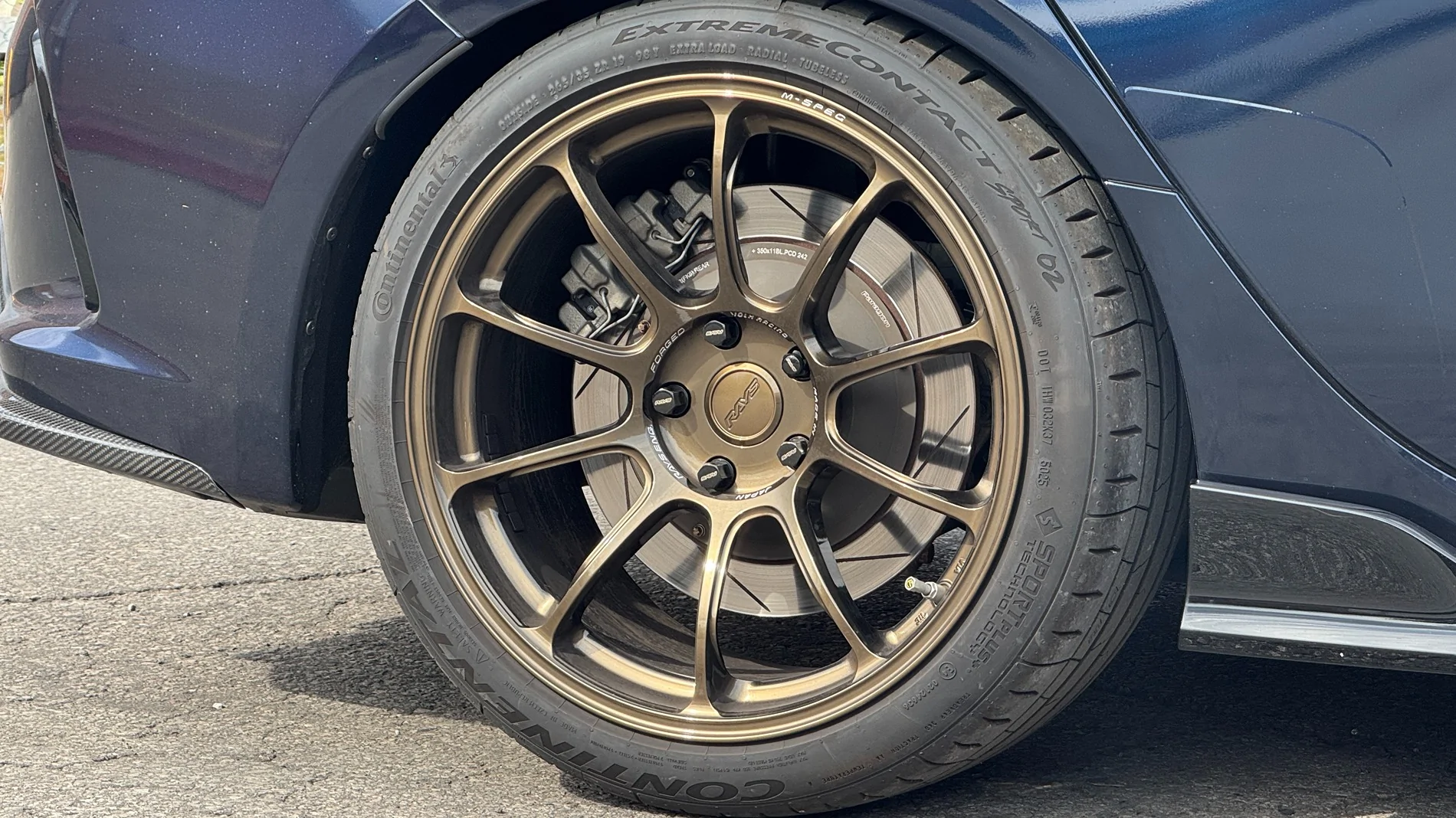

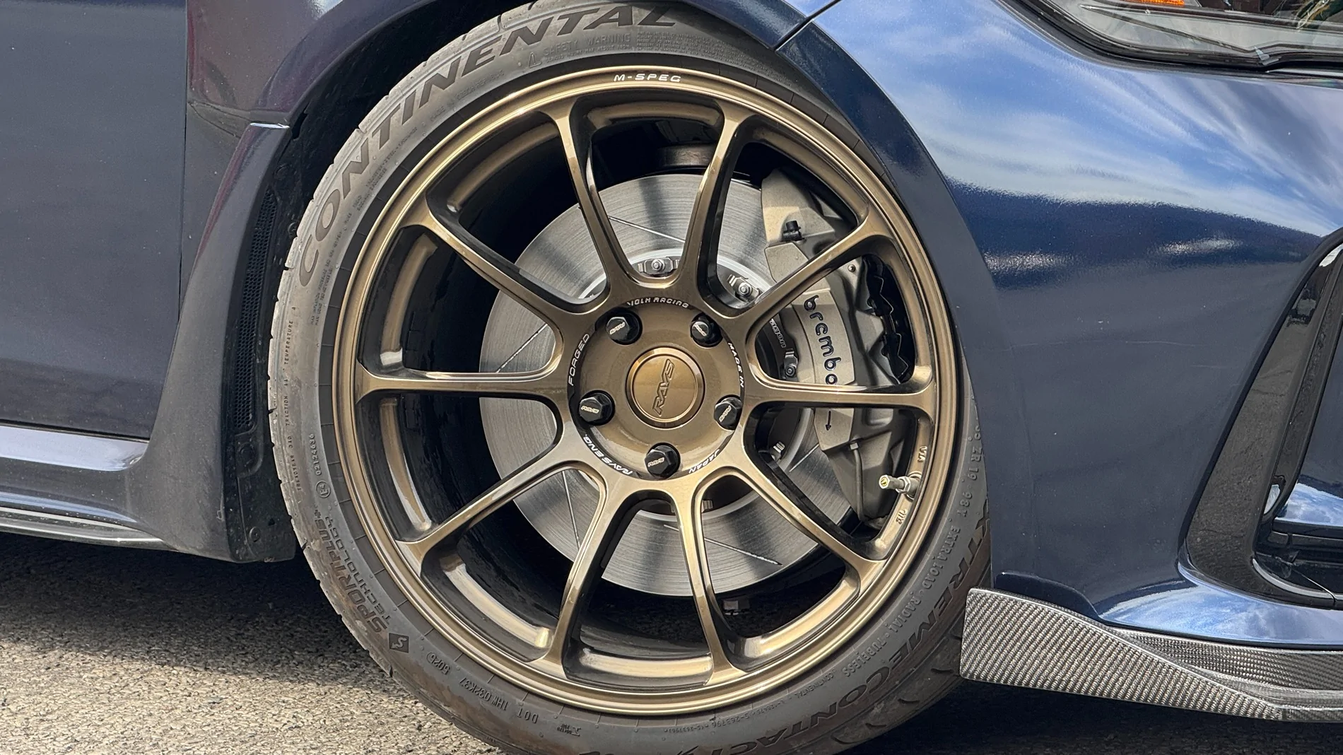

And since you see the brakes on the last post, let's talk about those as well :cool:
Finally installed the front and rear calipers I had rebuilt and refinished earlier this year. They read a bit bronze in photos, but they're actually Titanium Grey. Logo's 5-axis CNC engraved, a mix of the Brembo Pista and motorcycle division designs. Fun fact: the "e" in Brembo is meant to resemble a motorcycle helmet. It's filled in with mag blue to tie in with the wrap.
Couldn't call it complete without matching rears, so those got done too. I still had the Paragon 350mm rear kit from my FK8. Once that went on, keeping the stock front rotors wasn't going to look right, different hat color, slotted vs. blank. So I had a fresh set of fronts ready to go as well.
Added Brembo NAO ceramic front pads for less dust than OE, reused the OE rears, and threw in Wunderladen rear caliper bushings too. Only note on the pads: less initial bite and lower overall performance than stock. Not a track build though, so that's fine for now. If I do hit the track next season, I'll do a quick front swap first.
Really happy with how it all came together, unique without being flashy. If you’d want something similar done, hit up @higher.coats on IG for the custom work, and hit us up for any braking parts :)

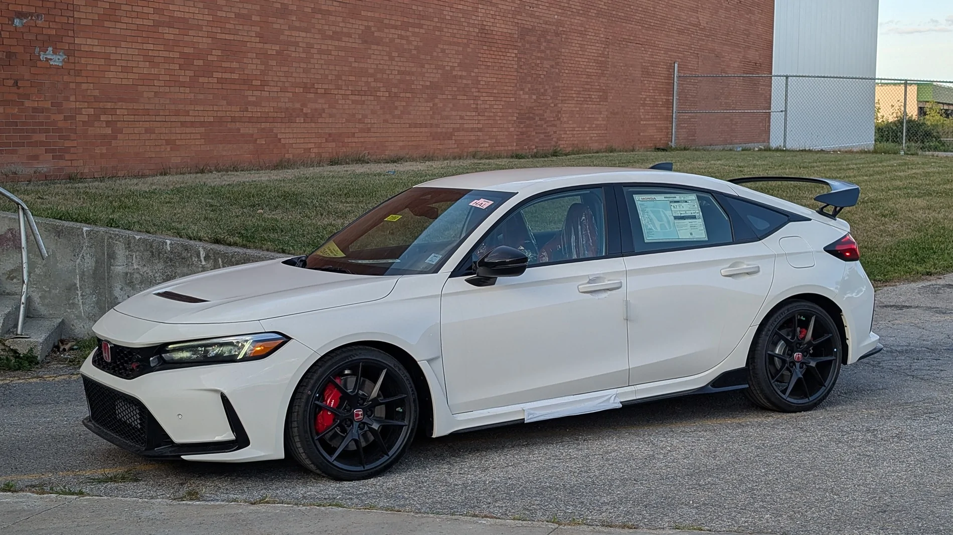

Wowza, I just realized that we took delivery on August 24th, 2025!
Ummm about being a dad build...well, I can still say that I comfortably swap the baby seat from our Lexus NX to the CTR, anytime it's needed, so we're still staying true to that theme? 😇
