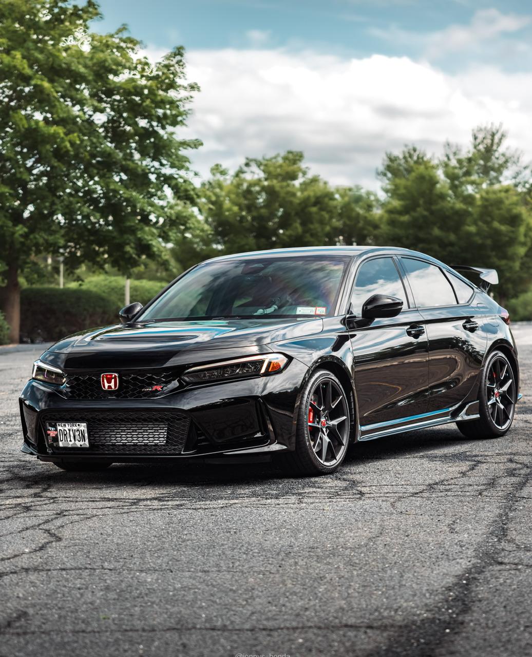

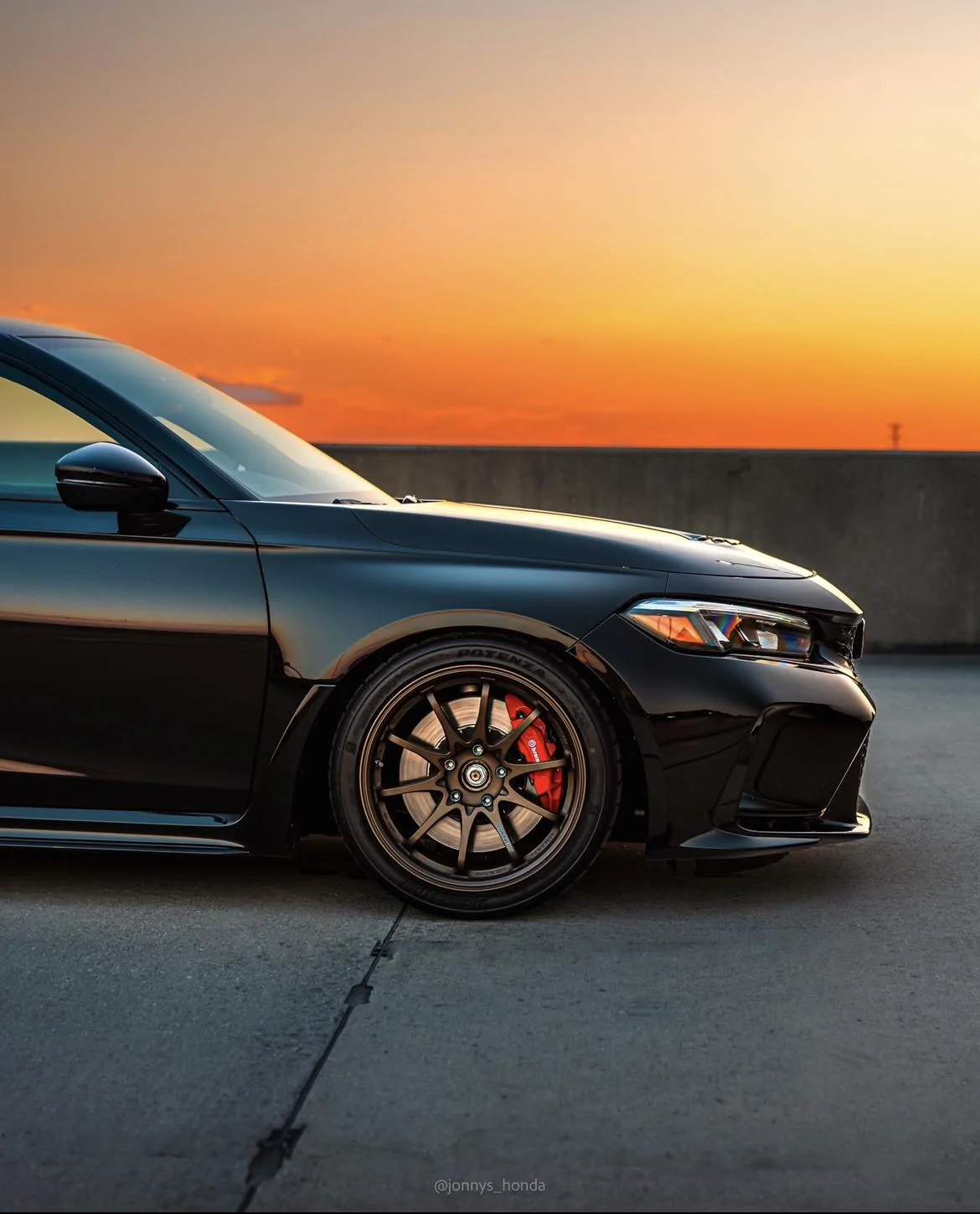

Eibach Sportline FL5 Spec!
They reached out to get a prototype over to me. The drop is great!!
Full resolution not support on this site but here’s a reduced file.
Note: All Images posted on my thread are for personal use only. Not to be used for commercial purposes without my written permission.

Which springs do you like more? Spoon or Eibach? Which ones do you think have a better ride quality?
The comfortable ride of spoon was very OEM like but the wheel gap did not look very appealing.
With Eibach Sportline FL5 spec, the drop looks great and the stiffness leads to a better driving feel at the cost of a little comfort.
Ultimately depends on what is important to you.

How much comfort is lost? The equivalent of driving around with the stock suspension set to sport or more towards driving in +R all the time? Maybe not as aggressive as +R but more towards that end of the spectrum? I definitely will want to lean more towards comfort. Anyways, thanks for the input!
