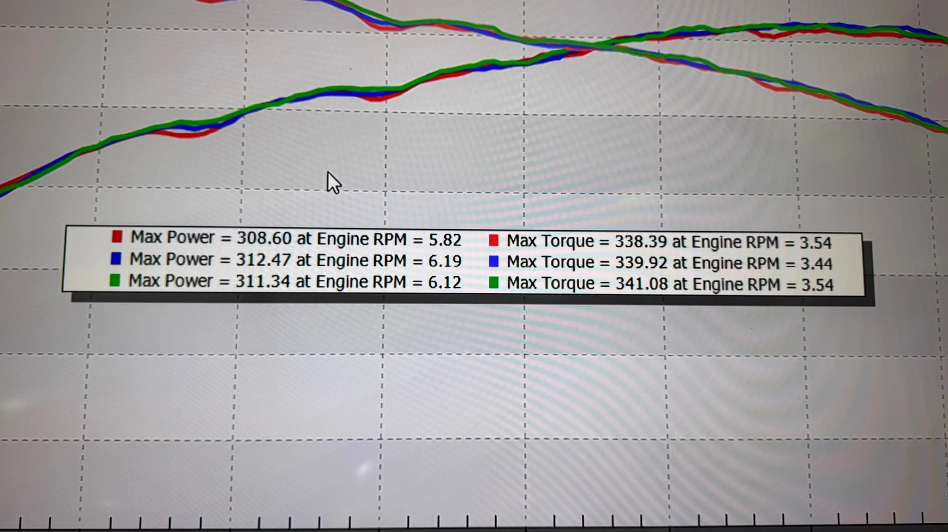

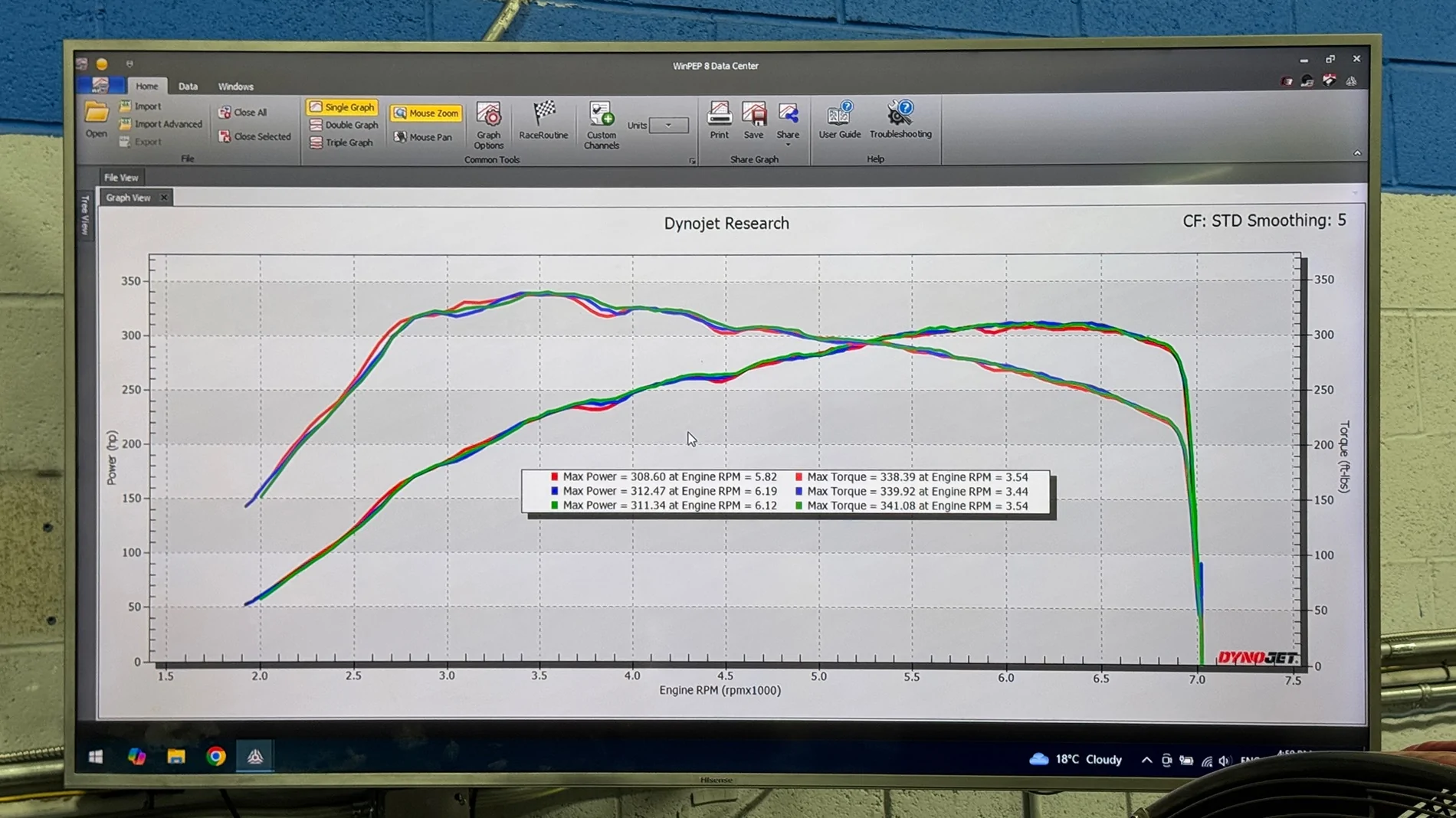

I’ve got some catching up to do here…

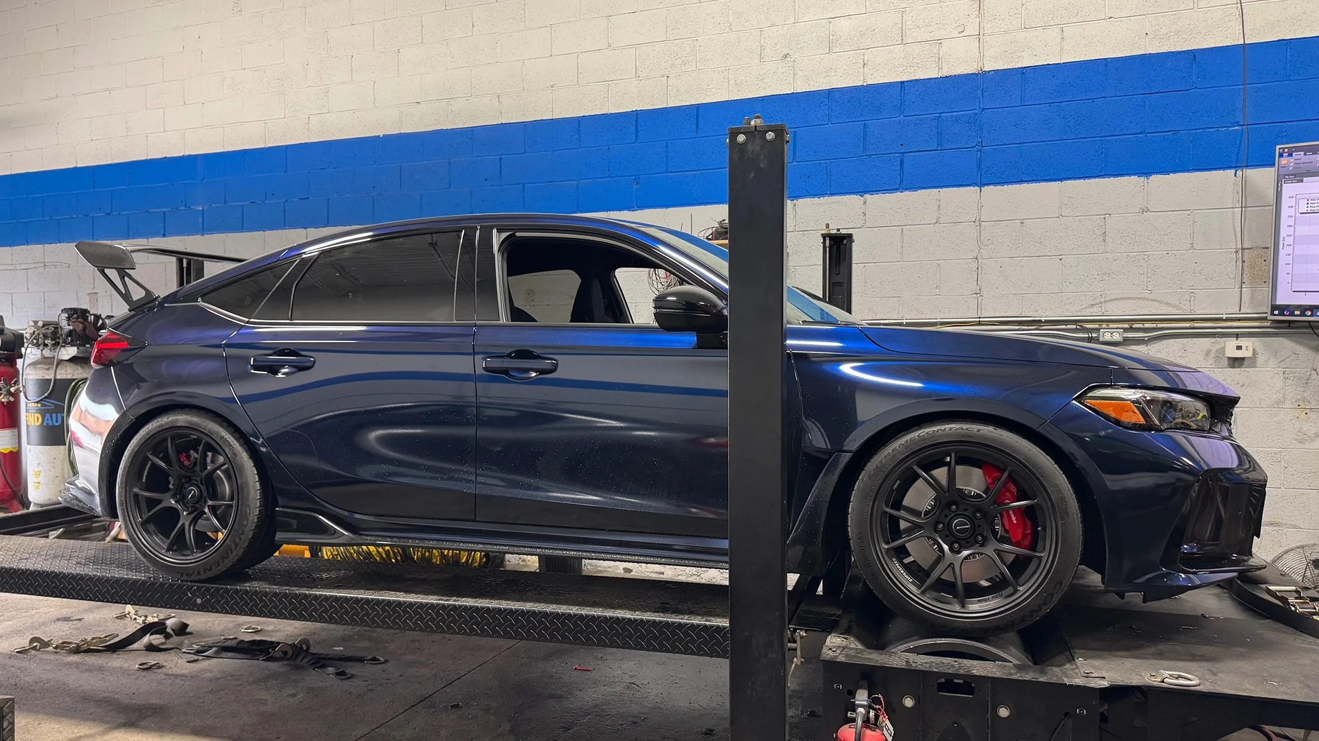

Got the car on the dyno in mid-April to establish some baseline numbers. We’ve been using this particular Dynojet for years, and the results have always been consistent with what you’d expect from other well-known dynos, including DRob’s.
I’m happy with this healthy baseline and the car felt every bit as quick as the numbers suggest. Only mods at this time were an MXP Catback and TSP Intake/Inlet Coupler.

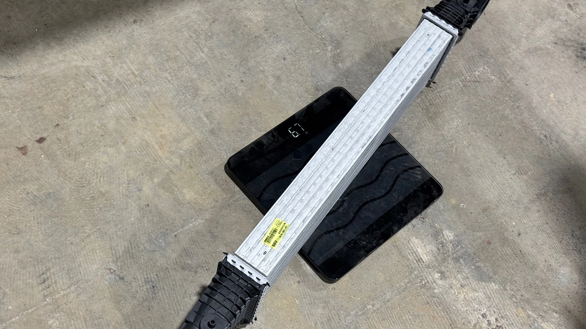

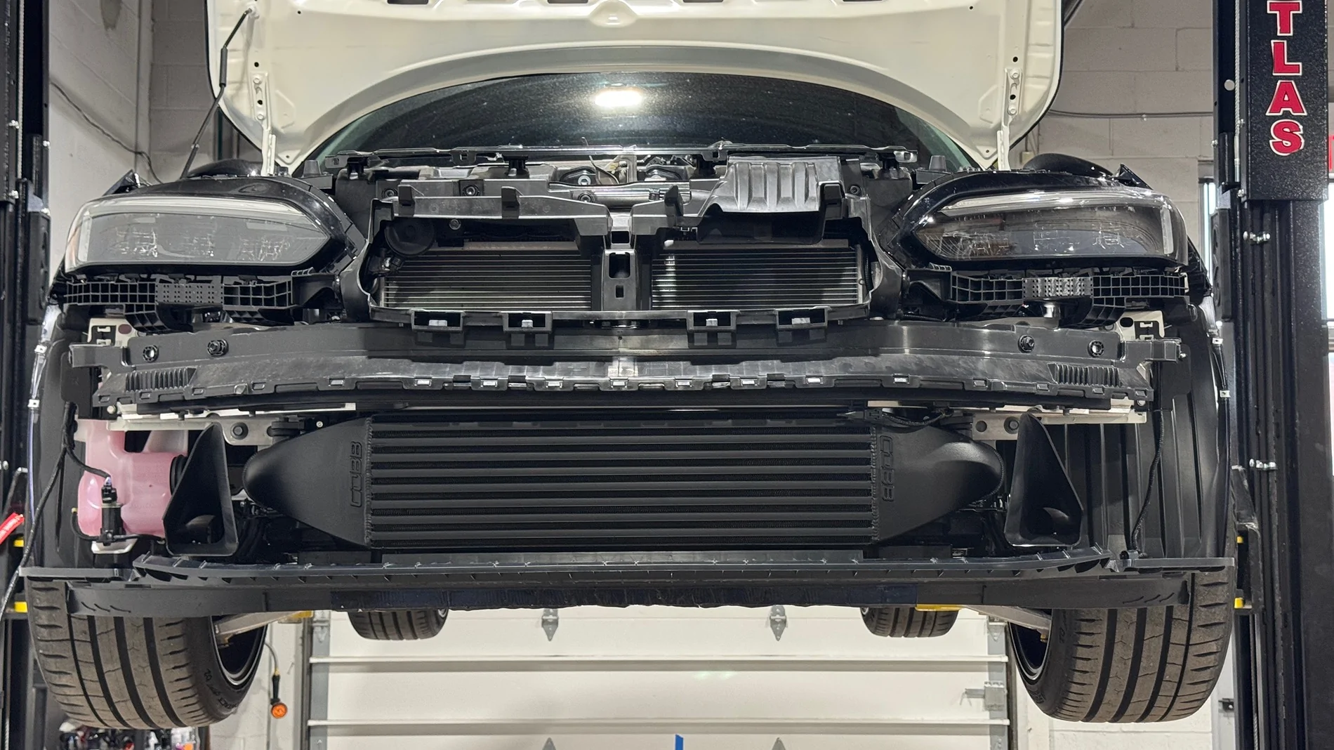

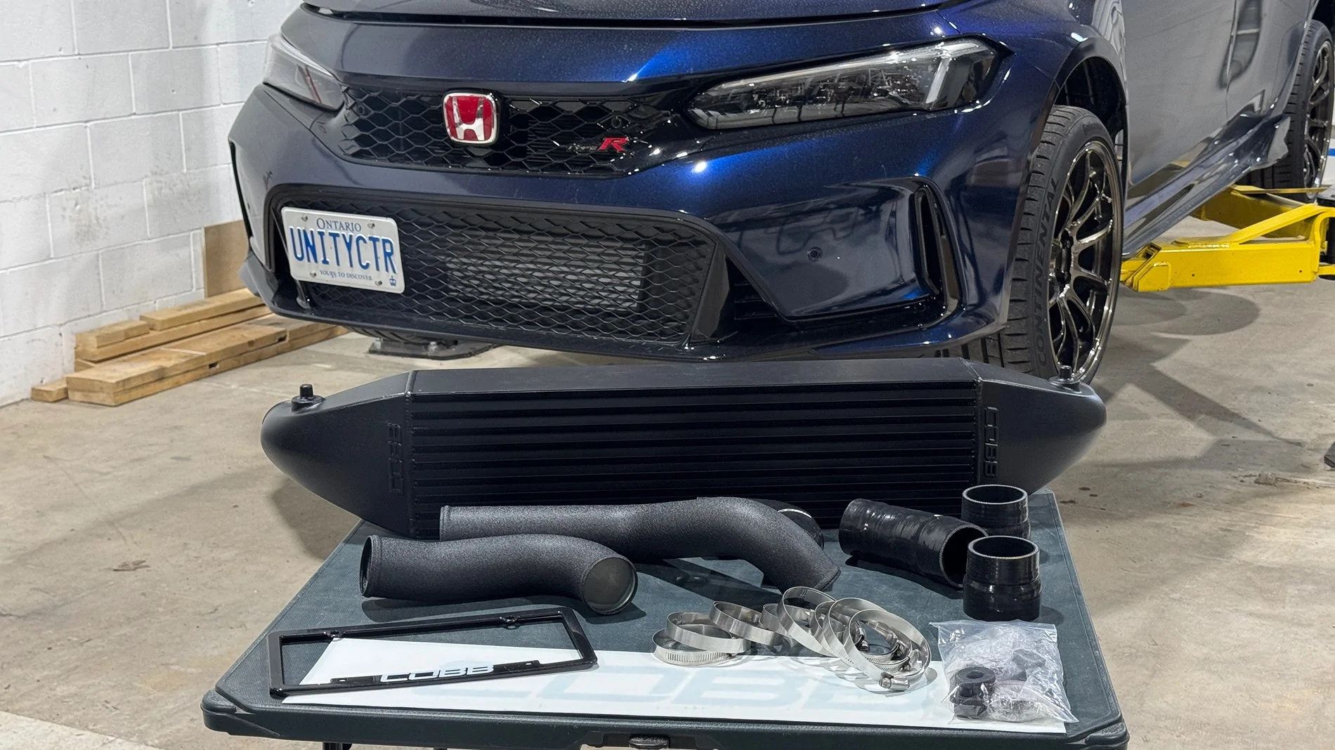

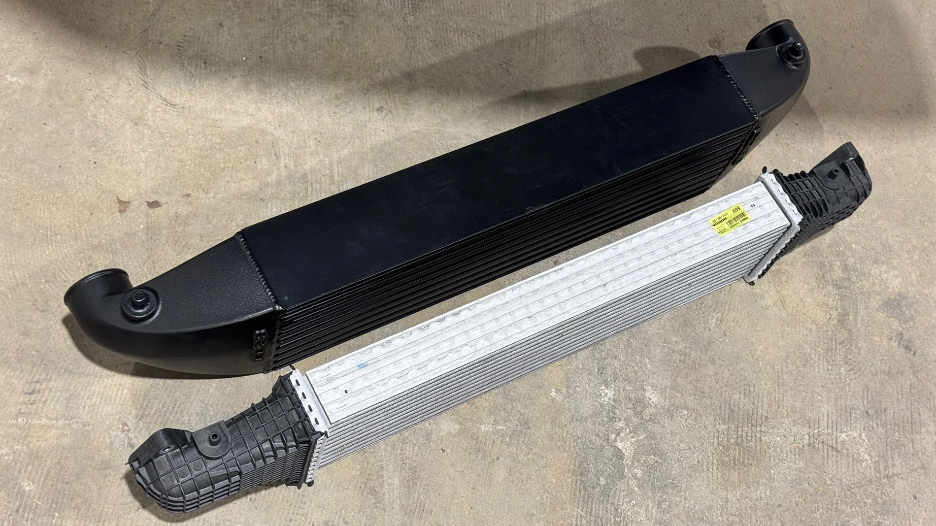

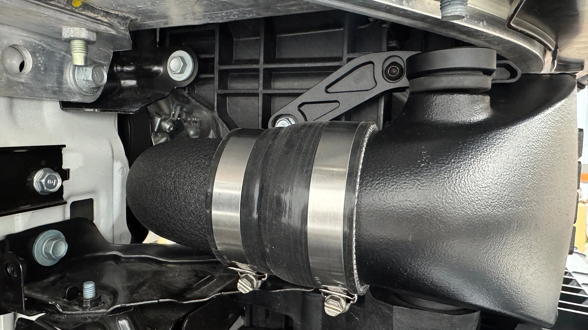

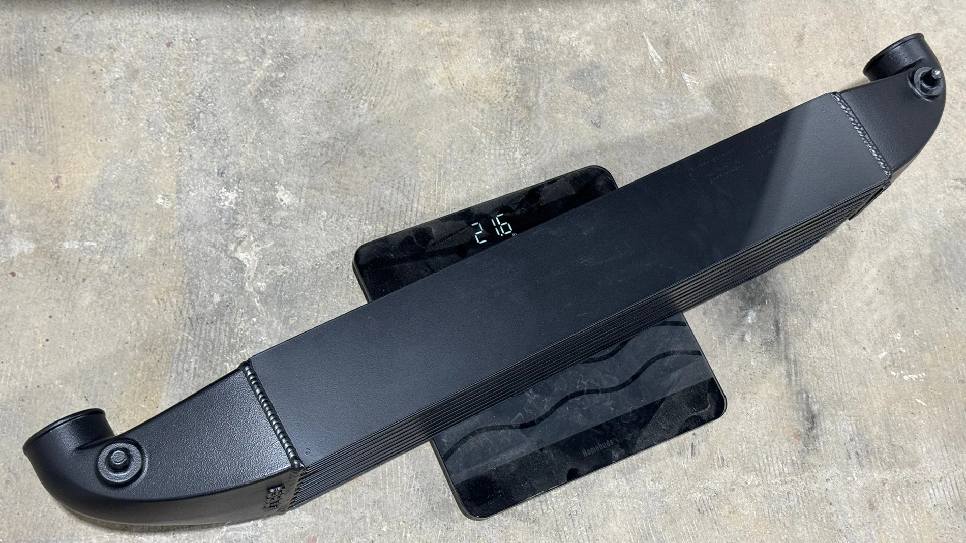

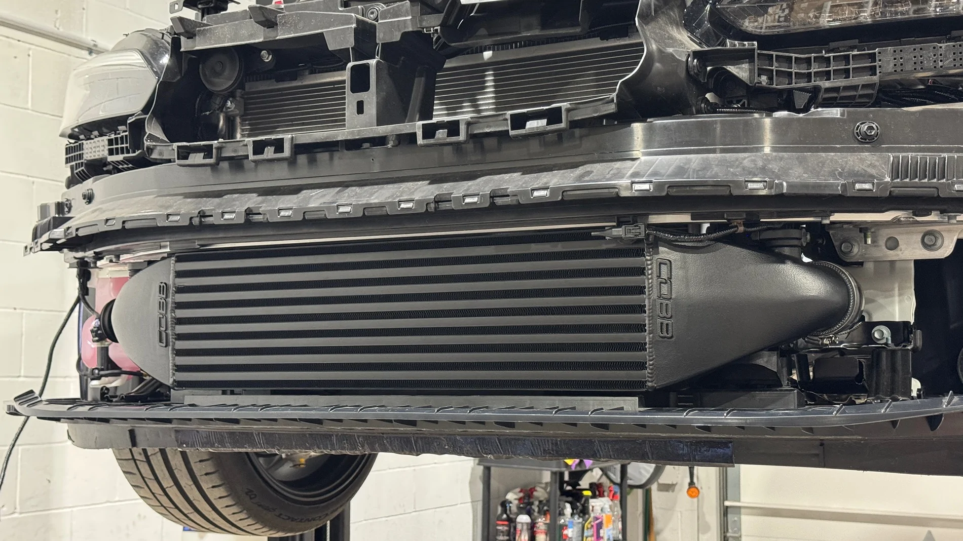

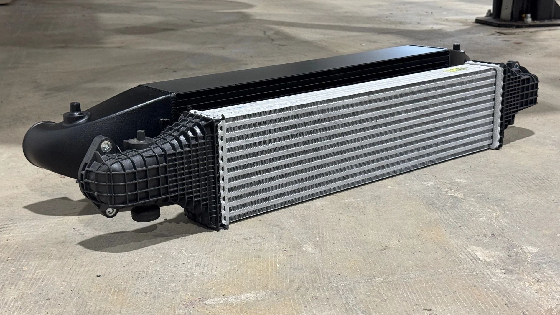

Got the COBB Intercooler Kit installed on May 14th. Since this car is primarily street-driven with future turbo and fueling upgrades planned, I opted for a bar-and-plate core over a tube-and-fin design.
Packaging and overall quality were excellent. The Garrett-manufactured core is paired with COBB’s own piping and brackets, which are sturdier and nicer than the factory pieces. Fitment was spot-on, with no trimming required on the FL5 despite the instructions mentioning it. We only had to remove the bumper guides due to the significantly larger core size.
While the bumper was off, we also installed a 27WON snorkel and WOT cooling plate. The goal is to maximize airflow while helping offset any cooling efficiency lost from removing the factory shroud.
Once everything was buttoned up, there were no CELs, fitment issues, or drivability quirks.

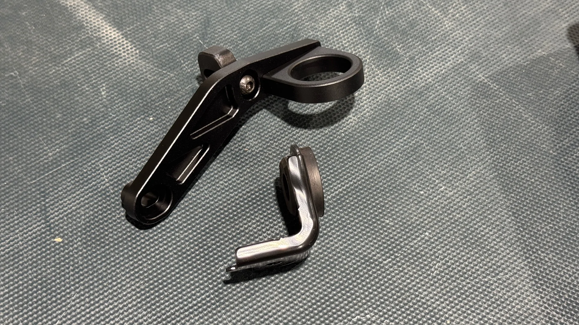

I had a used 27WON snorkel from a friend’s FL5 part-out, so with the bumper already off, it made sense to install it at the same time. It does require removing the factory shroud, which may raise some concerns, but for a primarily street-driven car I didn’t expect it to have any meaningful impact on coolant temperatures.
It would be difficult to compare intake air temperature data before and after the snorkel installation, as the Infinity Designs Intake and Inlet were installed at the same time. Any changes in IATs would be influenced by all three components, making it impossible to isolate the snorkel’s contribution on its own.
I do have plans to upgrade the Rad once the RV6 660AS goes on. It’s not a mandatory upgrade, but as power levels increase, so does the demand on the cooling system. Additional cooling capacity is a worthwhile step to help manage the extra heat and maintain consistent performance.

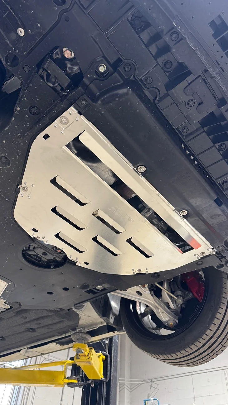

Also threw on the WOT Cooling Plate at the same time. It’s a pretty popular upgrade among track-driven FL5s, and as we slowly add more power, every little bit of cooling helps. It’s a simple mod that helps hot air escape the engine bay and fits right in with the goal of keeping temps in check.
