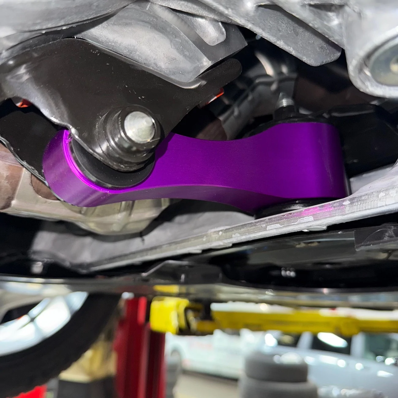

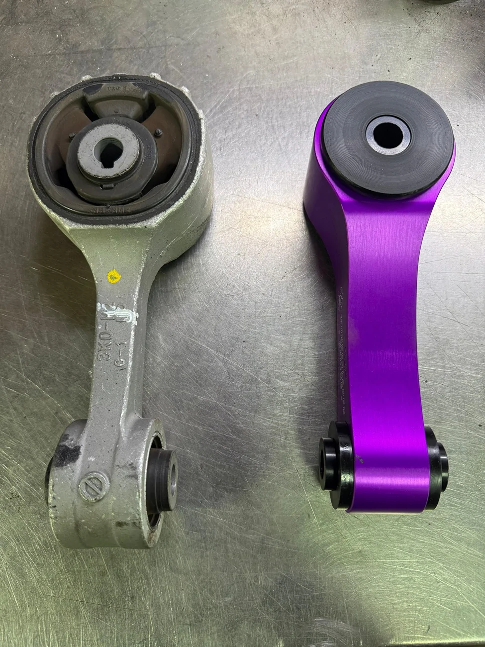

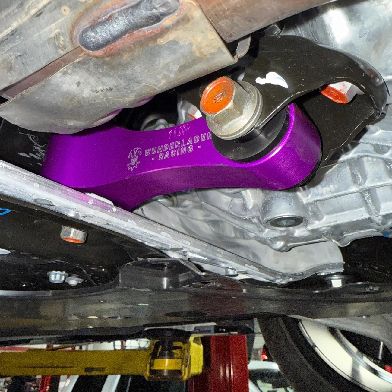

Towards the tail-end of FK8 ownership, I found the perfect RMM for me - Wunderladen with the Street Bushings. It offered what I had been seeking for a long time, which was performance of the 27WON Street RMM, with the low NVH matching the PRL RMM. I had both those mounts before, I tried Whiteline and Hasport as well, and also the Perrin Inserts so I’m pretty familiar with all the main brand offerings.
For this reason I was pretty set on using the Wunderladen Street for the FL5, just didn’t get to install it till now. I will say that the stock RMM is quite soft, and one can feel the drivetrain lurch during shifts, or when you’re ON/off throttle.
Shoutout to @Thusee for the RMM install, and the first oil change after 1,000 miles!
11th Gen Honda Civic Unity Performance Humza's FL5 Build Thread 7497a2ec-da94-4e7e-a300-102649ab94e9
11th Gen Honda Civic Unity Performance Humza's FL5 Build Thread 09040607-15dd-4fd7-bd86-9edd9bd77f59
11th Gen Honda Civic Unity Performance Humza's FL5 Build Thread b3e14fdc-2b4d-4ab4-8aec-3e6933e4c099
You do feel the extra rumble in the seat when you first fire up the car post-install, and minor amount when you’re setting off in first. Past that there’s no dash rattle or constant boom from the engine.
The shift feel is immediately improved as that lurch motion ON/OFF throttle has been removed from the driving experience. I’ve done some spirited pulls and shifting the last couple of days, there’s definitely more confidence in me to grab the next gear quickly at high RPM's.
On good weather days I’ll get the car out for more mileage so I can continue to break-in the RMM, but for now I’m more than satisfied.

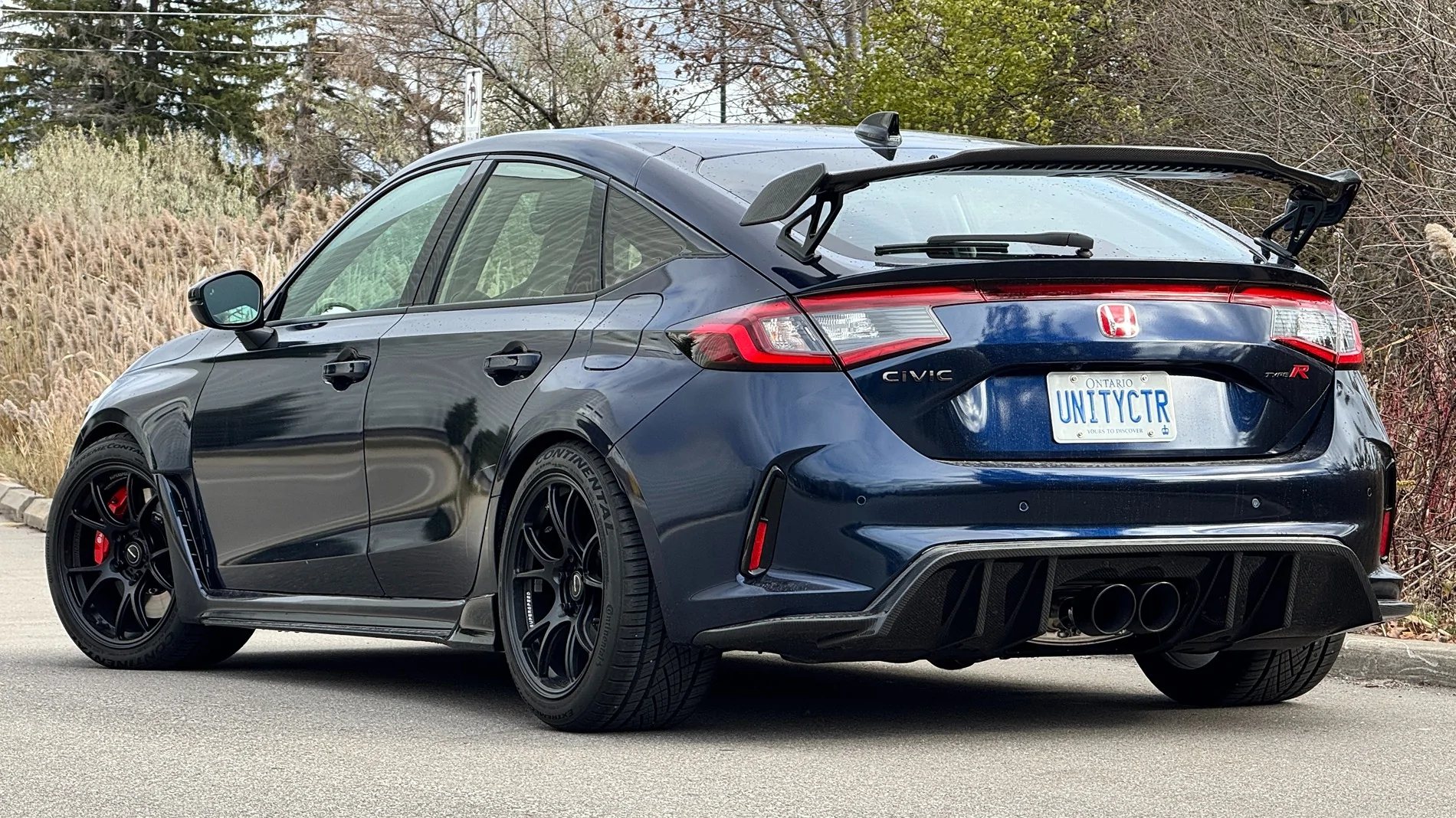

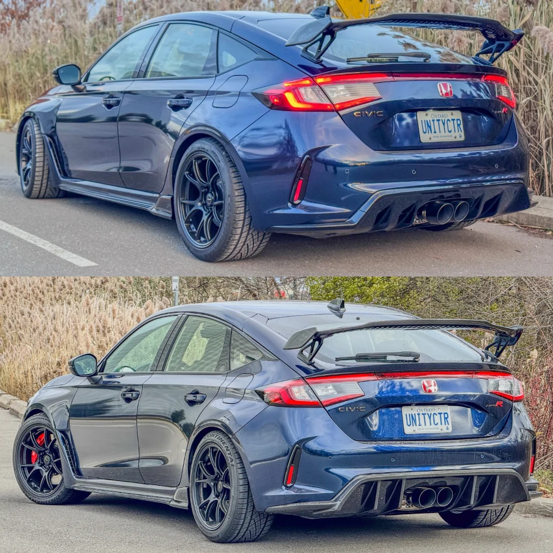

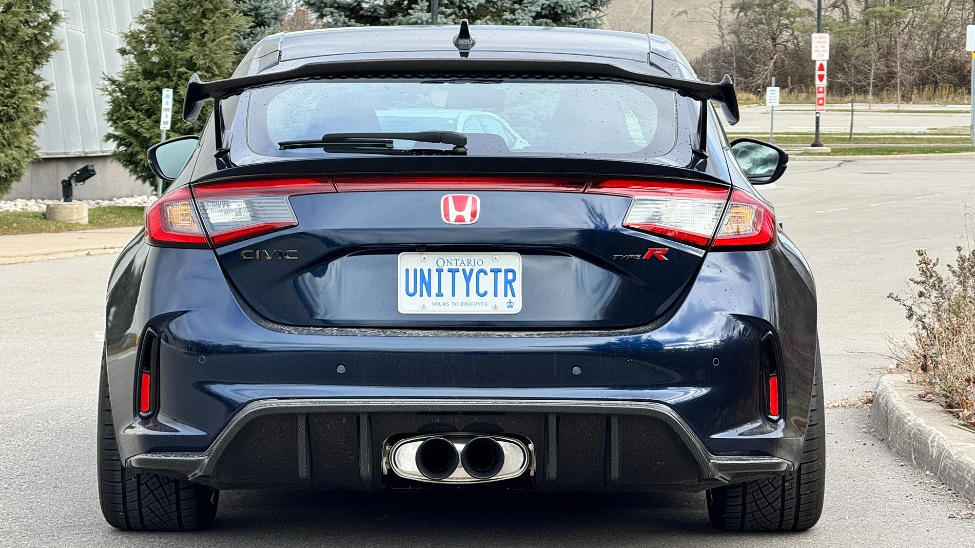

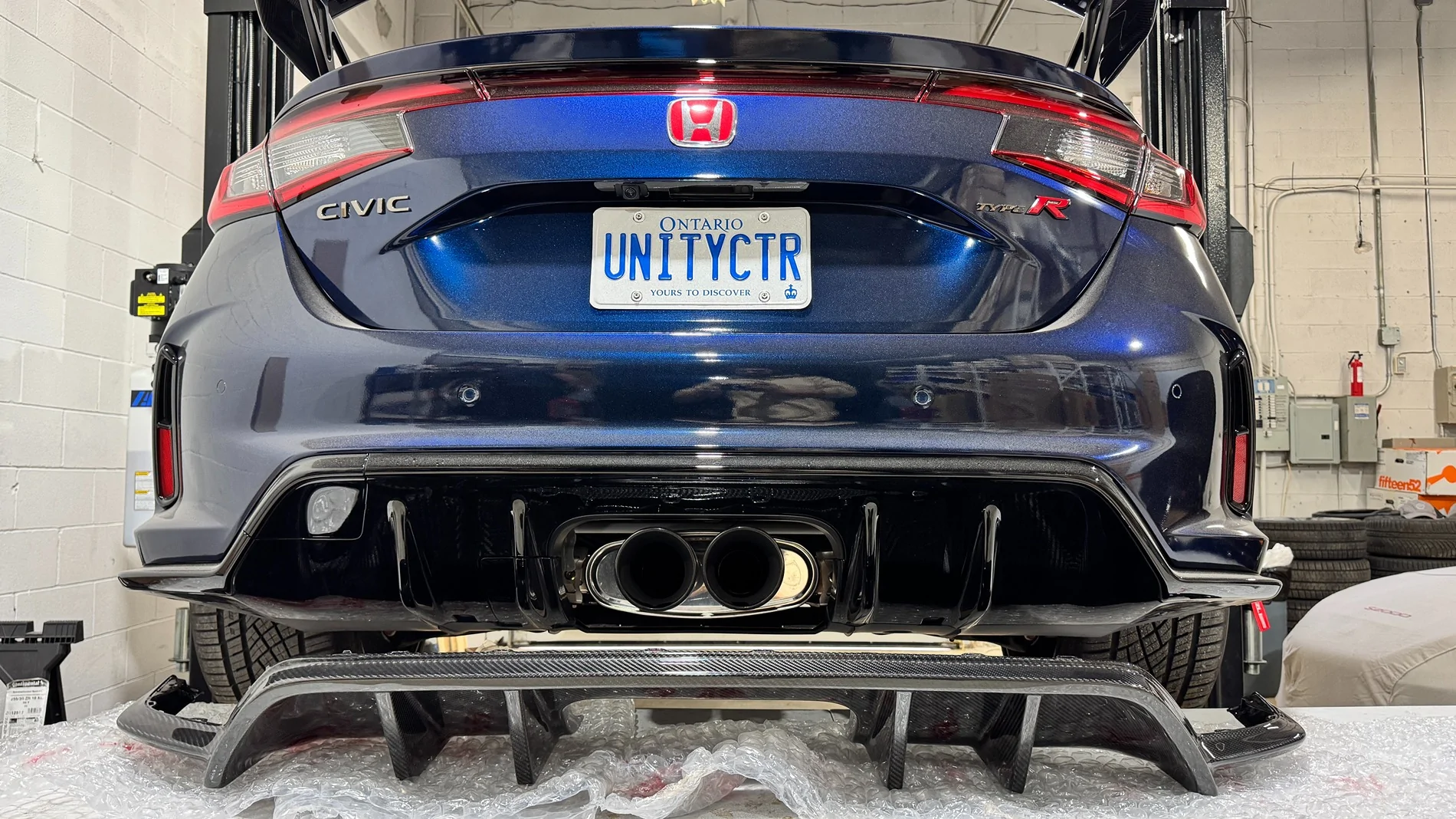

I still haven't decided on a front lip, but at least the šŸ‘ end has been taken care of!
APR Diffuser, 2.9lbs of Dry Carbon goodness! The factory diffuser is good but I wanted something more aggressive but nothing overly done - lot of options have extra number of fins, or spats that extend out to the side, which is just not me.
For the amount of money I spent on it I had big expectations, and I'm thankful that the final look delivered! If I don't mention that it has the diffuser swapped, I think any FL5 owner will do a double-take before they realize it's different. Rear toe hook isn't crucial for me, so losing access to it isn't a deal breaker.

APR does great work!
