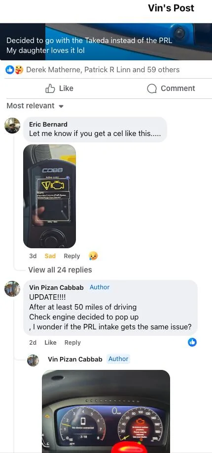

FYI, you cannot resolve the CEL this intake causes with a tune. There is a manufacturing flaw in some units that prevents proper installation of the MAF sensor.

Lots of CELs reported on Facebook for this intake, buyer beware.
Interesting. I may just cancel the order then. Which one do you guys recommend? PRL seems a little pain to install.
Correct! The issue will persist since it is a problem with the way the intake ventilates the evap system.
