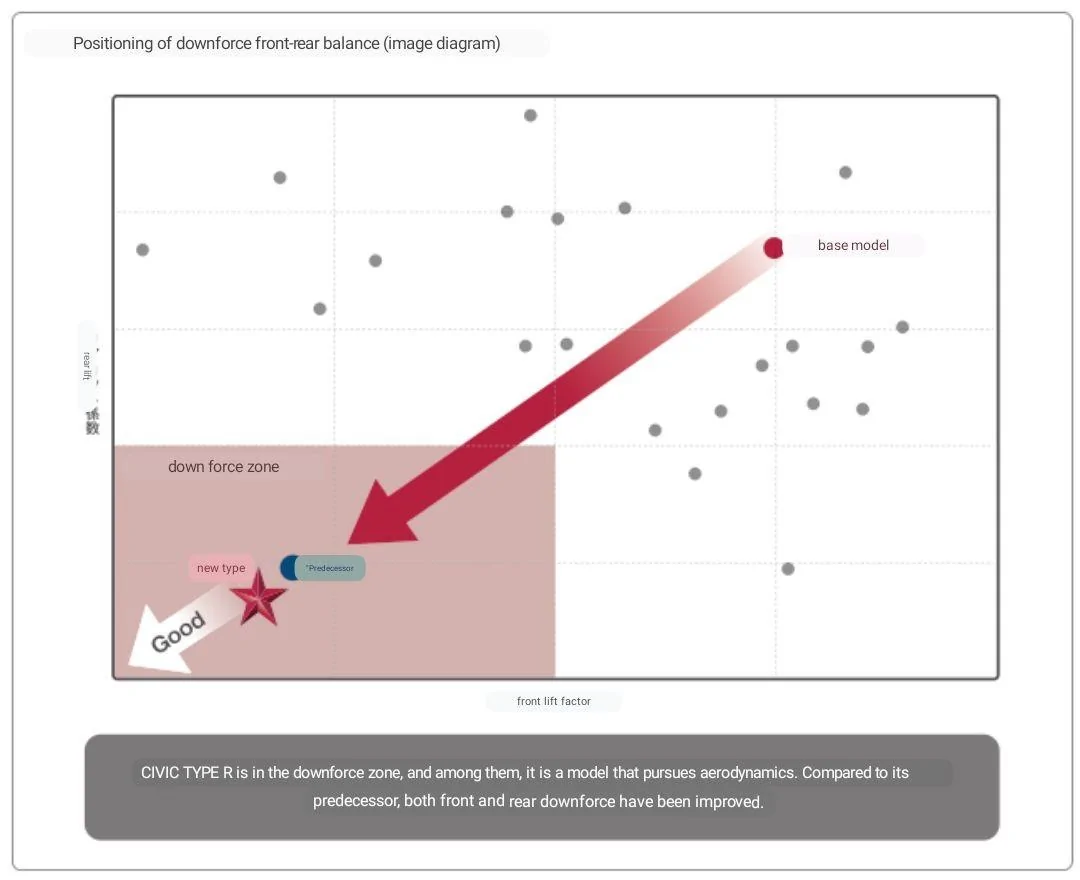

They presented a qualitative comparison between both cars:
11th Gen Honda Civic Downforce/lift/aero drag figures File_20230828-182959~2
