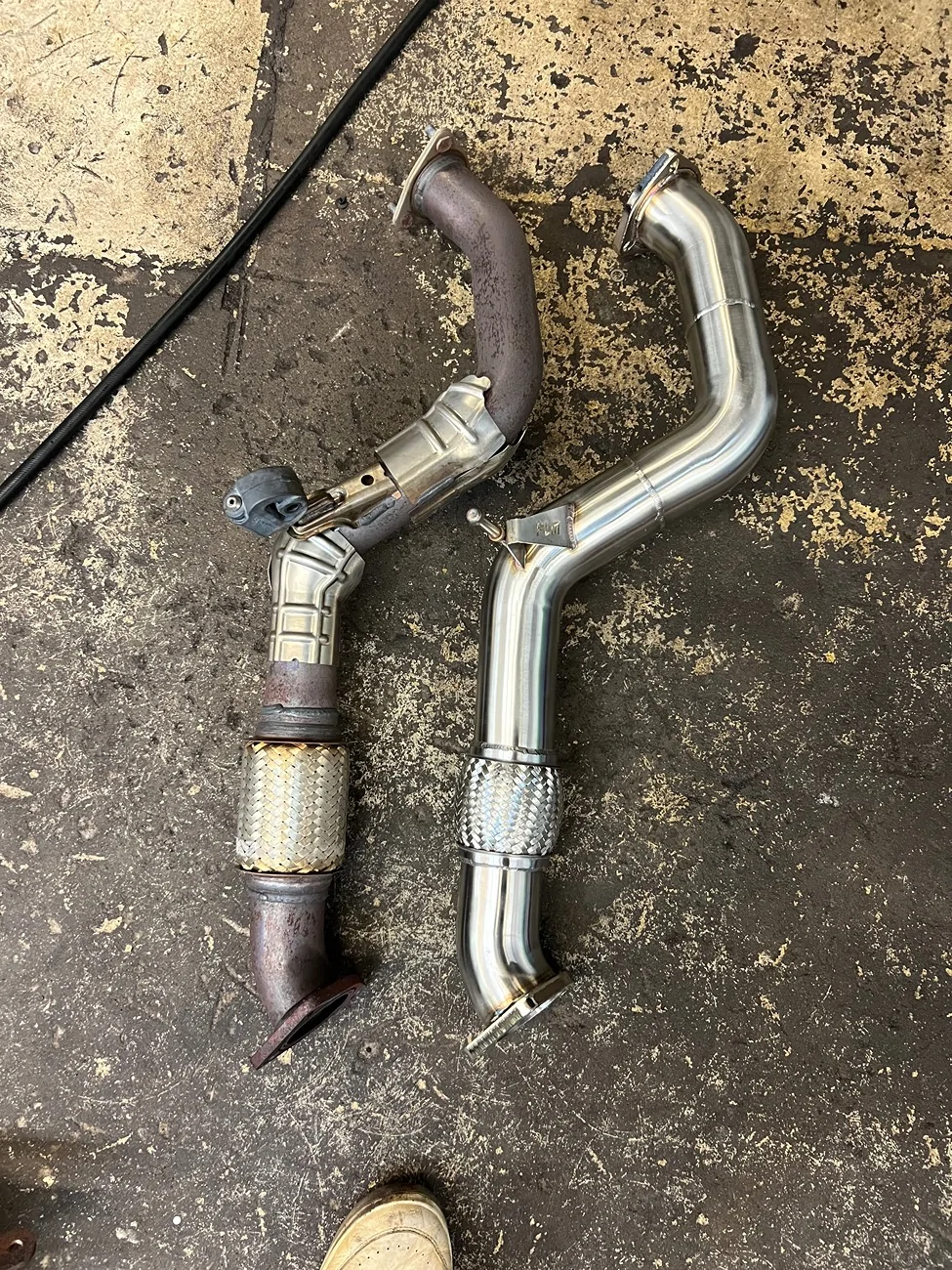

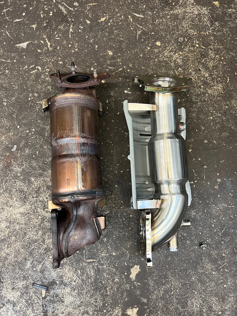

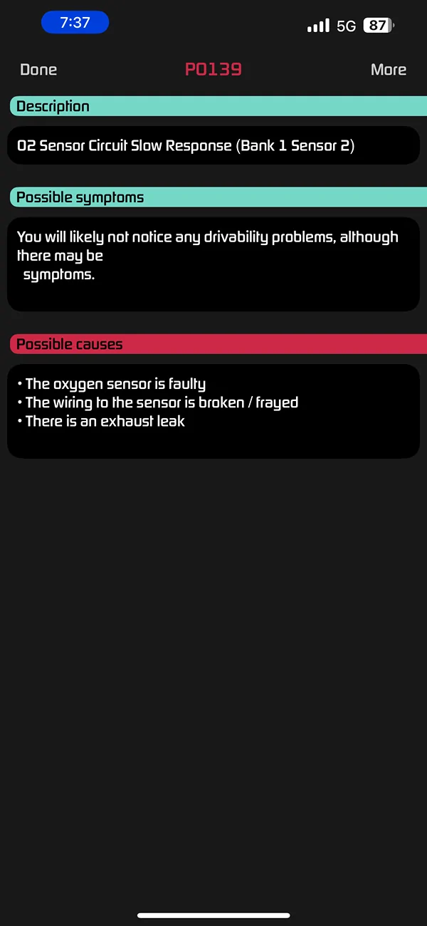

I recently installed a plm downpipe and I’m looking for a way to get rid of the cel (02 sensor/bank1 sensor2.
Looking how to disable this sensor, how to get it done using Hondata or even add it as a mod option nc I’m having trouble

Have you tried disabling the P0139 error in the DTC’s section of the misc. area of the calibration window and then uploading the calibration to the ECU?

Aug 4, 2025
New York
2025 FL5 Civic Type R
