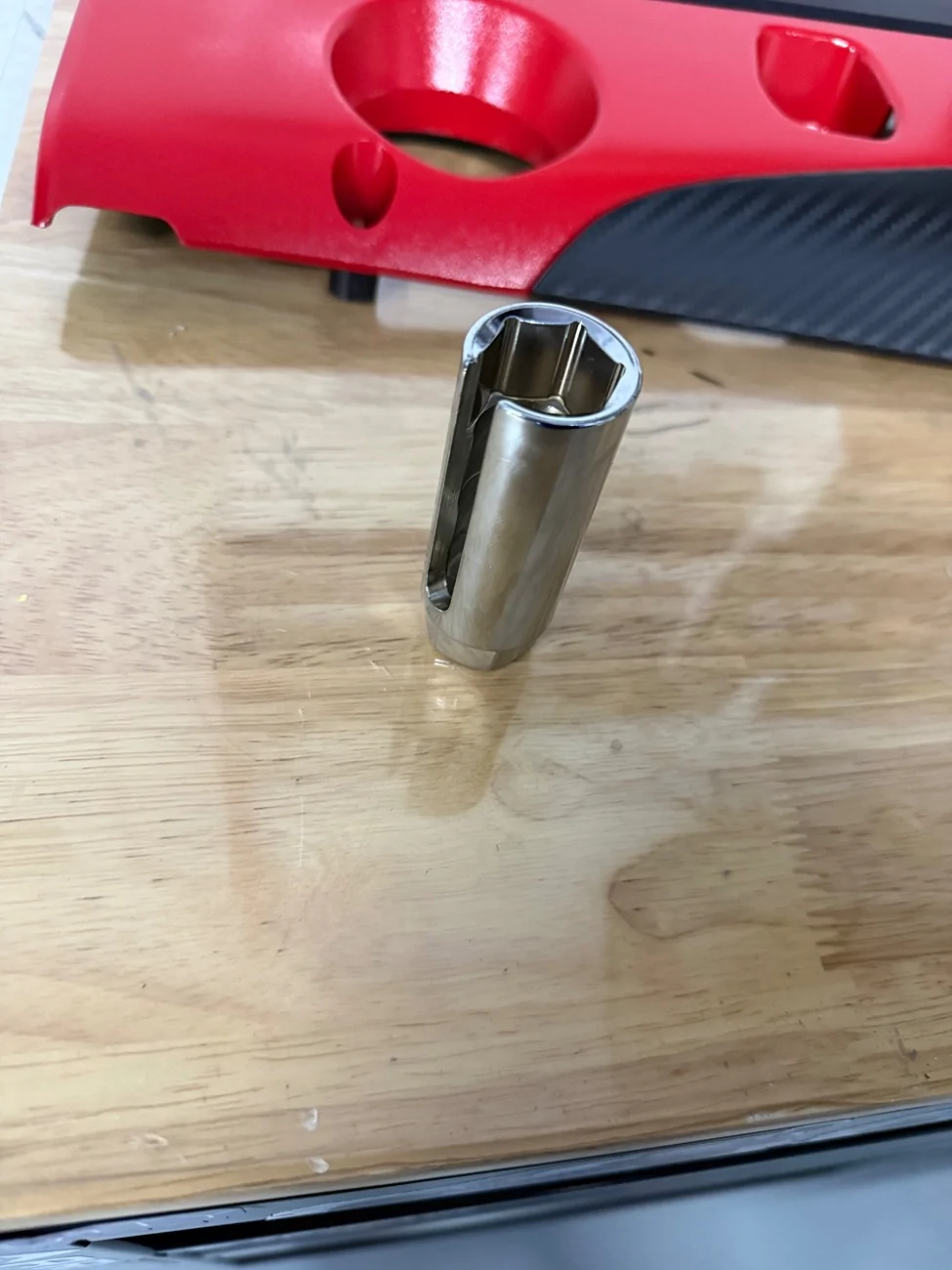

This tool:
11th Gen Honda Civic Downpipe install.. IMG_5655
Which I have used to remove o2 sensors for every car I have ever owned, doesn’t work on this car. It’s too thick to get down into the little shield this o2 sensor has. So if you have this, don’t use it as it won’t work.

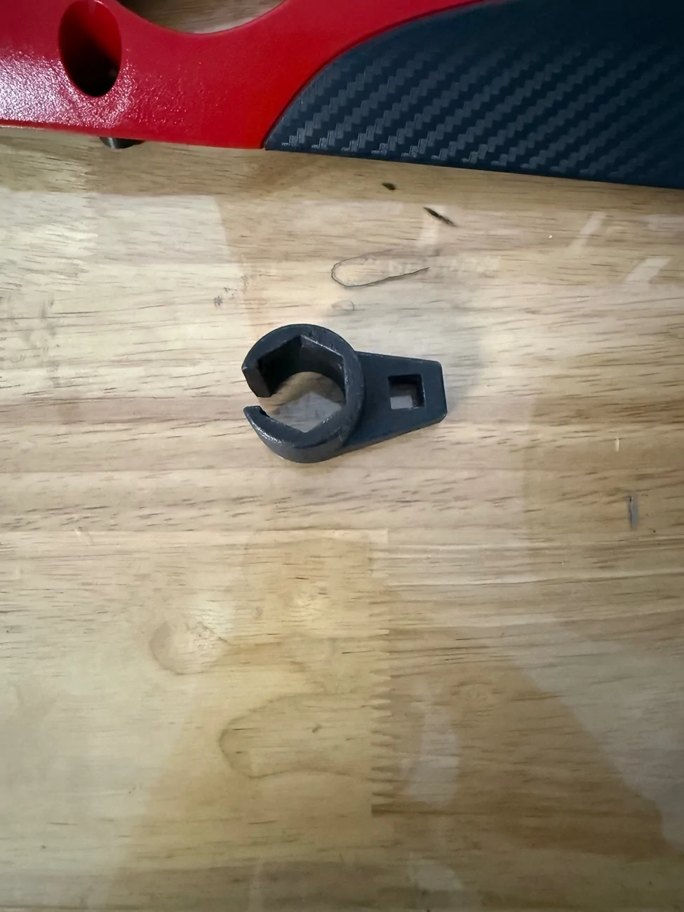

So, I went and bought this tool:
11th Gen Honda Civic Downpipe install.. IMG_5656
This tool (purchased at advanced auto) did a fantastic job of striping the o2 sensor nut. It’s the correct size but just did not work. Thin walled o2 sensor. I saw it spinning but all it was doing was spinning on the nut
So, in my infinite wisdom, I sprayed some PB blaster on it thinking maybe this thing is seized somehow.

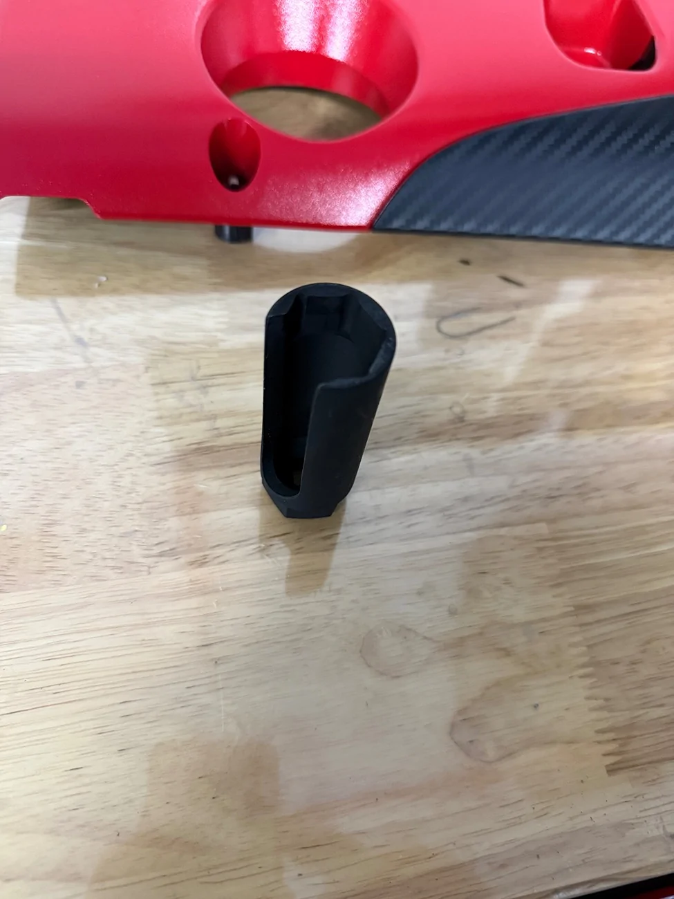

Then I went to Autozone and purchased this tool:
11th Gen Honda Civic Downpipe install.. IMG_5657
this was the tool that worked! However, once I got the o2 sensor out, I saw that some of the penetrating fluid had leaked down into the tip of the o2 sensor. Consensus is split whether this will negatively affect the o2 sensor reading correctly. Since I didn’t want to mess with that, I had to order a new one from Honda which cost me an additional $150 and it won’t be here for over a week since it’s special order and no one has it in stock 🤦🏻‍♂️.
Just a PSA for anyone attempting to install a downpipe at home. Have the right tool for the o2 sensor to avoid going through this. My car is down for a week now because of it.

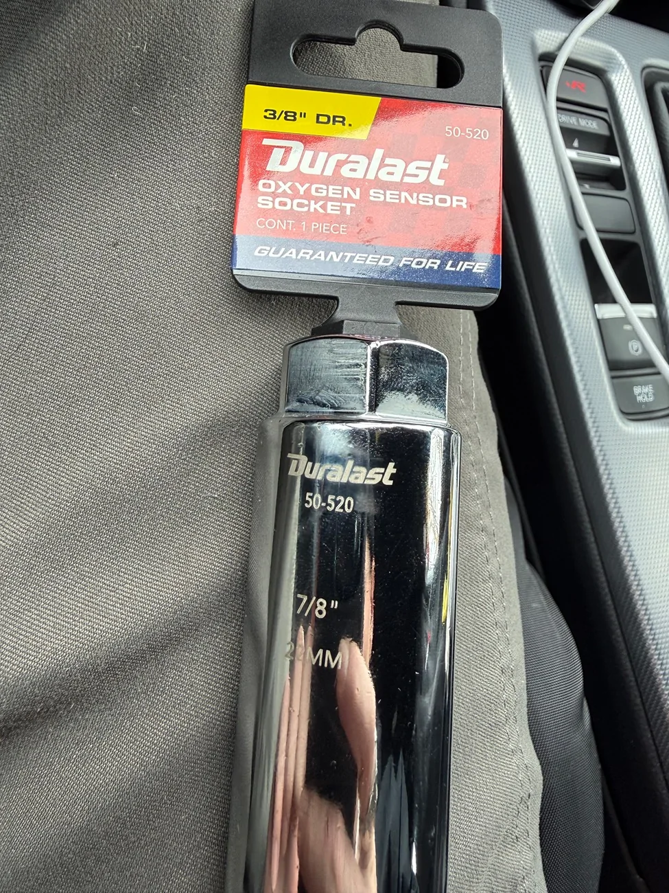

Sorry to hear about your issues. Do you have a brand and part number for this tool?
Thanks
