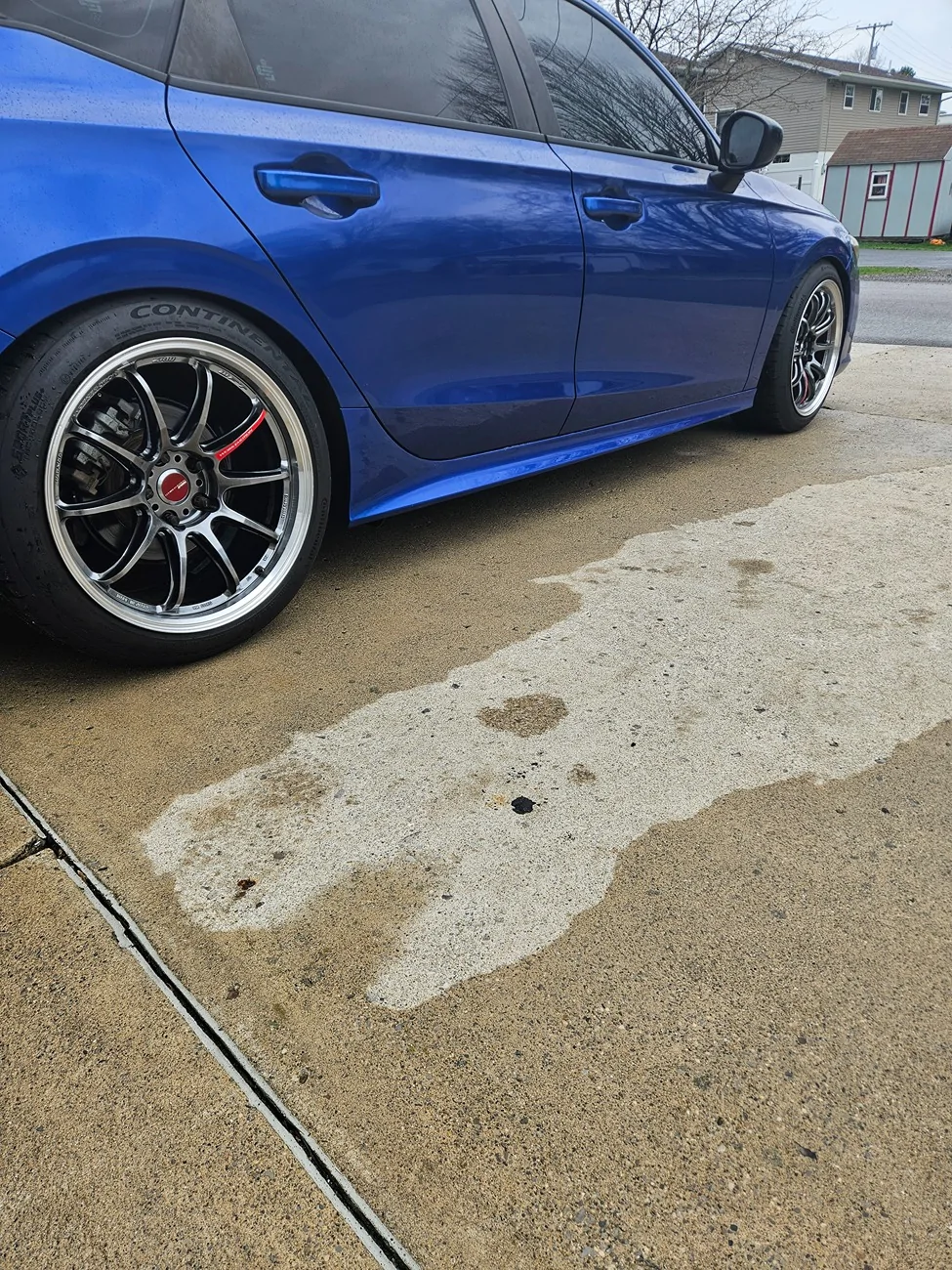

Anybody have the Eibach pro kit for the 11th gen with this issue?
I am getting vibration when going above 70 mph and the tpms light came on but tire pressure is good. Leads me to believe there is some sort of wheel speed issue after lowering.
Car has not been aligned yet.
Its on some work emotions 18x9.5 +38 245/40

What's up with that picture? It could just be the weird angle giving it a fish eye effect but it looks like the camber on your rear wheel is way out of whack. Is the wheel bolted on all the way???
I'm not familiar with the Si, but not having an alignment could easily contribute to vibration. If the toe is out significantly it could lead to all sorts of weirdness- oh and you probably are destroying your tires too.
Something ain't right, in any case but it's hard to tell from pictures (especially that one) and zero context other than "springs installed".
