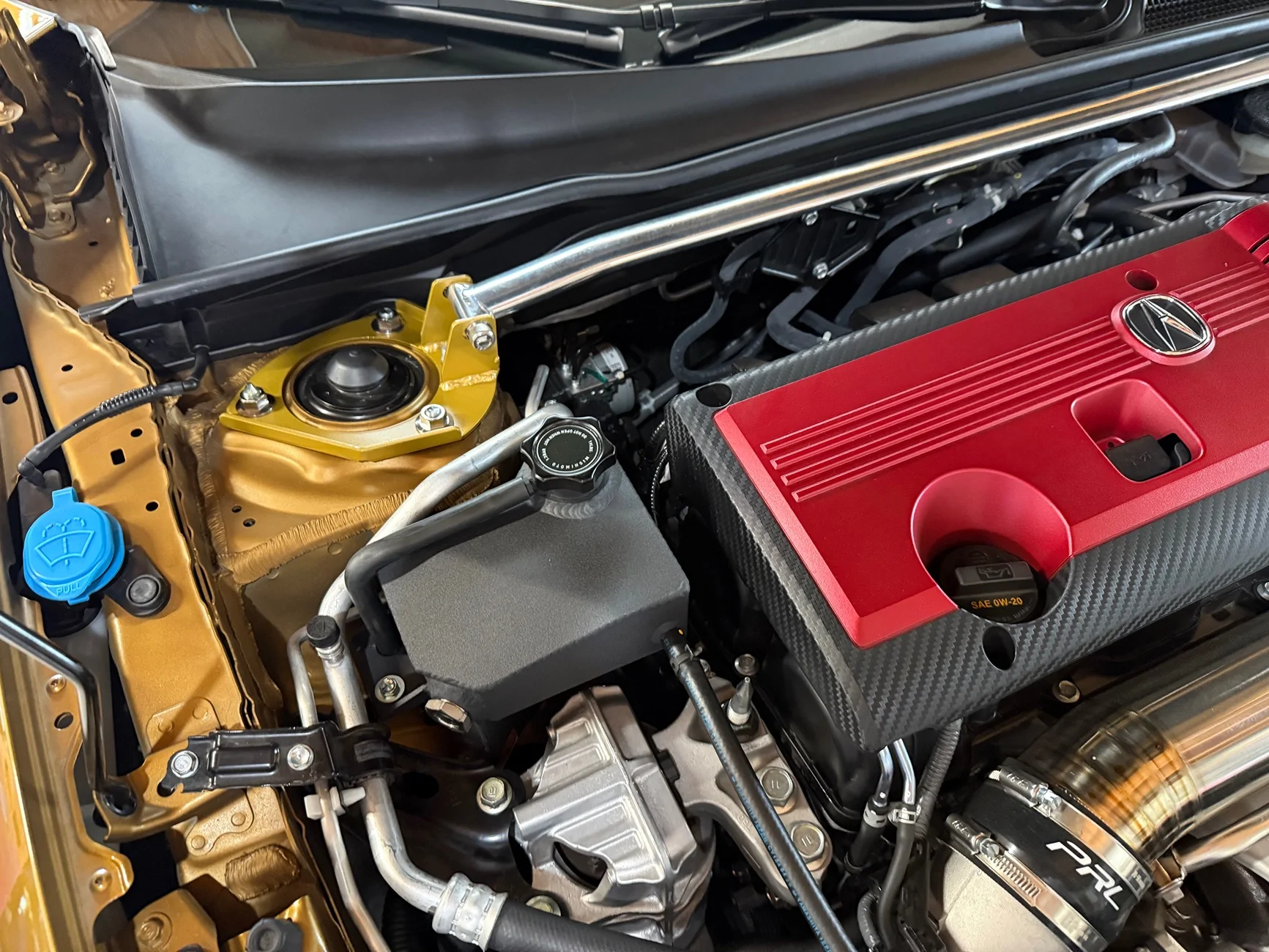

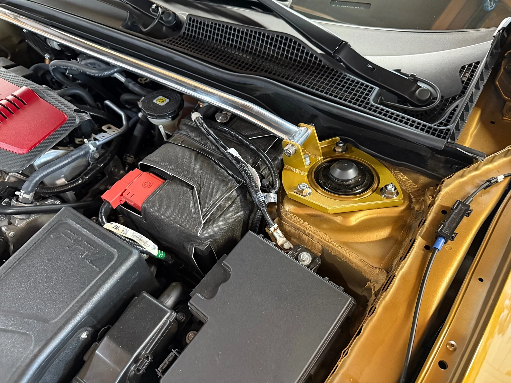

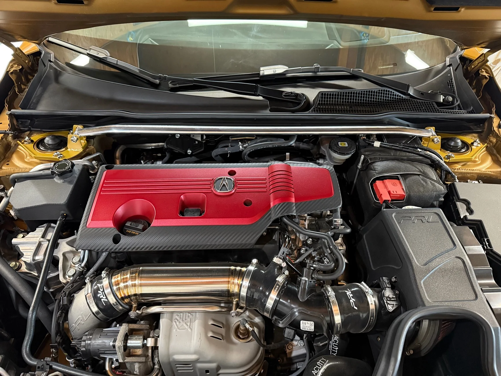

Some photos.
Looks good! Now the real question is, do you feel a difference at all? I see a lot of companies make strut bars and I like them, but for some reason Spoon still does not run one and they are heavily dedicated on the track.
It is a fair question and it was discussed in many forums. I don’t track the car. I have many other mods on the car. I can’t tell how much it adds. Some people said it takes 9 to 9.5.
I like the looks mainly, it’s not very expensive and it does something positive - so, a good mod for me!
