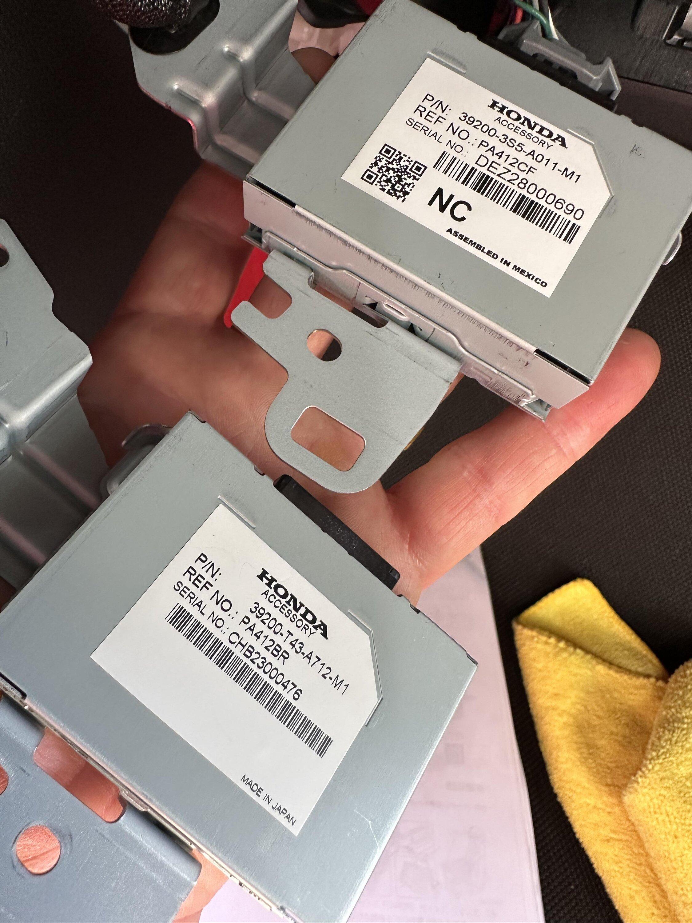

Confirmation that the TLX part that I purchased works.
Followed this video for install:
However I did have to pull part the casing and only use the circuit board as it is not a direct fit.
11th Gen Honda Civic FL5 Active Sound Control (feat. Topher) s-l1600
11th Gen Honda Civic FL5 Active Sound Control (feat. Topher) s-l1600 (1)
sashimi
sashimi
Jun 30, 2023
81
68
US
CW FL5
End results, it still sounds ‘fake’ as expected, but it is much improved over the video game sound of the stock FL5 unit. One interesting find was that the amplification only works in Sport mode, or exhaust set to sport in Individual. Phone video capture quality is very poor and it does sound better and way louder and throaty in person. I’m happy with the outcome and will long term test it.
This is good info to know! this now confirms that the ITS module I ordered will pump in the same sound and will work exactly how it does on the ITS in the CTR :hmm:
nattypiso
Dom
Aug 20, 2023
175
162
Fayetteville, NC
FL5 CW R-05536
Let us know how it sounds if you swap!
I've heard that it sounds less artificial compared to the CTR module, but after watching a few POV drives of the ITS on YouTube, it's hard to make out the differences without experiencing it in person :hmm:
nattypiso
Dom
Aug 20, 2023
175
162
Fayetteville, NC
FL5 CW R-05536
The TLX swap definitely sounds way better! it's unfortunate that the module only seems work in the Sport setting but the better sound outweighs the cons. Did you make a custom bracket to mount it properly?
sashimi
sashimi
Jun 30, 2023
81
68
US
CW FL5
It makes sense since the TLX a spec has comfort, normal and sport mode. I drive 90% in individual mode so it's a non issue in using this module. There was no way to mount it 'properly'. I took the circuit board out of the casing and used the thick, clear mounting tape.

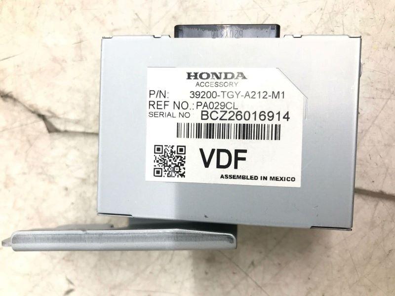

ITS module swap complete and tested?
JDM_DOHC_SiR
Uncle Dave
Apr 17, 2017
27
857
642
Chula Vista
Sure did .. swapped it out yesterday so much better than the CTR module ... not sure what the Japanese engineers were thinking but in +R mode its way too artificial. Now on the other Hand now that I have had a day with out any module plugged in and then another day with the ITS Module on the car and driving around this it is very natural sounding and I almost had to check to see if I was getting any "pumped in sound" well worth it for me since not having anything plugged in was making my OCD trigger :rofl:
11th Gen Honda Civic FL5 Active Sound Control (feat. Topher) CTR vs ITS modul
sashimi
sashimi
Jun 30, 2023
81
68
US
CW FL5
Very well! This is the go to for those who hate the Type R fake noise then. Does it work in each mode or is sport and +R mode now have the same sound?
JDM_DOHC_SiR
Uncle Dave
Apr 17, 2017
27
857
642
Chula Vista
Comfort has zero sound similar to the CTR
Sport has a very slight low tone ( I’d say about 1/3 of what the CTR is for sport mode )
+R now sounds very natural and very in tune with the natural exhaust tone of the car and sounds nothing like the CTR downshifts are the area I notice it the most…. And reving it out you can actually hear the natural engine noise now vice the electronic generated nails on a chalkboard sound that comes from the CTR in +R mode :thumbsup:

Just for reference; proper ITS sound box part # is: 39200-3S5-A01
Ordered for $67 today. I will update with impressions, and hopefully put this to bed.
