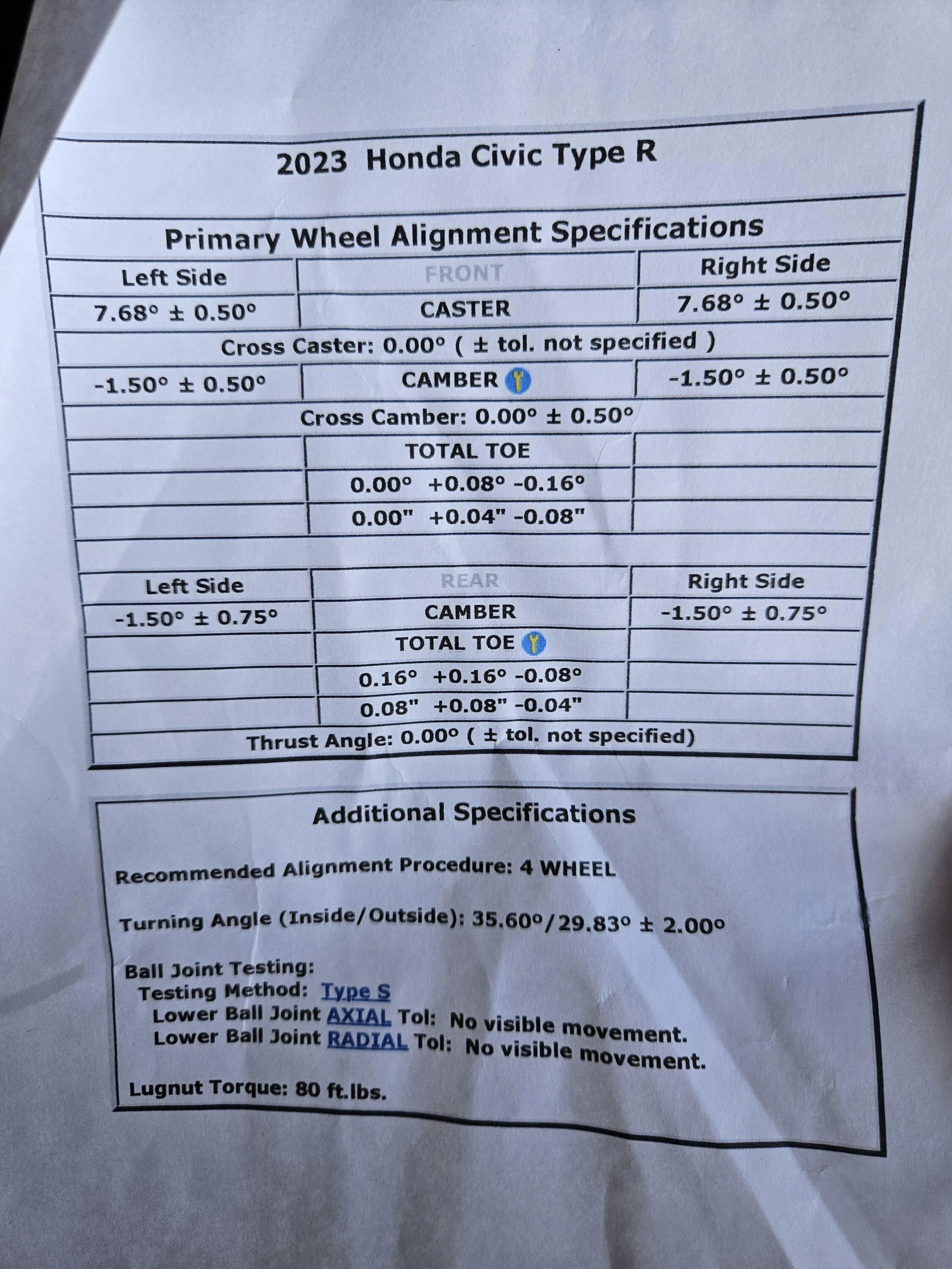

My cars alignment has been off since I bought it. Steering wheel was off center off the dealer lot, they tried to align then told me they don’t have the fl5 specs, but they used the fk8. Which is stupid to me. Now they’re saying they likely won’t have alignment specs until November 2023.
wtf.
does anyone have alignment specs for fl5??
kinda crazy Honda would sell a car that their dealers can’t service.

I ran into the same problem so I made a trip to a shop that had a spec. I hope this helps!

This will definitely help, thank you! Do they use a system other than hunter? Weird that the dealer doesn’t have it but that shop did. Was it a performance shop or something?

Yes. They were working on 5 gts when I was there.
