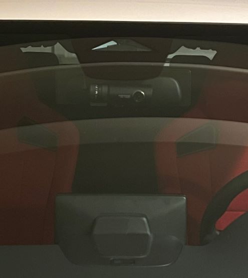

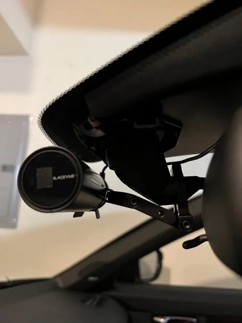

Just wanted to share that it is 'possible' to use blendmount on our cars.
It has been issue free for 8 months and counting.
11th Gen Honda Civic FL5 Blendmount image1
11th Gen Honda Civic FL5 Blendmount image0
BlendMount P/N: BBV-2000R
It just involved a bit of filing on the tapered arm.
Follow homelink mirror replacement guides to remove the mirror
and file down the arm until the blendmount clamps do not slip off!

I can take more pictures but it's straight forward and self explanatory when you actually try to mount it. It will slide off because the arm tapers like a cone, so to speak. You are filing down the base of the arm to make it more or less a 'cylinder' for the clamps to bite onto.
