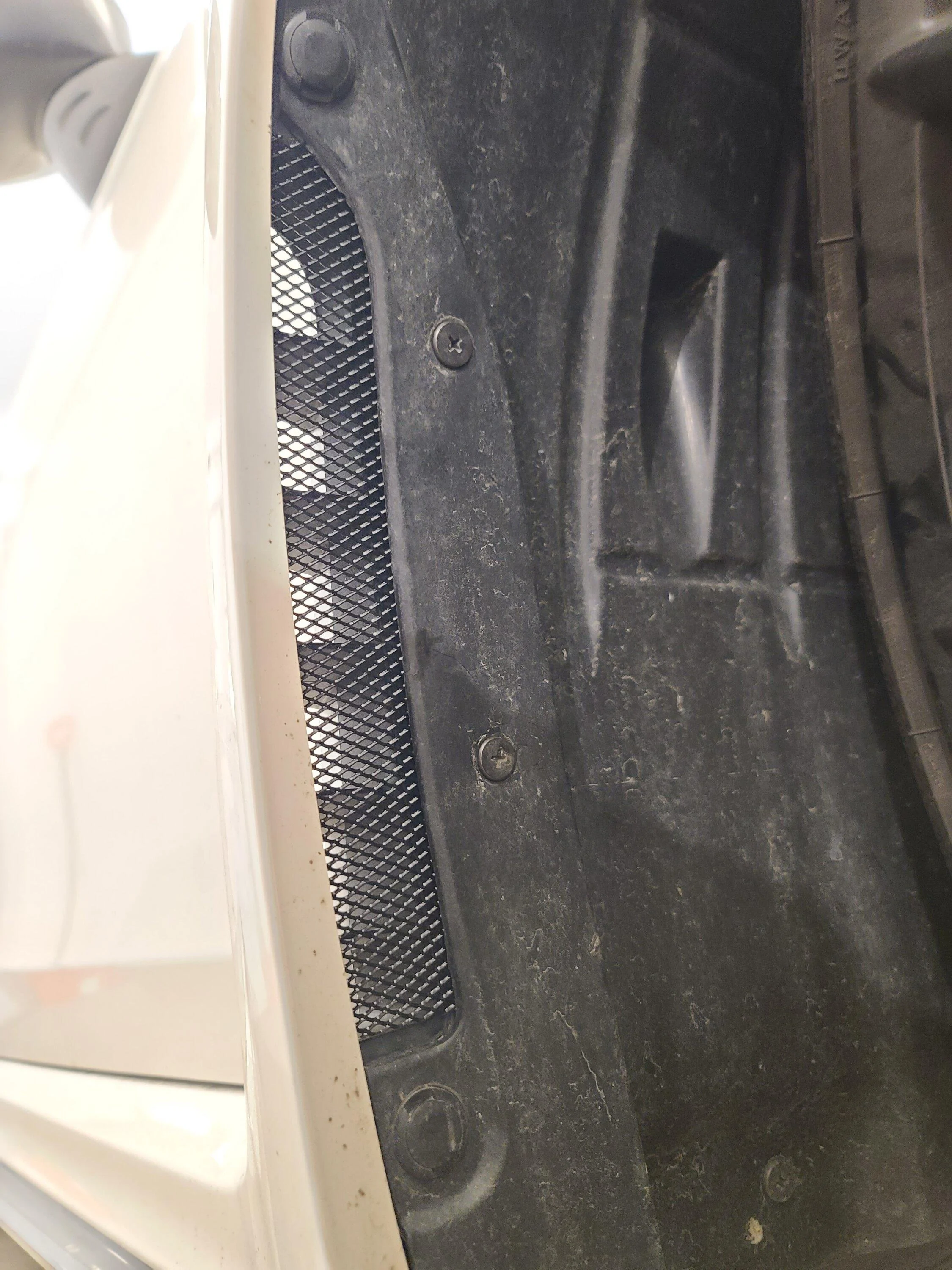

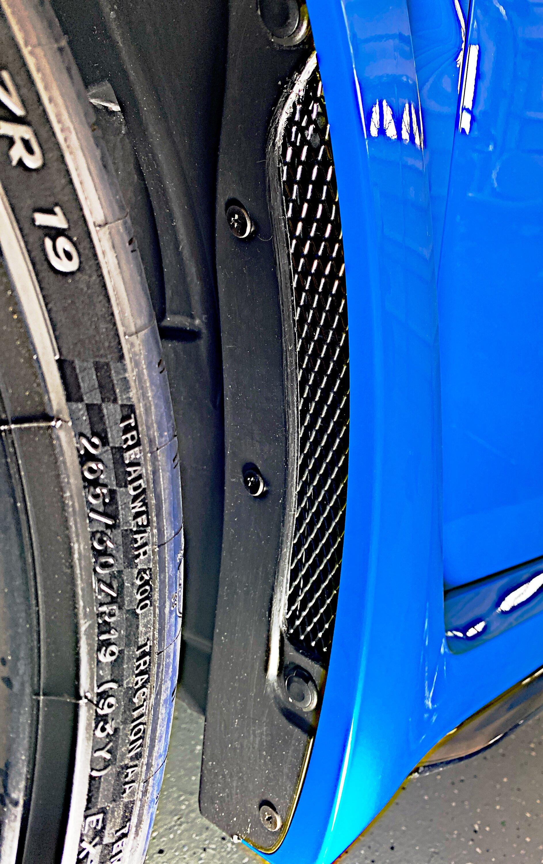

Don't try and use the top/bottom clips for retention. With the mesh slipped in properly everywhere the two screws are more than enough.

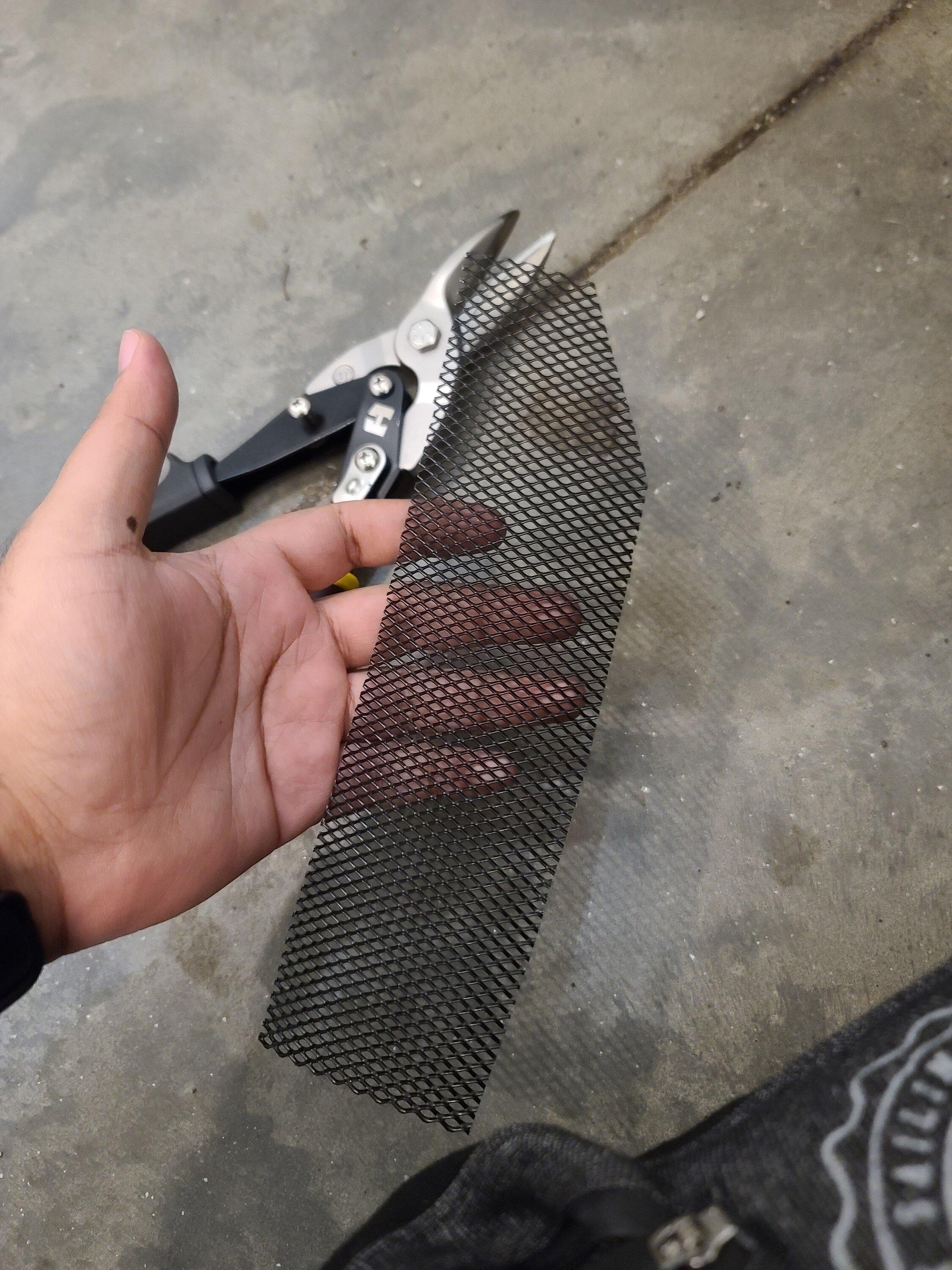

For the time being, I added some automotive mesh to the fender vents, inspired by someone else on the forums. Costed around $20.
Do you know what size mesh you used? I ordered what I thought was right from Amazon and the holes were too big?
AggAuto Universal 40"x13" Car Grill Mesh - 100x33cm Aluminum Alloy Automotive Grille Insert Bumper 3x6mm Rhombic Hole, One of the Most Multifunctional Shape Grids Black https://a.co/d/29ps1zj

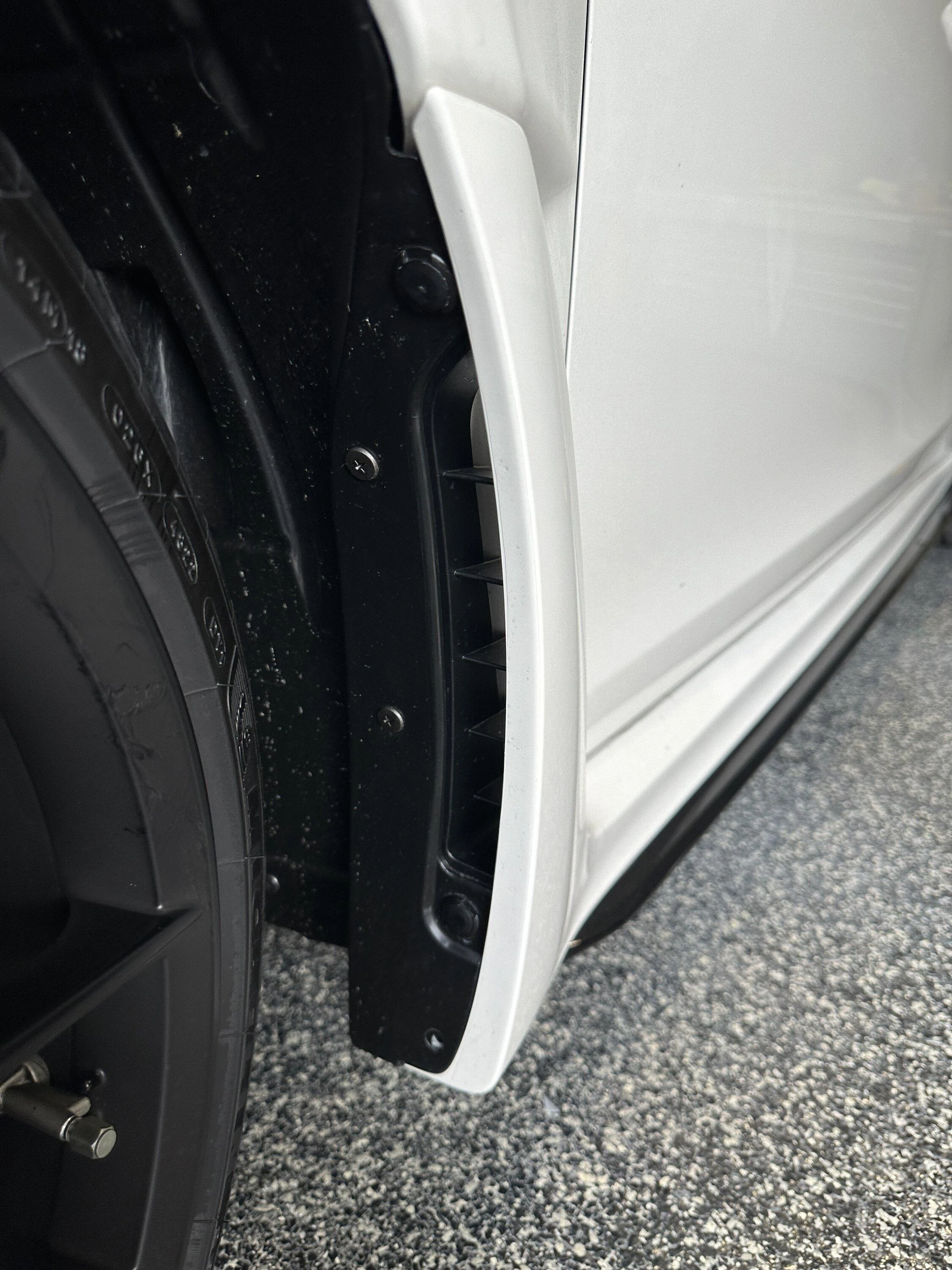

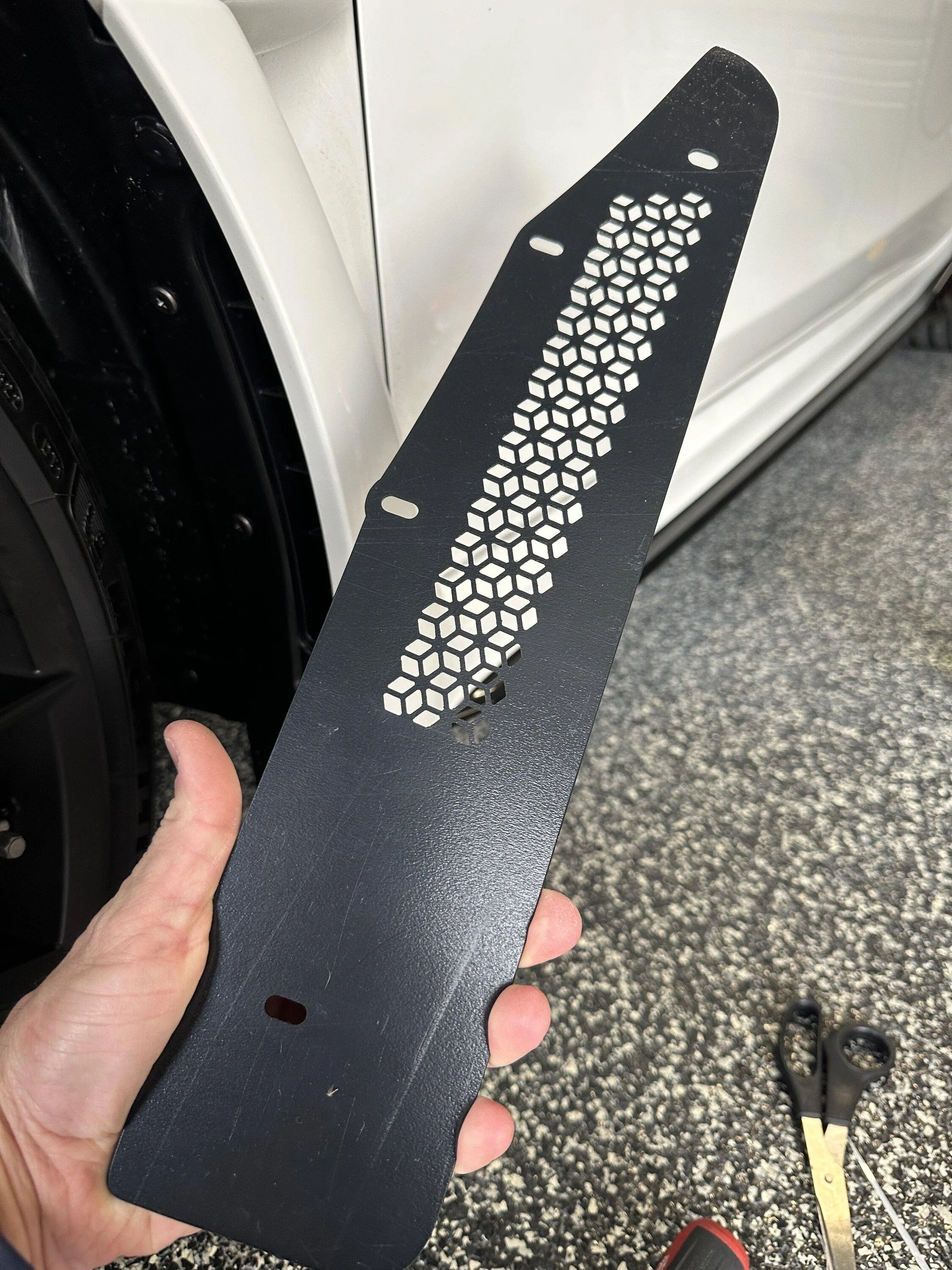

Got the fronts in. Overall… extremely pleased. The inside surface is a smooth kydex that appears to be scuffed, but you 100% do not see it when installed. The back side is textured, and looks totally black. The holes were well lined up, and use factory screws to good effect with some tilt and in/out adjustability due to the slot holes. I used the recommended Dorman 112B fasteners, as they’re a little more secure looking and easily taken out if need be. The new holes in the Sukeban look way better than the old style simple circles. I’ll get an installed photo soon, once the backs are in. I used some door edge tape on the painted surface where the flaps touches, just to prevent scratching from inevitable dust/grit and vibration rubbing away paint, and that took a while to trim form 5/8” strip and apply/dry. Otherwise these would take 5 minutes to install, but the top OEM push clip is quiet difficult to get out and will 100% break.
