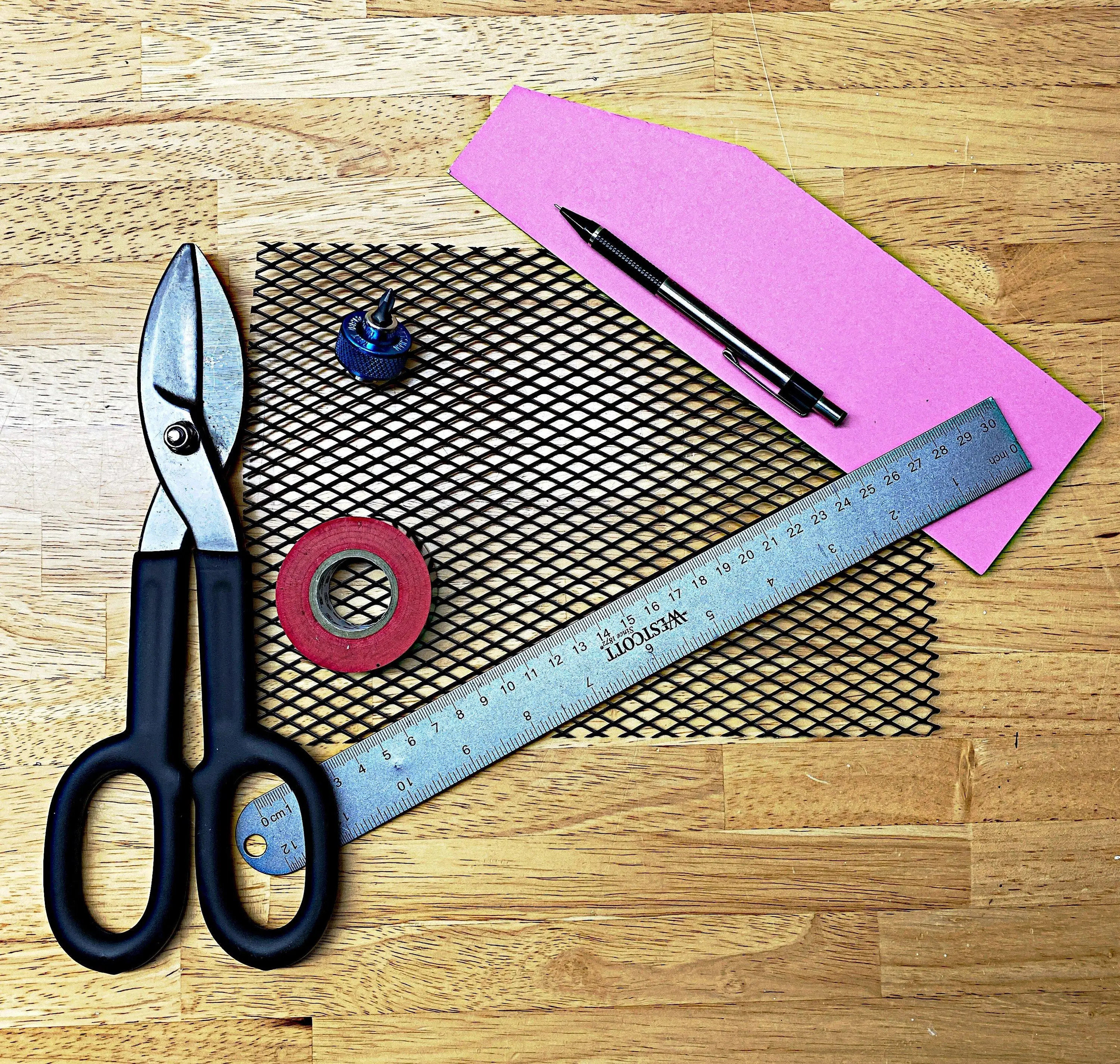

Anyone want to be awesome and share the dimensions of the stencil they used?
I didn't use one and cut the mesh directly, but my mesh was 9 inch on length and 2.5 inch on width. It was 10 inch in length initially but that was just to be on the safer side, as the vent is slightly curved. Cut the top of the mesh at no particular angle, just laid it on top of the vent and saw how the lining curved inside, made marks on the mesh, and cut accordingly.

Can you post measurements of the template (pink paper)?
Thanks
Originally, I just traced out patterns on pieces of card stock until it looked appropriate and then trimmed accordingly by placing it into position a few times.. Since the edges will be hidden beneath the surrounding plastic, a precise cut wasn't necessary. It is important, in my opinion, to make certain that the lateral edges of the metal mesh are filed smooth for obvious reasons. I went an extra step and lightly coated them with some black Plasti Dip I had on hand. After approx. 1K miles, no rattles, no scratches, and no "downstream" debris getting through. There are some nice pre-made guards you can purchase, but in mfy opinion they are pricey and no better than ones you can make on your own. See also the OP by vbb and browse 3D printer templates if interested.
