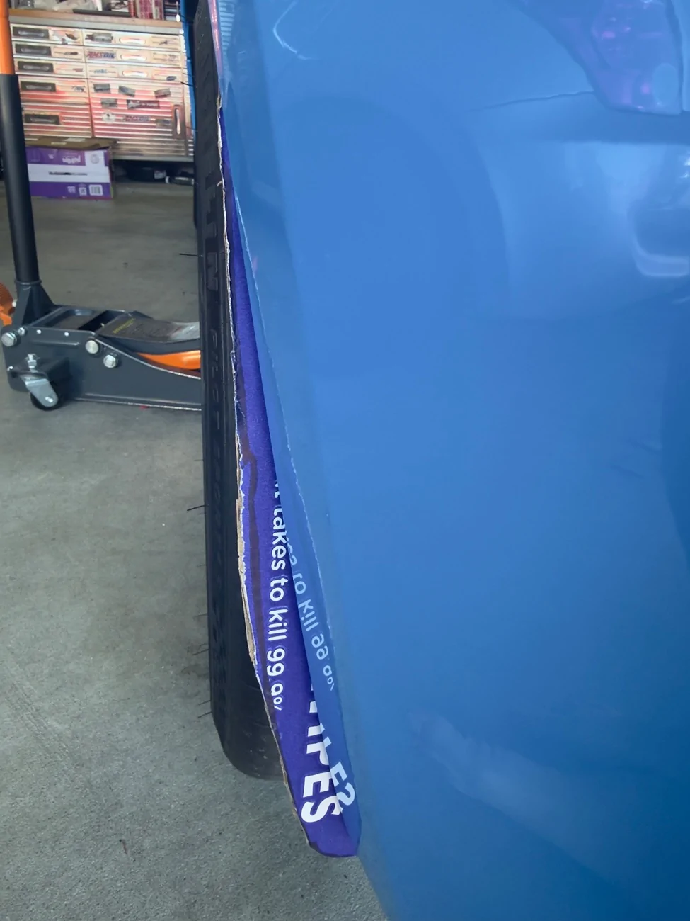

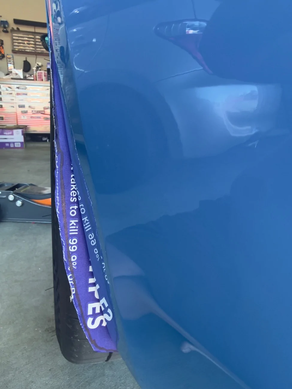

Thanks to @NeRO_CTR, I decided to take on this project. So far, the only material I have is a set of universal Amazon performance tuning 🤣 mud guards and a box from getting the groceries today at Sam’s Club to do the template. I have some sanding blocks and stuff lying around to make it round on the corners and all that, but let’s see if I will be taking pictures and posting it on here in case somebody else wants to do it. I will be reusing the OEM hardware, not the ones in the picture. Also the link attached in case I forget to add something of the parts.

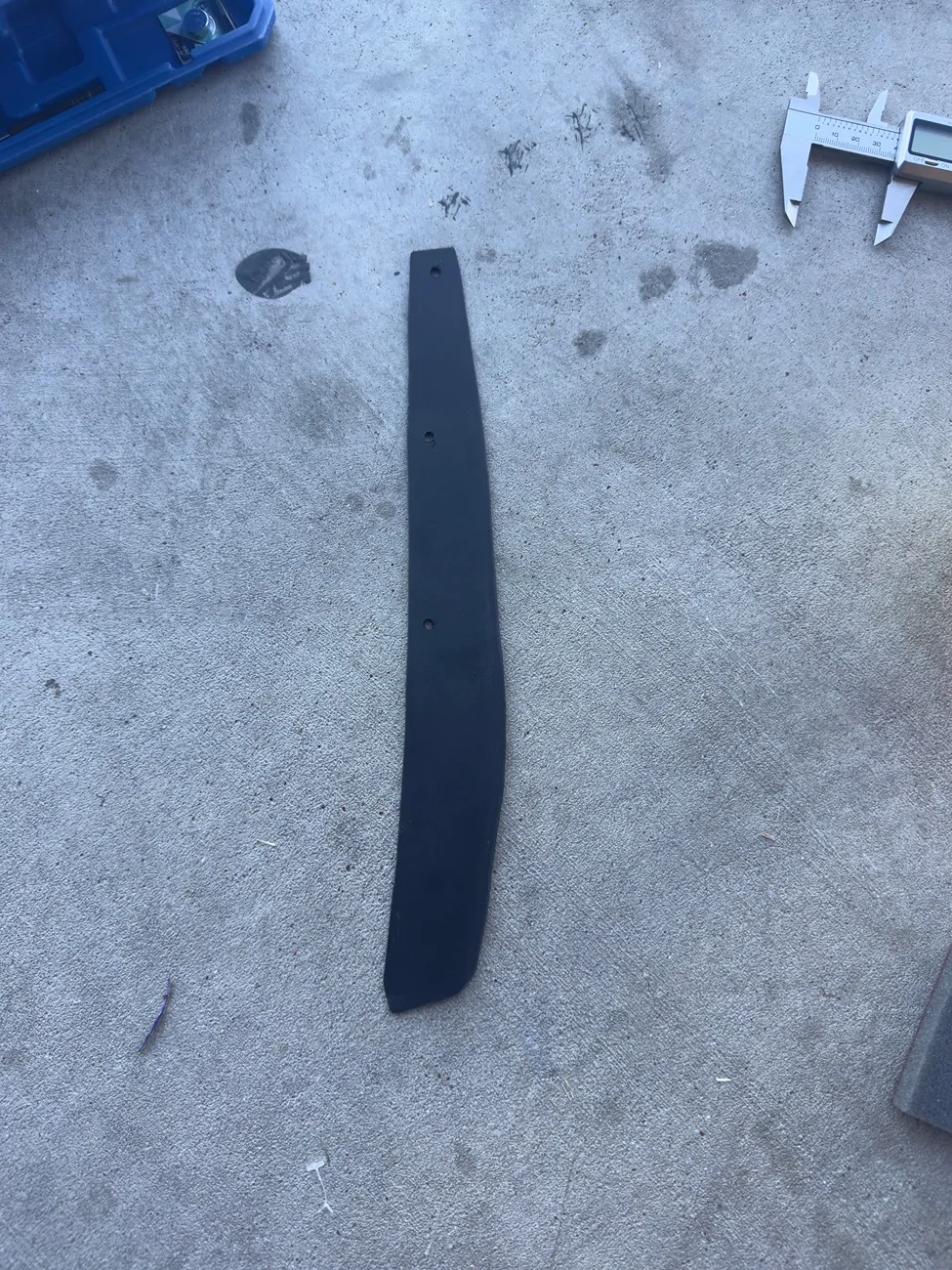

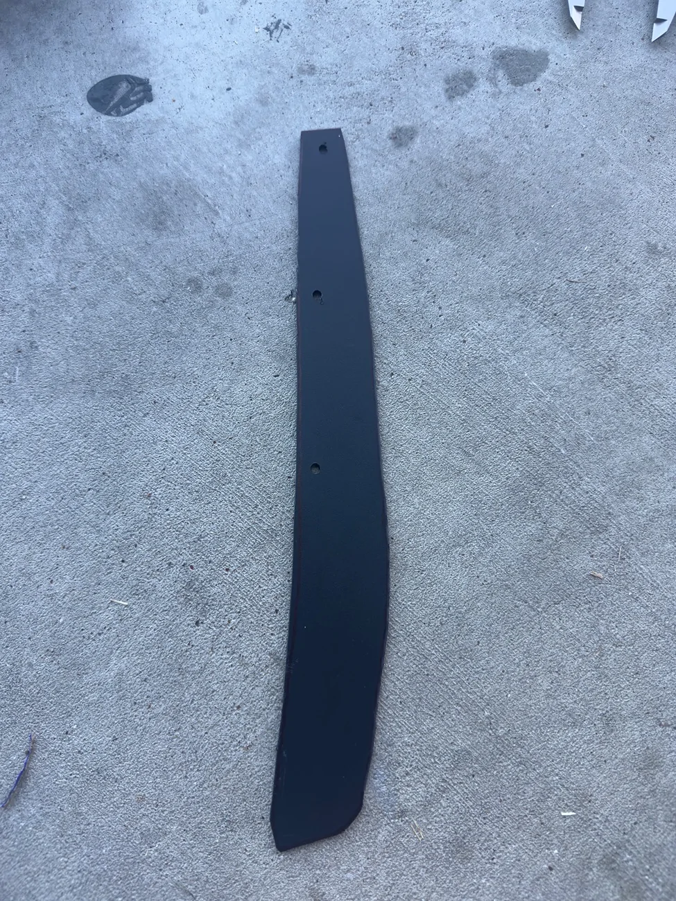

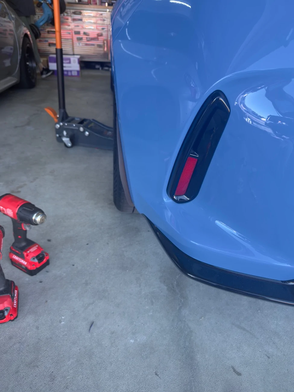

I took on the project today. It wasn’t that bad. The tools I used:
Small angled screwdriver
Jack
Straight tin snip
Scissors
Black marker
Sanding sponge 220 grit (it was a leftover for a wall repair that I did 🤣)
Digital caliper
Drill with 11/64 drill bit
Cardboard
Also from the Amazon listing, I ended up using just one of the
The measurements for the cardboard cutout that I used in inches:
0.7 ( also here the first hole for the screw)
0.8
1.1 ( second hole for screw)
1.3
1.4 ( third hole for the screw)
1.5
This is the measurement I took for the OEM wheel and tire combo. I will be installing 19x9.5+50 on 265/30/19 all season Continental. I don’t know how much will change from this, but I have room for adjustments.
Thank you @ NeRO_CTR hope this can give clarity if someone wants something similar it took me probably 2 hours at the most from start to finish.
