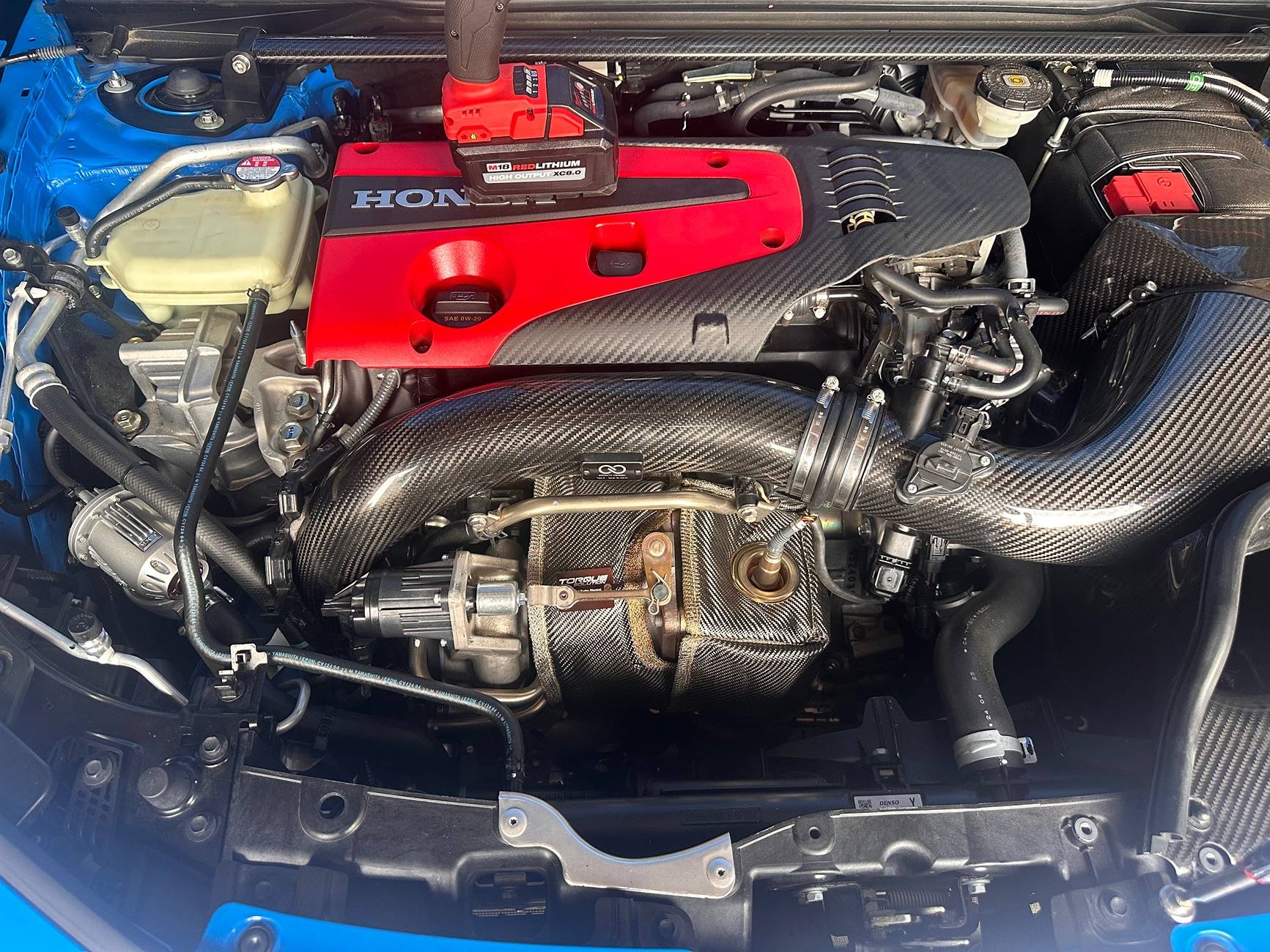

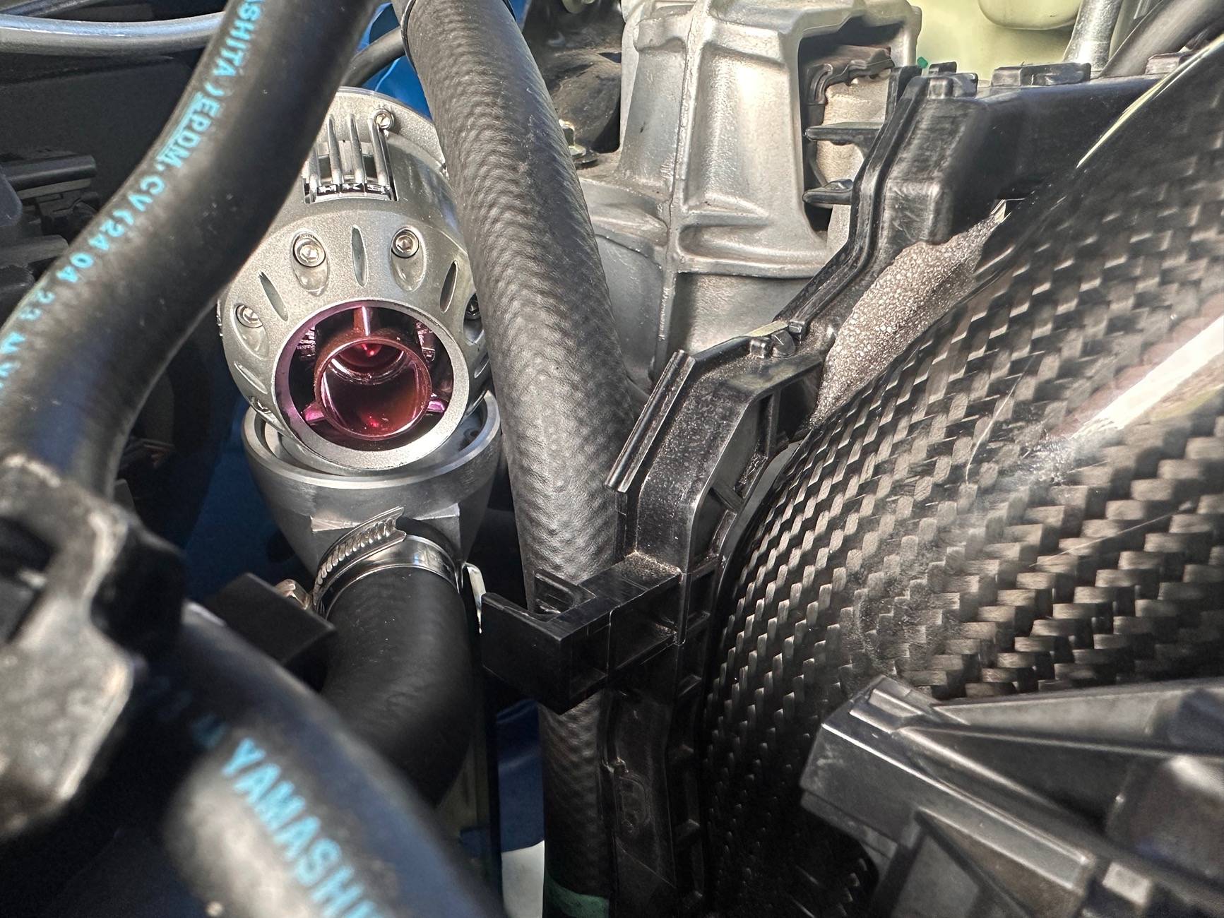

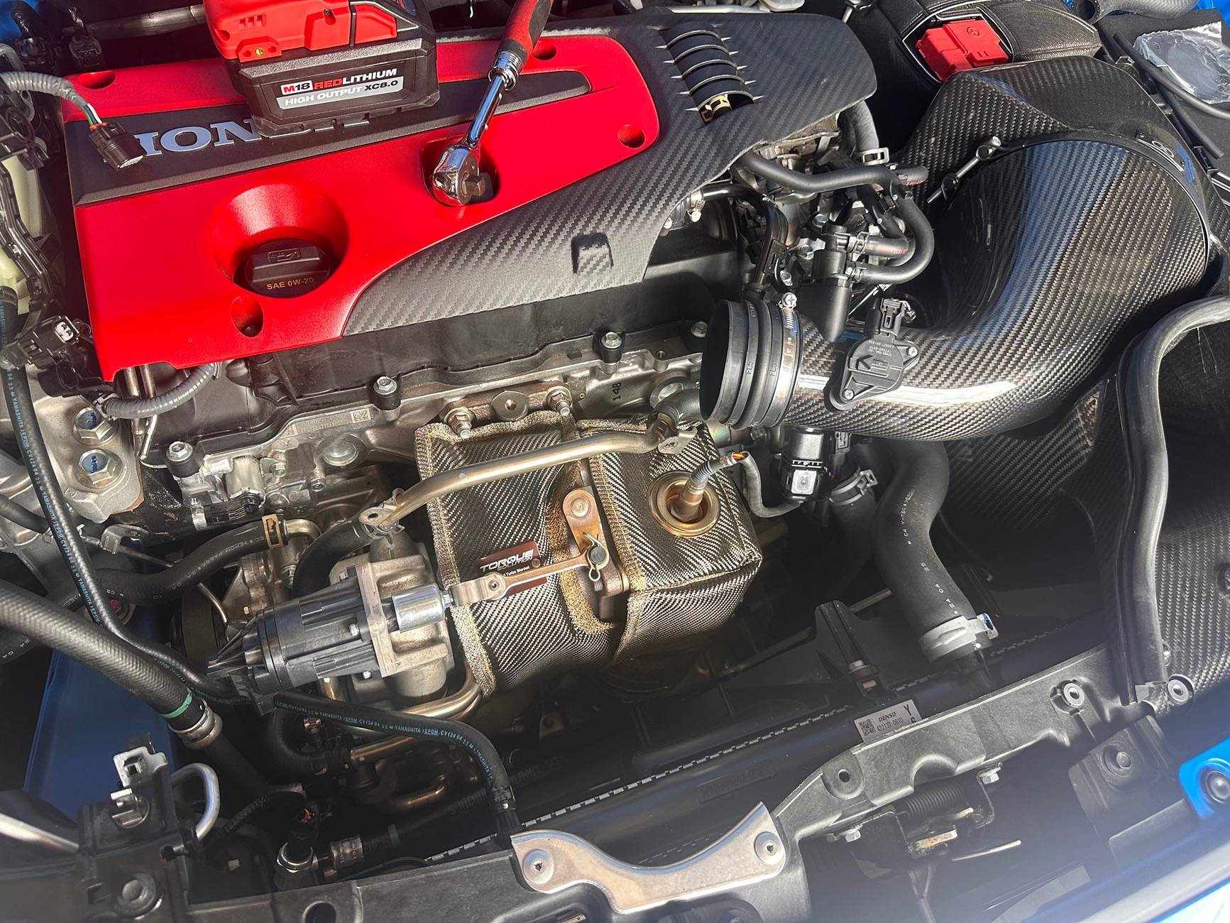

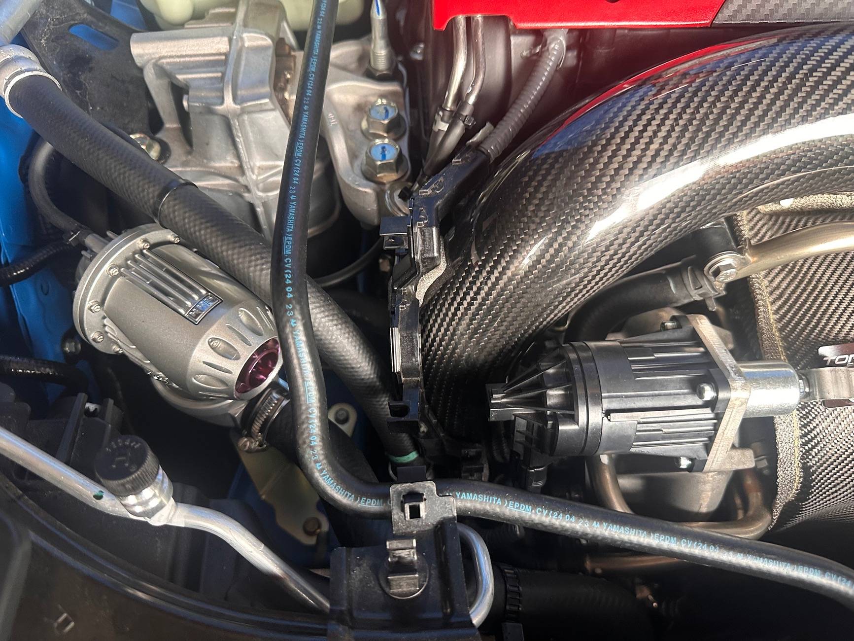

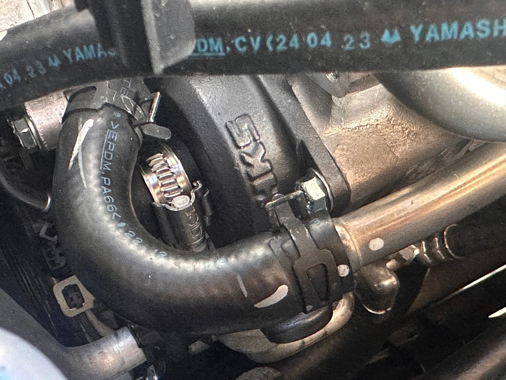

Installed my HKS BOV today, 2hrs later but i got it done. Also decided to go with the Purple Fin for now. One thing i would say, the new location on the FL5 vs the FK8 location, seems to be more responsive and louder BOV sound, even with no engine load.

Yes. Take your time, one bolt at a time. Get a telescopic magnet you’ll most likely need one like me. As you remove the bolts from the bypass valve and the inlet pipe near the turbo housing, keep the magnet close to the bolt to grab them, so they don’t fall down. If not then at least remove the under tray so your bolts, in case you drop any or the infamous 10mm socket like i did, you’ll be able to get them from the floor.
lastly, secure the BOV hose to the bypass valve but don’t connect it to the BOV, leave that for last, you’ll want the space to get all your bolts and plugs back on.
