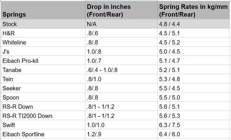

Found a video by LHT Performance on YouTube where he installed H&R Springs on his FL5.
Top numbers were with stock springs, bottom was with H&R Springs immediately after install so they hadn't settled yet. Still, looks like an even 1/2" drop which slightly different than advertised (H&R specs say the front is a bigger drop than rear, but in this example that wasn't the case, perhaps the front will settle lower than the rear?).
If anyone has the Eibach Pro-Kit measurements on an otherwise stock setup I would love to know.
11th Gen Honda Civic FL5 Lowering Springs 1728658926550-2r

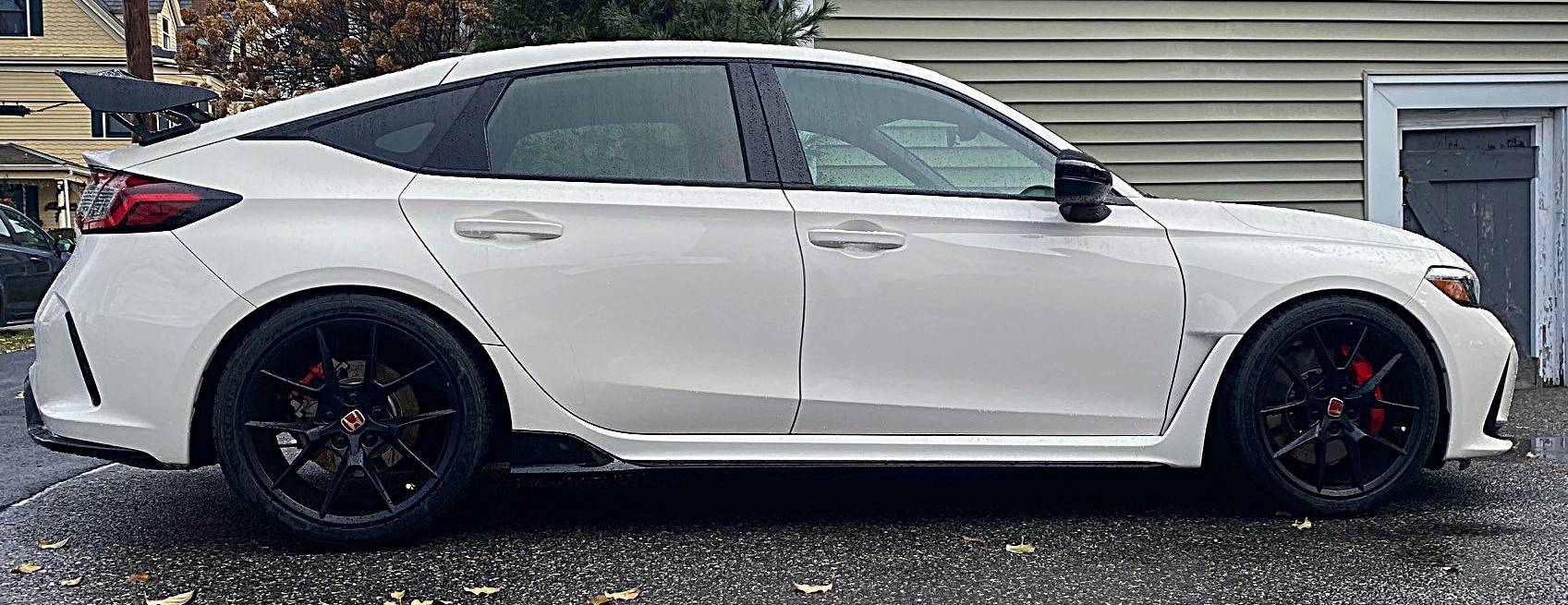

For reference: H&R Springs on 265/35/19
11th Gen Honda Civic FL5 Lowering Springs FL5 Side Profile
