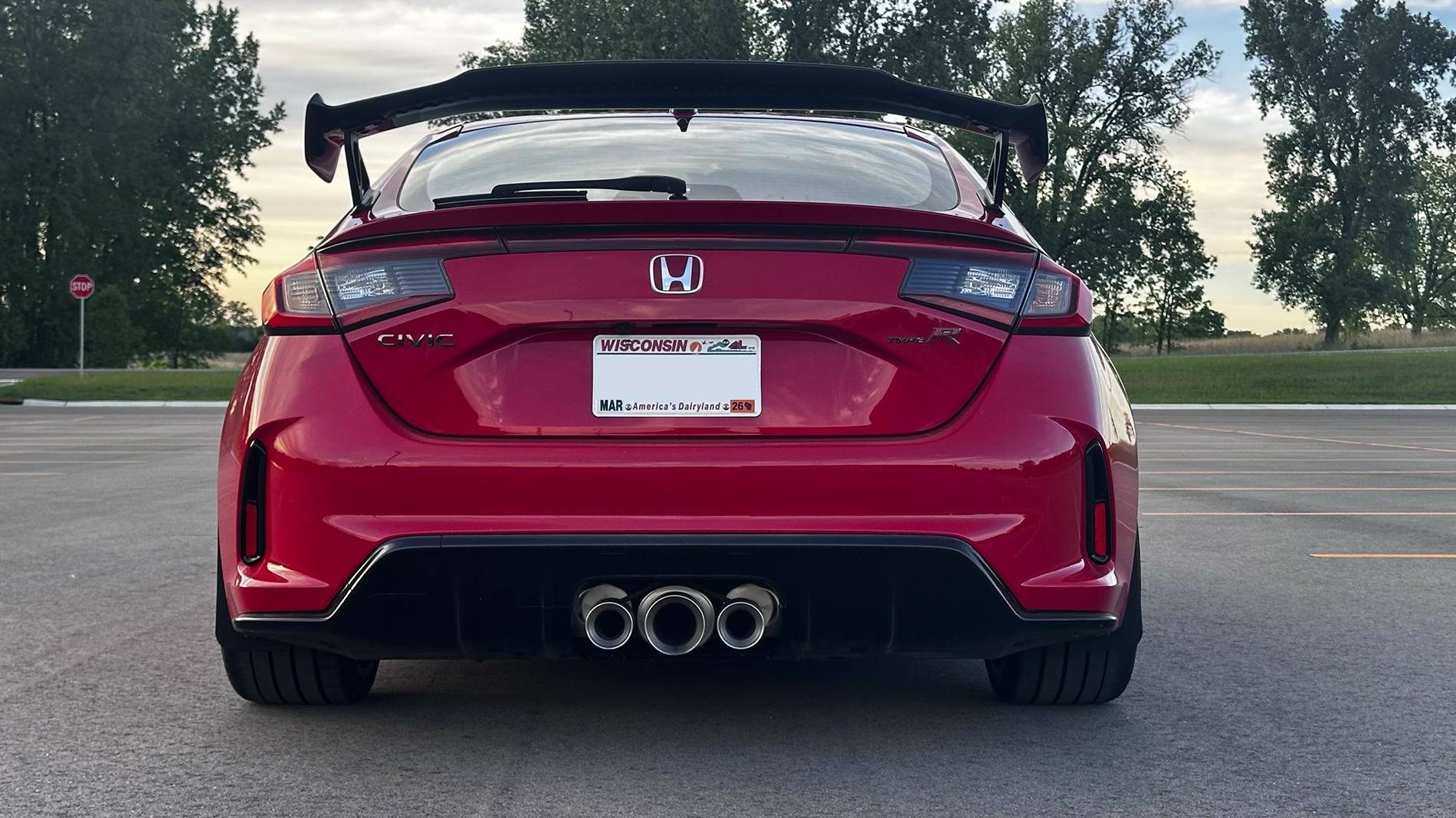

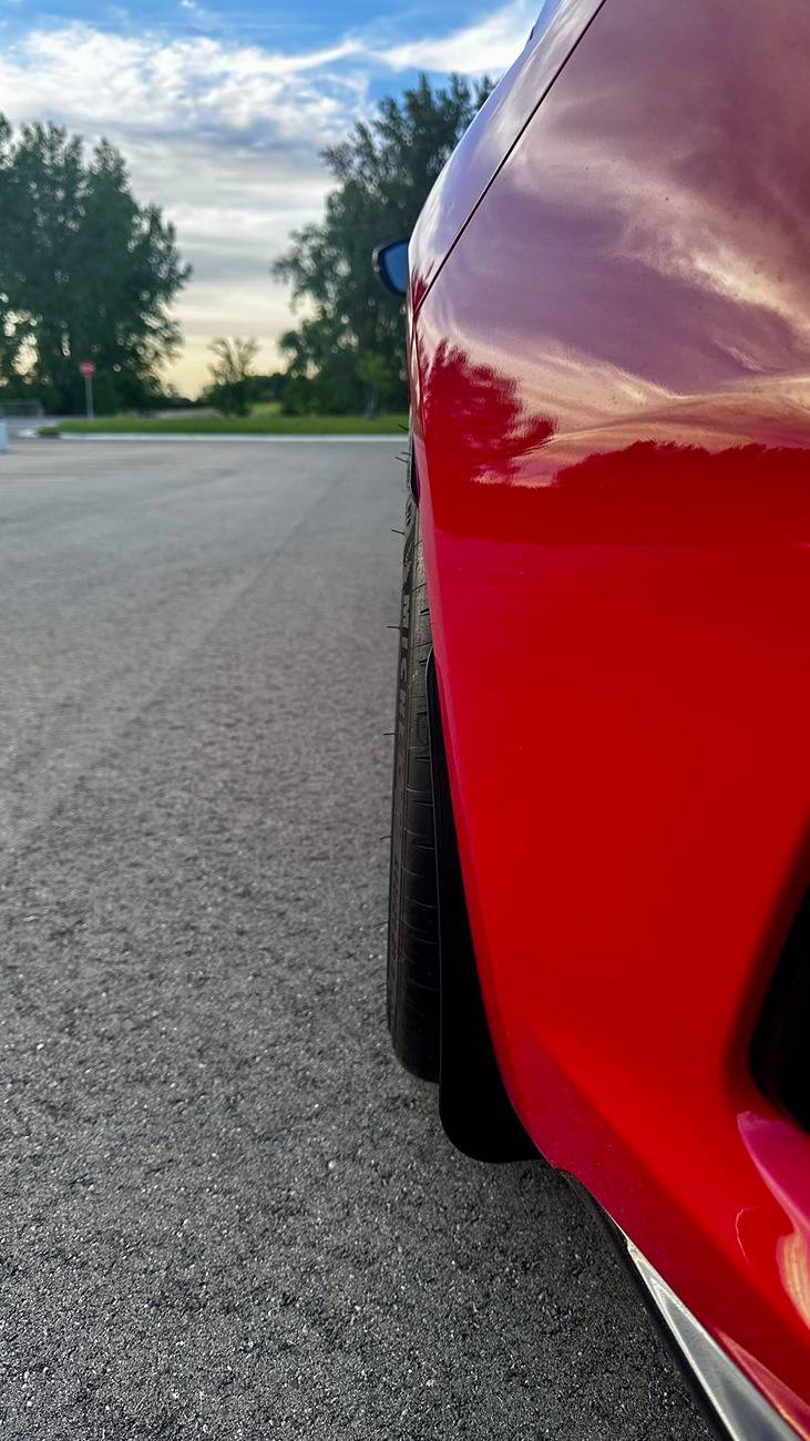

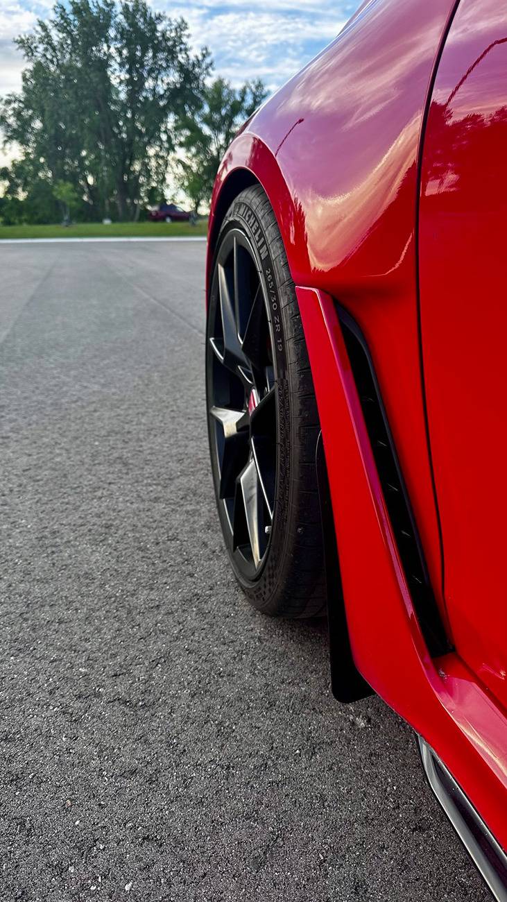

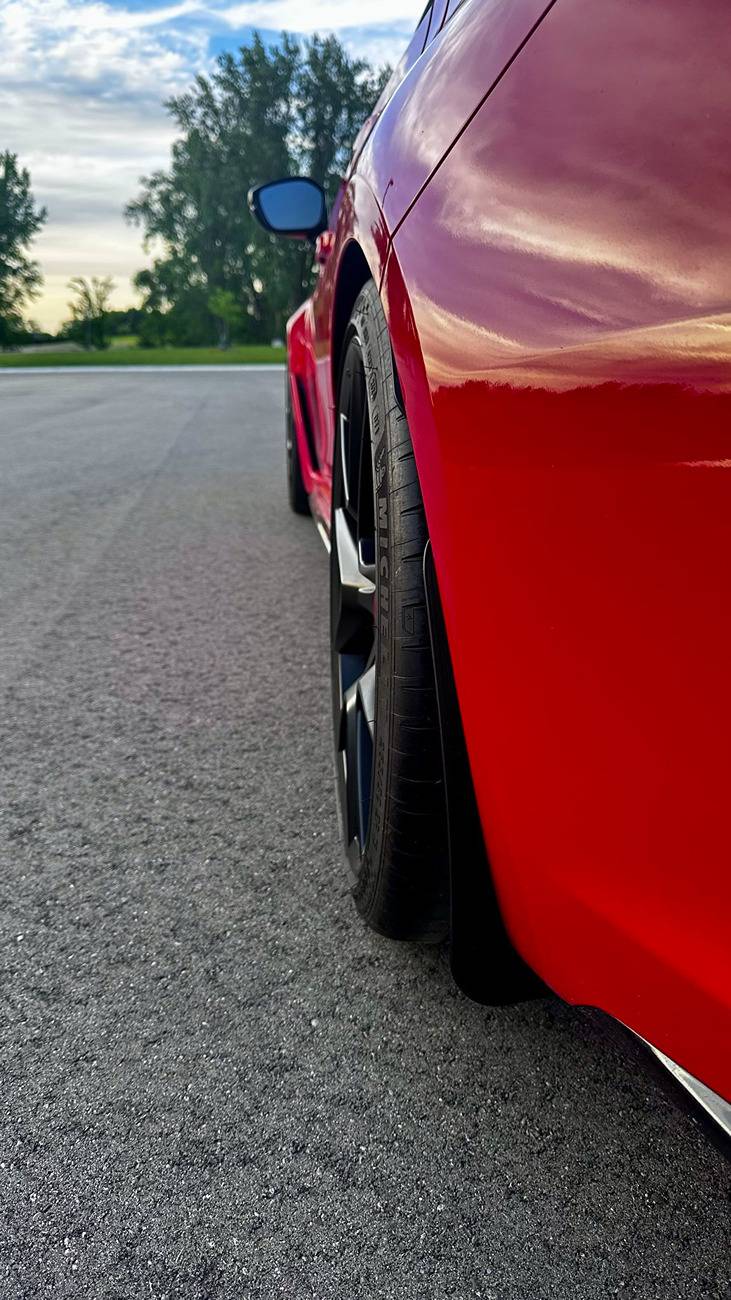

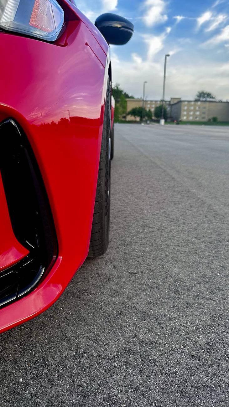

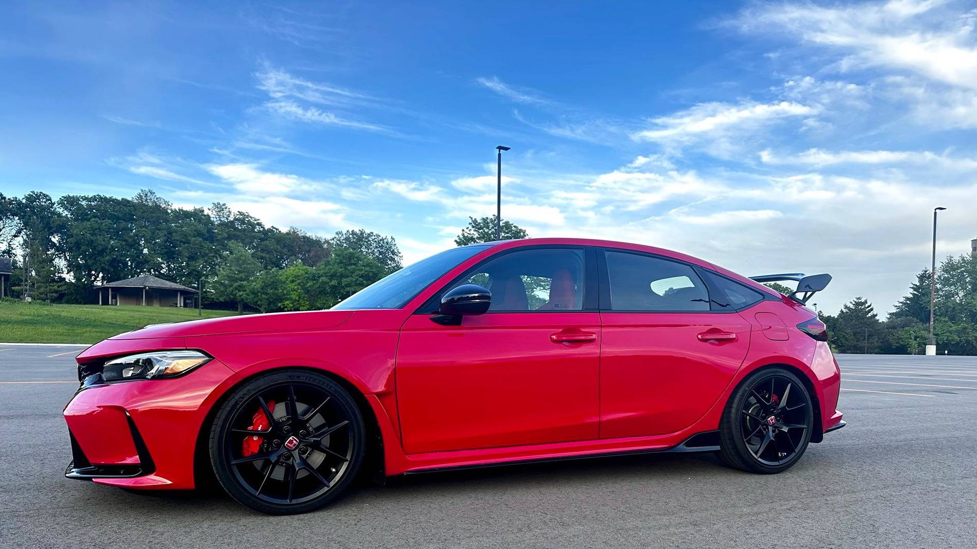

Eibach Pro-Kit
+15mm Bonoss spacers
No camber adjustment yet.
Will update with added pics after alignment and settling.
Might go to +10mm in the rear.
Pics took same day as install. Hoping rears settle a little bit more but overall I'm surprised at the drop, I was expecting less. I'd probably go H&R if I did it again. Comfort & sport feel like stock, +R feels better. HUGE PITA for install. Drivers side took me about 3-4h on it's own, everything else was pretty easy. Suggest two people as moving the steering wheel helped getting the drivers side to seat. Remove your axle nut to help with axle popping out, I didn't and damaged one of my axle seals so I get to do it all over again this weekend.

That's funny because I just noticed the same thing on my recent Eibach install. Drivers side is lower than the passenger side by about 1/4". You can see it in the pics above, but it's also lower than I expected which is what has me a bit worried.

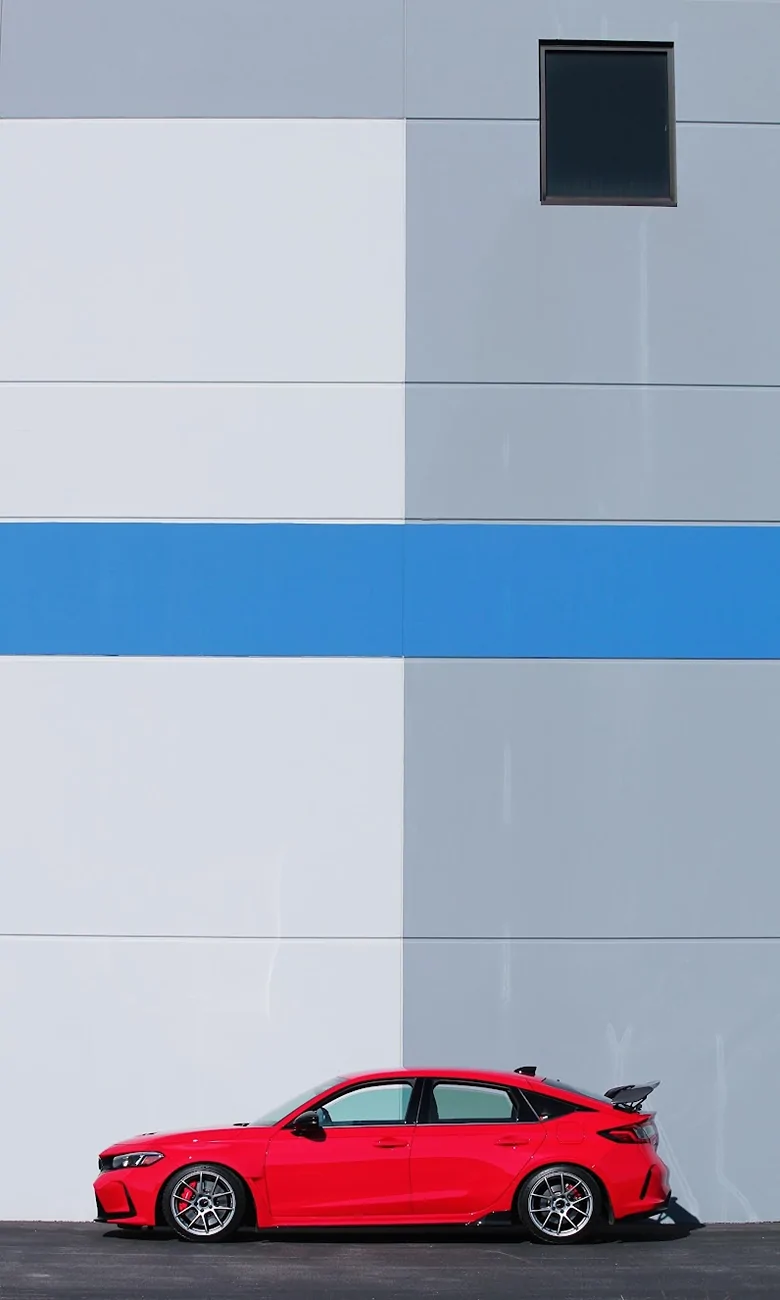

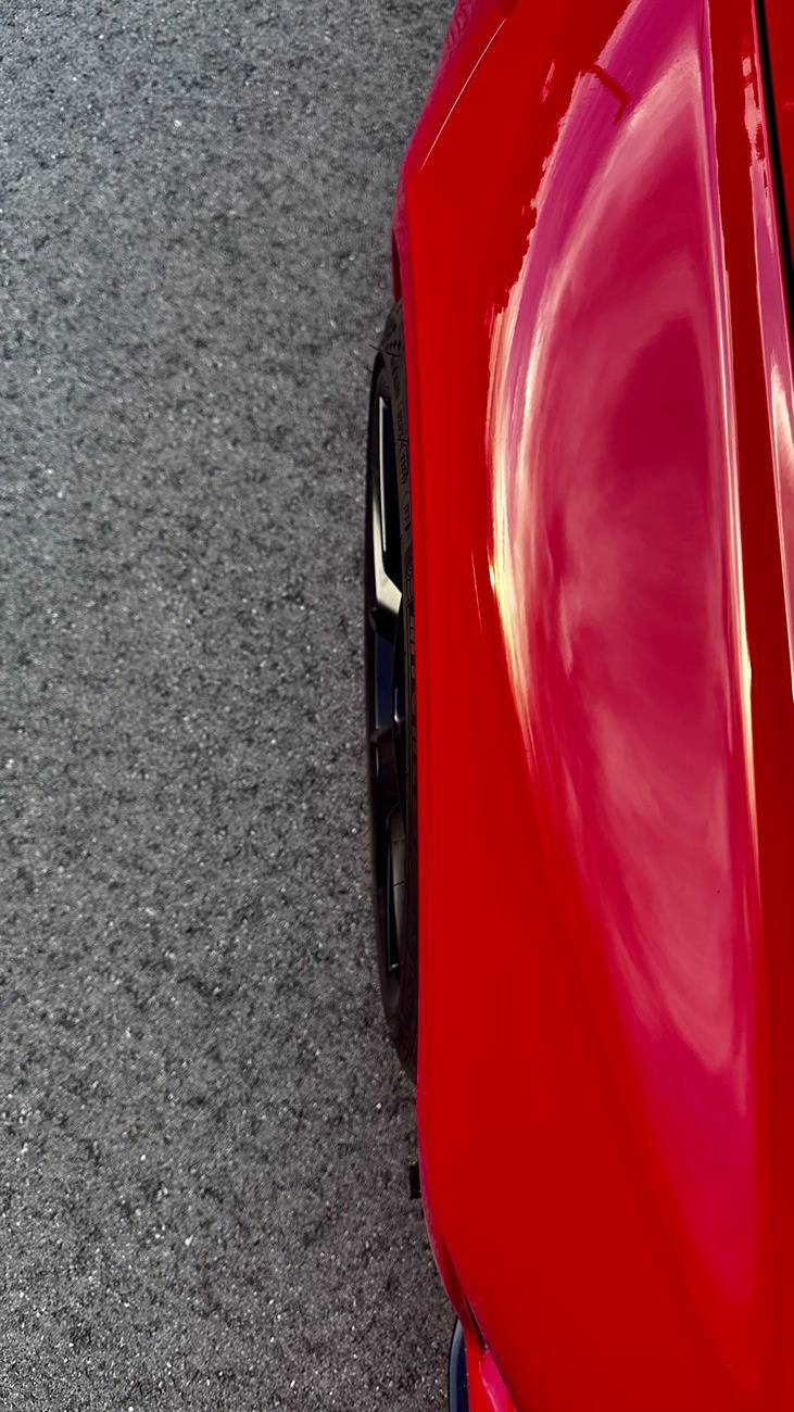

I'm still happy with my setup. The rest of the springs/bushings/whatever settled out on my Eibach's and the setup looks great. I snapped some pics on my winter 18s pre-winter. No regrets.

Damn that stance looks nice!!!!
No rubbing of bottoming out? How’s the ride with passengers? I got the same color waiting for it to come first week of Feb is delivery date.
No issues at all with the stock wheels or with the winter setup (18s). I sometimes have 3-4 people in the car when driving wife/nephew/brother, and no issues.
