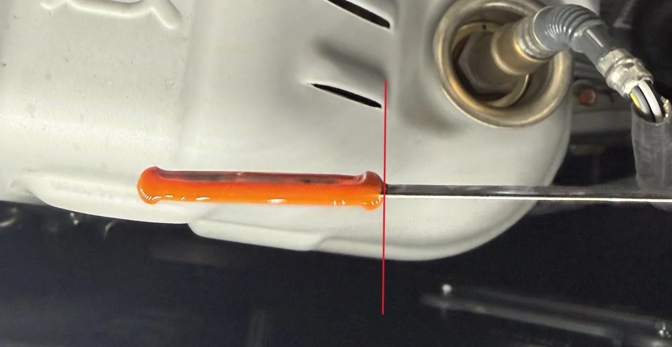

I have changed my oil numerous times at the dealer and noticed they always overfill the shit, and I have to siphon it out. Today I went into a smaller shop and had the oil changed again, and they told me they put in about 5.4 liters or 5.4 quarts. After I drove back took another look at the oil its still over the max line.

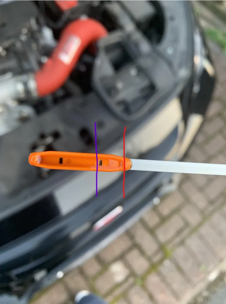

At this point, I'm starting to believe I'm not using the dipstick correctly. The oil pressure is approx 20 psi at around 175 F. The image I provided is from another person because with the new oil its almost impossible to take a picture of. The purple line is the oil level if I don't fully push the dipstick (dipstick is resting on the 1st o-ring, not all the way inserted). The red line is the oil level if I fully insert the dipstick all the way to the end. All of these readings are done based on the owner's manual, where I run the car to operating temps, shut off, and check the oil approximately after 3 minutes.

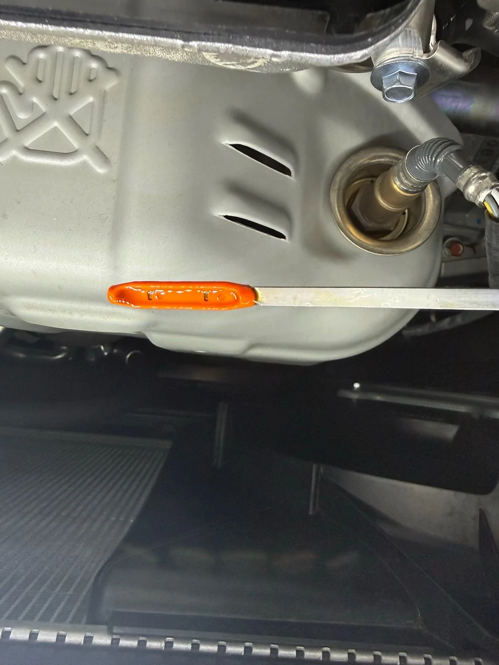

interesting.. i just checked mine (has been 2 hours since i drove it) - less than 2k miles on it, never changed, and mines to the top of the orange on the dipstick for sure. Guess imma be buying a dipstick

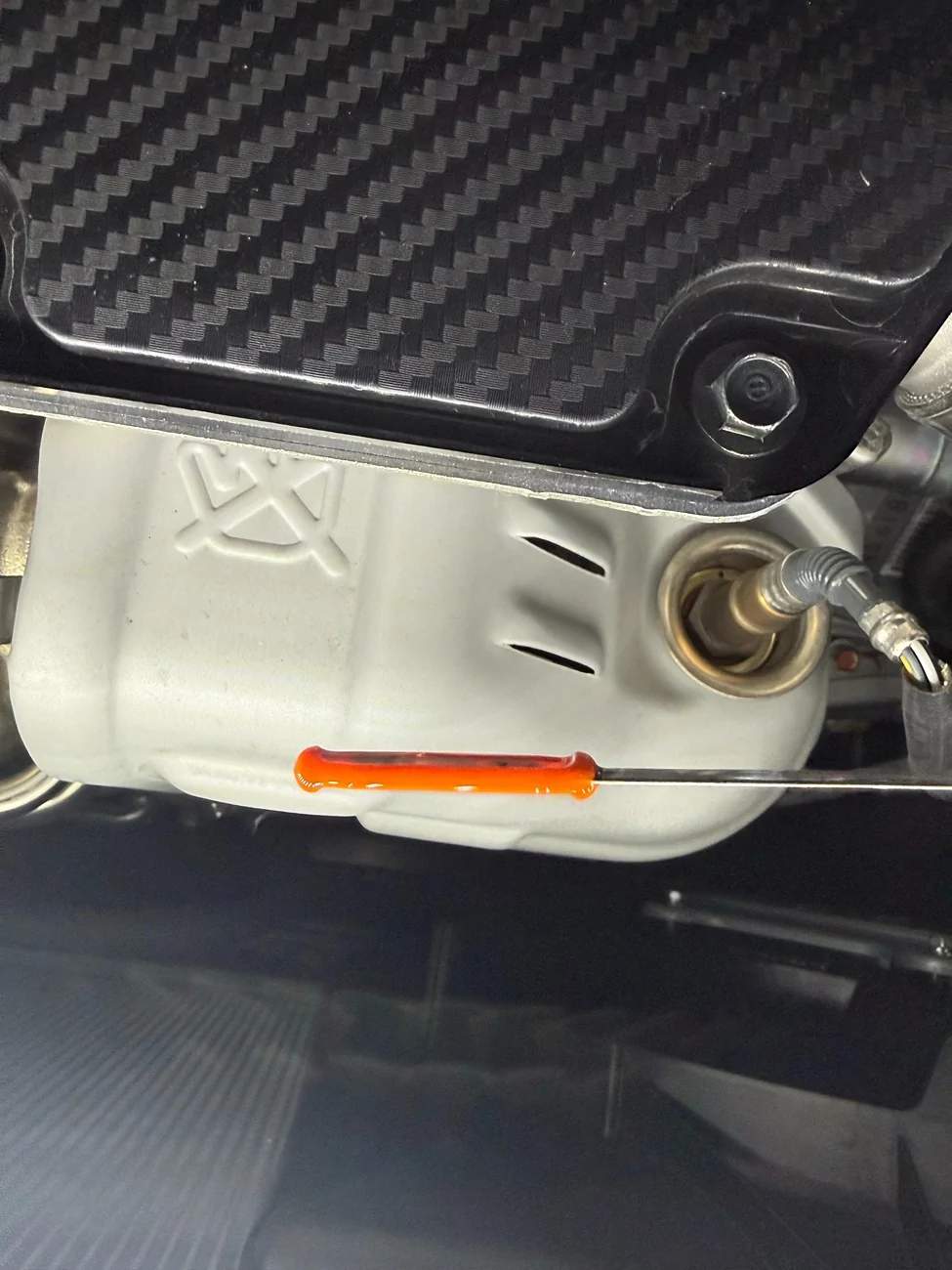

have you checked the back side of the dip stick usually the front side( the side facing the windshield) is very inaccurate. But if that’s the case it might just be the horrible dipstick or something else. Should I siphon some out or is it just inaccurate reading?

I couldn't tell you truthfully. All i can give you is the info i have - i have not changed my oil and it came like this from the dealership new. If they are telling you they put in the exact amount it calls for and it shows up on the dipstick at the same spot and different places are changing the oil - id be inclined to think the dipstick is the problem. I wont be doing anything to mine and hopefully someone else has more information or some insight on this for us.

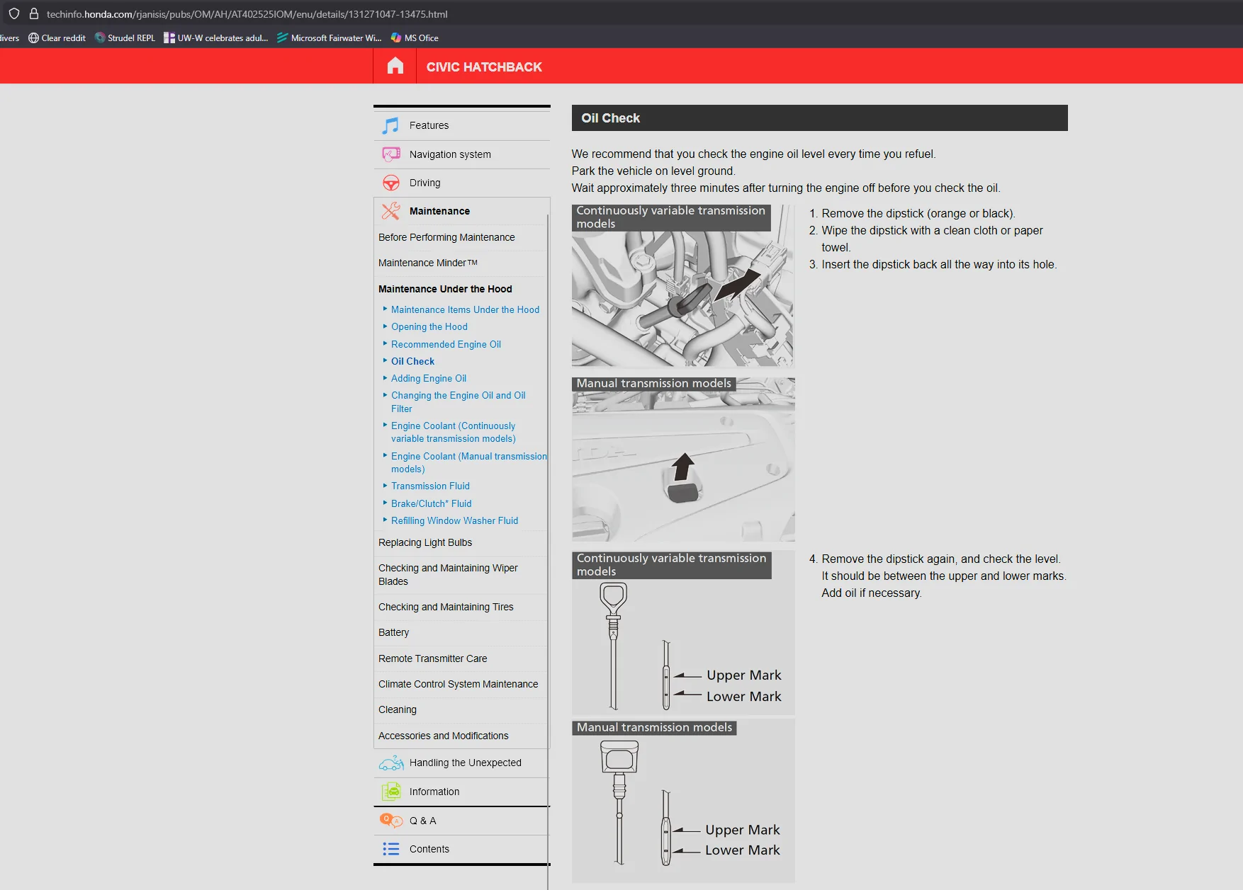

https://mygarage.honda.com/s/owners-manuals
This is from Helm directly who makes the manuals for Honda.
11th Gen Honda Civic Fl5 Oil level 1771685324922-o7
11th Gen Honda Civic Fl5 Oil level 1771685351818-50

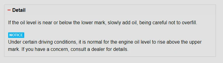

TLDR: Check after driving, let the car sit on a flat surface for 3 minutes, it should be between the two dots. If you check it after spirited driving it might be higher (that's how I read it at least).
