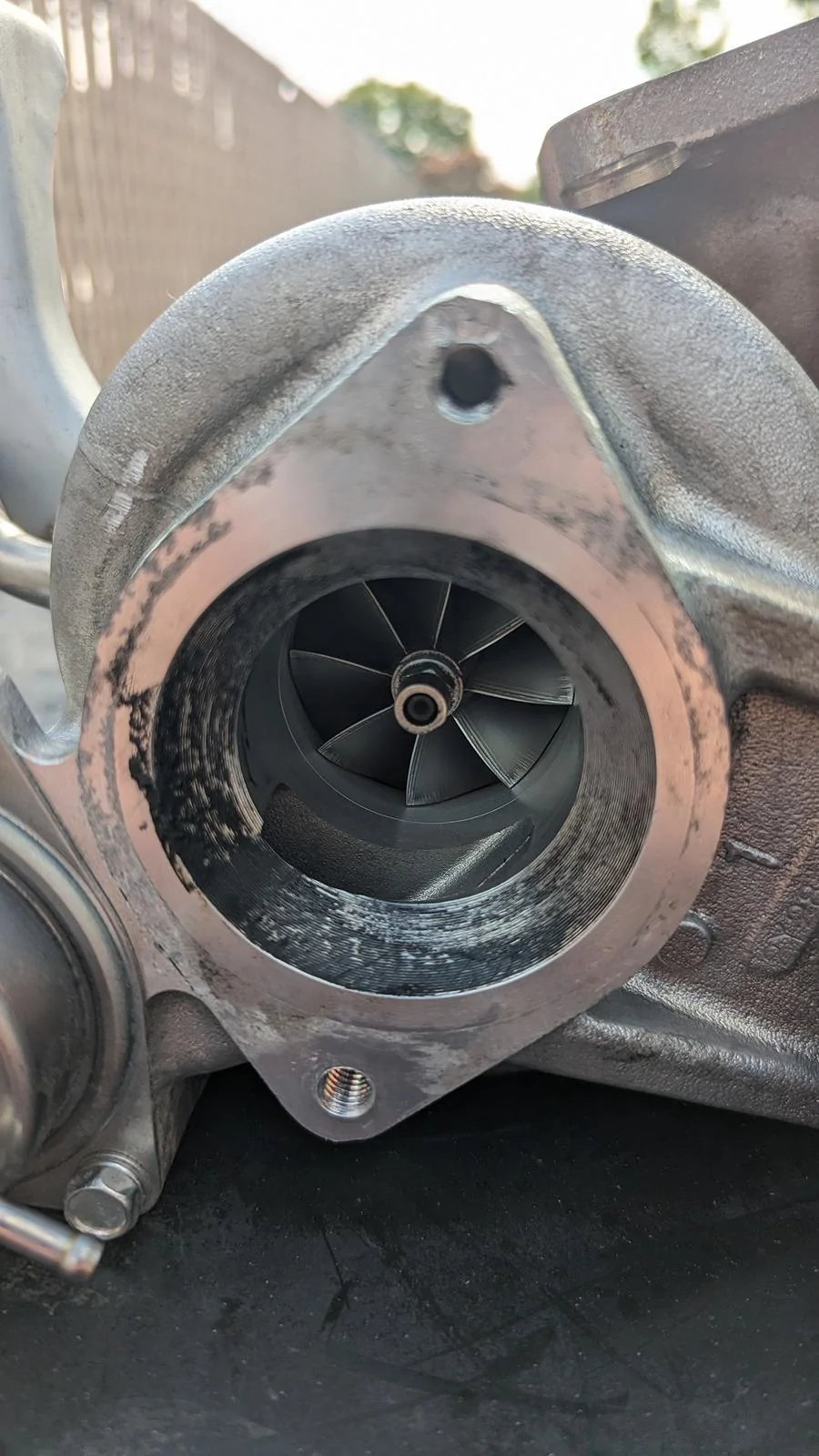

Well. I have a catch can and this is what my turbo looked like before upgrading.
