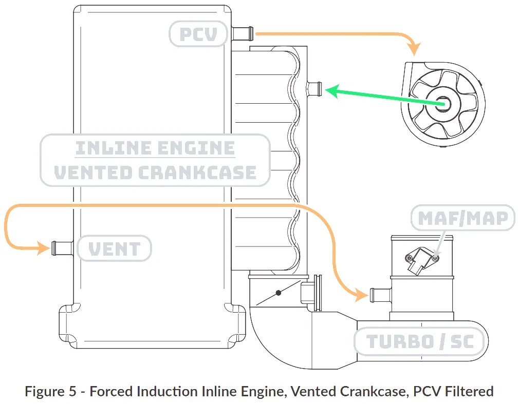

Thanks for the explanation...My last post was a confusing mess and I was not aware that the PCV valve was in the cylinder head cover itself. Here is take two. For the FL5, the Improved Racing CCS is installed inline on the PCV hose connection as depicted in this PIC (PCV Valve open when the intake manifold pulls a vacuum...PCV Valve closed when intake manifold pressure is greater than crankcase pressure from the other side):
11th Gen Honda Civic Improved Racing CCS Catch Can PCV_Filtered
That said, when under boost and the PCV Valve is closed, excess crankcase pressure is released from the CCV and reintroduced into the intake track after the MAF and before the turbo. The following PIC shows a dual catch can setup where one is installed inline on the PCV hose connection and the other on the CCV hose connection:

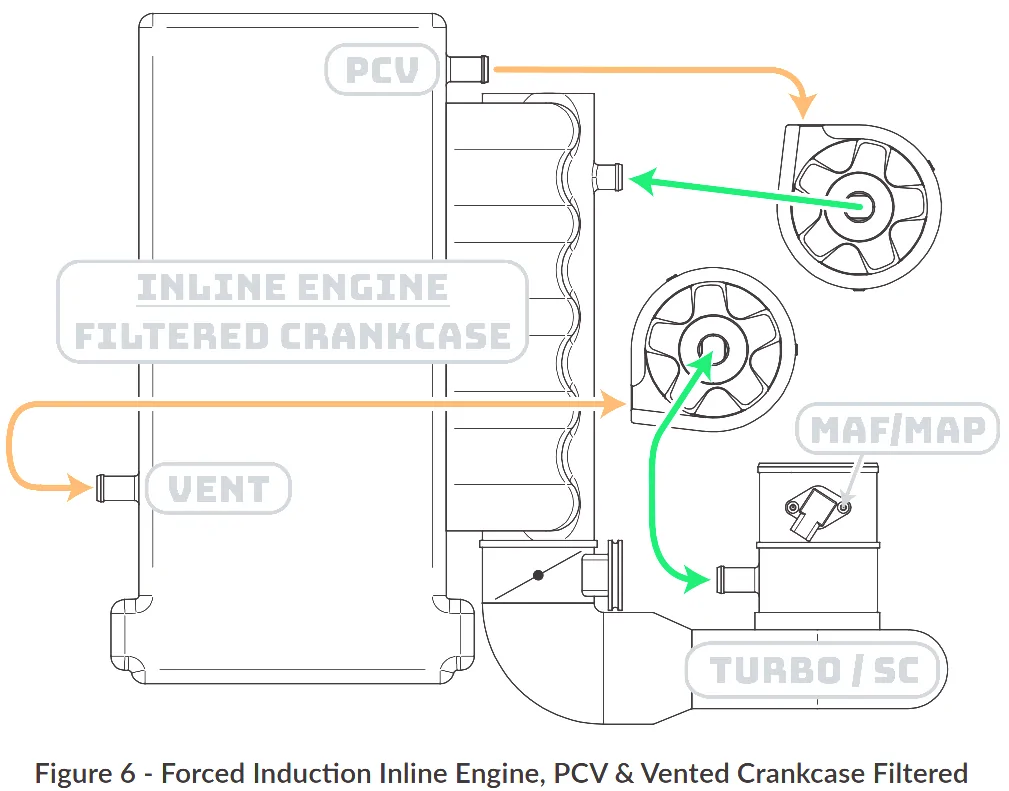

11th Gen Honda Civic Improved Racing CCS Catch Can PCV_and_CCV_Filtered
If only one Improved Racing CCS were used, why install it inline on the PCV hose connection instead of inline on the CCV hose connection? It would seem that installing on the CCV hose connection would be more effective at keeping the intake track leading all the way to the intake manifold clean. Said another way, catch can on the PCV side filters during idle/vacuum conditions feeding directly into the intake manifold whereas catch can on the CCV side filters during boost conditions feeding directly into the intake track after the MAF and before the turbo.

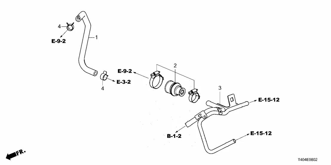

Thanks and that sucks to hear. Thinking some more, it makes sense to me now for the Improved Racing CCS to be installed on the PCV side only. In that configuration, airflow only travels in one direction just like how the CCS was designed to support.
If the CCS were installed on the CCV side, I could see where there could be potential issues since the airflow is bidirectional. Part number 3 in the below PIC would also need to be butchered up where parts 2 and 3 mate together.
