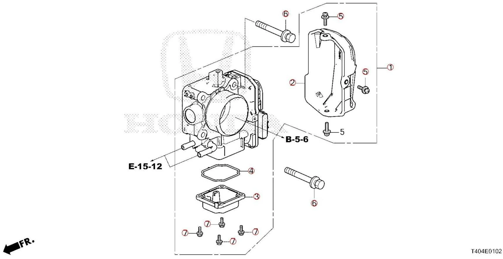

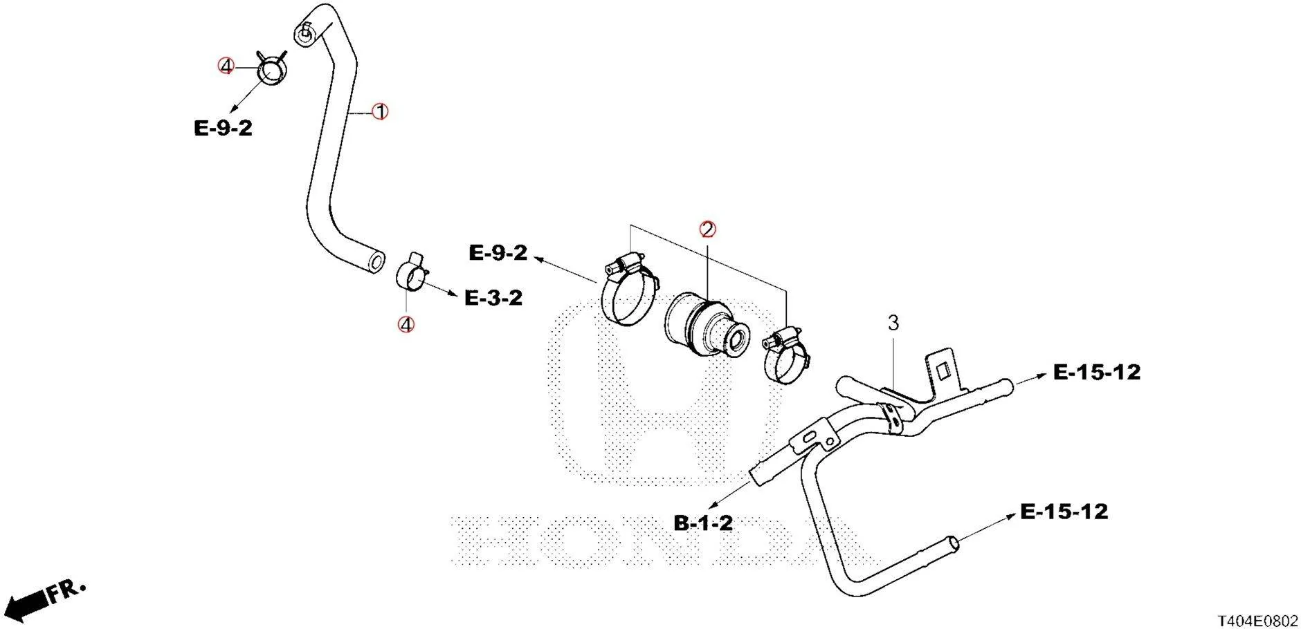

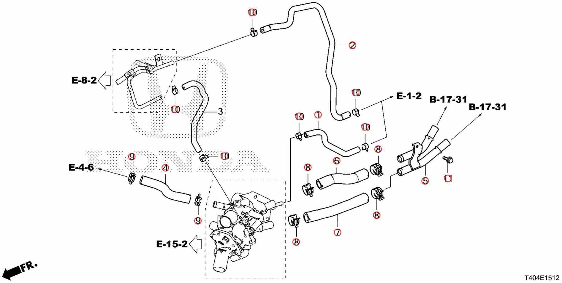

I never really understood the need to pump coolant through the throttle body so it is time to eliminate it. Here is the parts diagram for the FL5 (throttle body coolant hoses are parts 1, 2, and 3):
11th Gen Honda Civic FL5 Throttle Body Coolant Bypass 1745714157095-uu
Parts 1 and 2 in the above diagram connect to the throttle body barbs (E-15-12):

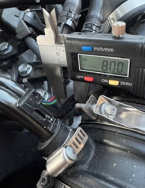

The hard pipe (To E-8-2 in the first diagram) has an 8mm OD for the coolant hose connections:
11th Gen Honda Civic FL5 Throttle Body Coolant Bypass 1745714379399-h1
8mm = 0.315" so 5/16" or 3.125" ID end plugs can be used to cap off the coolant hose connections on the thermostat case (i.e., where parts 1 and 3 connect in the first diagram). End plugs can also be added to the throttle body barbs to cap them off.

The other barb connections on the hard pipe (To E-8-2 in the first post, first diagram) are for the breather tube in this diagram:
11th Gen Honda Civic FL5 Throttle Body Coolant Bypass 1745718044395-fk
The hard pipe can be removed if you are using an aftermarket catch can connecting between the valve cover and intake pipe connection. If your car is tuned to run off of the MAP sensor only, then you can plug the connection in the inlet pipe and put a breather filter on the valve cover to vent to atmosphere instead of recycling.

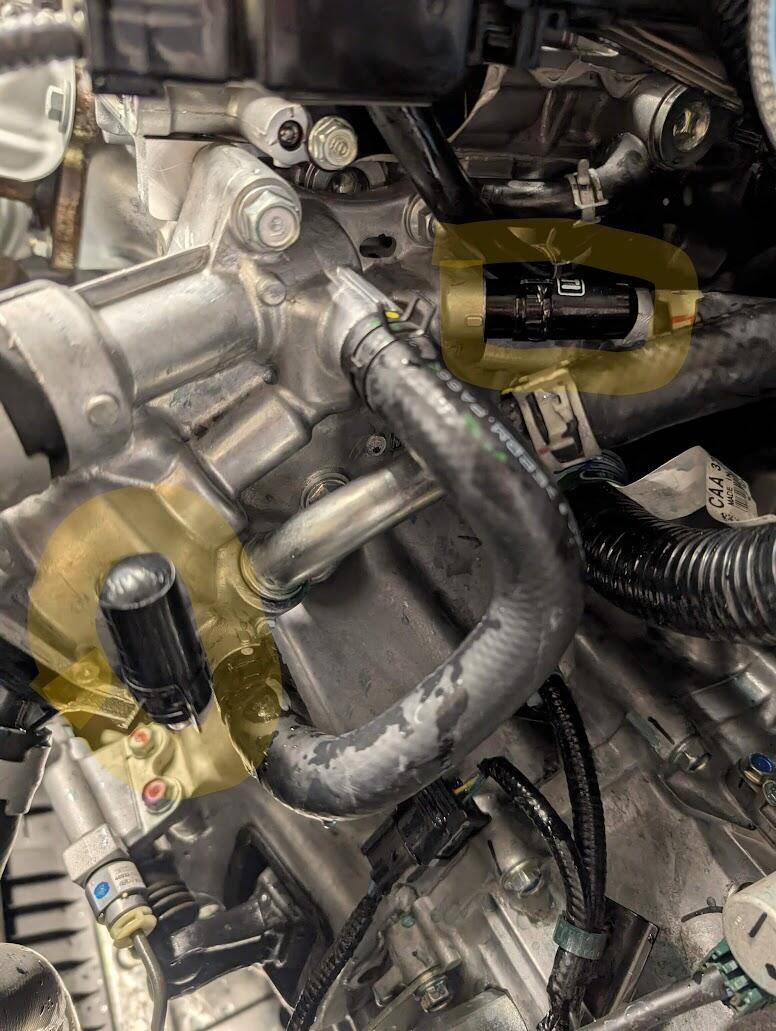

Thanks and cool...Would you happen to know the routing and purpose for this hose on the FL2?
That hose and its plumbing is stock. I did not modify it. It connects the upper and lower sections of the thermostat/water pump housing. I wonder if those connections are used on turbo engines.
I got the idea after reading this thread. I live in Southern California. I don't ever worry about freezing temperatures. ? I bought these caps and clamps.
Cool and thanks...I'll have to look at the hose on the FL5 the next time I remove the intake. It does however make since that those barbs may be used for the coolant lines to the turbo.
