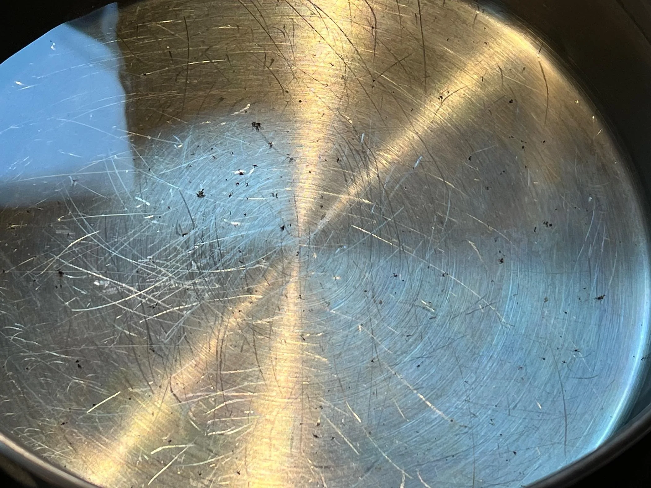

Just a PSA to rinse out a coolant expansion tank before installing, I think these are styrofoam fibers that worked their way in during shipping:

Just to confirm, the Mishimoto expansion tank is the same for the FL5 that fits the FK8. Mishimoto could not confirm it fit, which is odd.

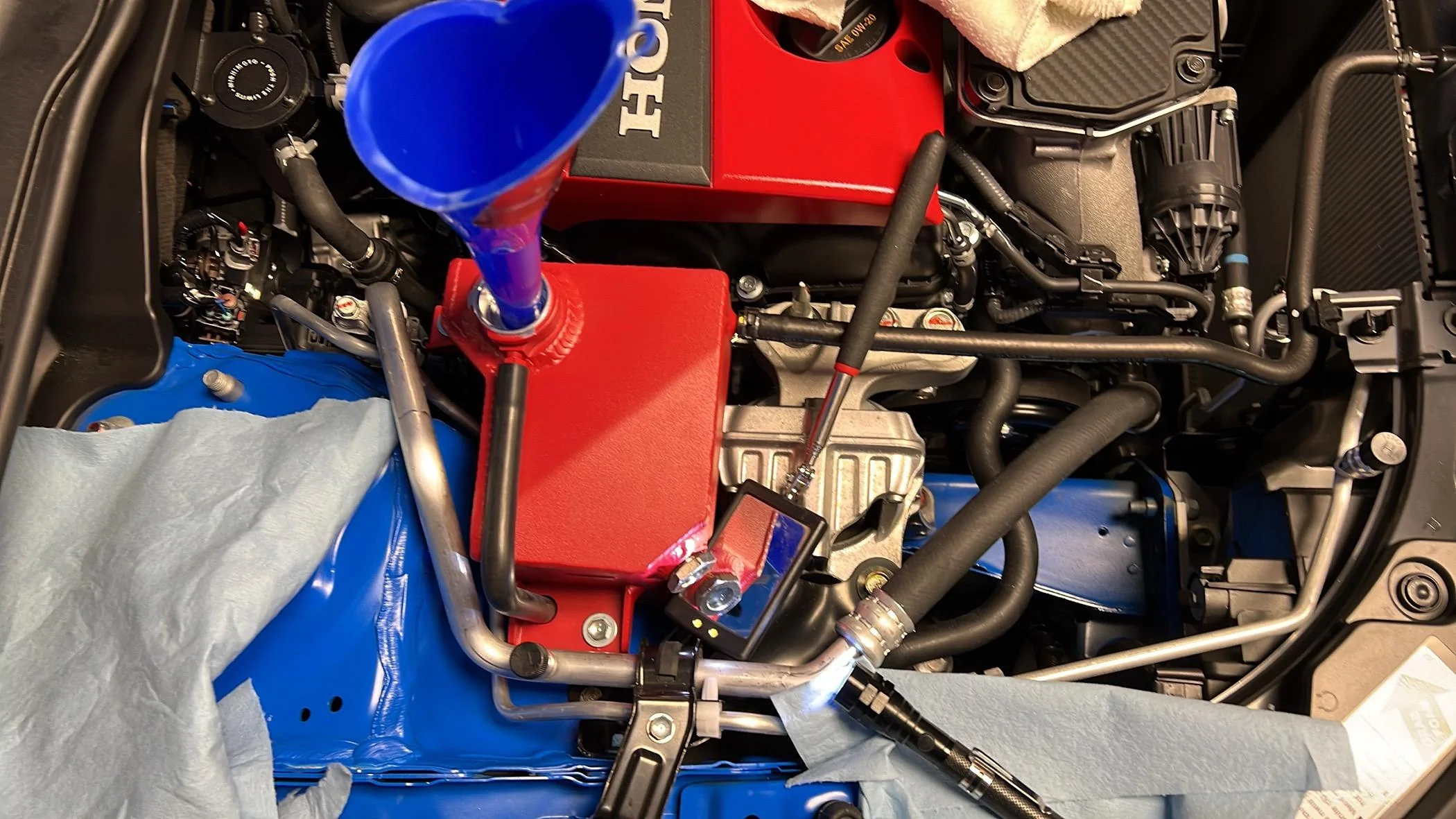

I used a flashlight and mirror to see the coolant level reach the sight glass while pouring:

So far the radium tank with hondabond is holding up. After one track day, no leaks.

That thing will never fail. The hondabond you placed that day can never be undone. ?
Yeah I hope not. So far each time I check under the hood, no blue coloration on the hood or anywhere on/near the tank. I didn’t think I put too much but clearly I put too much when I had to scrape off from the inside. Thanks again for telling me to do that.

27Won. It’s a solid single piece, radium is two pieces and prone to leaking at the seal unless you use RTV sealant. 27Won is a big Honda vendor- I have their rear motor mount and it’s a perfectly machined piece.

Why not mishi? It’s a solid piece, I have no issues with mine. I wouldn’t go with radium, either mishimoto or 27won.

Peeps seem to worry about the sight glass leaking. Here's a thought ........ just don't fill it up all the way to the sight glass in the first place if nervous ................ ;-)

Not sure. Mine hasn’t. And it’s filled halfway. The threads comes pretreated. I have not seen any leaks so far. It was my concern with the radium tank. But seeing how you can use sealant on it, I was willing to take chance since I didn’t like the looks of the other options currently available.
