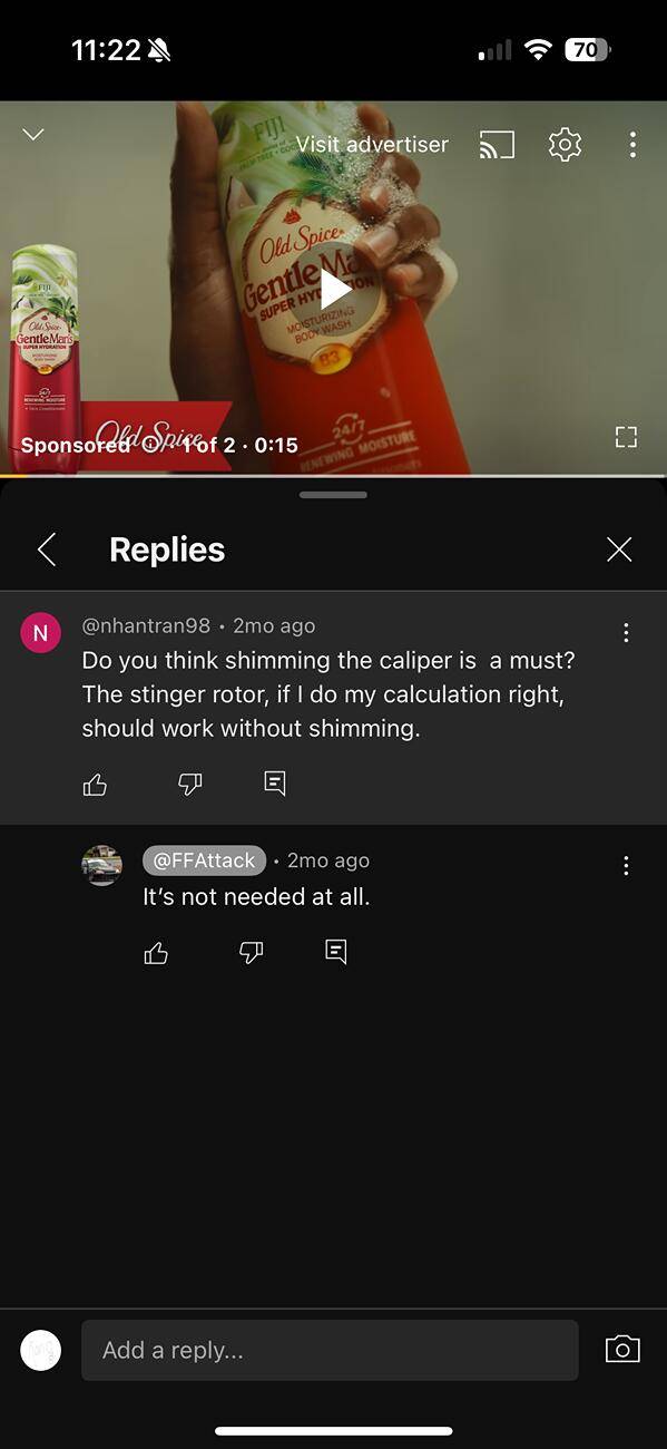

Is this the Kia stinger caliper?
And what rotor did you use
Both Genesis Coupe and Stinger would work I would recommend some machine work on the Stinger caliper as it off center of the rotor by about 1 mm. Rotor is Nissan Juke Nismo RS (2015 i think but check the spec). The juke got better pad contact due to smaller hat but would not fit older civic (8-9th gen)
