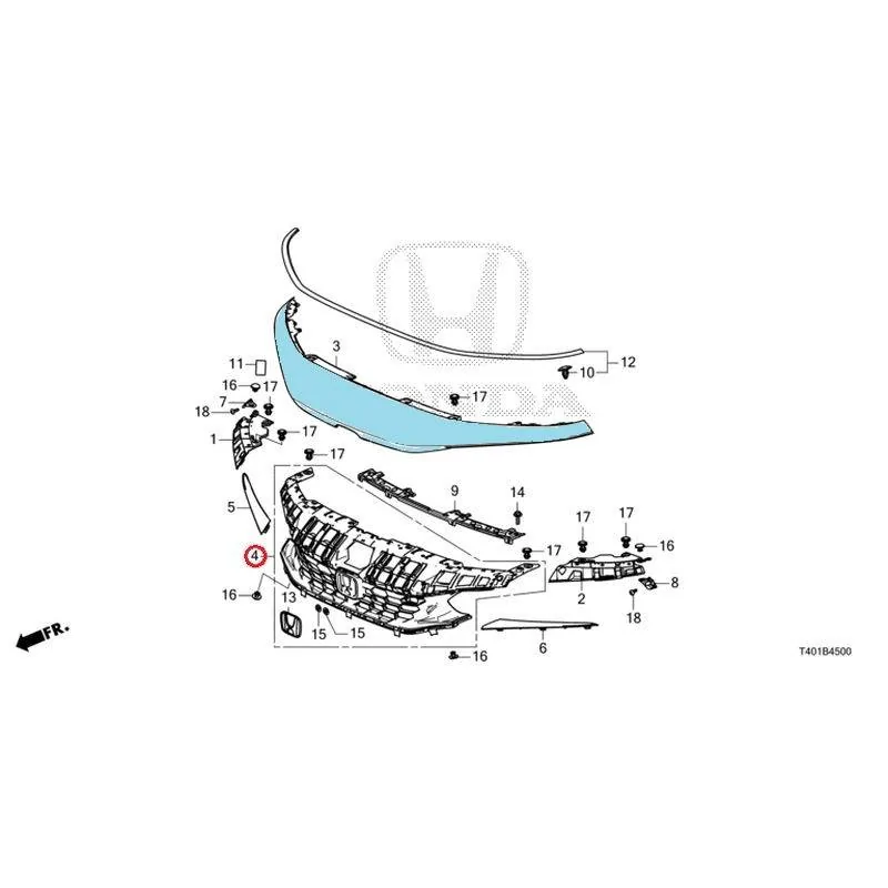

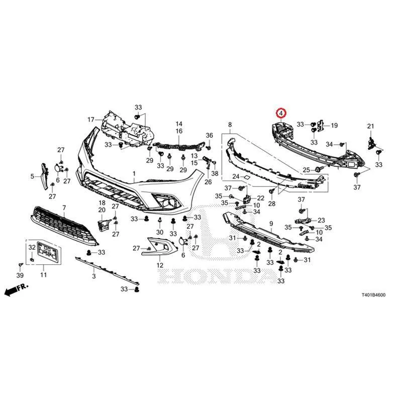

The hatchback and sedan have different grills, so they will have different part numbers. Even though the Si grill looks identical to the Hatchback, but it comes with mounting hole for the Si Badge so it's going to have different part numbers.
The bumper cover, however, is identical on all 3 models, so all 3 grills can be swapped provided you change the upper nose piece #3 as well. This is how the 10th generation should have been made, Honda learnt from their mistakes.

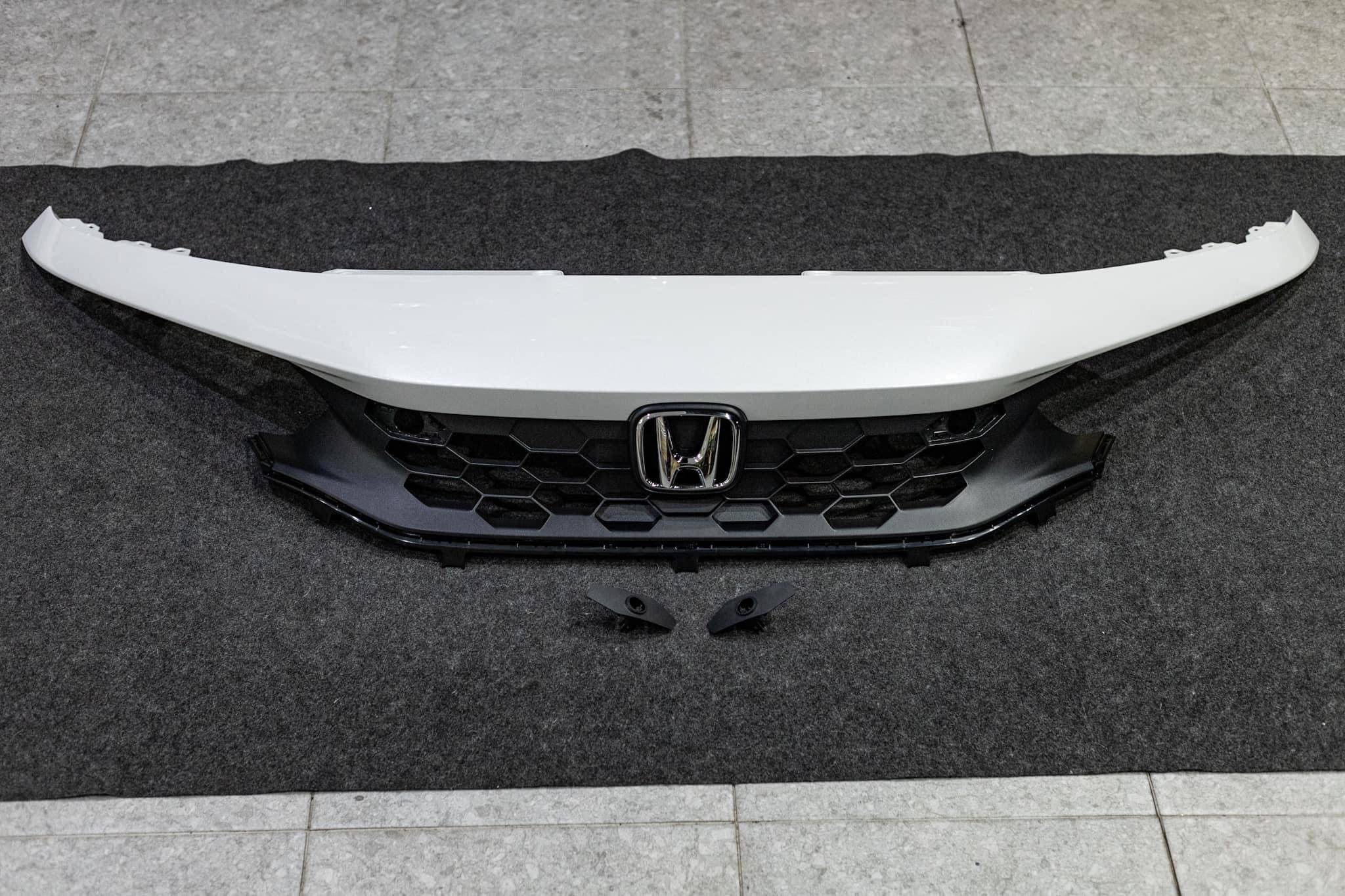

Any idea what the part number for Si grille is?
No, I don't see them on any online honda part stores yet.
You can get the hatchback grill, which is basically the same thing unless you specifically wanted the one with Si Badge. I believe the Si grill will have an indentation for the Si badge (like the 10th gen) , or it could be the same if the Si badge is secured with mounting plate like previous gen.
Not only the grill, you obviously have to get the upper painted nose piece as well.
