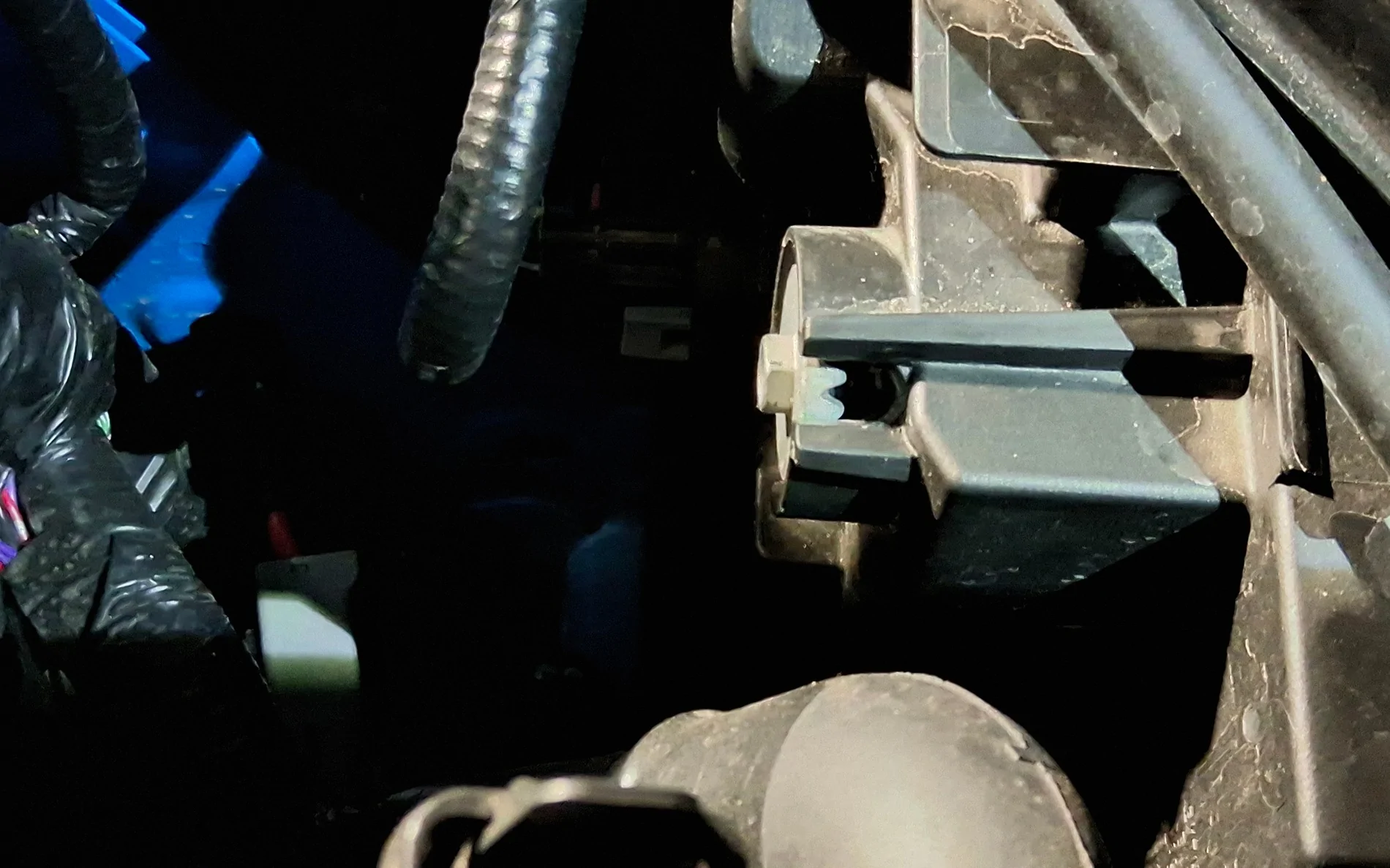

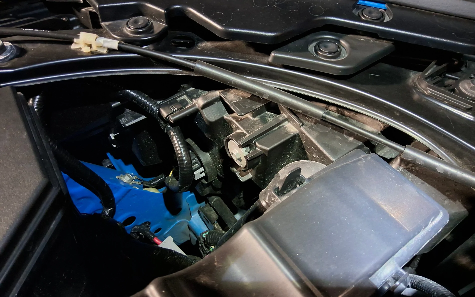

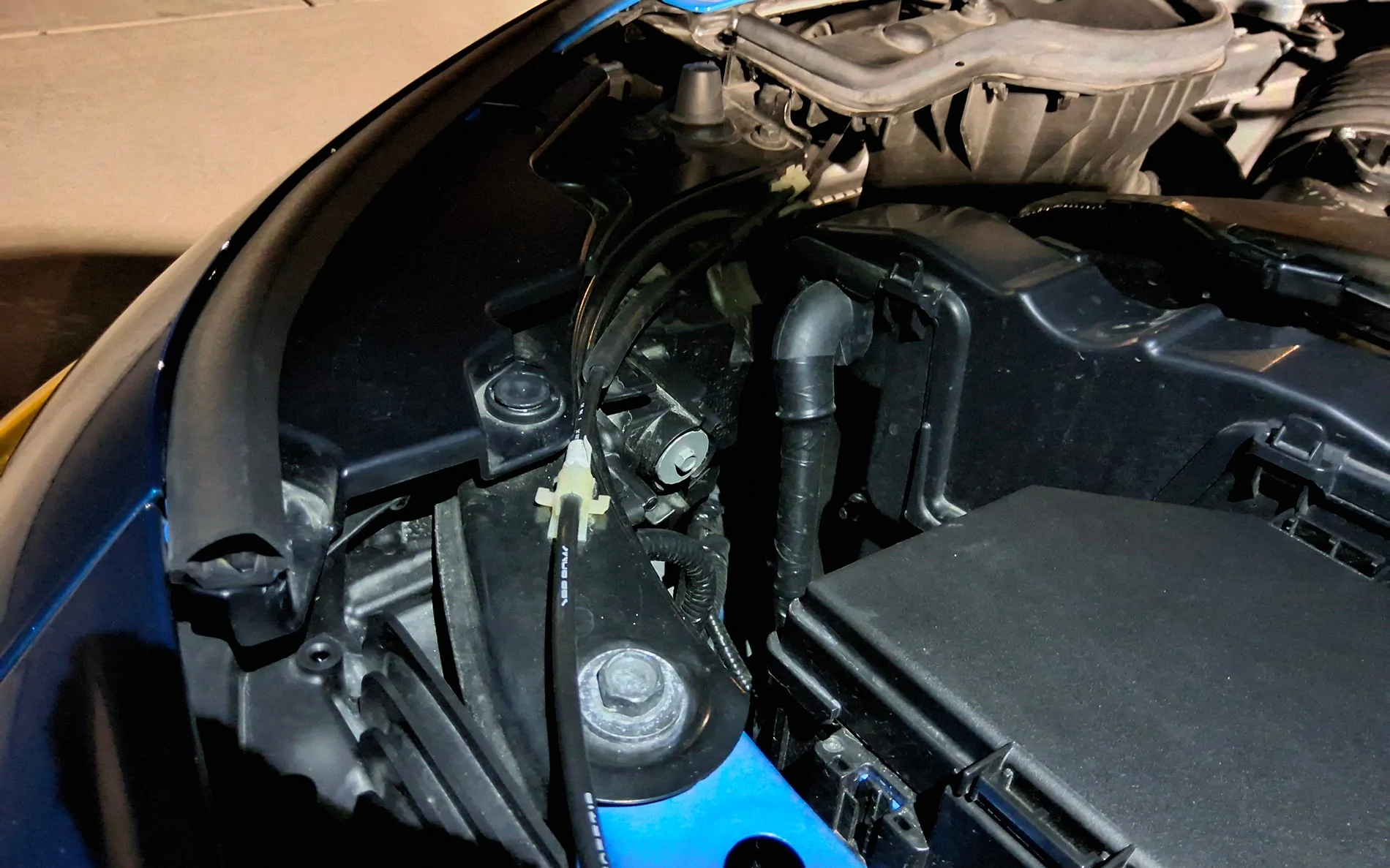

I popped the hood and looked behind the headlights.
Here is what I found.
Left Headlight.
11th Gen Honda Civic Headlight Adjustment? 20251211_192034
This bolt looks like it has teeth. Maybe this is for semi fine tune adjusting the beam height...?
11th Gen Honda Civic Headlight Adjustment? 20251211_192224

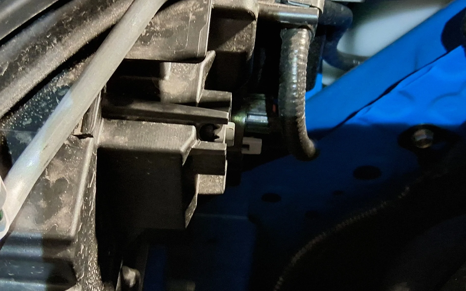

Right headlight.
11th Gen Honda Civic Headlight Adjustment? 20251211_192102
Right headlight bolt.
11th Gen Honda Civic Headlight Adjustment? 20251211_192249
Anyone know if these are the adjustment bolts for aiming the beam height of the headlights?
Thanks.

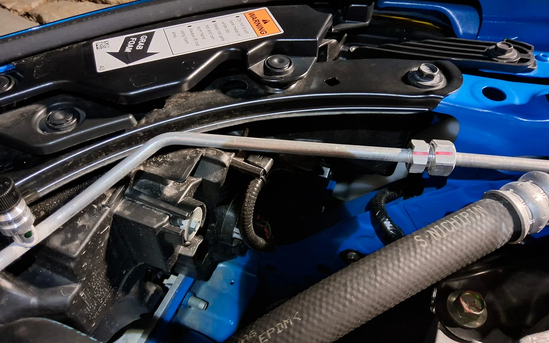

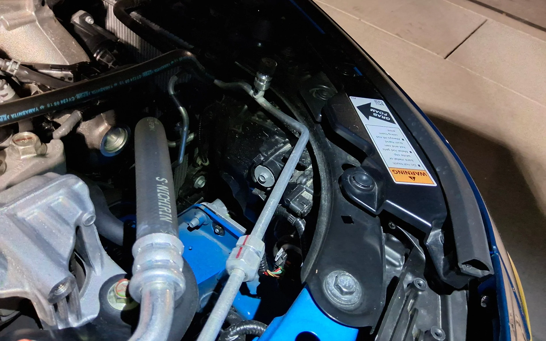

Left headlight bolt closeup.
11th Gen Honda Civic Headlight Adjustment? 20251211_193906
Right headlight bolt closeup.
11th Gen Honda Civic Headlight Adjustment? 20251211_193922
Are these teeth the beam height tuning adjustment notches?

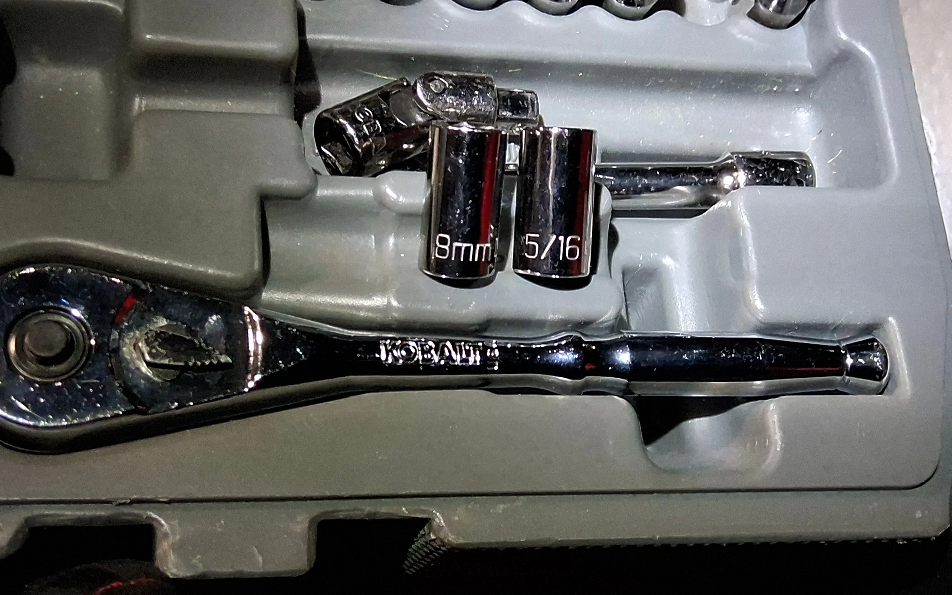

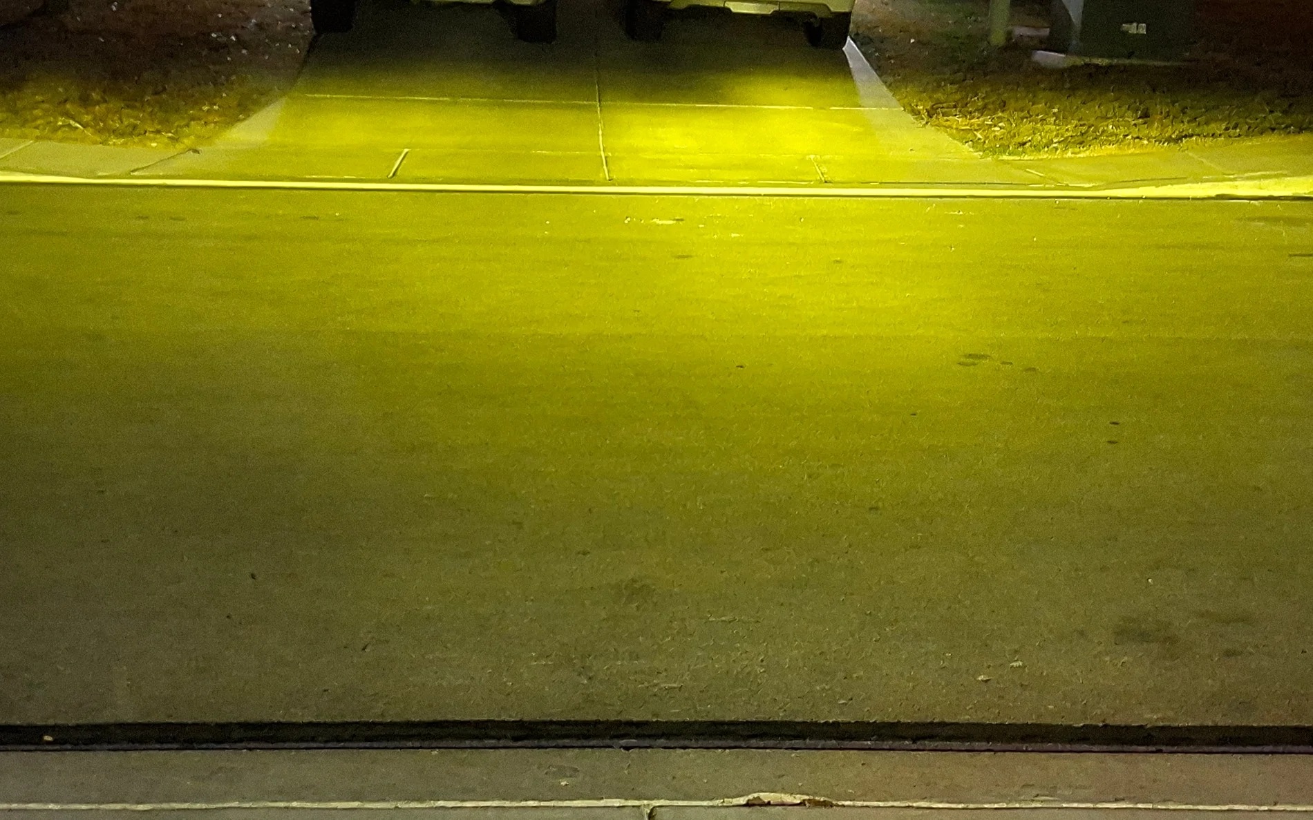

So... I turned on my car and my headlights, just in my crooked driveway, and I gave it a shot.
An 8mm or a 5/16 socket will fit the bolt.

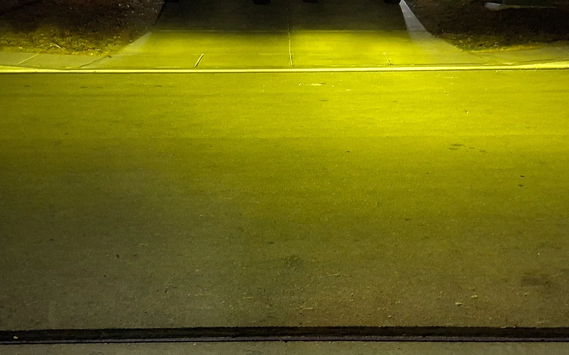

11th Gen Honda Civic Headlight Adjustment? 20251211_195633
I adjusted the right side headlight.
Before adjustment.
Note that my driveway is slanted, so my right headlight sits physically higher than my left from this position. We are just looking from my driveway across the street to my neighbor's driveway.
11th Gen Honda Civic Headlight Adjustment? 20251211_195754

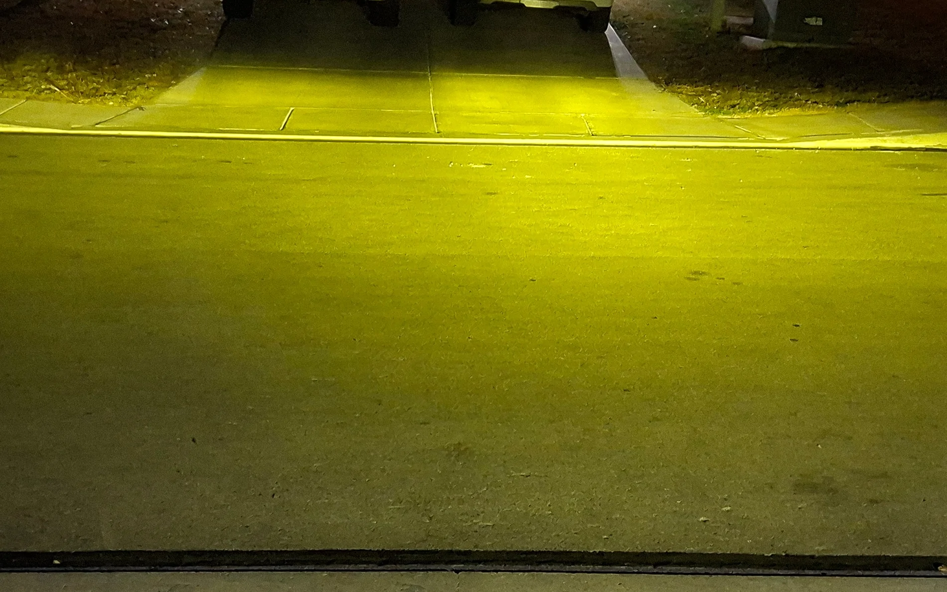

After turning the right headlight bolt clockwise.
11th Gen Honda Civic Headlight Adjustment? 20251211_200833
After turning the right headlight bolt counter-clockwise.
11th Gen Honda Civic Headlight Adjustment? 20251211_201031
It looks to me that this is how the headlights are adjusted on 11th Gen Civics.
I haven't found any other screws or bolts yet. Of course it it dark outside right now, and my middle age eyesight not so good these days, so... that's my excuse, if I missed anything.
