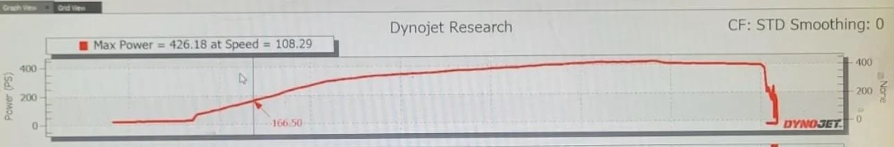

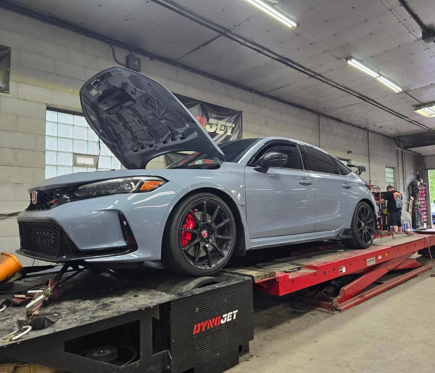

Car pulled power big time up top. Where you having issues with IAT’s ?
Was extremely humid and they didn’t have a lot of fans .. its absolutely possible. Was also driven for an hour and a half so was plenty hot when it arrived. See the tiny little fan ? That was it for cooling.
Yeah I suspected it, same thing happened to me on a car I was tuning. Not as marked as yours but still there.
