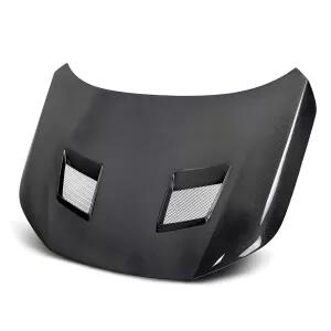

I'd also get a CF hood like the one thats on the DE5 TCX car. Its seibon, I have the link bookmarked on my PC

De5 shares the same hood as fl5? Have you seen it in person if the fitting is flawless?

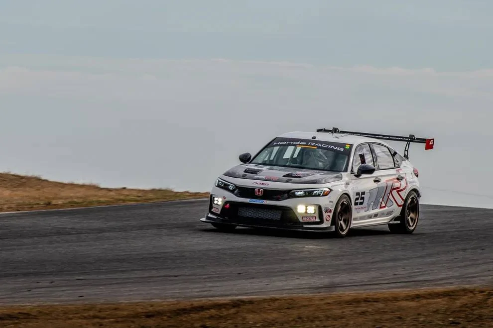

DE5 has a different hood design but it should be a 1:1 fit. Can't speak in person about fitment with Seibon, I don't really scour other people's builds or go to car meets otherwise I'm sure I'd see someone with it. I bet if you look around you could find an owner with it.
The Varis one seems really overpriced. The venting looks a bit too similar to the OEM one, they just made the center hole bigger and added some side vents. Honestly you could probably achieve the same effect by going on race louvers and replicating the same design for far less, you just wouldn't have the lightweight carbon fiber benefit but I don't think that does much with heat dissipation.

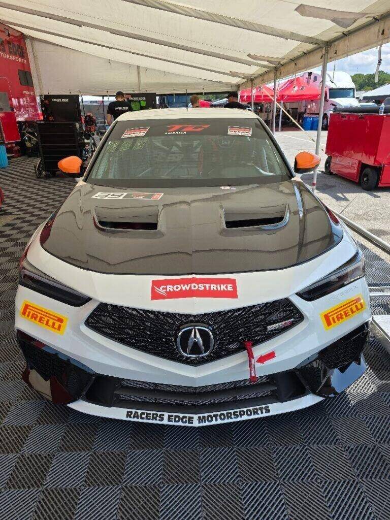

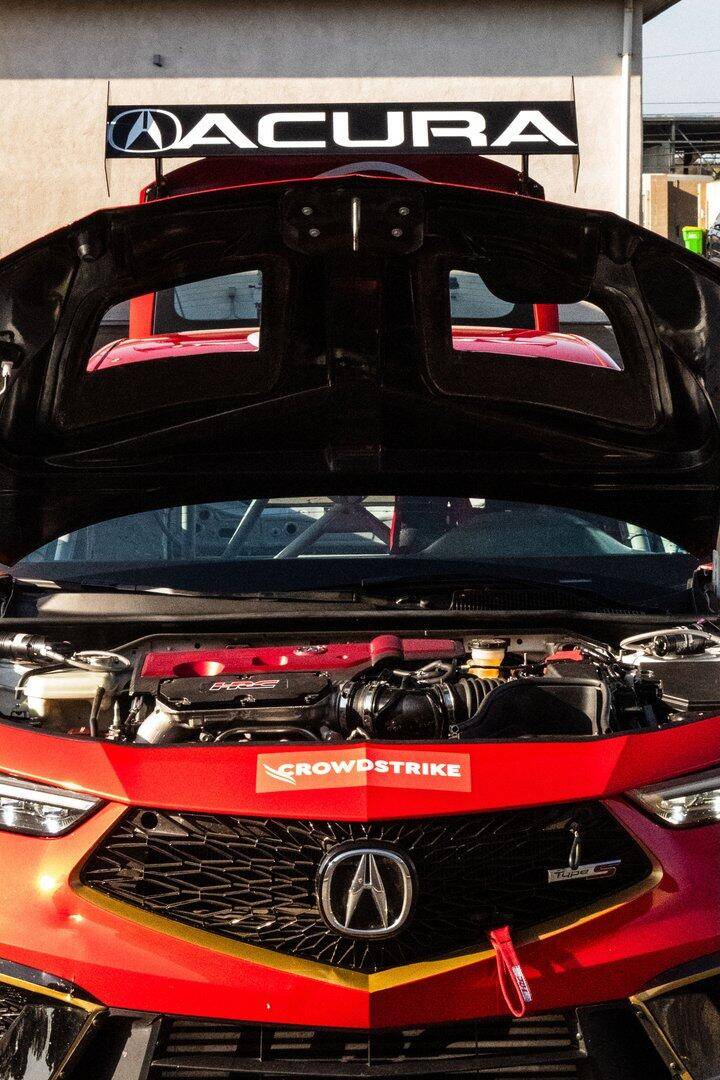

But for me, I'd rather just use what you see the professional race teams using. I haven't seen any race team use the varis hood.

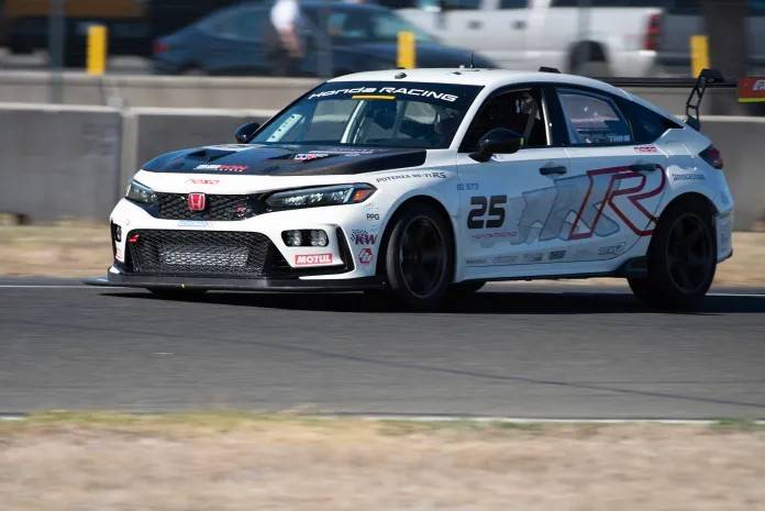

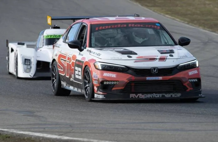

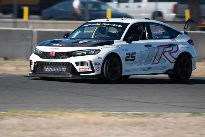

HRC used the same Seibon hood for the Thunderhill 25 hour endurance race. It was used on the on the Civic Si too.
