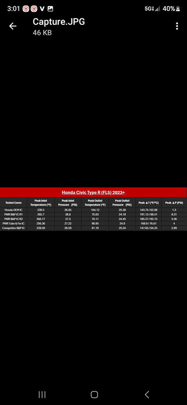

What's this tell you ?
It depends on the conditions of the test and what the definitions are of the measurements. If it is sustained over 20 minutes of hard use AND the peak is indicative of the broader curve that could be insightful. Can you elaborate pretty please?
Honestly nothing lol, I don't know what I'm looking for, or rather what the use case would be.
Wouldn't you ideally always want the temperature delta to be low? Or does a high delta show that the fmic is good at cooling? If the fmic gets to some outrageously high number, but then rapidly goes down, is that better than having lower temps at peak and normal temps once it goes down (hence a smaller delta)? Ideally the temperature would never shift, which makes me think the latter option would always be better since it's more consistent, but it also implies that if there is significant heat, it won't be able to cool as efficiently.
There's also the matter of if the fmic temps are only lower because they're not having all the heat transferred efficiently.
In any case I'm shooting in the dark.
Don't tell me shit been looking at it a few days. They only thing pwr really say about it is ''F1 tech'' this is the data We are the best .
I doubt any aftermarket company is going to provide that intensive testing. The most I've seen is just a graph that just shows the lower temps, but nothing about speed or time sustained, and even then its not really conclusive.
Its crazy but I feel like alot of these products fall into the 'trust me bro' thing and just lean on theory for why they work. Thats why I only look at whats on the DE5 ITS TCX and the FK8 TC because those cars are the really the closest to a street car. Never done aftermarket development so I don't really know how it is behind the scenes but it would be nice to see the better data.
For what its worth there are FL5 race cars that still use the stock IC. I never ran into a problem with the overheating yet, but thats all driver skill and track dependent. When it starts to get hot here in Florida it probably will become an issue for sure. Tbh Im more worried about how to handle the coolant and oil temps since thats what will actually blow up my engine ?

Good intercooler data is VERY hard to find. People love to throw numbers out but their testing was done in a inconsistent manner leaving you with apples to oranges like data. The "all intercoolers suck thread" is a bit comical at this point, reader beware for sure.
We at TSP LOVE good data and refuse to be associated with data that is anything less. I don't believe we are equipped to provide strong intercooler data that we can stand behind, so we do not publish any.
If you wanted the best track intercooler today based on assumptions based on it's composition, I'd say PWR. Yes, you will pay for it.
More cost efficient options for the track are coming.
This is actually great data, truthfully. To me, at least.
I'm paying attention to the inlet temps. It's fucking HIGHER for the aftermarket intercoolers!!! From just this data alone I can extract two pretty compelling hypotheses:
1) The delta is influenced by the higher inlet temp, thus implying higher efficiency
2) The inlet temperature is influenced by the HIGHER AMBIENT TEMPS IN THE ENGINE BAY, which if I were to guess, may in fact be CREATED BY THE INTERCOOLER.
Otherwise, data looks good that the outlet temps would be substantially cooler, leading to an overall increase in peak boost pressure. All this makes sense and is the expected outcome for what you'd expect an intercooler to actually accomplish, in lowering the temperature of the air going into the turbo. So for guys chasing big power, an intercooler is probably necessary.
But that's not what we're talking about here, we're specifically talking about overheating on track.
So if having an aftermarket intercooler (especially bar and plate...) results in higher ambient temps (reflected in the honestly pretty dramtically higher inlet temperatures), then I'm feeling pretty good about my theory that an intercooler ACTIVELY CONTRIBUTES TO OVERHEATING.
Somebody tell me I'm wrong! Seriously, I feel like I'm on my own here and I just don't understand why I'm the only one fighting this battle.

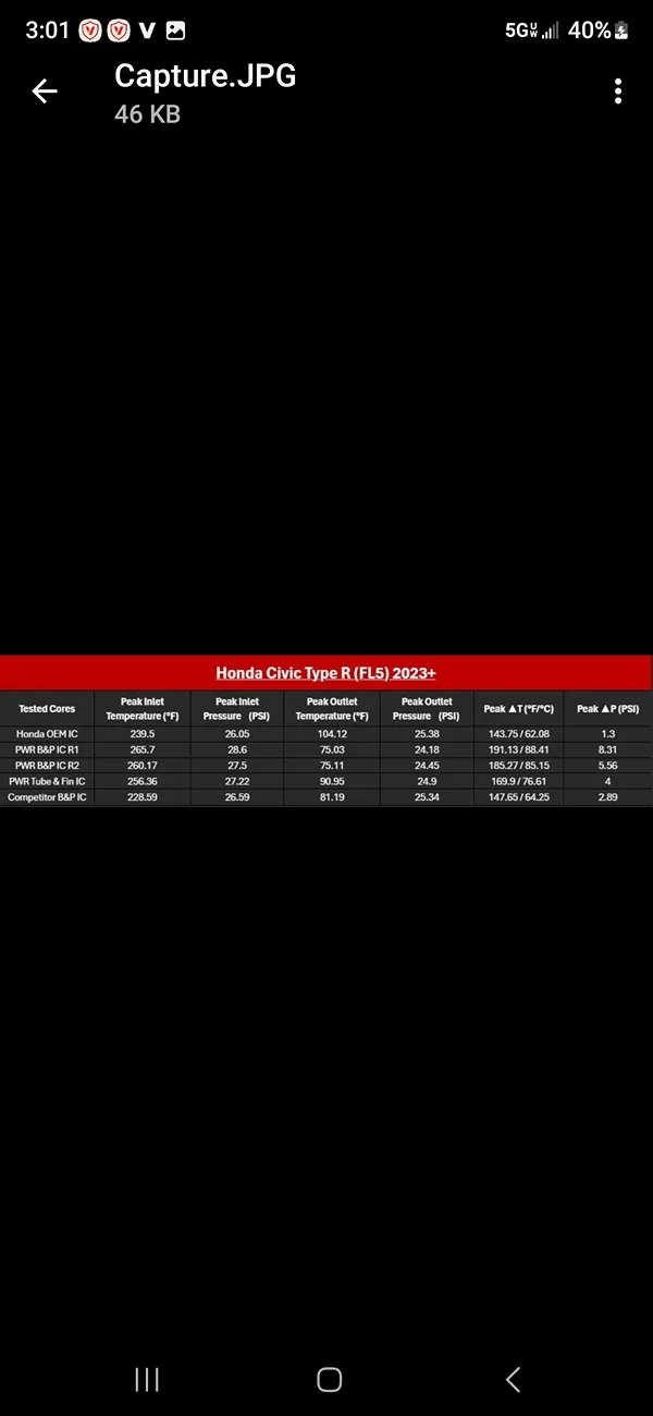

Forgot to add this information about the data that I posted. This is also something to take into consideration.
