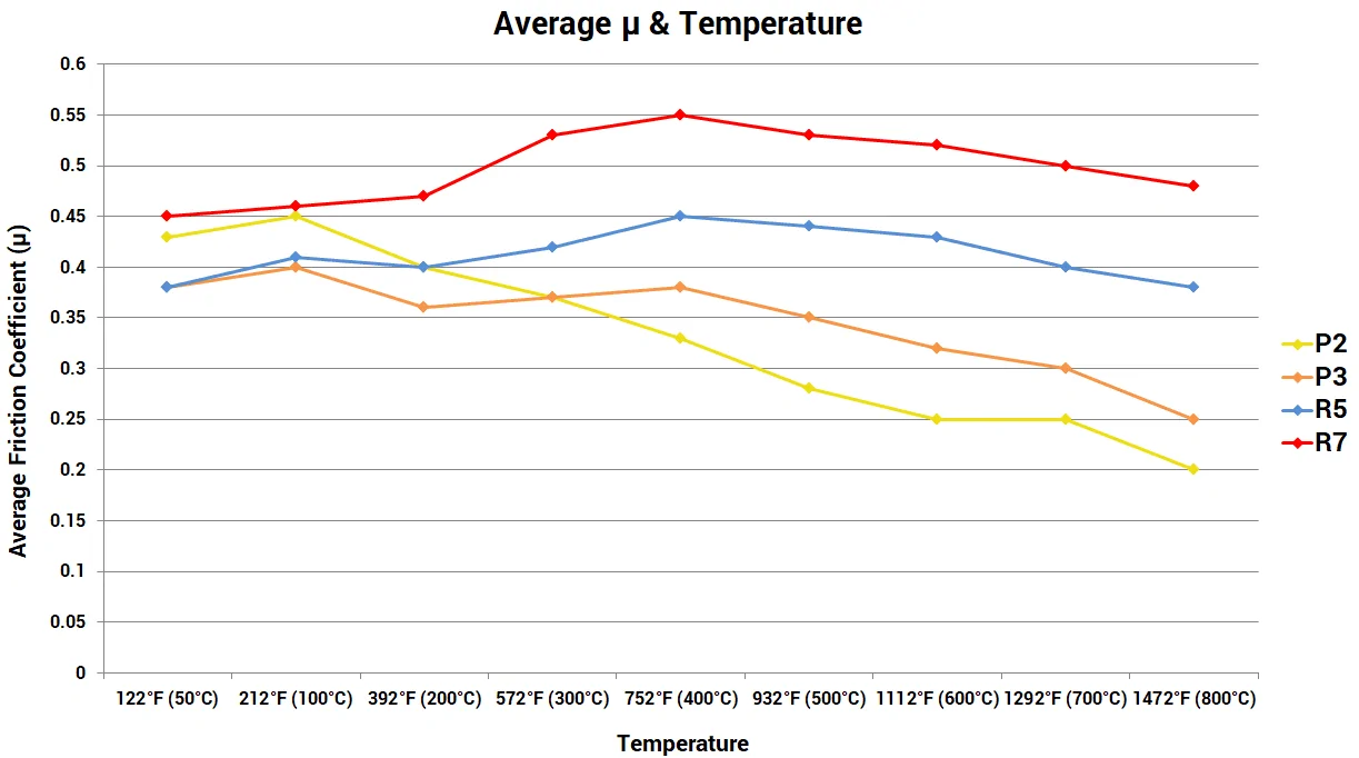

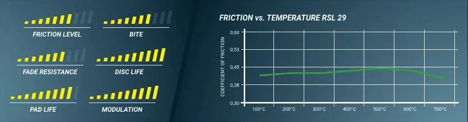

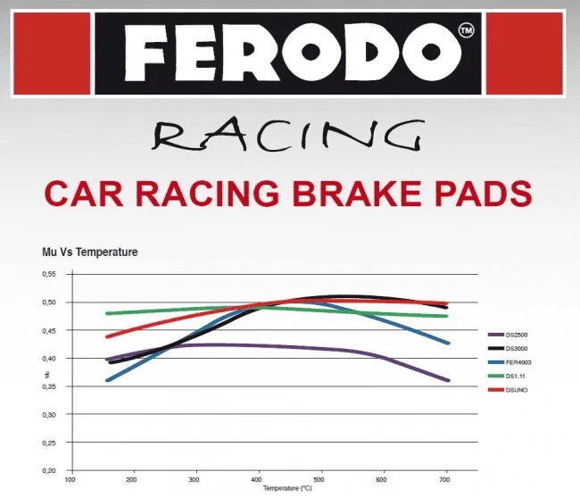

key difference for my reference as well:
ds2500 efficiency drops down on 600c but it's noisy?
11th Gen Honda Civic Best combined track and street pad? 1711427300064-xe
note: i get what i paid for. looks like p3 temperature efficiency falls on 500C
11th Gen Honda Civic Best combined track and street pad? 1711427314288-tu
efficiency falls down 600C. ive used these pads. it's so quiet that I forget that I'm using a track race pad.
