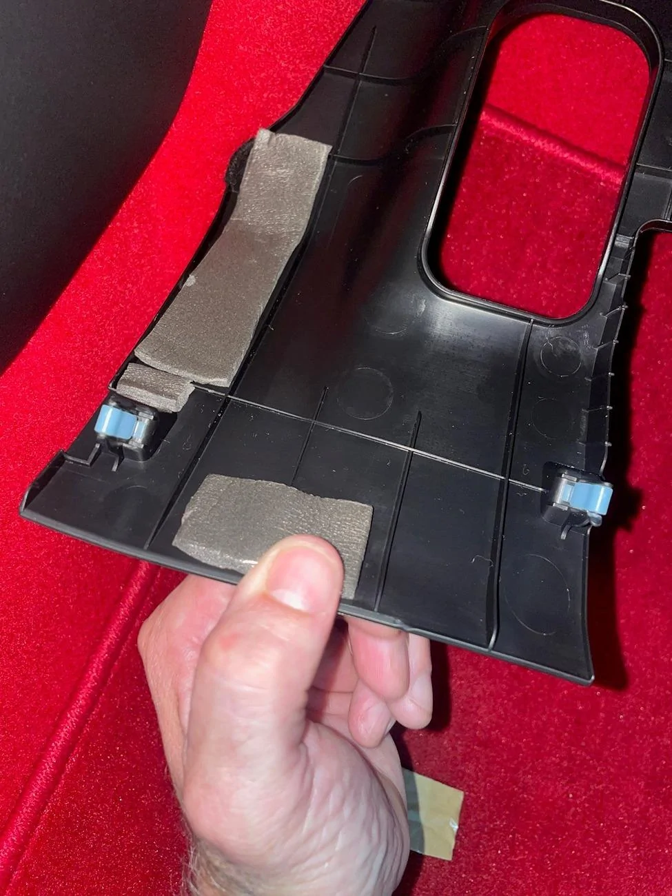

Today I pulled down the panel on the left side beneath the glovebox. There's two clips holding it up. It is tapping vibrating against a big white piece of plastic. I put some sound deadening material inside the panel where it vibrates against the white plastic box. This did the trick. No rattle even in R mode.
I couldn’t tell how that piece is held in place and am paranoid to start pulling on panels (and potentially breaking something). Nice job!

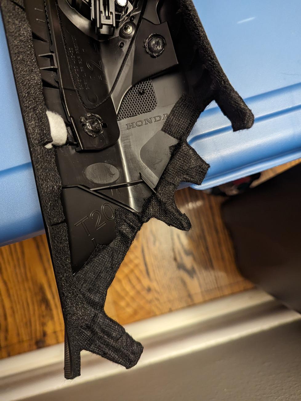

Yeah, it's resolved. I Tesa taped the hell out of the bottom section so its press fit rather than loose fit. I also went overboard with foam tape along the whole edge. But since then i've been dealing with rattle under the steering wheel and center dash. It seems like when one source of vibration is dealt with it travels to another place. I've just about pulled apart most of panels at this point and i'm done playing this game lol.
I'm scared to take these off since there's airbags under there. Are they simple to take on/off? Also, where did you get the Tesa tape? I saw the tesa® 60606 PV1 product on their site but can't find it anywhere online.
The single-use clip was a bit tricky to get it off, but other than that it wasn't too bad. I had harder time trying to put it back on correctly then taking it off since it was a tight fit with the tesa tape applied. "HomeLink Mirror Install for 2024 Acura Integra " youtube video shows how to do it. I got the Tesa tape from Amazon.
