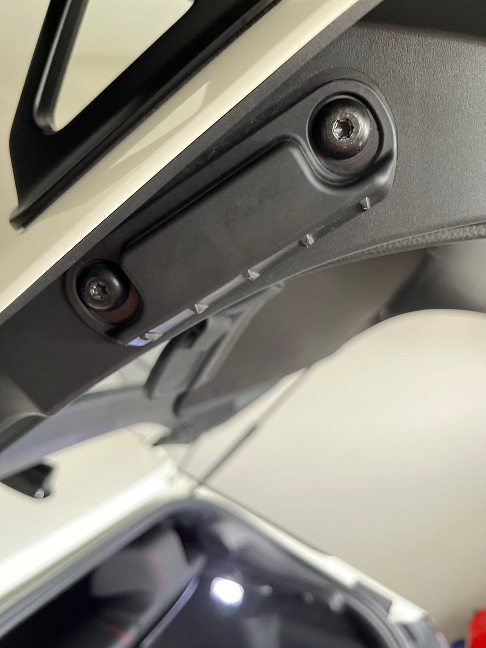

Finally figured out the rattle “clink” sound (when hitting a bump) occasionally coming from the trunk area after like 18 months of ownership. I did EVERYTHING I could think of to locate and eliminate the issue…except 1 fairly obvious thing! The “clink” was coming from the trunk latch! There wasn’t enough tension in the latch, so basically my trunk door was bouncing just a little bit and the latch would “clink” like two chain links being snapped tight against each other. I couldn’t replicate it except when driving, so I had ruled out that it was an issue with my trunk and thought it was probably a loose heat shield under the car. I was very wrong. To fix it, all I had to do was move these rubber bump stops down (located on both sides of the trunk door).:doh:
NICE! I will give this a shot later today.
I had the same issue and couldn't figure out how to stop it.
I settled on wrapping the latch with some electrical tape to provide more tension. Worked great, but after about 1.5 months, the tape it gets all cut up and requires replacement,
