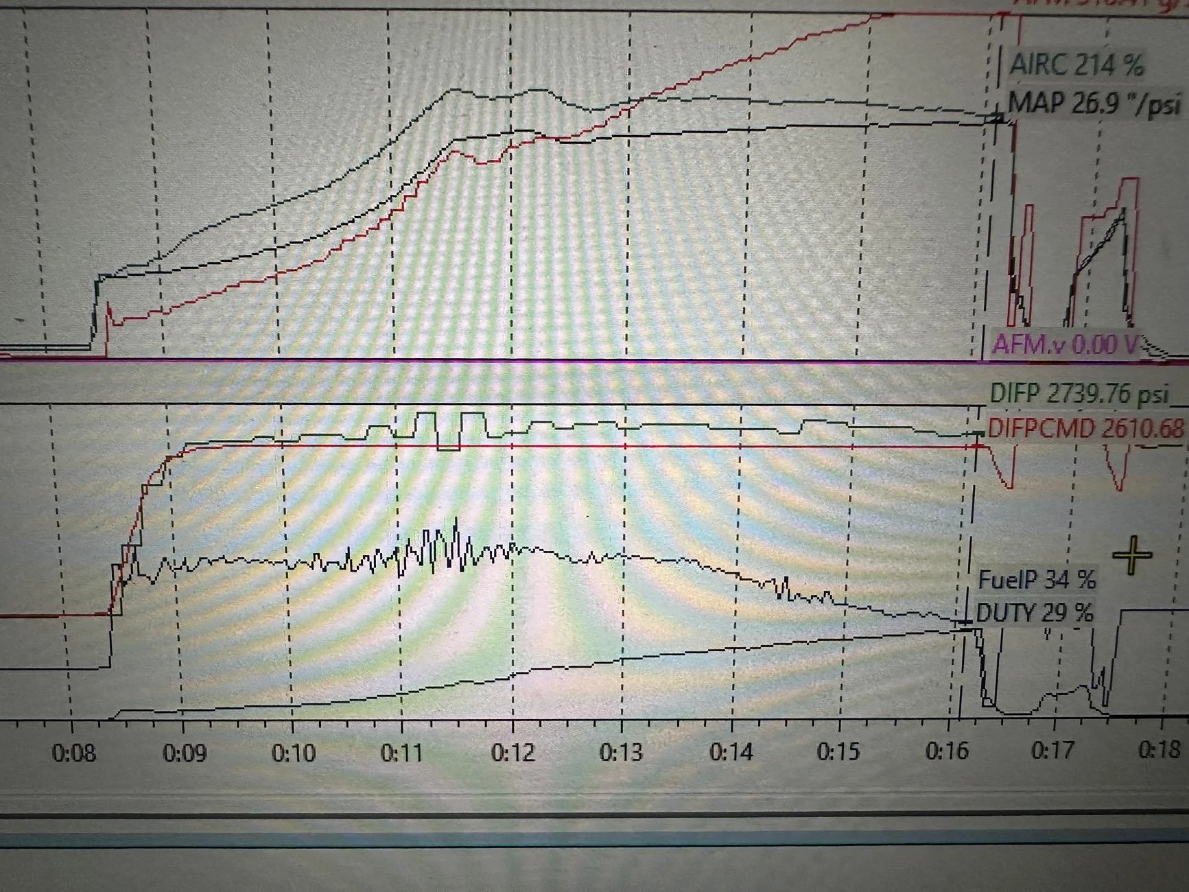

Worked with a customer yesterday on his setup. He was having consistent issues with heavy oscillations on the Hondata Fuel system plus.

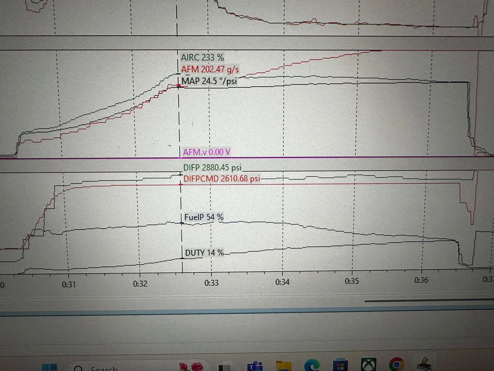

It looks a lot better now and the car is running properly.
